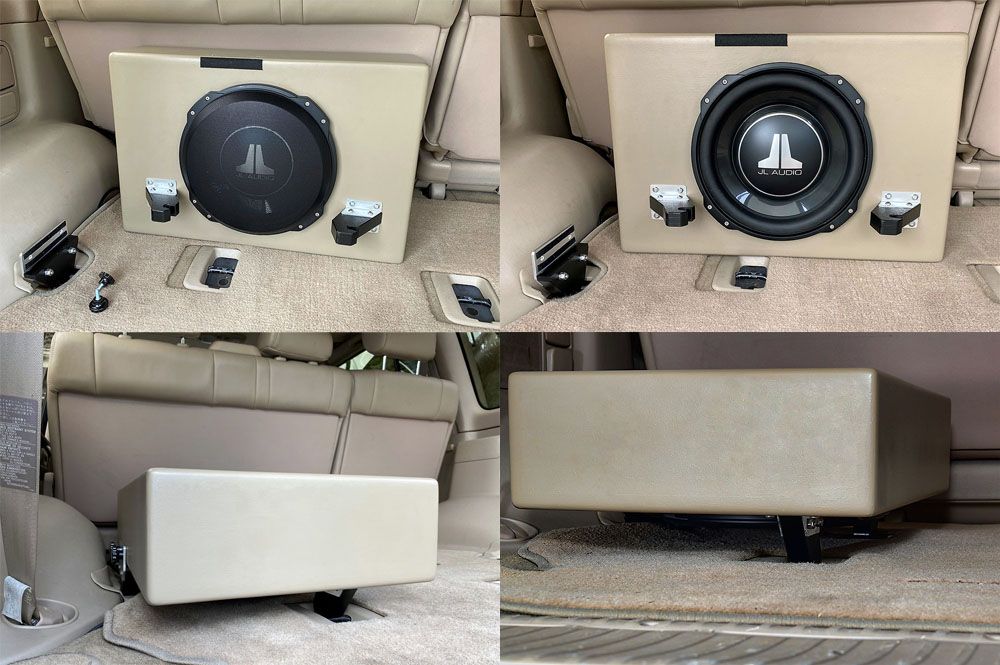

The sub-woofer is very secure, I won't have to worry the enclosure will fly up and hit my wife or I in the back of the head should we get rear-ended. I can also easily remove it when I want to haul things or put in the third row seat. It should also still fit behind the third row seat. With the tinted windows and matching paint, a thief will need to look very closely to even notice the sub is there. I may still build a custom enclosure in the OEM location but with what I have, am in no hurry.
Subwoofer box looks great! Where did you get your sub box mounts? They look like they hook onto the third row seat mounting points.
I built the subwoofer enclosure but Musicar Northwest built the mounts. They do attach to the third seat mounts. They are very secure and easy to remove. I can toggle between a tune that includes the sub and one when I remove it. I am more than happy with how everything sounds.
So the question is, do you notice any movement/rattle from the sub with it mounted like that. Looks quite secure but just curious if there is any play in the mounts that would have them buzzing with certain frequencies or whatever.
What a small world it is. I noticed earlier in the thread you mentioned owning an 335i E92. I owned a 335i E90 that had Musicar's stage 1 sub and amp package. Great company and products. Definitely not the cheapest out there, but you get what you pay for.
