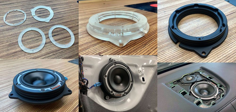

THe stock plastic ones off the factory speakers and trace em on mdf and cut em out. The. Sandwhich a sheet of dynamat between the mdf ring and the metal door cavity. Easy and good for sound enhancement.
also massive audio ct2 tweeters are legit and would be good with those 6.5s
I don't think MDF will hold up on the inside my doors; I don't think they seal very well after 20 years and a bit too much moisture is bound to wreck havoc. Thanks though.

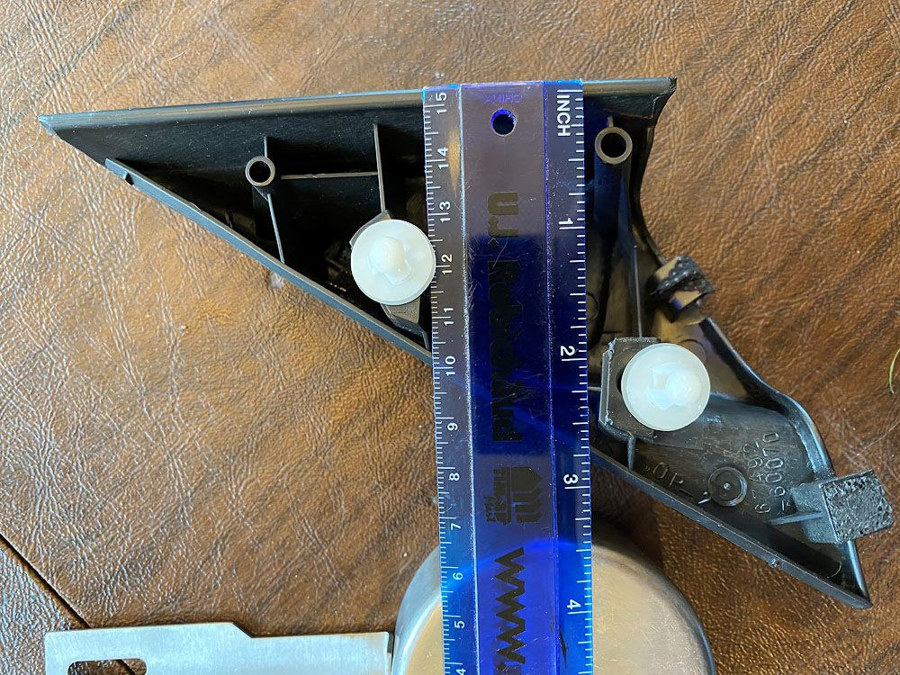

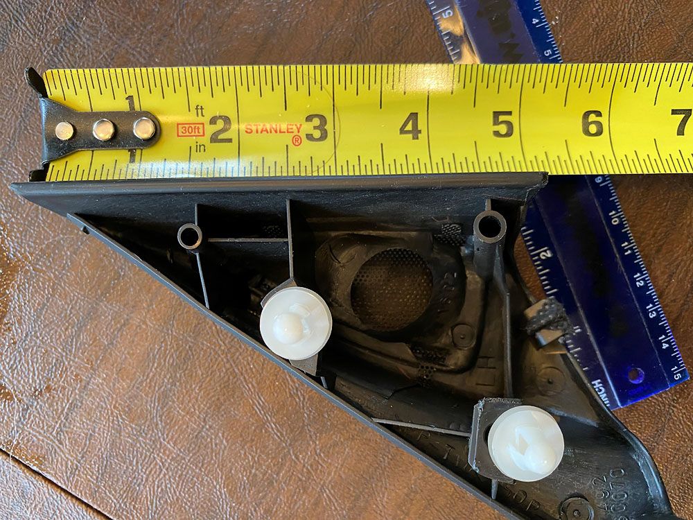

Do you know if the tweeter sails are the same size on the 2000 and 2003 Series 100's?
I want to be sure I get something that will fit. Any chance you took internal measurements? I need to find the process to pop them off and take measurements. I hope I don't have to take off the entire skin to do that.

My CT’s were 28mm (1.10”) and they Fit with no room to spare
I measured the stock ones and believe they came out to just over 34mm wide. I did not measure the depth but they aren't overly deep.
@Pucker5 did you have to modify the sail at all to get your CTs to fit?
How do you safely remove the tweeter cover?
I find lots of pictures after it is removed but none removing it. I don't want to break it and hopefully I don't need to remove the door. I just want precise internal measurements. I think this is what the inside of my 100 series tweeter cover looks like.
Thanks
I was able to remove the sail cover, just didn't wan't to break anything. Of course I didn't notice one of the white clips was loose and it fell down inside the door when I put the cover back on. Think I'll wait until I work on the door speaker to retrieve it.
Nope

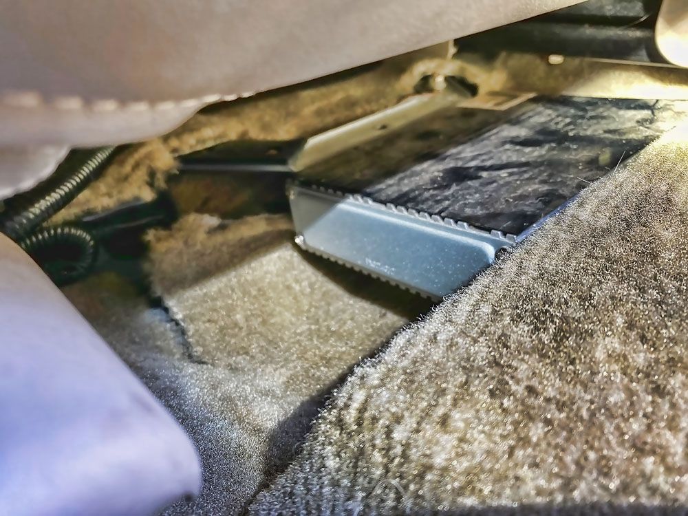

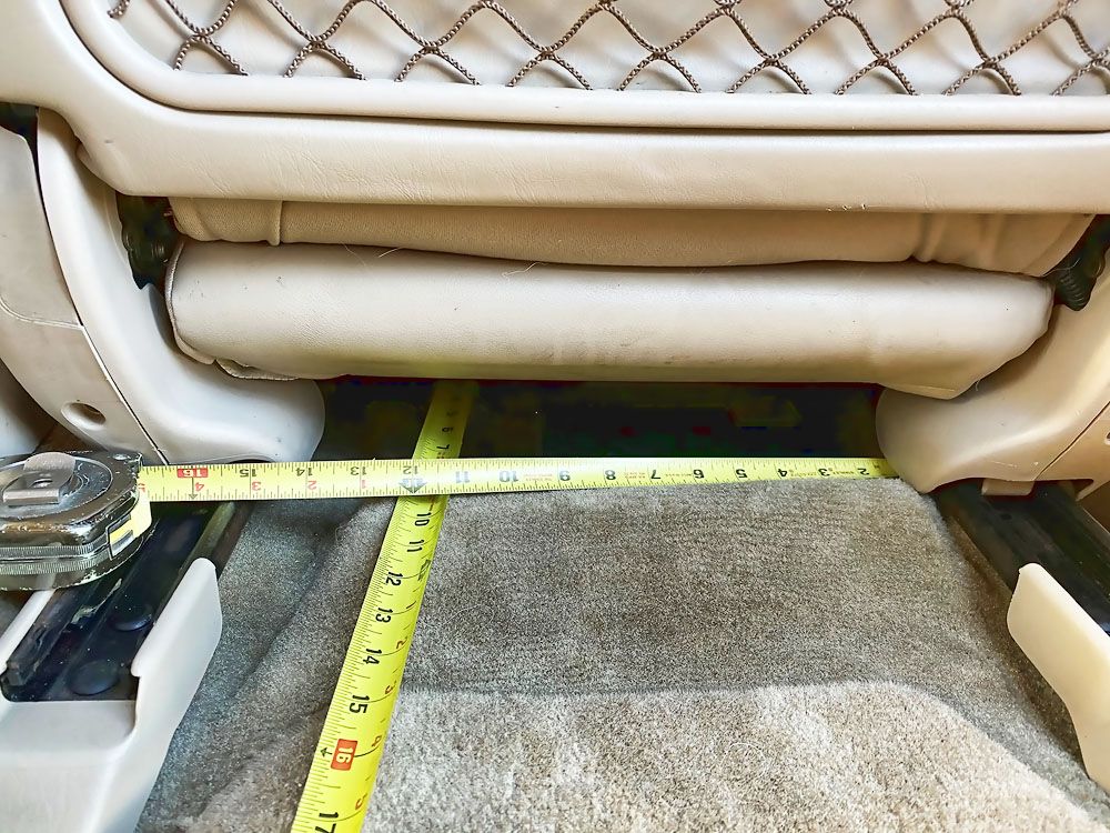

Will it fit under the seat? 15 3/8"(L) x 6 3/8"(W) x 2 1/4"(H)
It was suggested the JL Audio didn't provide enough power to the Dynaudio Esotar 650.2 mids and Esotec MD 102 tweeters so I am now considering the Arc Audio ARC 1000.6 amp with IPS 8.8 DSP Module. 4 channels for the front stage and two channels bridged for the sub.
I don't think it is going to fit. Looking at other options now. The board in one of the pictures is 15 3/8 inches long. It could tuck a bit under the rail on the right side but there seems to be a raise in the floor on the left side.

Custom Tweeter Pods for Esotec MD102
Composite Woofer Adapters for e650.2
