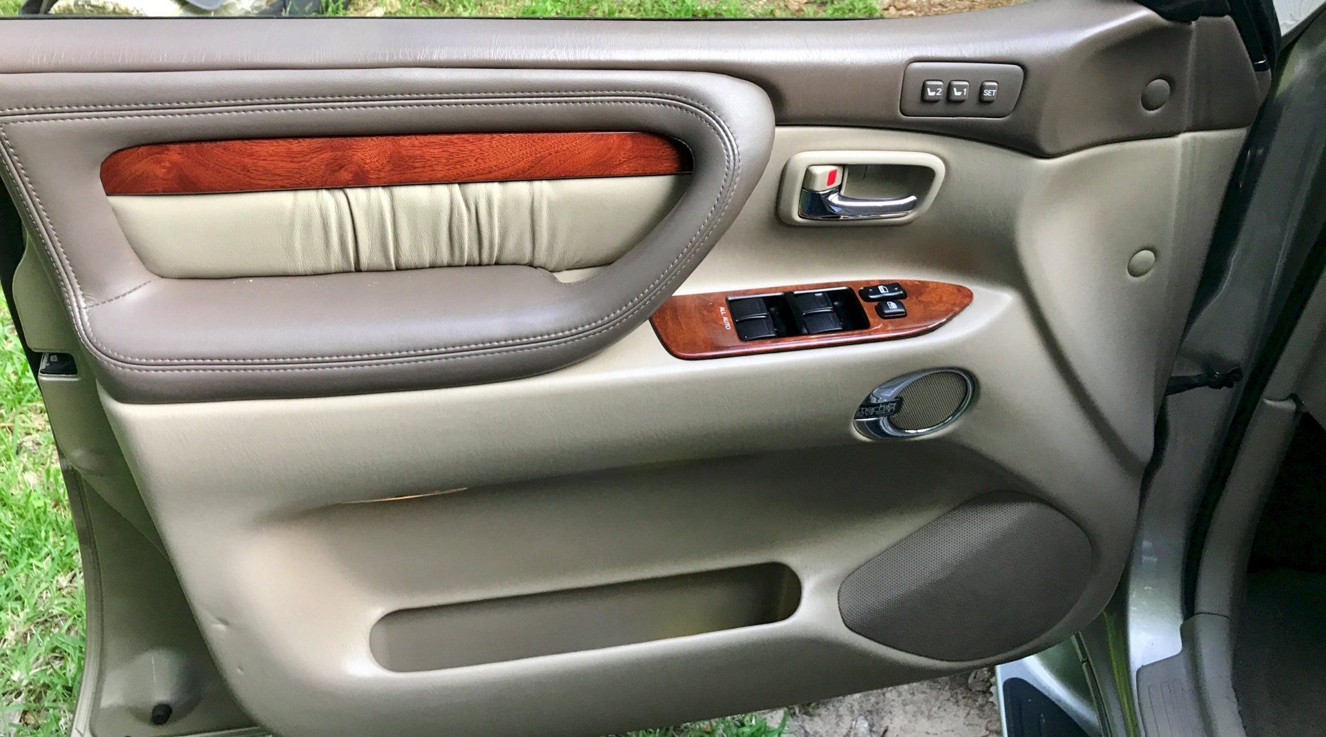

I am considering an audio upgrade for my 2000 Landcruiser, Series 100. I am interested in a full replacement of all speakers, the head unit and adding an amplifier and maybe even a DSP or amp with DSP built in.
It looks like I have tweeter sails in the front doors and mids in both the front and rear doors and a small woofer in the rear. What are the sizes? My searches show anywhere from 6 ½” to 5 ¼ mids, I haven’t found anything on the tweeter size and not sure of the rear woofer size. I assume I would want a component set in the front and coax in the rear door. I'm interested in a Morel Hybrid 602 6-1/2 component speaker system in the front and Morel Hybrid Integra 602 in the rear. Both sets are fairly shallow but do have decent sized crossovers. Will crossovers fit on the door panel? I need to know more about the rear woofer to decide on an option. I’m not set on the Morel’s but they sound great in my 335i E92.
I think I can figure out the head unit and prefer to have an external amp. Is there an external OEM amp and where is it located? Size would help to make sure a replacement fits.
