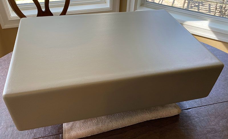

Quickly built the box and will put a coat of primer on tonight. Tweeters arrived so just waiting on the JL Audio 12TW3-D4.
Edit: Image added. Paint color turned out pretty close to the interior color.
My install is finished and I couldn't be happier with how it sounds. I have some work to do to tame some rattles when playing at high volume but you can only hear them when standing outside the car, not while listening inside.
The mid-woofers in the front doors put out some series impact and the outside door handles are just loose enough to vibrate a bit. A piece of tape or rubber should take care of that. The rear side windows shake a bit as well at high volume, mostly from the sub-woofer's sound pressure and a bit from the mid-woofers. I don't play at those volumes very often but I can crank the volume as high as I want with zero distortion. Musicar Northwest built the tweeter sail panels and the sub-woofer latching mechanism, amp rack and mid-woofer mounting rings. Their level of craftsmanship never ceases to amaze me.
The sub-woofer is very secure, I won't have to worry the enclosure will fly up and hit my wife or I in the back of the head should we get rear-ended. I can also easily remove it when I want to haul things or put in the third row seat. It should also still fit behind the third row seat. With the tinted windows and matching paint, a thief will need to look very closely to even notice the sub is there. I may still build a custom enclosure in the OEM location but with what I have, am in no hurry.
