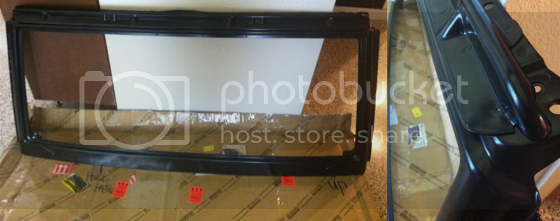

My new FST windshield frame came in today. Thanks @beno !
