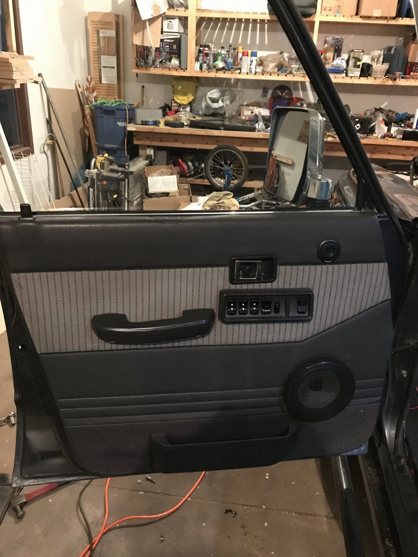

So the PO of my 83 FJ60 installed after market stereo and speakers front and back. The front ones prohibited the windows from rolling all the way down, so I took those out the first weekend I had it. My question is does anyone know of the size that fit and/or specific models they have used that have fit? I don't need anything fancy, I'm not looking for any incredible speakers, if I had the stock ones I would put them in, thanks

Thank you guys for the advice! I ordered the Pioneer TS-G1345R (For $25 shipped on Amazon you can't beat that) I don't think the holes were drilled large than the OEM speakers, does anyone have any advice for taking the door panel off? I was able to get the speakers out without having to take the whole thing off, I just unclipped the bottom and could get at it but I don't think I can install it that way. Really I just don't know how it comes out near the top trim at the bottom of the window
Came here to say, I finally upgraded the front speakers. Found these Kickers on Amazon, and they fit perfect. OEM look, speaker fits behind door panel with enough room for window.
