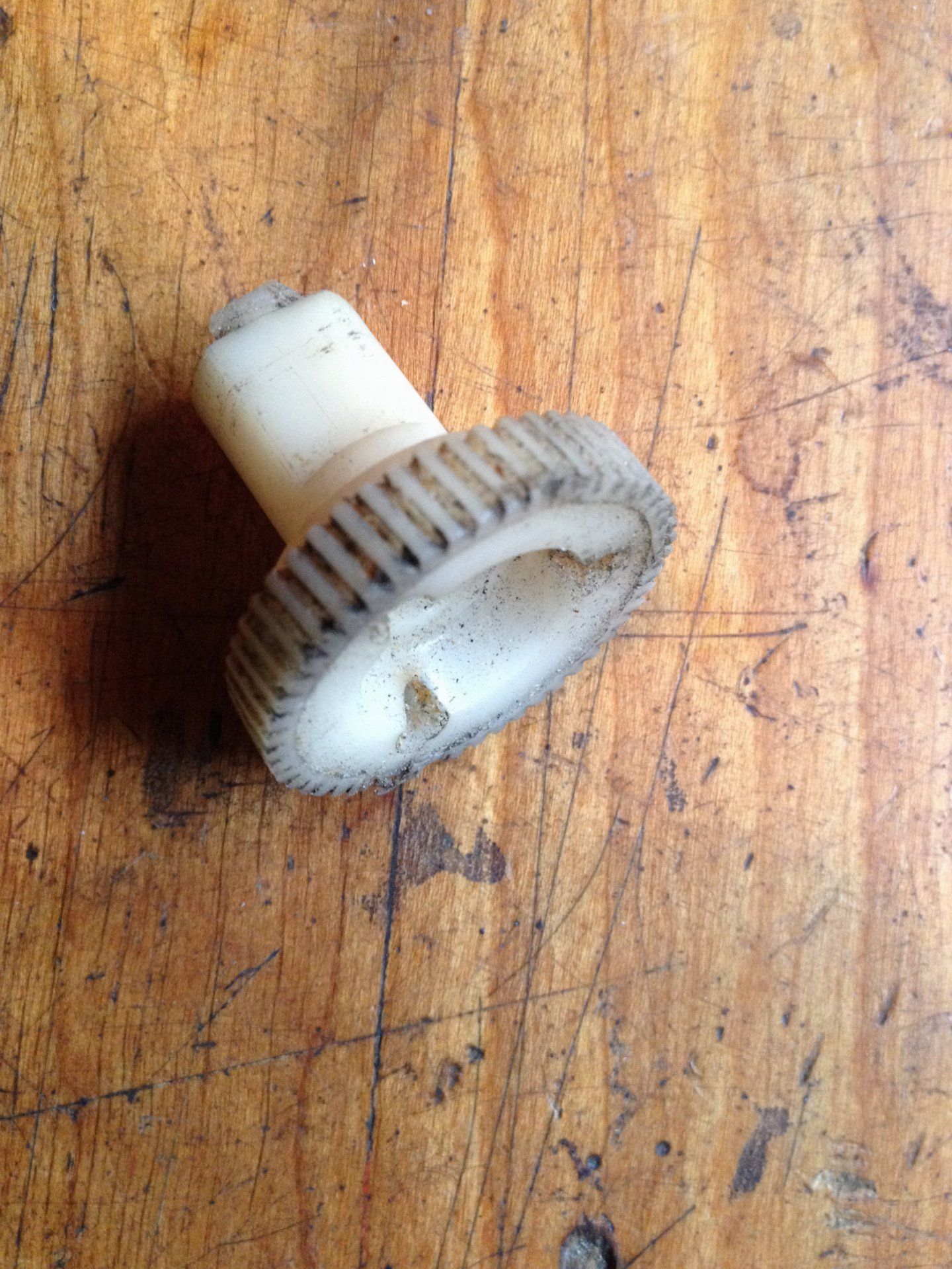

excellent product and write up. Pulled out my gears, found one shredded (pic attached), and have made my order for 2 sets of gear/caps, one for each seat.
Update: I serviced 3 seats - first took 2 hours, last was only 45 minutes. Would recommend the instructions emphasize being careful putting the shaft nut back on (use two tools) to avoid breaking the plastic gear. And recommend removal/cleaning/lubing of the rails.
