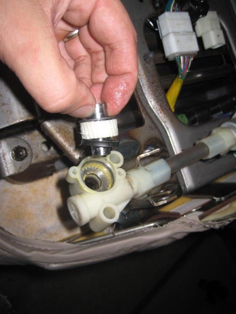

To press it on you can use a smaller socket if you want, and actually that will help create a stop when it smacks against the raised knurled portion of the shaft. Once on, I deburred the little chips the knurls made with a utility knife. You can see by the material removed how well engaged the knurls of the shaft must be with the new gear.
Then it's just bolt it all back up, I put the rubber washers in the same orientation as how they came out, and put a mess of grease around the new gear teeth.

NLTACY that is really cool looking and I hope the plastic gears hold up and your not costing people down the road with replacement parts and time to replace the gears . I think whats happening with the gears and causing then to strip in the first place is the metal gear " end "that fits into the white cap catches on the cap as its turning clockwise movement causing the cap to unscrew and causes the cap to fall out ,and once the cap is unscrewed it no longer keeps the metal gear in line and falls down and digs into the plastic gears and in one full rotation strips every gear . So If it wasn't for the cap unscrewing the plastic gear might last a lot longer and may never wear out . So if you can stop the white cap from unscrewing by using hot glue or blue loctite your seat my last a lot longer , which by the way I found out after I used a little loctite to hold it in place will not come off once you loctite it . I didn't want it to be permanent because I was going to cast that into metal also . I'm going to take my now working drivers side seat out and inspect the gears while its still working . My 1997 only has 50,000 on it and the passenger cap came out so I think it only take one full rotation of the cap out to destroy the gears . So 332k or 50k makes no difference its all when the cap becomes unscrews that your screwed . I do like the way you think NLX, I do the same thing when I make thing that go in the mouth like bridges and partials and dentures . Every thing has to work together .

If you have a spare broken seat steal the gears out of the recline mechanism and put them in place of the white gears. You'll notice they have way better hypoid to the worm gear. If you're interested in making a metal gear, copy the recline gears instead.
