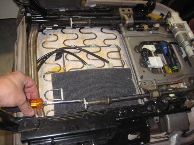

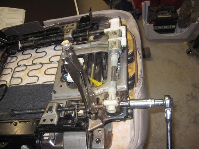

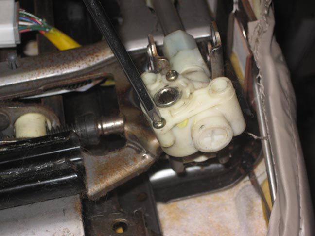

To take off the shaft bolts, hold the shaft with a vice grip. Remove the little plastic the rear supports, then unscrew the gear housing. When you remove the shafts from the slides of the seat, do your best not to allow the thing to twist at all, and thus change position. It's important that both sides are at the same position, in relation to each other, or it's going to try to push your seat crooked and probably not work too well.
View attachment 252638View attachment 252639View attachment 252640
I marked the ends with a magic marker to make sure it lined back up.
