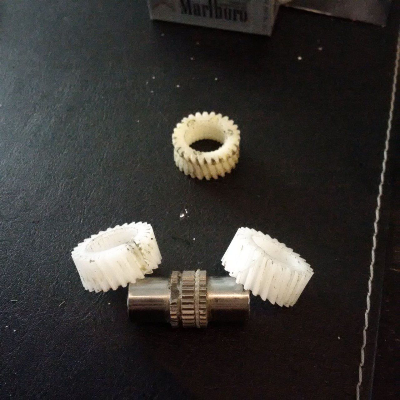

I recently got another 80 to add to the stable.. this one has the leather power seats. The driver side is stuck around half way through the rail while the passenger seat moves but makes a loud sound whilst operating. I decided to order the fix for both seats (2 gears, 2 caps).

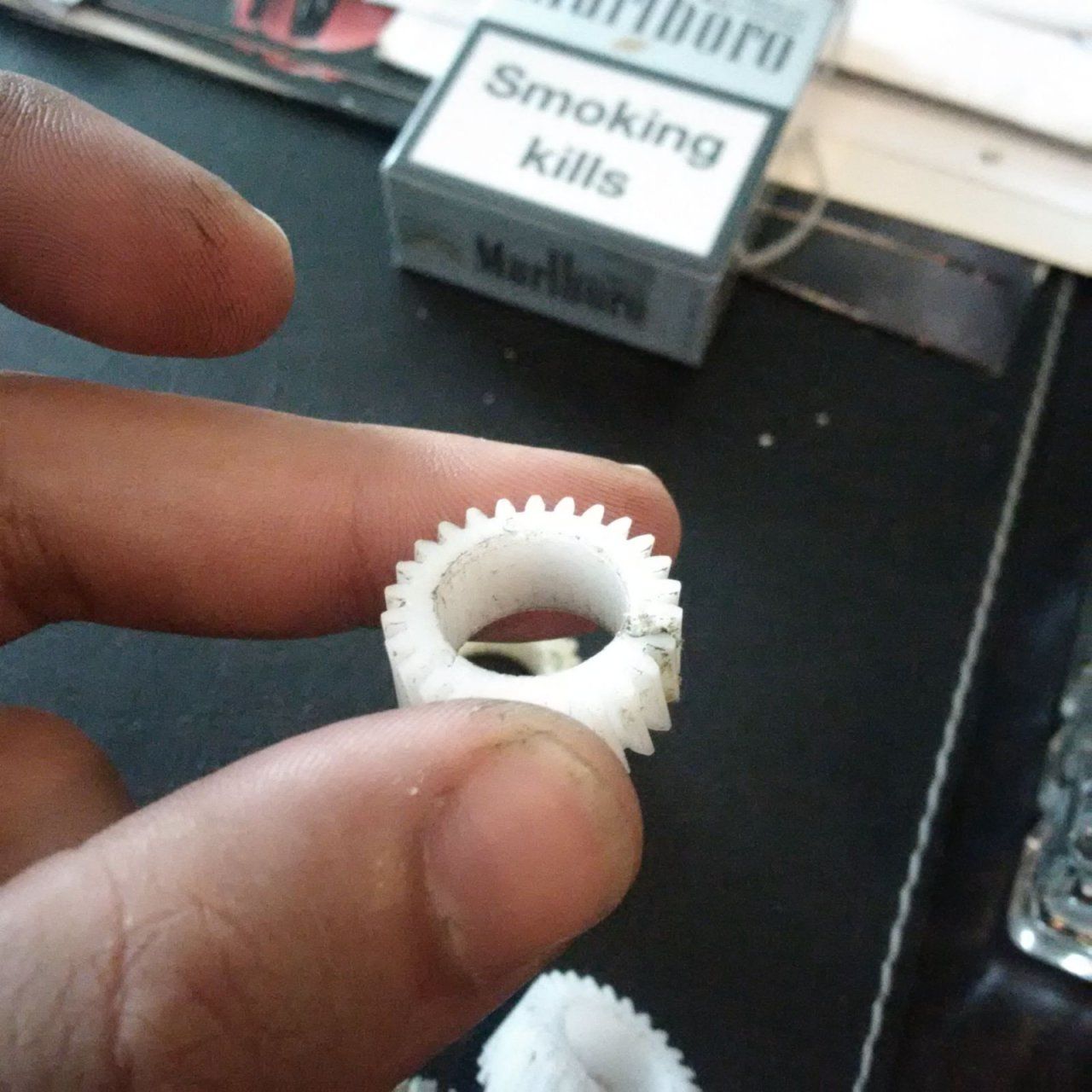

I removed the driver seat for installation. Followed the instructions which were great but when I was pressing the gear onto the shaft, I accidently cracked it (guess it was going in at an angle). I had to use the other one instead and that slipped on very smoothly. Bolted everything back up and aligned the rails and went to the truck for a test. Nothing happened :( the seat would still not move but I could here the motor working. I tried messing around with it back and forth for a few mins hoping it would work but it didn't so I removed the seat and stripped everything off again. I found that the other gear had cracked as well (around half way - see pics) and the worm gear on the shaft was burred from one side!!
Any idea what went wrong? I also feel that the inside of the replacement gear didn't take the pattern of the worm gear. Maybe it was slipping?
I am also wondering if every seat rail has 2 gears or just one since the kit for both seats has 2 gears and 2 caps only.. I did the DS seat and worked on the outter gear, didn't look into the other side (next to the tunnel) to check if that had a gear.
Any thoughts? I'm going to order some replacement and attempt this again because the truck is undriveable at its current state especially being 6'5

I have successfully destroyed two new gears and have yet to fix my seat problems.
Here is the scenario: 1995 LC with 120K. PO purchased the replacement gears and caps (I assume from Gamiviti as I don’t think these can found elsewhere) and gave them to me when I purchased the LC. Both Driver and Passenger seats were working, but he had removed the shaft and gear housing on one side of the seat – leaving only one shaft hooked to the motor. I am not sure how long the seats were operated this way, but I am guessing it has been for quite some time. The seats are still operational with only one shaft hooked up, but I have to believe that this will definitely shorten the life of the expensive motor. The problem is that under quick acceleration or stopping the seats actually slide forward or back about ½”. This rocking cannot be good for the underlying components.
I followed the instructions via the web and swapped to the new gears. Very good instructions, but a little more difficult than I anticipated with pressing on the new gear. Nonetheless, I am pretty confident that I completed the gear swap correctly. However, during the initial test I could hear the gears strip immediately and only one side of the seat tried to move. The first go around I may have underestimated the importance of precisely aligning the shafts. I basically just eyeballed it. The second try I precisely measured the shafts and feel that everything was properly aligned. Same result – stripped gear and only one side moving.
I did check for obstructions to the seat track, and also to make sure all the components looked to be in good shape. Basically I am wondering if I should purchase another set of gears or go ahead and purchase the entire housing. Possible the issue is related to the worm gear in the housing and/or my inability to get it lined up correctly with the plastic cap. Anything other than less than perfect install that could be causing this problem?
Greetings. I'm in the same boat as you. 1995 FZJ80 and waiting for new gears to arrive to try this again.
My oversight was a failure to check the passenger seat outboard gear after replacing the inboard. I didn't realize there were plastic gears on BOTH sides of the drive shaft. I stripped my new gear because that side moved forward while the other stayed put (had a stripped gear unbeknownst to me).
I'd suggest carefully inspecting both inboard and outboard gears and lubricating both. I'd also suggest thoroughly cleaning the associated worm gears. Finally, on the advice of another Mudder, I purchased an inexpensive digital caliper to PRECISELY align my seat rails.

I just did the same on my driver side. Thought I could get away with just the cap initially but that didn't do the trick. So I bit the bullet and replaced both gears. A bit of a challenge removing the old ones (ended up using a Dremel to cut them off), and making sure the new ones are on straight. Took maybe 1-1/2 hours instead of the one hour reported by others, but that's fine. It works great now and beats the $2000 that the dealer quoted me to fix it!
