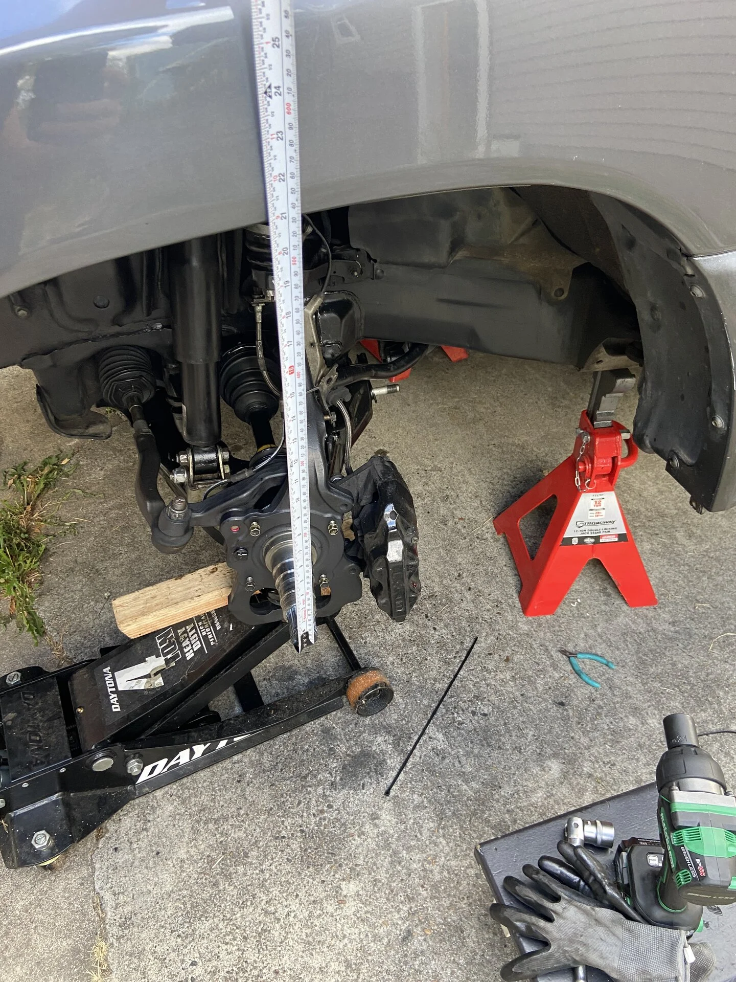

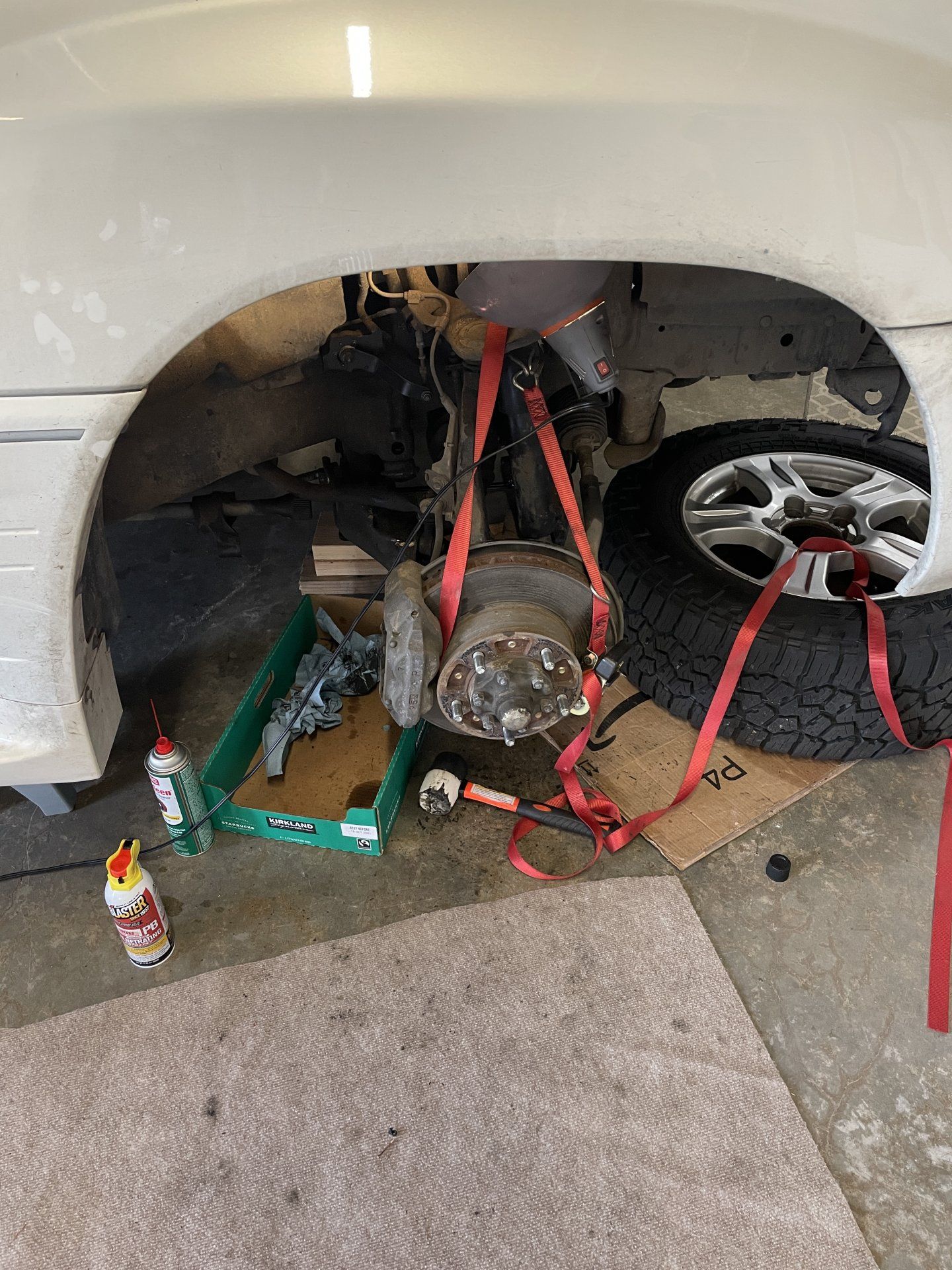

I just removed my passenger side front LCA and thought I was being smart and wratchet strapped the hub to the upper control arm. Didn’t really think it through and when I removed the LCA the hub assembly was supported by the UCA/axle.
Any chance I damaged anything? I’ve since strapped it to the frame as well as putting a jack under where the ball joint would go.
How would I know if the axle has been pulled out of the diff? To clarify I am wondering if letting the knuckle/hub rest on the upper control arm with no support underneath would the axle come out of the diff even just a little? But the more I think about it, I doubt that would happen since I still had the tie-rod end connected as well as the knuckle to the UCA. I imagine it would would pretty hard to pull the axle out of the diff with those still connected? Is there anything in the suspension/frame that limits how down the UCA can travel on it's own?
The droop didn’t appear to be too much.. axle appeared to be fairly straight?
You're good!

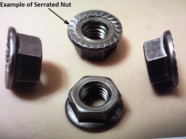

It's a serrated flange nut. The bolt or nut may be turned. The serrations are directional and designed to resist rotation in the direction that would loosen the nut. It is perfectly fine to turn the nut if you desire. In fact... they are designed to mar/displace the base material they ride against.

Toyotas nuts and bolts do not look serrated to me. I ended up flipping the bolt and nut around and secured the control arm this way so that i can torque the bolt. Hopefully it'll stay in place. We'll see
The Toyota nuts for the LCA are definitely serrated.
I’m doing this right now. After reading the thread it dawned on me that I logged my ride height during AHC tuning. So I’m going to jack up the LCA until the center of the spindle is 535mm from my fender edge. No tension on TB, torque everything down.
Everyone’s going to have a slightly different nominal measurement. My notes say 500mm is stock and slee sets up 540 to 550mm.

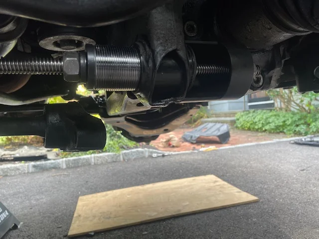

The parts list below was paired with one of the larger cups from a ball joint press kit like this to receive the bushing.
Amazon product ASIN B01N7CO50EYou can also rent these kits.

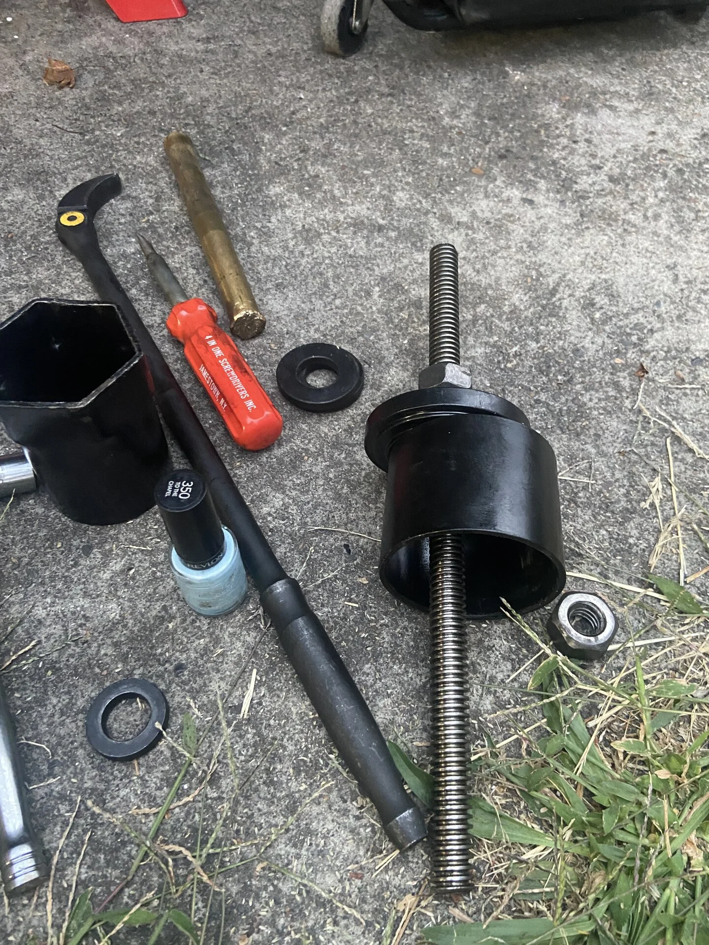

Here's my order from McMaster-Carr:
QtyEachDescriptionPNExtended
2$3.68Carbon Steel Acme Hex Nut, Right Hand, 5/8"-8 Thread Size94815A108 $7.36
1$21.24Alloy Steel Acme Lead Screw, Right Hand, 5/8"-8 Thread Size, 12" Long93410A932$21.24
1$4.62Black-Oxide Steel Oversized Washer for 7/8" Screw,
0.906" ID, 1.828" OD, 0.230"-0.255" Thick, Packs of 1
98029A056$4.62
2$2.6Black-Oxide Steel Oversized Washer for 5/8" Screw,
0.719" ID, 1.250 OD, 0.230"-0.255" Thick, Packs of 1
98029A053$5.2
Total$38.42

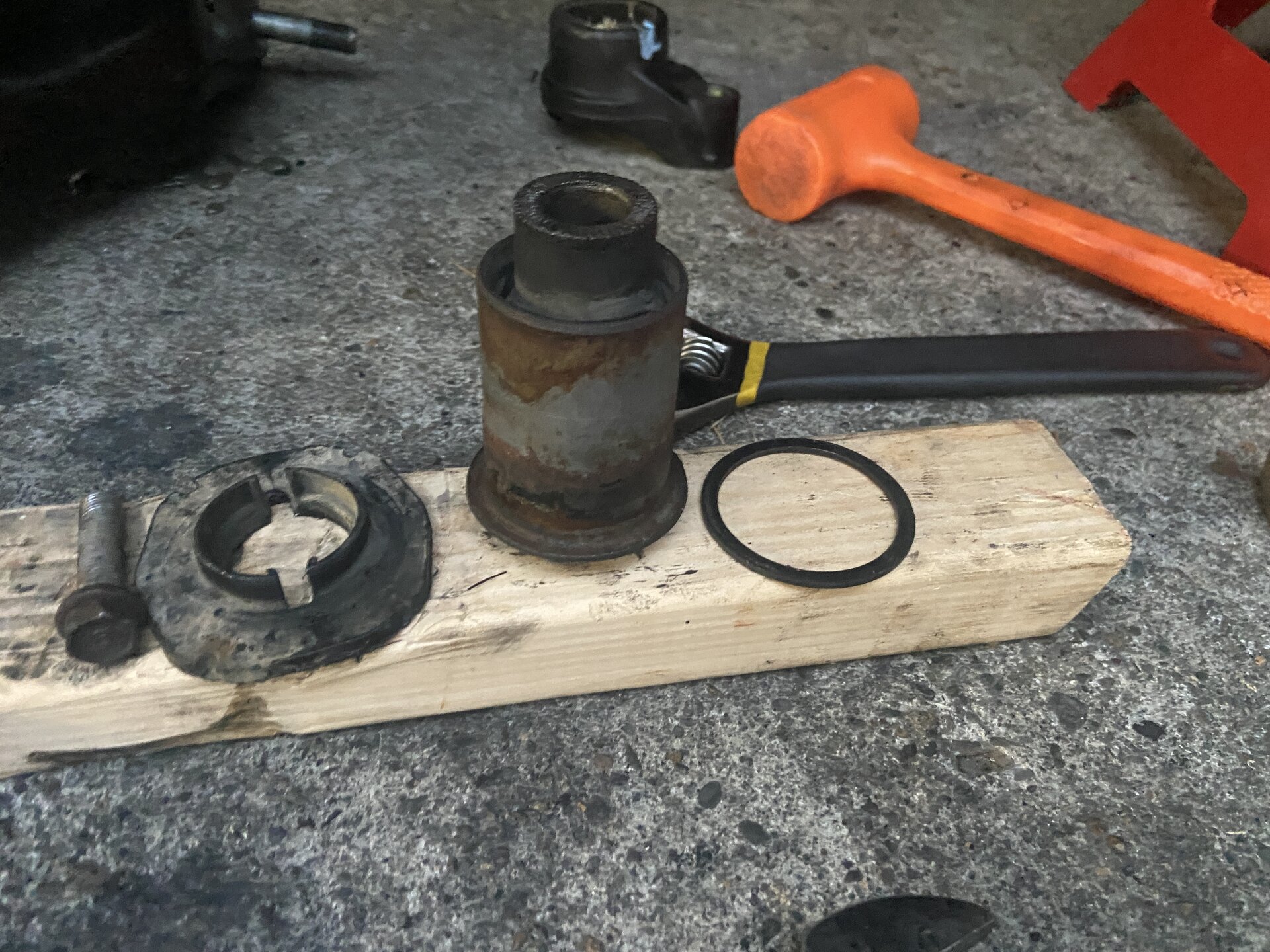

Its a grade 7 screw, with 125,000psi tensile strength. I didn't run the numbers for what it can assert to the bushing ... but estimating it now to roughly 20,000lb breaking strength, assuming 1/2in diameter solid inside the threads. Cross-section area in inches * tensile strength in PSI ... YMMV, but my bushing popped out!
they are not serrated nuts, but actual raised radial bars. the frame has receiving indentations...if you loosen the single nut, the bars become destroyed, and takes 10x the force.

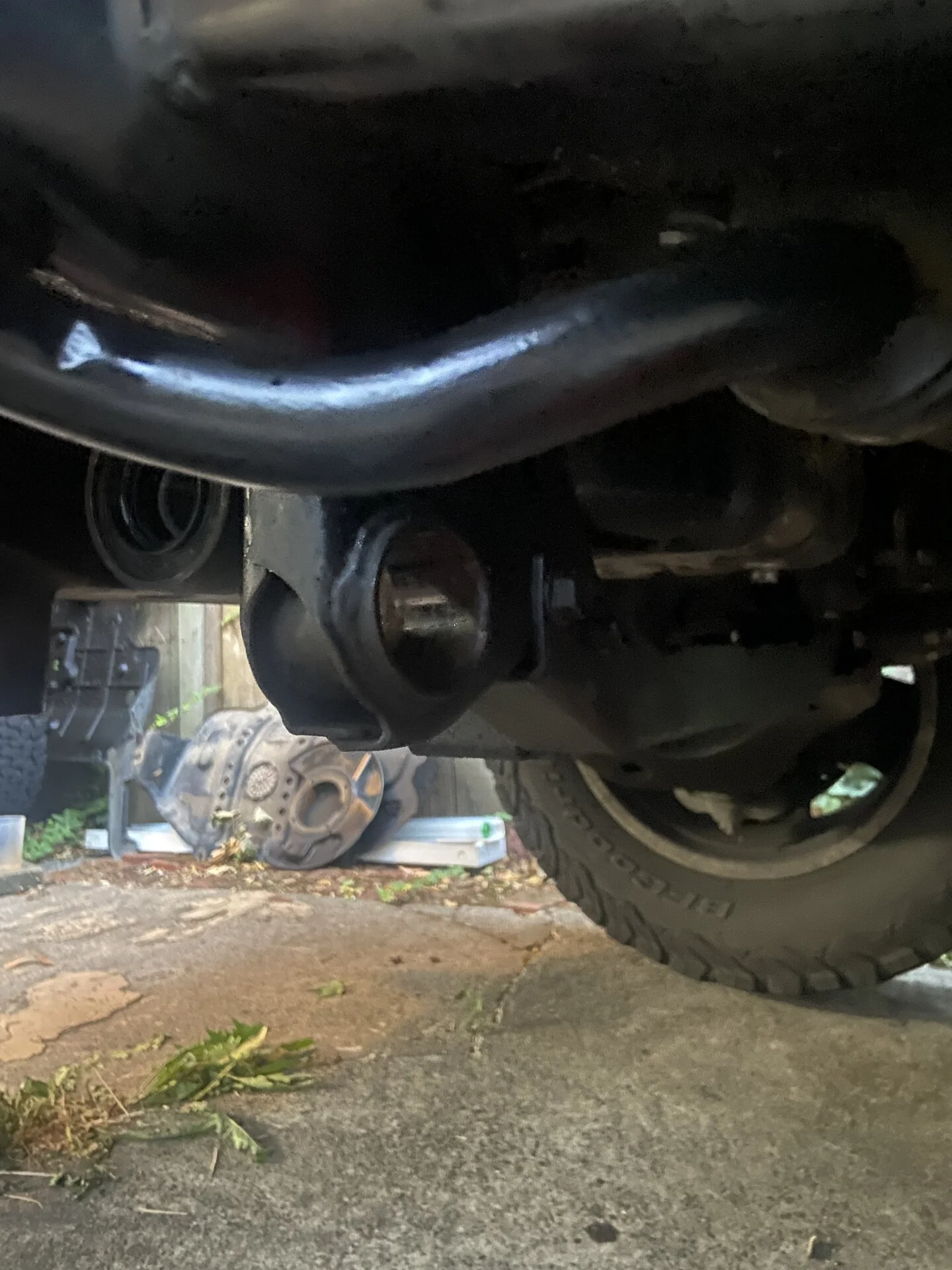

Mc-Master Carr order worked great! I paired it w/ the rented #648617 ball joint press receiving cup from advance auto. The kit didn't haven't anything the correct OD to push bushing #2 out but it turns out that nipple for 2" OD galvanized pipe fits nice and snug just about the same size as the 1.828 OD washer. Pushed it right out - I just had to help it back out in the reverse direction with the washer.
