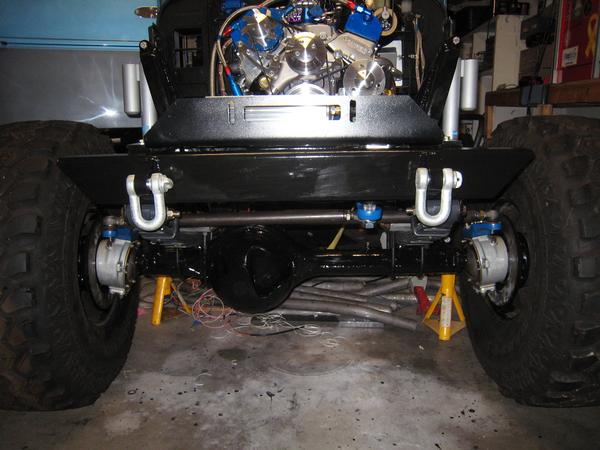

front diff protection?

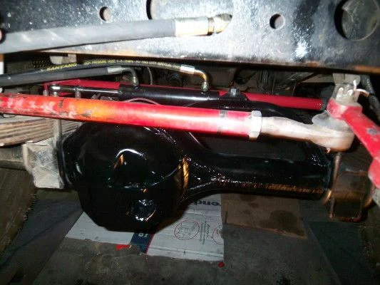

Here's a pic of mine. I know it's not a great pic of the diff cover itself, I can get better pics.

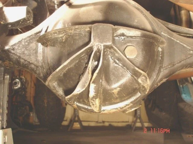

i took a spare rear diff cover and cut it up, then welded it on top of the front one for more protection, so far its done a good job, but it looks kind dumb and id like something a little more beefy for my next one!
I wanted to fab up a Dynatrac style cover, but made the ribs too long & of too light guage mat'l. :rolleyes:
sweet idea man, shame on the exection champ. are you going to do it again? use thicker material? if you do would like to see a finished product.
