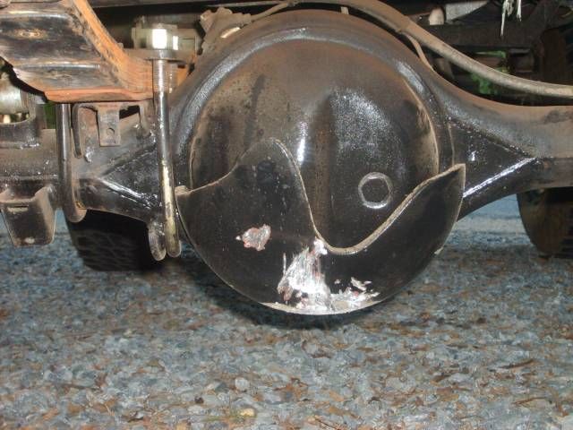

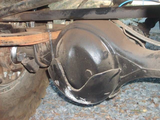

Here's a couple pics of mine. Just 3/16" plate cut to the right shape and tack-hammer, tack-hammer....... till its flush, then welded in solid. Also cut out drain and plated the bottom.
Cost: 2 dollars + 2 hours :hillbilly:
I am another of pygpen's satisfied customers. best bang for the buck if you are looking for something to just weld on. If you want to fab something up there are a few good ideas on here. If you can find the 10" pipe cap and want to do the cutting yourself, don't forget to notch for the drain on the bottom.

I welded a piece of 1.5" x 1/4" thick bent to the radius of the ring gear . pretty simple but it works well . the ring gear is the only thing that is close to either cover front or rear .
are you guys welding these on with everything in the axle in place? meaning, full of diff fluid, gears in place, ect..?
Seems to be a pretty standard practice.
If you were to drain the fluid, I would expect that to "burn" more fluid since there would only be a thin residue vs a gallon of fluid to dissipate the heat throughout. Don't see how it could affect gears etc.
