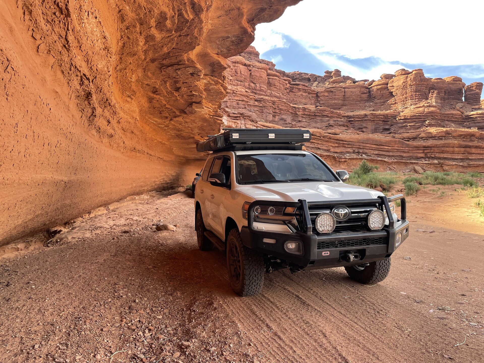

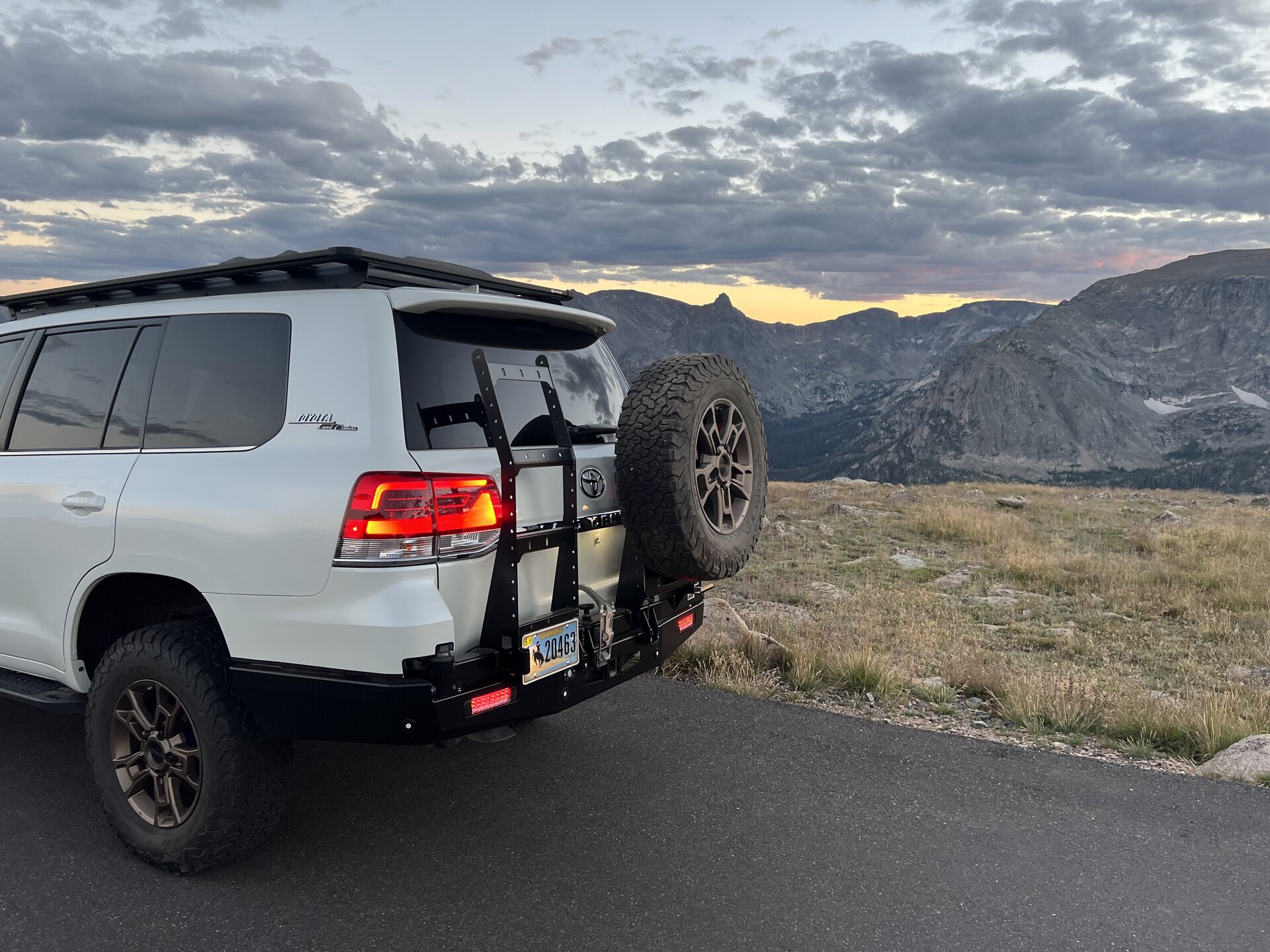

I have ARB on mine. This is my 6th vehicle with an ARB bumper. They just make good quality bumpers and they are crash tested which was a selling point for me. But I also just prefer the look of the ARB. After damaging my stock rear bumper on this trip (below) I got the Slee rear bumper it is also excellent quality, I'm sure their front bumper is really nice too - every Slee product I have had is really quite nice. I think you'd be happy with either of those brands.
Looks great. I have the Slee rear also. Great, great bumper. Would have definitely considered the front Slee bumper, but it was not around when I bought my TJM.
