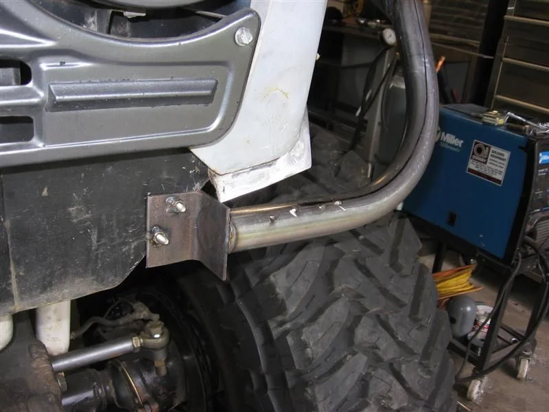

Well I finaly finished my "honey-do" projects for long enought to have some time to start building my bumper!! I'm pretty happy with the way it's turned out so far concedering this is my first tube bending project. I ran out of welding gas or I probely would still be out there! :cheers:Joel

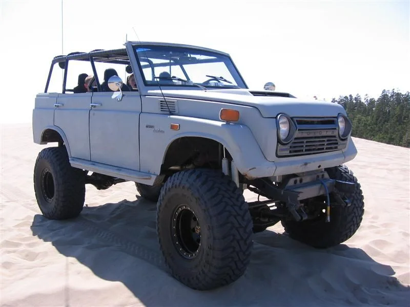

I will be taking her on the McGrew Trail ride in July. We can't wait...this will be our first TLCA event. We ran the trail a few years ago and had a blast.
This is one of the pictures of the cage I have for now...I will take some more and get them posted.

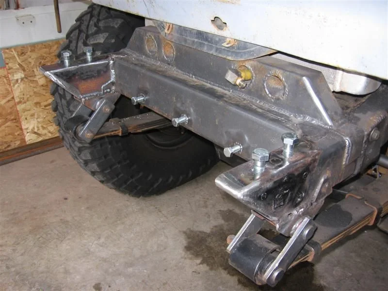

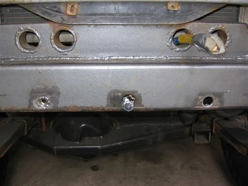

Well I got a little more done on the bumper. I boxed in the ends of the frame rails for extra strength, and because I cut one off to short when I did the SOA. Adding in the mounting points turned out pretty good too. They should be pretty strong with four 5/8" soon to be grade 8's and three 1/2" bolts on the the lower half.
I have not had a lot of time to spend fabricating until recently and it feels great! Every once in a while when I'm in a bad mood I'll sneak out to the shop to grind on something and it always puts me back into my happy place.

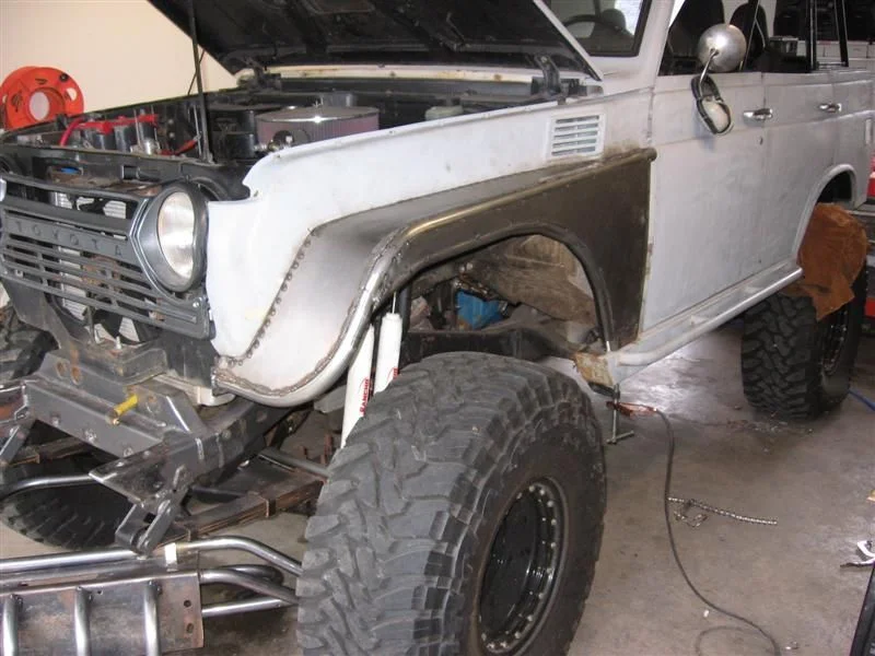

With the bumper well on it's way, I started thinking about how bad those fenders are looking!
If your a purist you might wont to turn your head. Sorry! I used to be, until I started grinding out the bondo and chicken wire the p.o. used for body work.
This is the first set of bars I bent for mock up.
:cheers:Joel

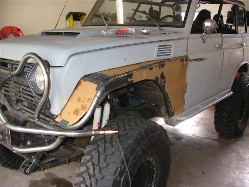

Couple more pictures! Now that I bought a Silver star I feel like a Japanese tourist at Disneyland! (don't be offended, it's funny)
Cardboard is a great thing! It holds a pizza together, and can fill in the gaps when your trying to think!

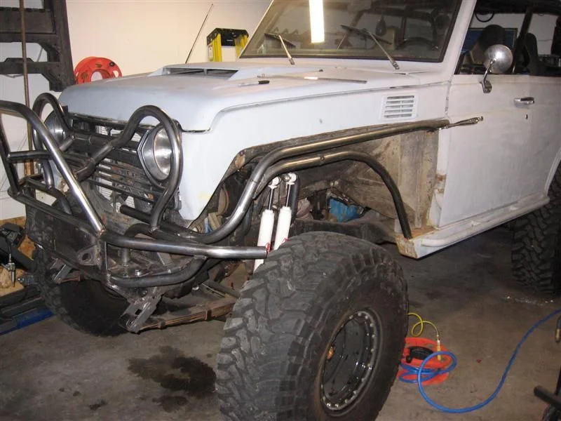

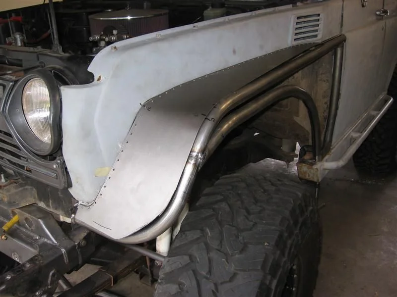

I 'm getting closer to finishing up the fab work on the first fender. Man there a lot more work in these little buggers than I thought there would be. Theres a lot of different angles to have to work with. But I'm happy so far.
P.S. thanks for the words of encouragement!:grinpimp:
