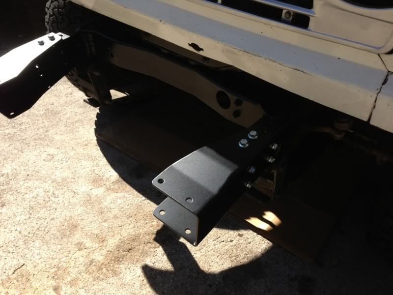

On a more fun front, got some AWL_TEQ goodness in the mail from the great white north. Cleaned up and painted the front frame rails to install these ...
Stay tuned for the reason I needed those frame extensions, it's off at the powder coating shop along with the grill, headlight surrounds, and fender vents. Will be cleaning up and painting the black area behind the grill while I wait ... might be a good time to install some other goodies from the parts stash?

Those frame extensions look nice, you're ready for hardware.
nice Tucker! How did you paint the hooks?
