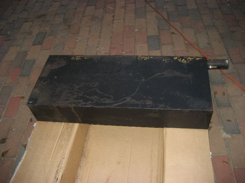

So had some more fun with the pig last night, after all my efforts last weekend it still seemed to be leaking diesel :frown: I think I mentioned this truck came with dual tanks, but what I didn't detail was it's got a 55 long range tank in the spare tire location and one of these along the drivers side along the frame:
attachment.php
So last weekend when I replaced the fuel lines I bypassed the auxiliary fuel selector and just plumbed up the main tank (feed/return). I thought at the time that the excess fuel that was leaking had been running down the input from the selector, down the feed from the auxiliary tank, and dripping from the bottom of this tank. I now know that wasn't the case, because the tank was still dripping after I bypassed it and removed the feed line completely :frown: So it seams this tank is leaking, and last night I tried in vain to remove it. It had the filler on the DS front fender, and a the filler hose ran down the inside of the cowl against the inside of the frame to the inlet. I had a heck of a time removing that and the vent (30+ year old hard rubber), then the filler neck from the fender. Next I removed all the nuts off the two threaded hangers and pried to my hearts content w/o any luck. I guess I'm going to have to cut the two hangers, but I couldn't figure out how to get above the tank last night.
Any ideas?
