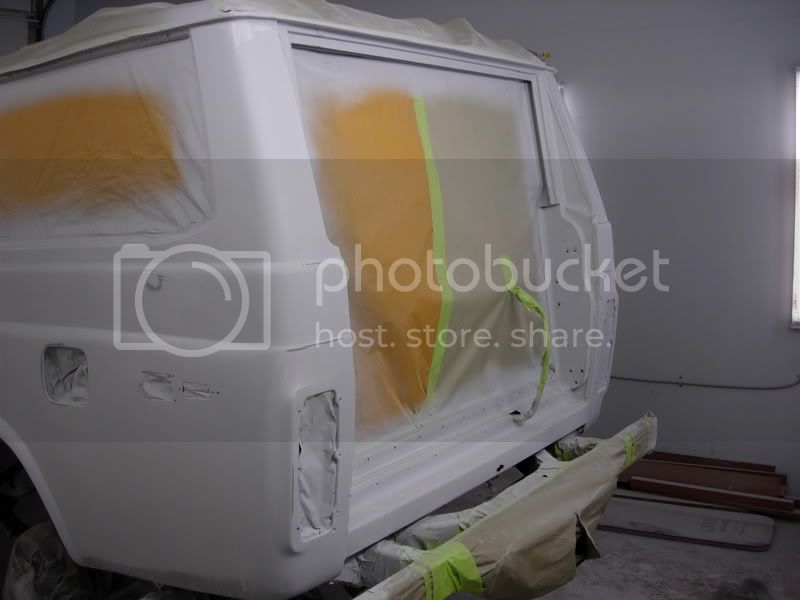

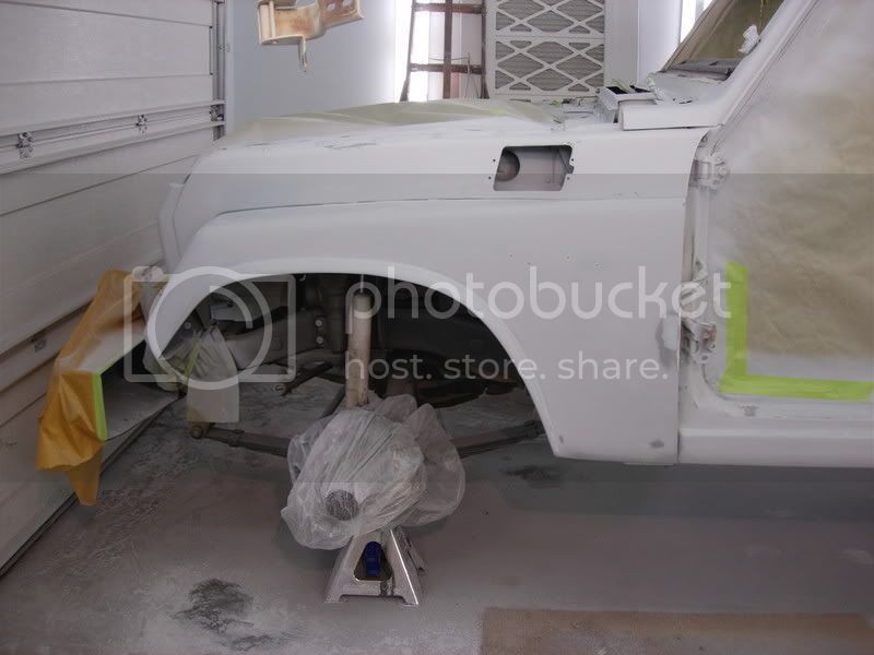

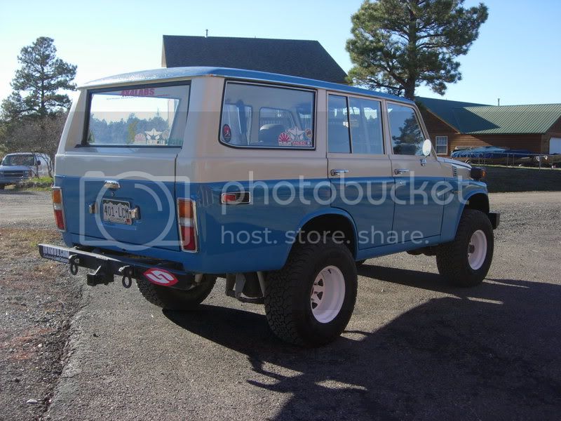

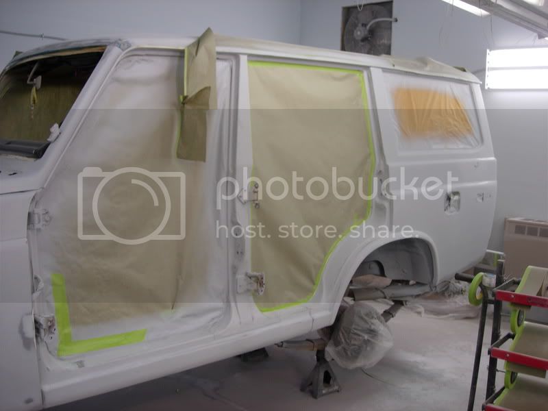

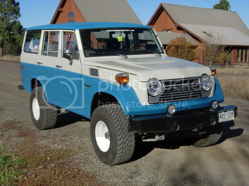

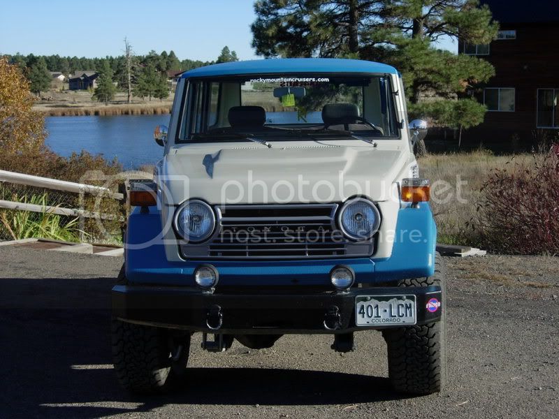

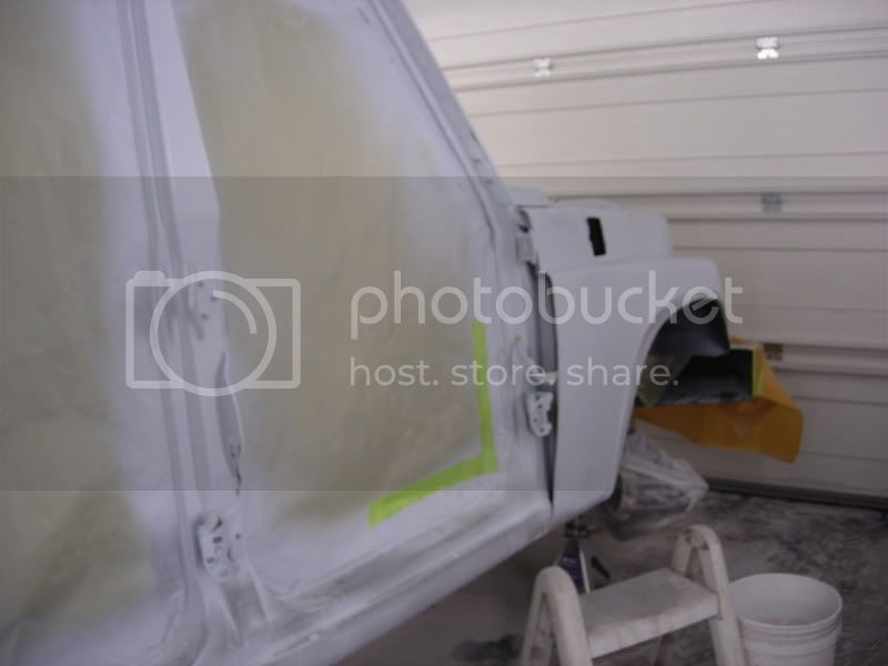

Well, finally got my sons pig finished. Went with the stock colors (278). Plenty of rust repair, but the end result was worth it ! Its Hippo lined color matched blue on the top, rockers, 1/4's and around fenders. Its going to get a mask of color matched white hippo on the front of the hood soon. New weatherstrip all around, new mirrors, headliner, and misc.parts i've bought from guys on Mud.
Special thanks to pvcruisers for the remanued tailgate weatherstrip. heathrj for the sticky on door and misc.weatherstrip, Ron @ RMC for the primo grill, and rhino for the glovebox door handle. Lots of others to thank also, but look at the pics and get inspired. Hoping this one will last another 28 years ! Long live the IRON PIG !:bounce: :bounce: :bounce:

did you end up fixing the fenders or did you get the fiberglass $OR ones?

THanks for the replies. Fenders are $or fiberglass. Fj60 p/s. Interior is going colormatched liner same as the white exterior. Won't have time until 11/7, then bucket seats tuffy and rear disc axle after liner is done. All fasteners that were removed were replaced w/stainless. Headliner is $or, but only cost $126.00 + labor. Well worth it i think. Its amazing how things shine up with a little elbow grease. Mike

The fenders are just ok. I bought them last fall, and since then they have improved them by reinforcing the vertical area where they meet the doors. The main complaint is that the roll/radius on top of the fender does'nt match the doors too well, so you have to fudge the two tone line a bit to make the lines correct. Other than that, zero rust forever is a good thing.
