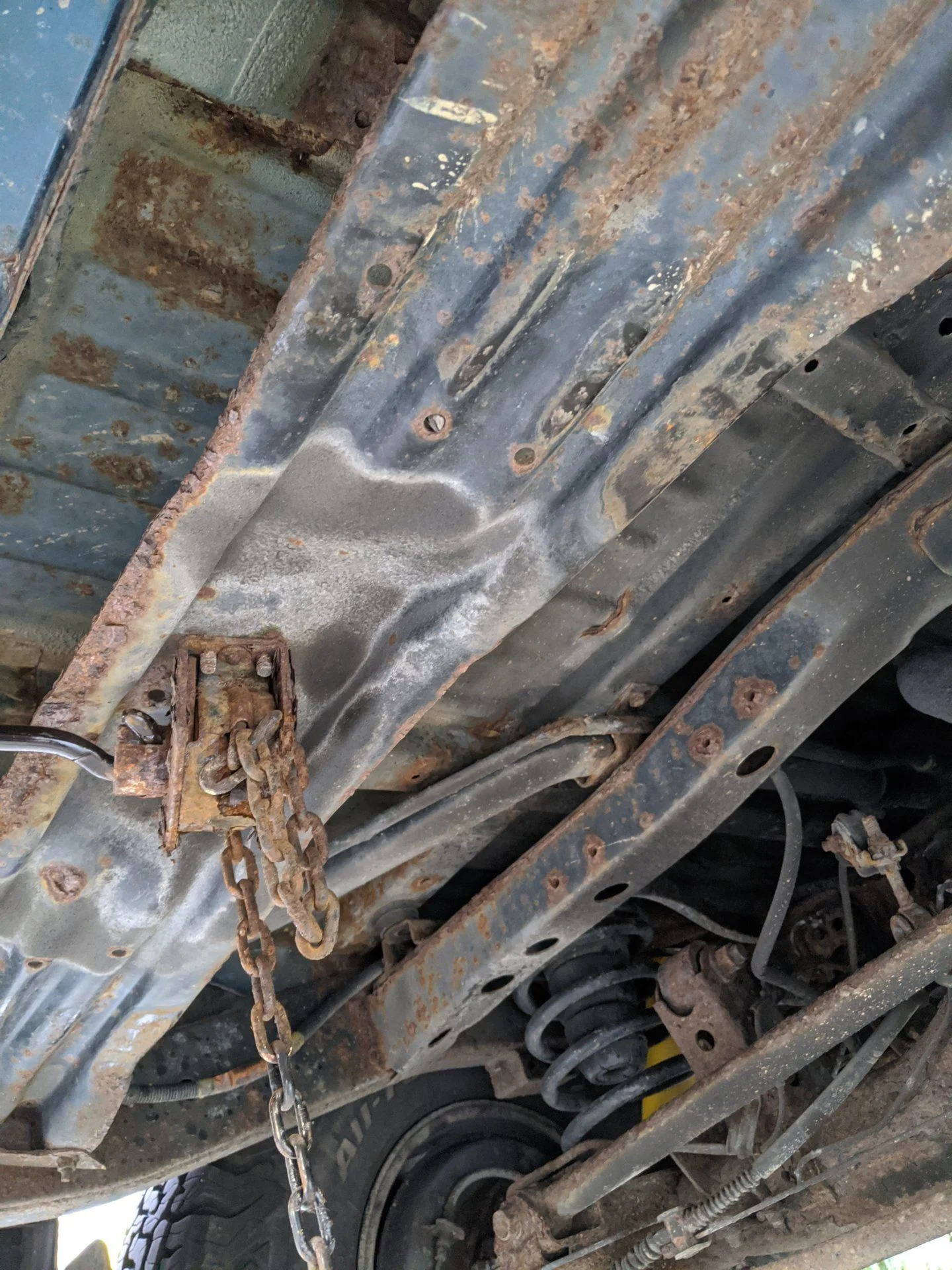

There's some speckling on the floor boards and I really want to try to keep this thing solid as long as possible.

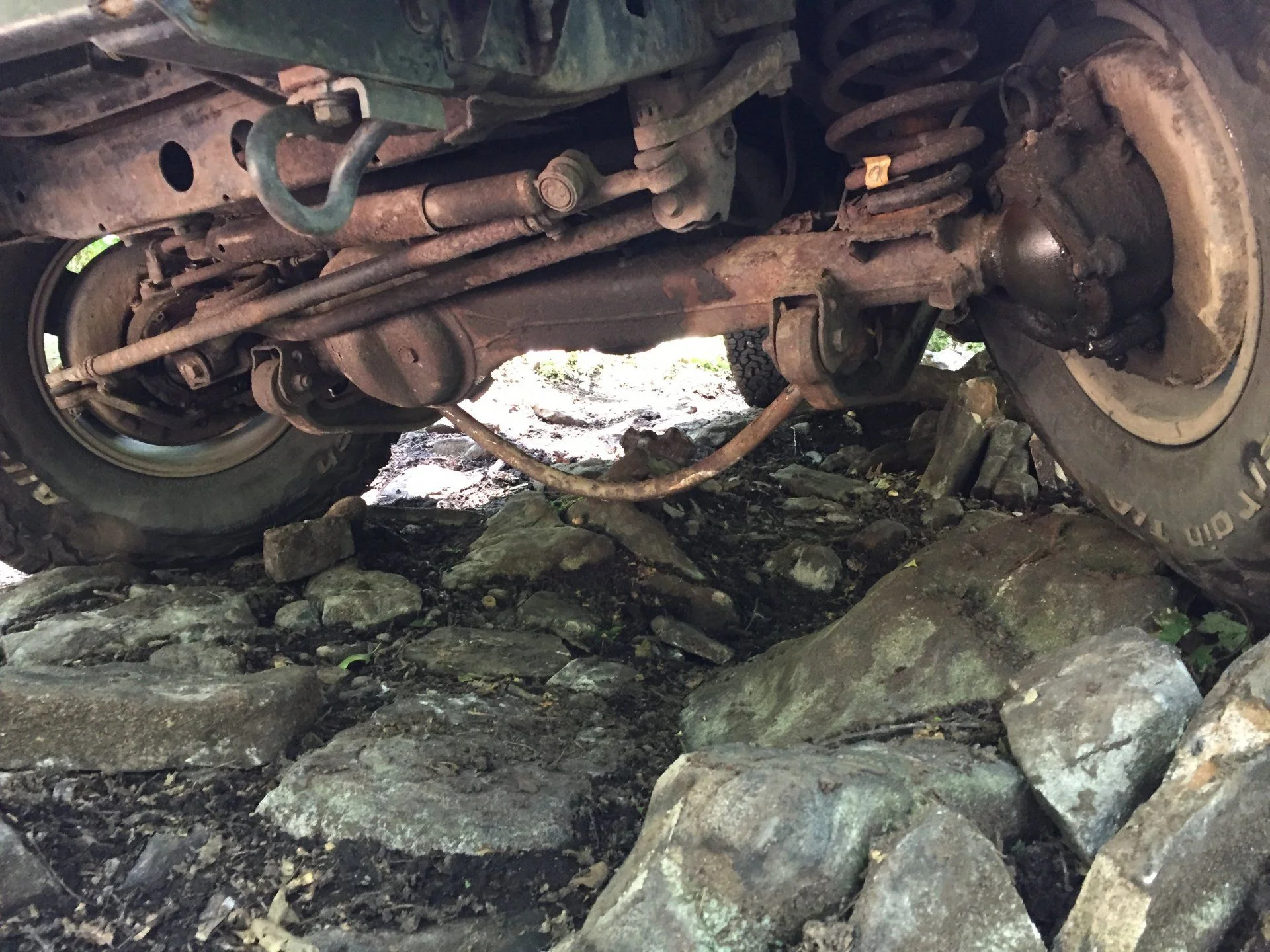

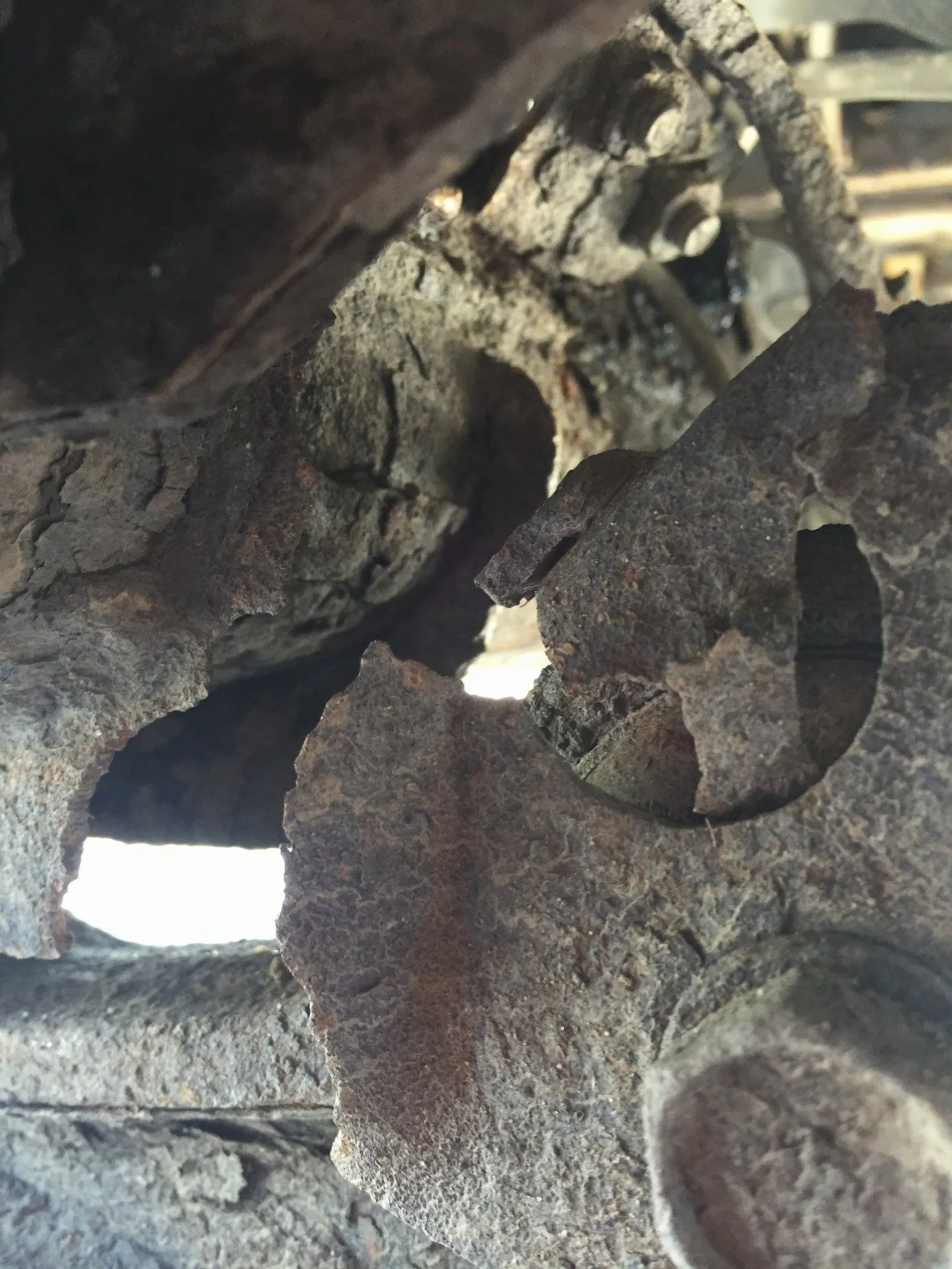

That axle looks CRUSTY! Might want to take a screwdriver and start poking around... before a good flex on a trail reveals the weak point.
X2!
Galva dip it? No idea on pricing but it will go inside the frame as well. Drawbacks may include and are not limited to. I doubt they will remove the body and everything and re install. Threaded holes will need drilled and re tapped. It will make welding a mofo.
I wheeled one of my 80's that had that much rust on the front axle. The rear lower control arm mounts decided they were no longer happy to be in a union with the axle housing. This happened at Anthracite, FAR from the lot, and on a difficult trail.
Not fun.
Not fun.
View attachment 2153304View attachment 2153305
Well, s***. I'll be crawling under my truck today at lunch with a screwdriver and poking aggressively on the axles. Happily, my front axle leaked (along with the ps cooler) so much that it was covered with oil when I first got it. The rear could be concerning.... Thanks for the heads up guys

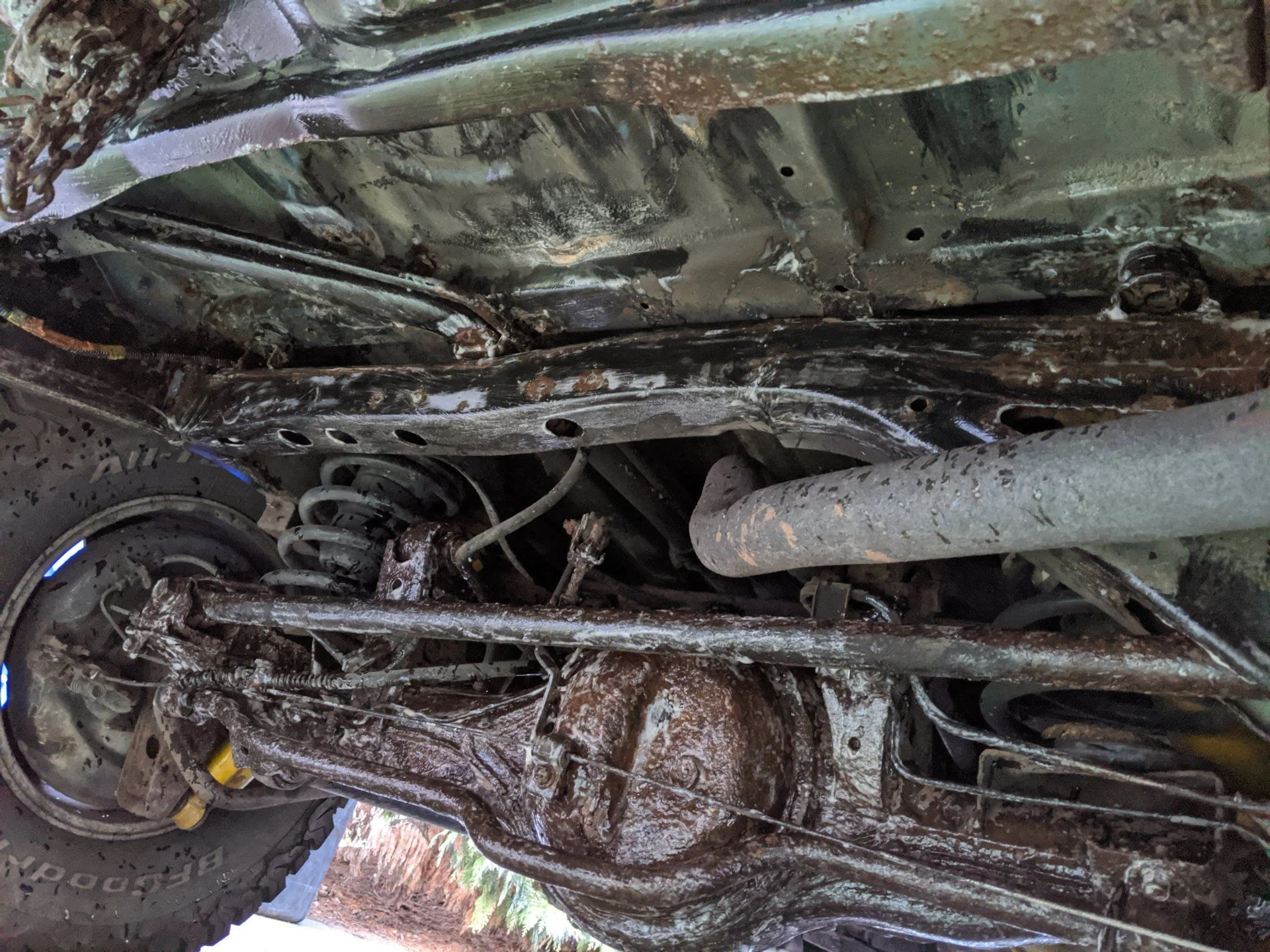

I do a complete Fluid Film treatment every October in my driveway using a pneumatic paint sprayer. She stays rust free.
Yes, it attracts dirt. Dirt can be cleaned with a power washer, and do you really care what the underside of your truck looks like as long as it's not rusty?
I ended up ordering WoolWax...same company as Fluid Film but slightly different product. I agree with @jonheld in that I'd rather have dirt and protection over rust. I bought a 5 gallon bucket and the sprayer they sell (includes gun, hoses, containers...). There is a thread floating in the 100 series area with a discount code I believe is still active. I did order my product in black just because.
Side note...I found fluid film in spray bomb form at AutoZone the other day. I started hitting the little rusty areas under my hood like bolts and brackets.
