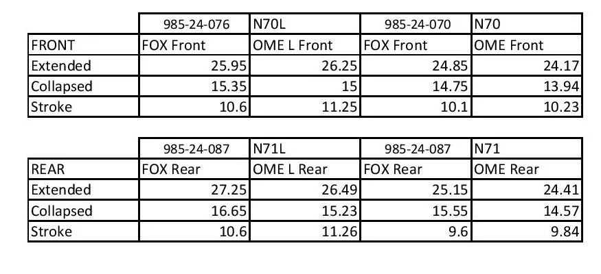

thanks for this " review " judging by your pics looks like the fronts are tad shorter than L and the rears bit longer..?
Without flexing the setup I don't want to say the rears aren't right on, honestly im a rookie. I will however try to flex it out when I find a place.
Is there a length difference between the front and rears or length difference between your Fox's and OME L's?
These lengths should be correct now but don't bet the farm on them.

"""""In retrospect the rears should probably be the shorter FOX for a 850J/863 setup as they are still longer than the OME L they replaced.""""""
Edit: I recant this statement as my original data was incorrect. the FOX rear shocks are really only .75 inches longer, not 2.25, But they still seem too long.
That's exactly what I was thinking.

Comparisons in length from OME and Fox specs:
Shock OME Nitro Sport FOX IFP 2.0
PN 60018 (Front) 985-24-070 Front
Extended 24.3" (617mm) 24.85
Compressed 14.1" (359mm) 14.75
So the Fox is a bit longer, more attention may need to be paid to bump stops (do you need BS extensions with a 2.5" lift?)

The rear FOX longer 087 shocks are just too long at compression. 1.5" longer than Ls. Also, I believe they would unseat the 863s and I didn't feel like addressing that. I have 33s so there's no reason to restrict my up travel. If you look at wheel travel going from sitting on your bumpstops down to fully extending your shocks, then I have a 16"-25.95" front stroke and around 16.25"-25.15" rear travel. My shocks sit right in the middle at 21" on the truck at ride height.

I don't get it. Up top in that chart there are two different FOX front shock numbers, with two different length and compression figures. Then there is a rear shock section, with identical PN's for the FOX shocks, yet two different lengths for compression and rebound. I must be missing something.

@superjuice gives the part numbers for us on the previous page of this thread. i was confused by all of this initially as well, but for autoanything, you can just search by part number. I just put a set of the shorter (073's) on my cruiser this week. Here's his part # breakdown, along with lift height info:
"Well I just placed my order, picked up the longer ones. $416 total shipped from auto anything (coupon feb20) but you have to search for them as a 2000 landcruiser.
Part Number from Fox's website for a 89-97 land cruiser.
Toyota Land Cruiser 80 Series 4WD 1997-1989 Front 1-2.5" 985-24-070
Toyota Land Cruiser 80 Series 4WD 1997-1989 Front 3-4" 985-24-076
Toyota Land Cruiser 80 Series 4WD 1997-1989 Rear 1.5-2.5" 985-24-073
Toyota Land Cruiser 80 Series 4WD 1997-1989 Rear 3-5" 985-24-087"

Fox has the lengths w/part numbers on their site. For MAXIMUM use of the length of shocks, you need to know your MAXIMUM compressed & extended length of your springs. Then you can decide if you want bump-stops to keep tires from rubbing. Generally, w/2.5"+ lift, 33's won't rub much @ all, 35's enough for a small (~1") bump, 37's enough for medium/large (~2"+) bump. YMMV.
