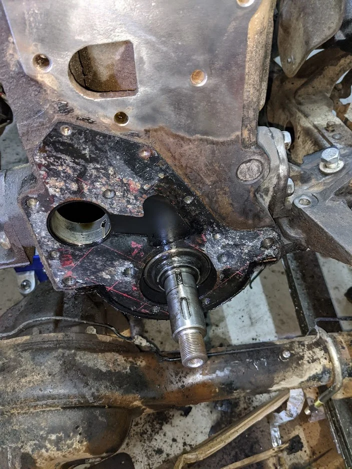

Also track which push rod and lifter came from which hole. It is important that they all go back in their original place.
You don’t need to remove the crank gear; the plate has a hole in it for the gear to pass through.
You ABSOLUTELY DO need to turn the crank/ flywheel to top dead center so the alignment marks on the crank and cam synch BEFORE YOU PULL THE CAM.
Will it be straightforward to re-seal the plate with the gear still on the crank? Now that I look closer it seems it's pretty doable.
TDC for the crank is already set. Got that part!!

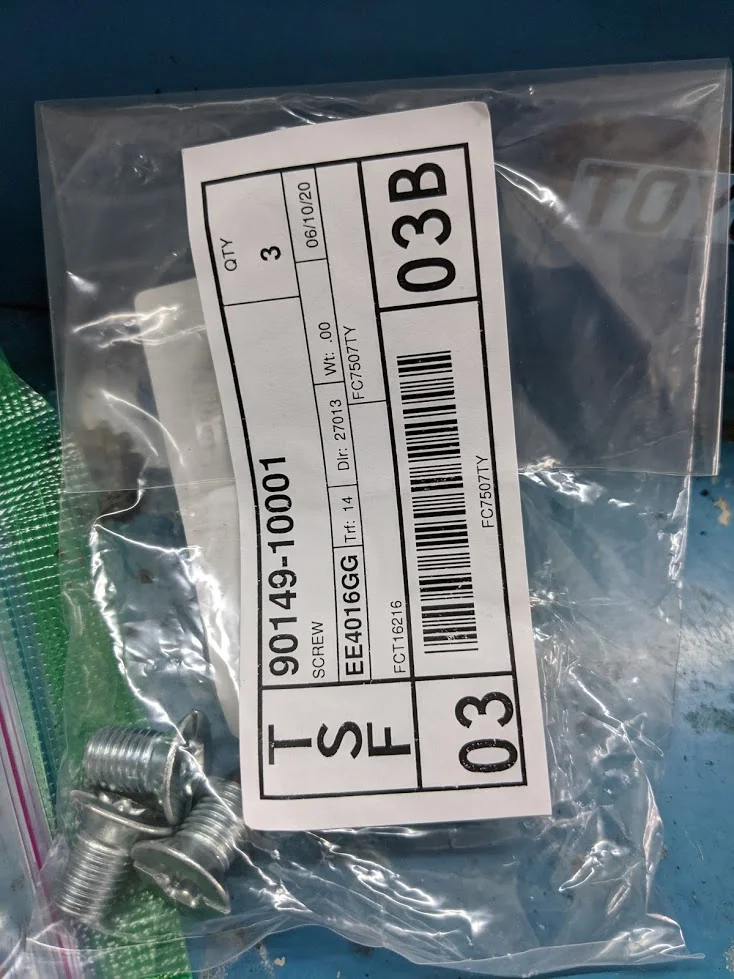

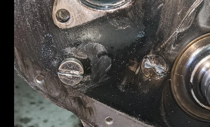

Also while you're in there be ready to remove these which could be a real PITA. Be ready to replace with the factory replacement hex bolts instead to avoid this next time.
They might get boogered up like this
A couple more pics for your reference
In four decades of wrenching on cruisers I have never seen those screws before Aaron.
I learned something new today!😊
I'll look back and see if I can see what the number for them was, but I'm pretty sure they were oem replacement for those flat head screws.

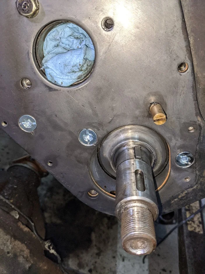

Hey @airon23 or @65swb45 or @Michael B or anyone else...
Do you do the OEM gasket sealant on both sides of the gasket for the end plate? Also for the timing cover cork gasket, right?
I read @Poser's thread in the FAQ for the side cover and oil pan gaskets, so know where to use the sealant there.
Would love more thoughts/input on best practices for preventing future leaks.
I usually apply sealant to both sides of a gasket. But I have never worked in that particular area of a 2F before.

So I went with a light application of OEM sealant on both sides. Really don't want to be this far into the 40's engine again anytime soon.

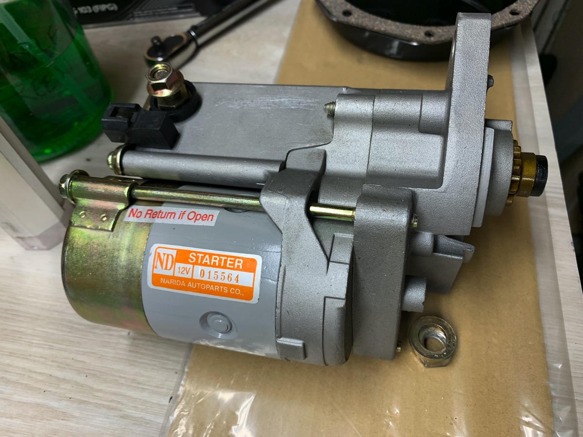

In the "While I'm in here" department I've upgraded to a gear reduction starter. I bought this a long time ago and just never got around to making the swap.

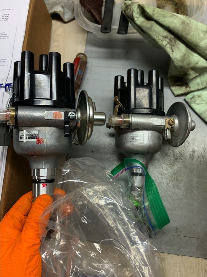

Contemplating popping in a new distributor. I have a new one in the box on my shelf of "just in case" parts. Nothing wrong with the old one. The new one is just so shiny!!

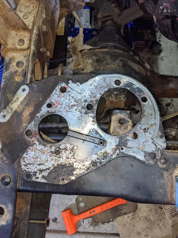

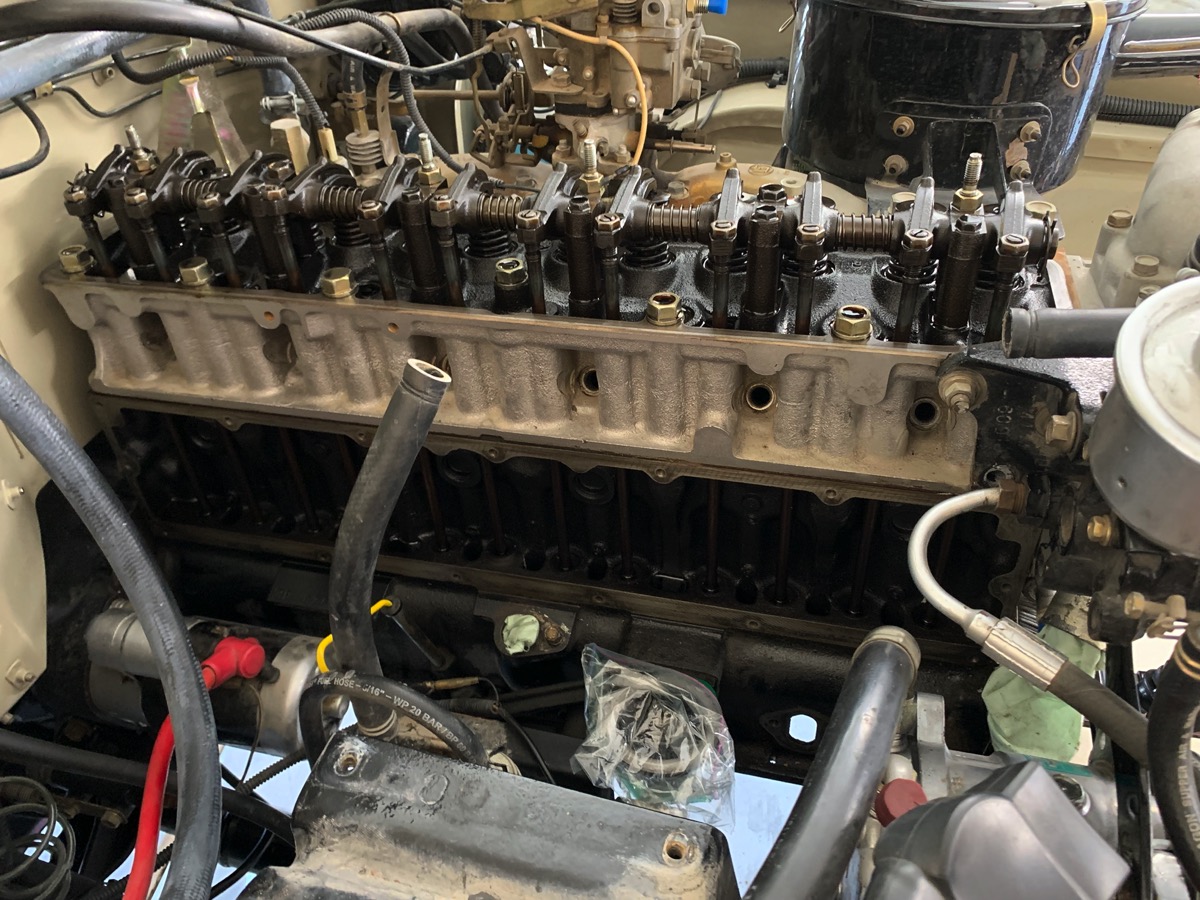

Here it is all opened up... side cover came off and was cleaned up and repainted. All gasket/seal surfaces were cleaned and degreased. While it was all opened up I did a lot of cleaning.

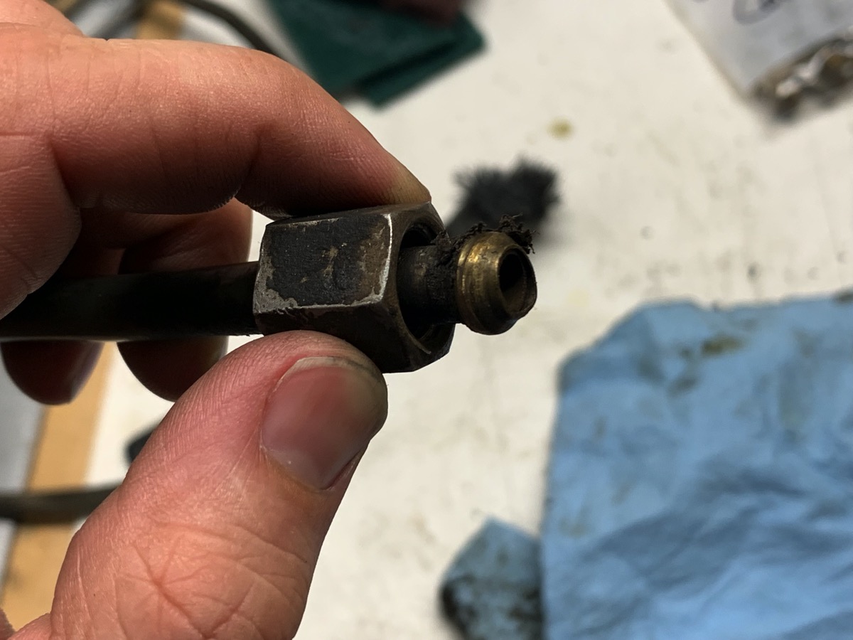

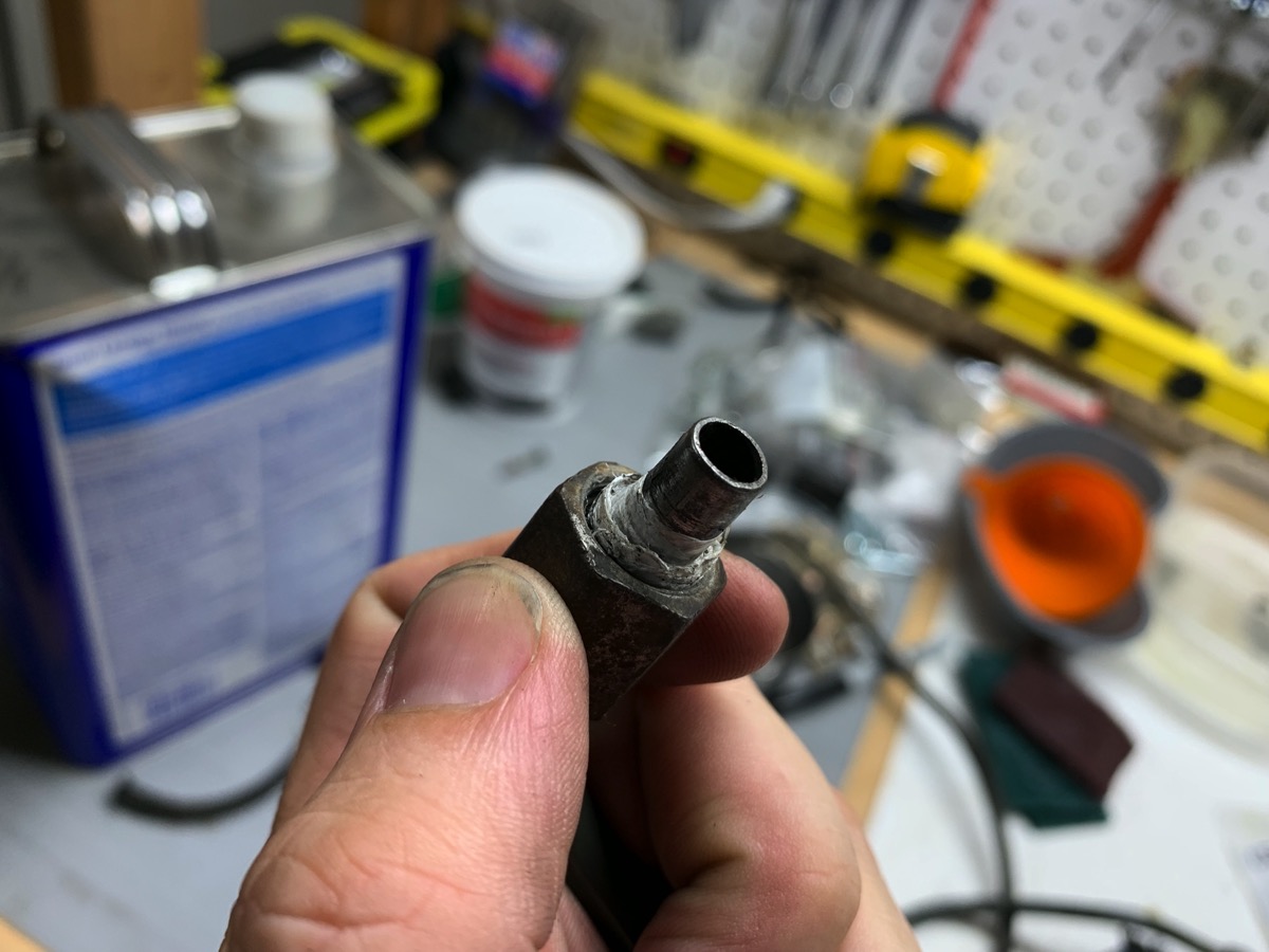

Detaching the fuel line from carb to fuel pump revealed this...

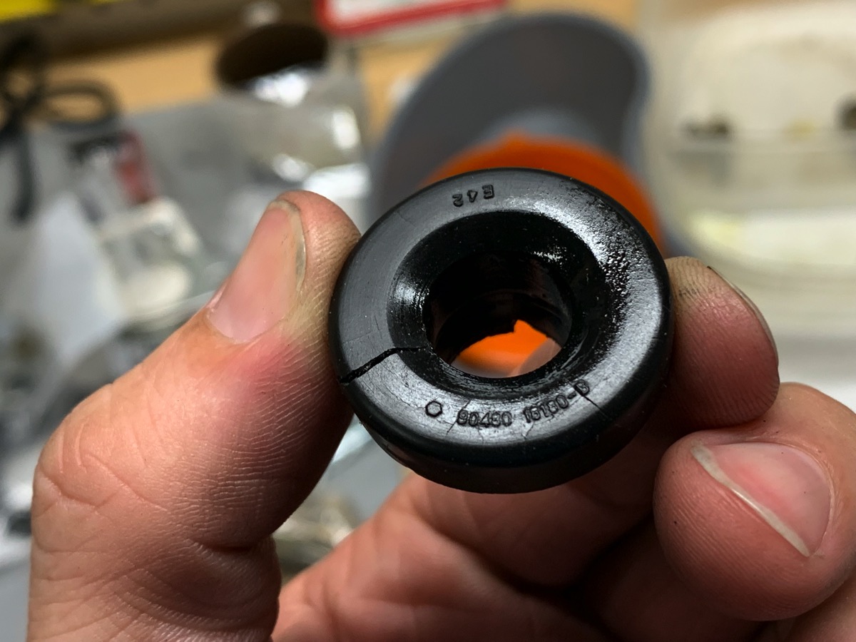

PCV grommet was in bad shape.

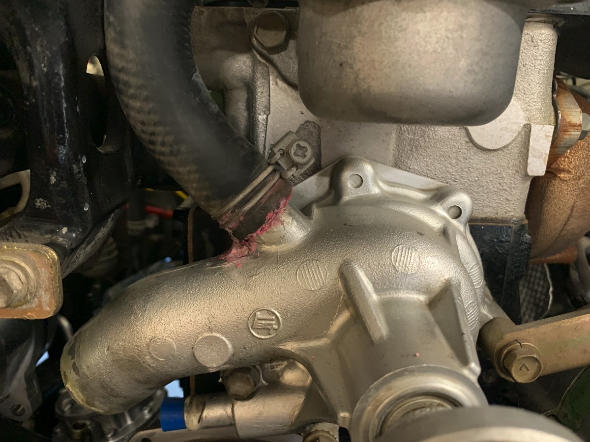

One coolant line obviously in need of replacement.

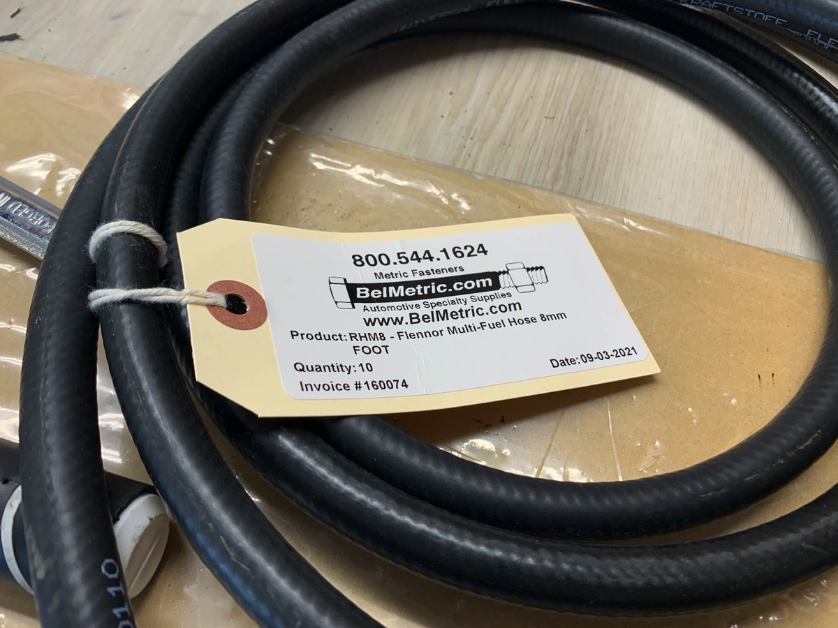

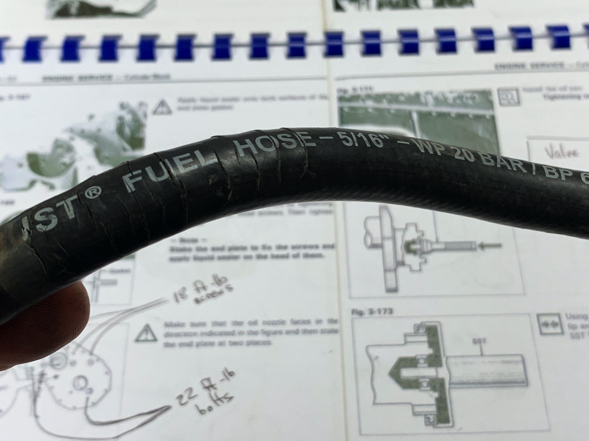

Fuel hose to/from the filter and pump was also in bad shape.

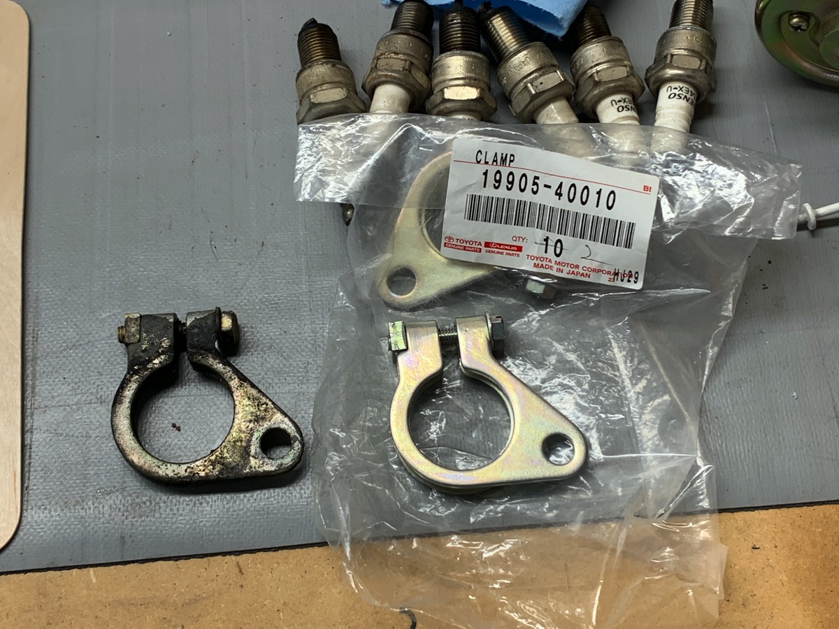

New clamp for the distributor.

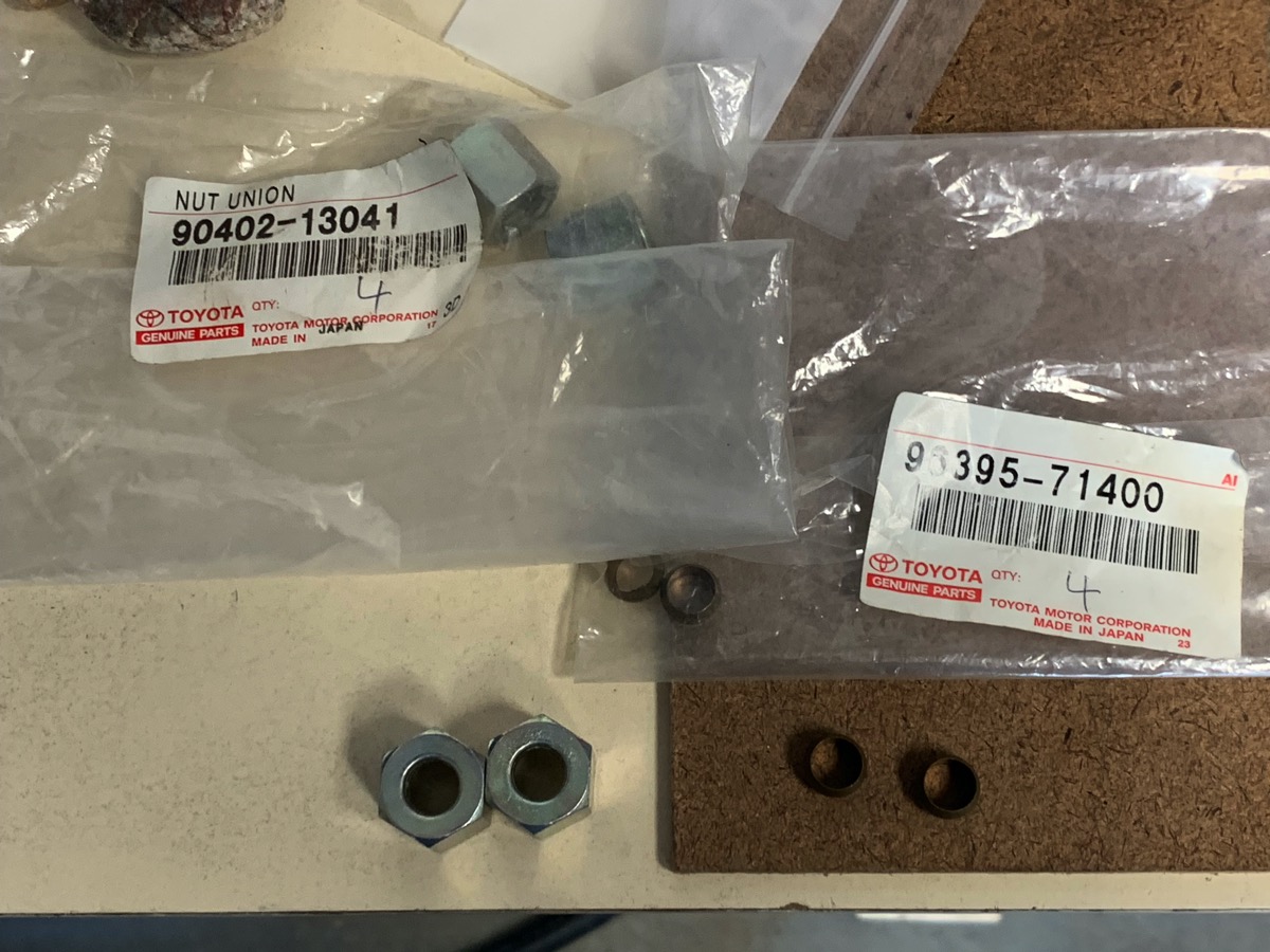

New nuts/unions for the fuel line.

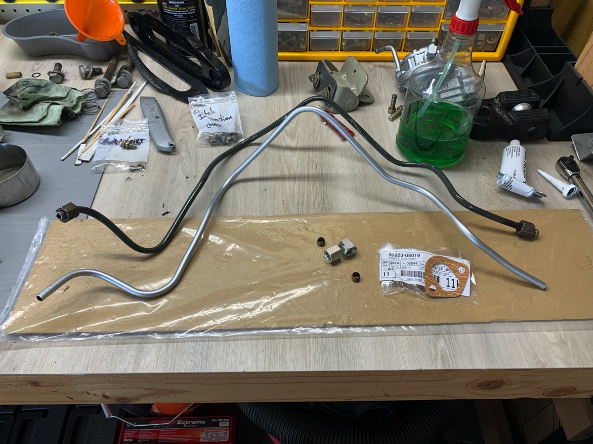

I went ahead and bent a new fuel supply line from the pump to the carb. I use the existing one, plus trial-and-error, to get the right fit.
Grabbed new fuel hose from Belmetric.

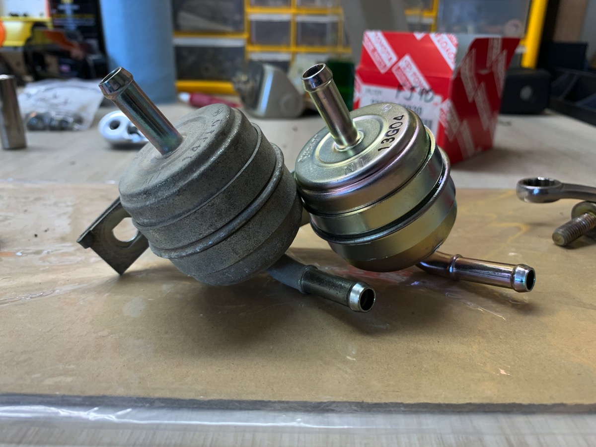

And a new OEM fuel filter.
New gaskets for the side cover, oil pan, valve cover, and timing cover as well as block off plate.

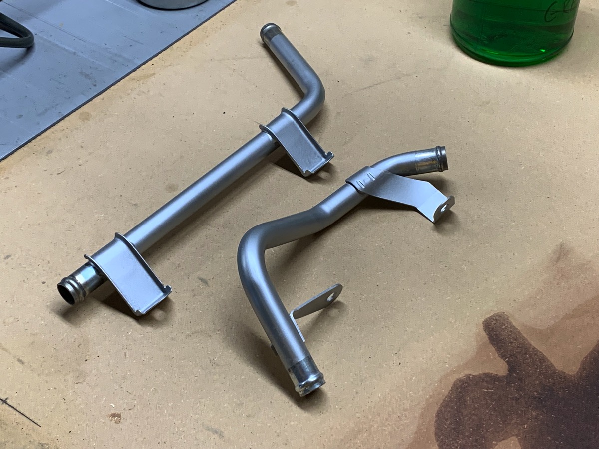

I cleaned up and painted two of the coolant pipes.

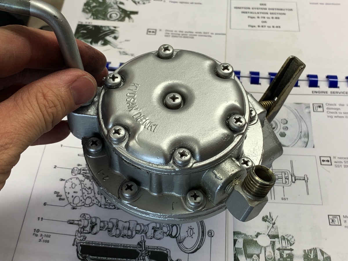

I cleaned up and painted the fuel pump.

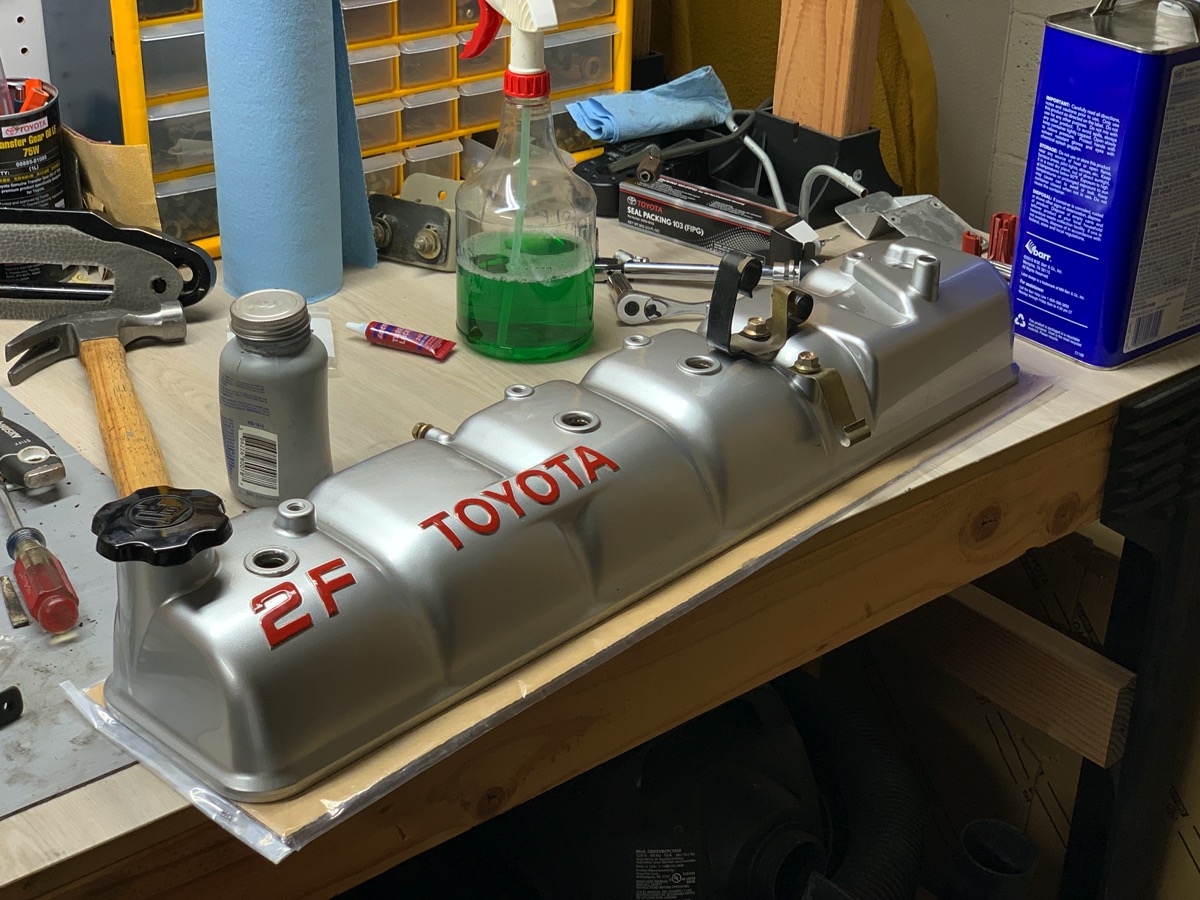

I polished up the valve cover and added overland metric hardware on the brackets.
