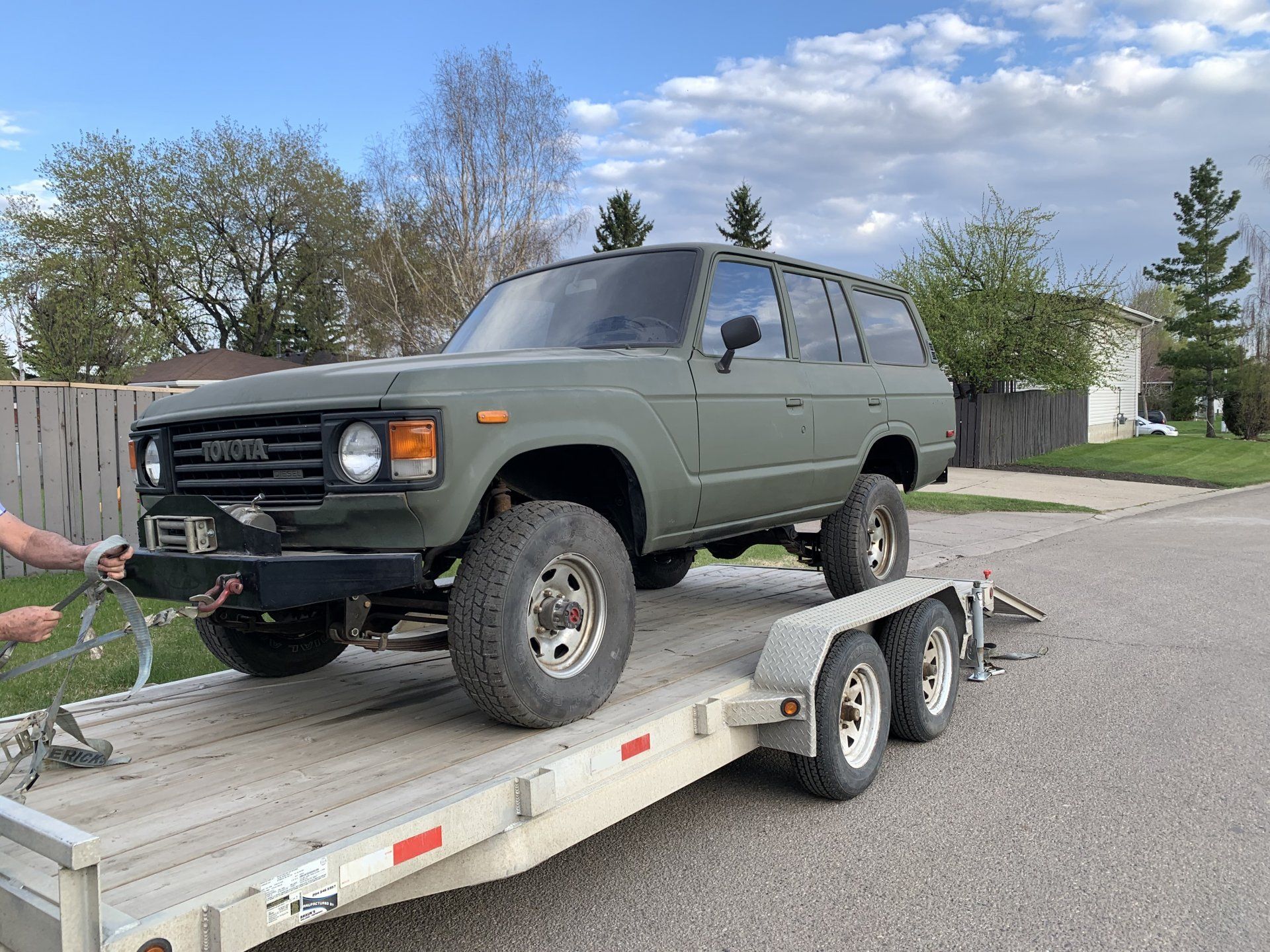

Well, I went for it!
I’m now the proud owner of an ‘83 BJ60 in olive green - if you see me around give a wave!
I did hire my mechanic to drive up and take a look at it first and had him trailer it home too.
He actually let me store it at his shop and work on it there to get it going. I spent a day getting the surface rust and some of the messy rock guard off the undercarriage - the frame actually looks excellent!
I degreased the whole engine - looking to see if we have any leaks that are an issue or just POs who never cleaned her up.
Changed the belts (or actually belt - having trouble finding the 50” power steering belt)
Reinstalled the front driveshaft (not sure why the PO removed it - 4wd works great)
Bled the brakes and clutch.
Refilled the coolant.
Fixed some of the POs wiring - now all that stuff works except I have no speakers and possibly a non functioning radio (have to see yet on that)
And at this point she runs great!

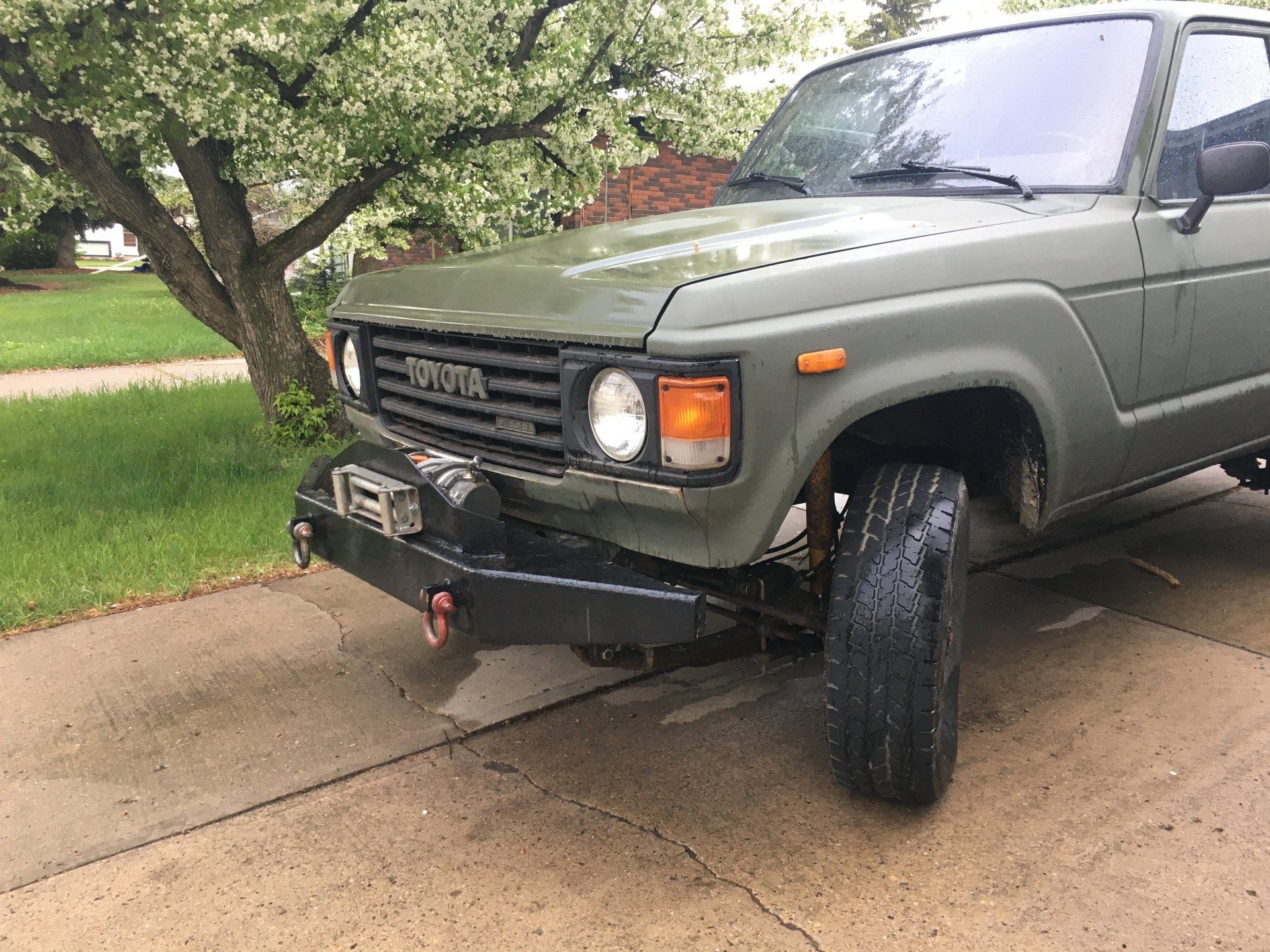

is that flat paint?
Yes it is.
Interesting paint history on this one.
Original colour code is Copper Brown metallic. (474)
At some point (I believe in the early 2000s) a PO painted it a really nice sparkle forest green. Then when the PO before me did the rust cut out and replace he painted it with this olive matte green. I must say not my favourite and if I keep it for a long time I’ll probably do a proper paint job.
