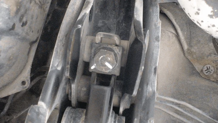

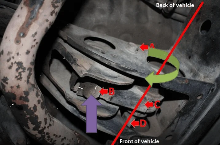

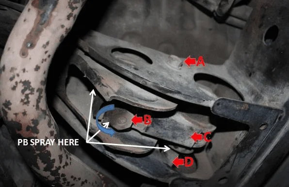

Pics. Better to just pull the PDF - save it to print or reference while on the job

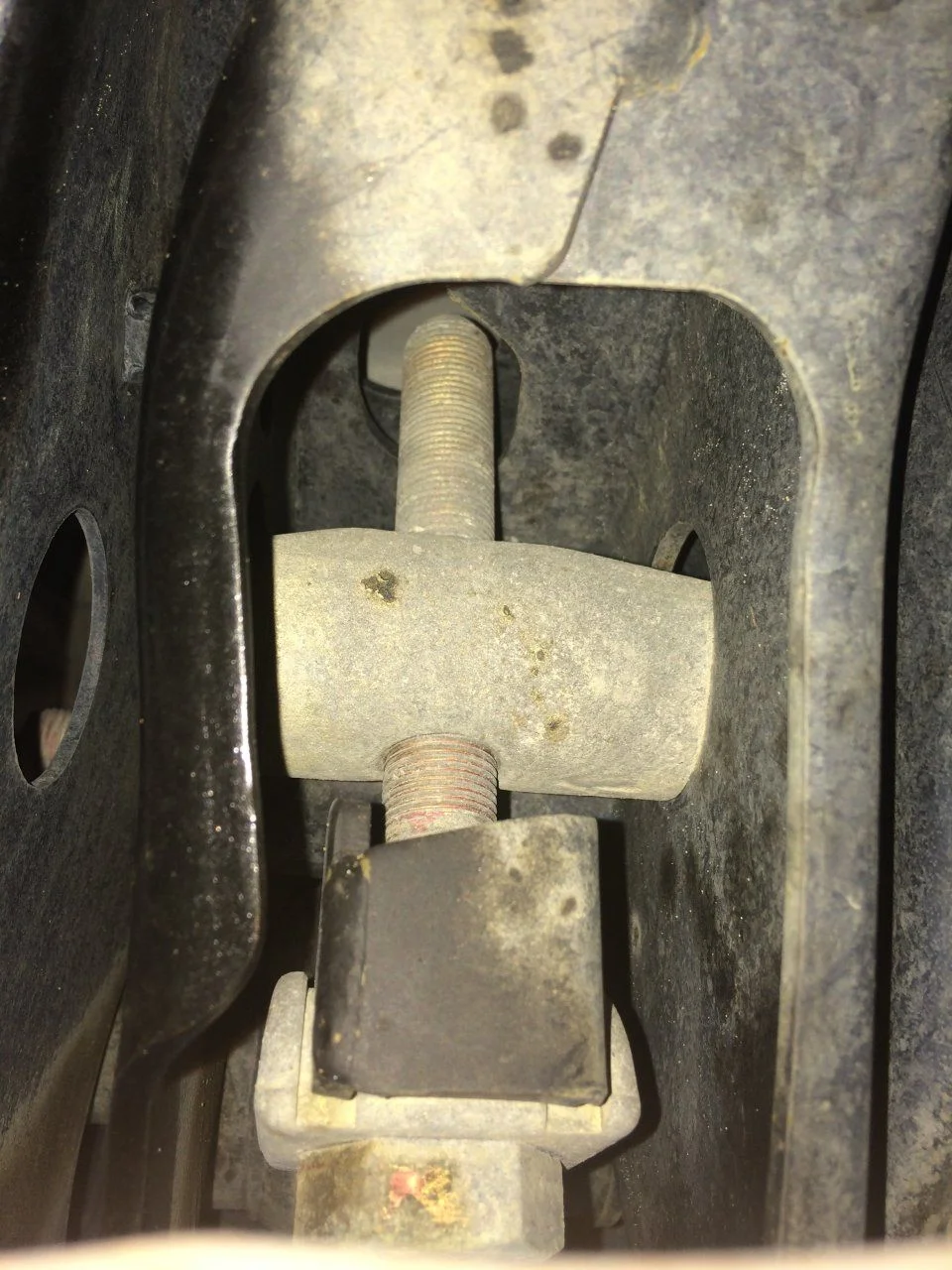

It can require quite a bit of effort for rust belt trucks. I soaked my nuts in PB (haha) for a few days leading up to it and it was still tough to turn mine with a breaker bar. I could do it with one hand and brace myself with the other but it wasn't a cake walk like some of you are lucky enough to encounter. Fresh bolts are much easier to turn.
Also, just to share my experience, I did not have to touch my passenger side bolt at all. For what ever reason my driver side was sagging really bad so it took probably 8 turns to get it even with PS. Still have some thread left if I decide I want to go to complete level but as of now I like the way it feels with the front a little lower than the rear.
Heck, even after a PB spray and using a breaker bar, I couldn't get the bolt on the driver's side to turn; had to borrow someone's impact gun to finish the job. For whatever reason, the passenger side bolt turned fairly easily, I only needed the breaker bar to budge it, and then finished the job off with a ratchet. I'm not sure where this anti-impact school of thought is coming from; as long as you mark the bolts and go slowly and stop to check how your bolt is turning every few seconds, you'll be fine.
I needed a bigger breaker lever on the driver's side than the passenger side. it was aproaching exhausting trying to compensate for the bumper and winch, but I got it done, sort of, with levers and muscles. (I maxed out my adjustment and will need to reindex my tbars to finish the job.)
As for air impact guns, I don't know if you can over torque these adjustment bolts? That is, once they are fully tightened, can you damage anything by torquing on them with a relentless air tool?
Thanks for all the info... my low buck LC had a bit of a gangster lean drivers side measured from top of rim lip to bottom edge of fender was 7" passenger side was 9.50" the pass side adjustment screw was about midway on it's travel while the drivers side was cranked tight... going from memory from reading these posts I re-indexed the drivers side bar over 1/4" I think it was 3 teeth... was all I could do to get the bolt back in the mount with the adjusting bolt backed out all I dared... once bolted up it took about 30 cranks on the bolt to get the front of the truck leveled out at about 9.75" on each side ... LOOKS so much better... so nice when someone else has shared their wisdom from experience

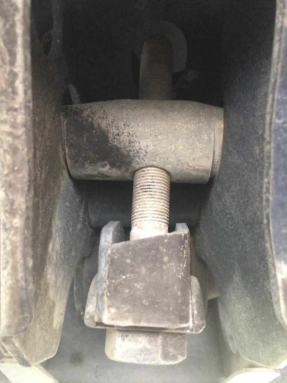

Got my springs and looking to get the TB's cranked. With the way my bolts look. Will i be able to adjust them without a re-index?
Re-index is in your future ....
Not much left on that one adjuster- (which is maybe your driver side?)
