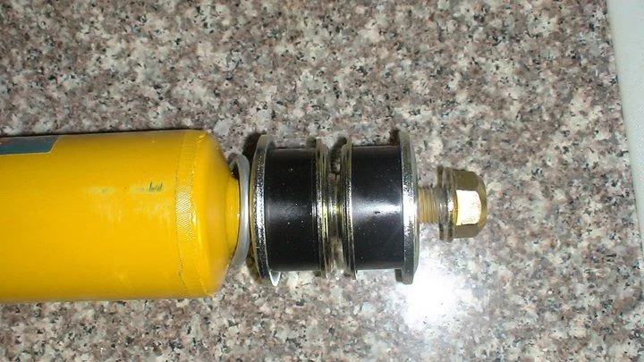

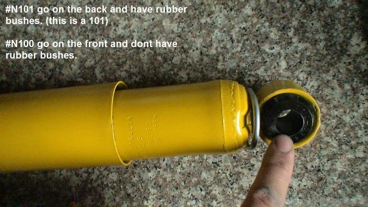

Prep all your suspension bits, no one has ever bothered to post this so this is what the bushing setup should look like on the top of the shock (I suppose you can just copy the shock as you remove it from the vehicle). Also don't be afraid of removing that steel bar compressing the shock, its not going to spring open and take your hand off. just twits one side of the shock one way and the other side the other way and it will pop off. You can put it back on buy just pushing the shock down onto the ground until it has compressed enough.
full
Then you also need to note that the N101 shock goes on the back and has a rubber bushing you have to push into place with a vice, and the N100 goes in the front and has no rubber bushing.

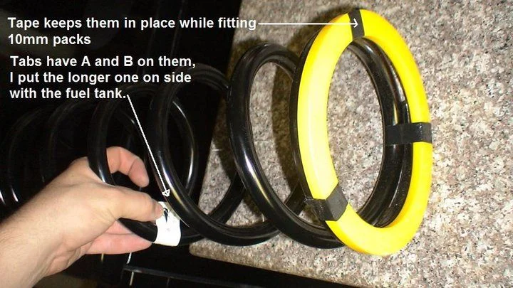

I have taped the coil pack to the top of the coil so I don’t have to fiddle around with it while I am trying to put it in.
full
I also got very confused about A and B coils and then where they tagged for use in a LHD or a RHD country so I called a mate and he said “just put the longer one in the side with the gas tank” (so I did)

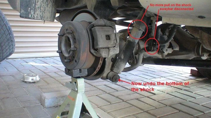

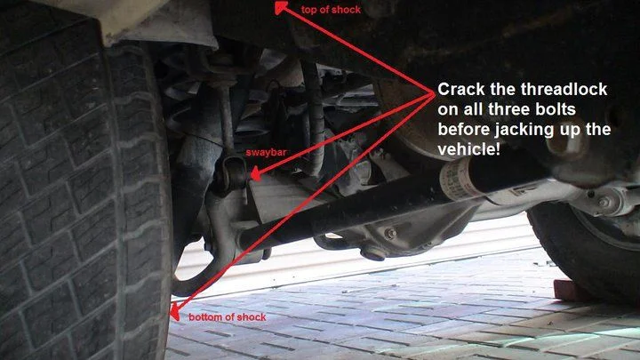

Before you jack up the vehicle, loosen all the bolts that are going to give you a headache, if your spare tyre is in I suggest you remove it (use the opportunity to check it for damage and its pressure). You can use the strap wrench on the top of the shock and just cable tie the 22mm spanner into place. You achieve the same thing, it’s just easier to get some weight behind the strap wrench.
You will also want to completely remove the bolt on the sway bar (the second you start to jack the car up there will be pressure on the joint that will make life difficult. I also loosened the bottom of the shock.
full

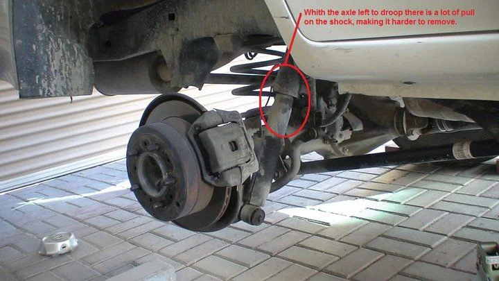

STEP 3
Jack up the car from the chassis (not the axle) and remove the wheel. You will see that the shock is at its full length and its going to be difficult to remove it this way, so put an axle stand under the axle and lower the vehicle back down until the shock is in a neutral position.
full
full

Remove the lower shock bolt and try to pull the shock off its mounting, it
probably won’t come off.

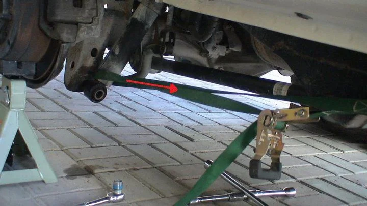

There is a pretty good theory to moving things, if you can “leaver it or jack it, strap it” (don’t read into that) so if it doesn’t come off grab a ratchet strap and use that to get it off, if you don’t have a ratchet strap you can tie a loop of rope, put a spanner in the middle and twist the spanner.

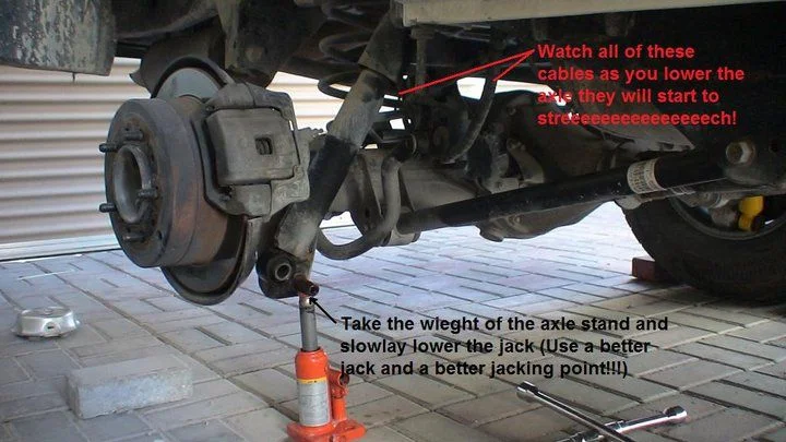

Put a jack under the axle (please use a better jack and jack point than the one I chose) and lift the axle of the jack stand. Remove the jack stand and slowly
lower the axle on the jack…. Make sure you are watching all the cables and wires to make sure you’re not stretching anything.
full
You should now have enough space to pull out the spring, so go ahead and do that.

on step 5, there is a bracket which holds the brake line in the center of the axel at the frame. remove the bolt to free the bracket and you now have extra slack in the brake line to allow the axel to swing freely. I did both left and right at the same time with the frame up on stands so my axle was lower to start with than your method. another reminder: lock the center and chock the front wheels; the e-brake is only on the rear and an open center will defeat the park lock on the trans.
