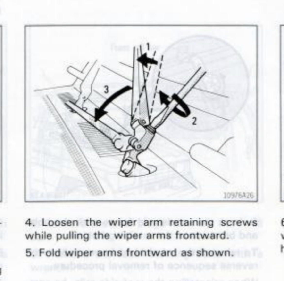

What’s this screw do, circled in red?
It’s a lot easier to unscrew if you raise the arm off the glass. Reduces the tension.
the knurled knob has a clip to stop it from falling out so turn until it’s free spinning.

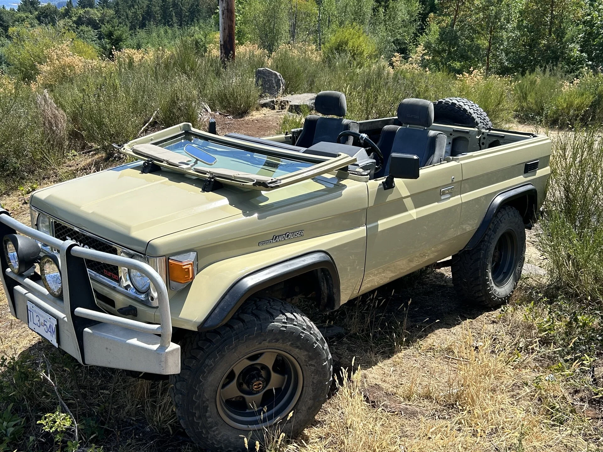

Cool part is when you fold the arm down and then fold the windshield over the tension
on the wiper arm keeps it firmly pressed to the glass so the wiper arm never hits the
hood. Mr Toyota is a genius. :)
