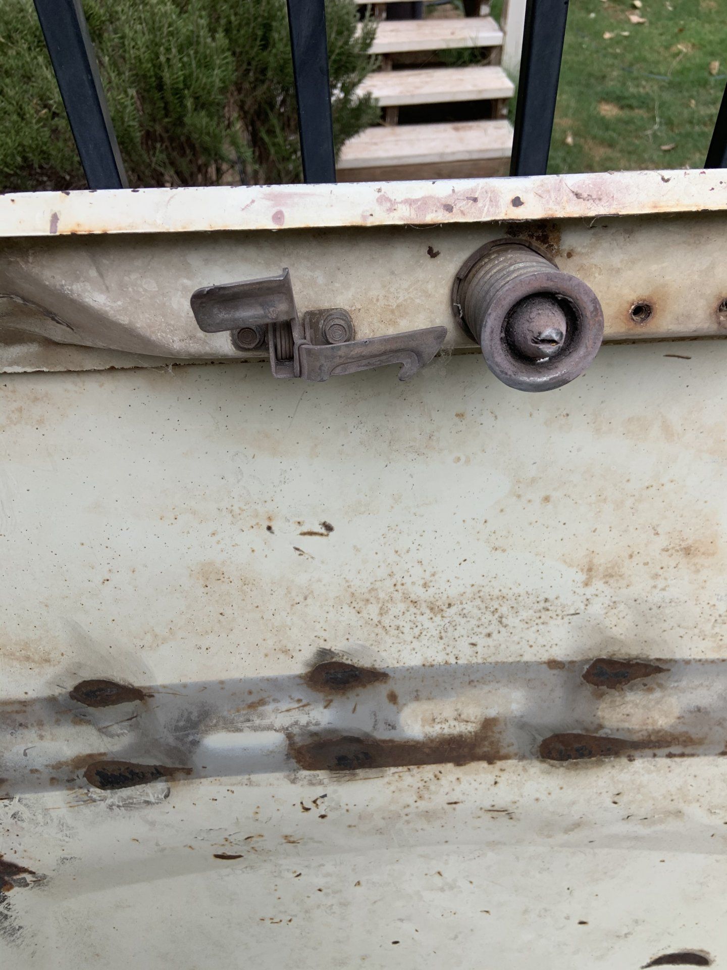

So the hood on my 55 flew open on a PO long before it came into my possession and folded across the middle. The entire time I’ve had it, I’ve never had to release a safety latch to open the hood, just the release in the cab, and lift the hood. I’d always figured the safety latch got damaged or removed at some time around when it flew open.
It occurred to me that I could snag the safety latch/hook from the early model hood that I got back in 2019. So I removed it and proceeded to dig my hood out of its storage spot and see if the parts latch will bolt up. Funny thing is, there IS a safety latch there, but it’s bent. WTF? How..?
Glitch in the Matrix moment...

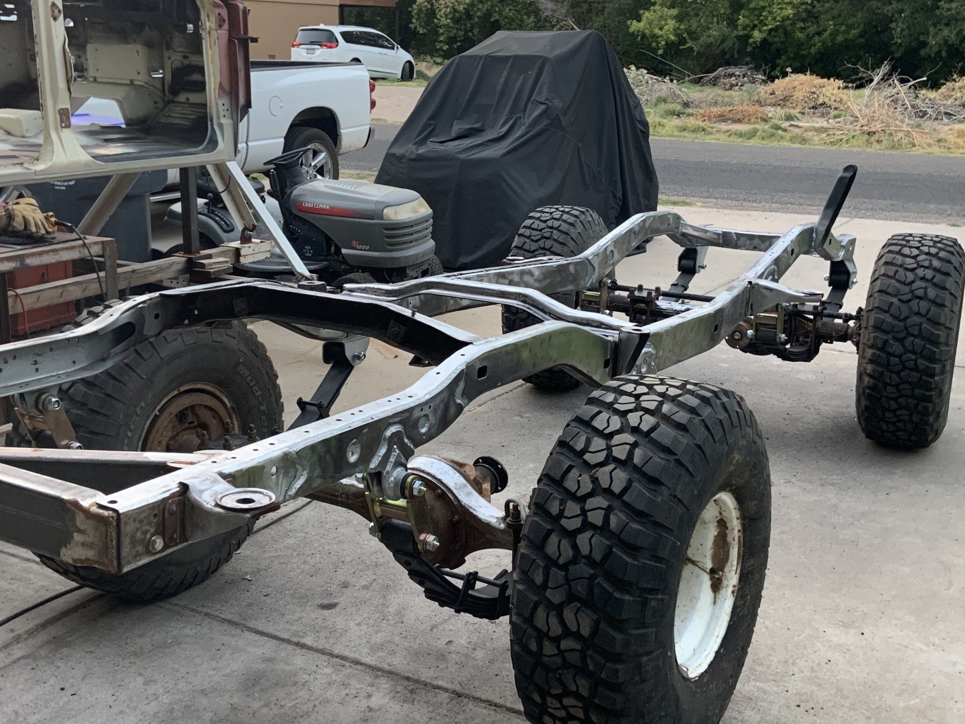

Got some more stripper discs off of Amazon and removed most of the remaining paint on the frame.
Had one of these hardware store standard issue 3M stripper discs sitting in my tool box since who knows when. They advertise their use with a drill, which isn’t impressive. I chucked it into my high HP pneumatic die-grinder and it became a hero. So I picked up a couple more.

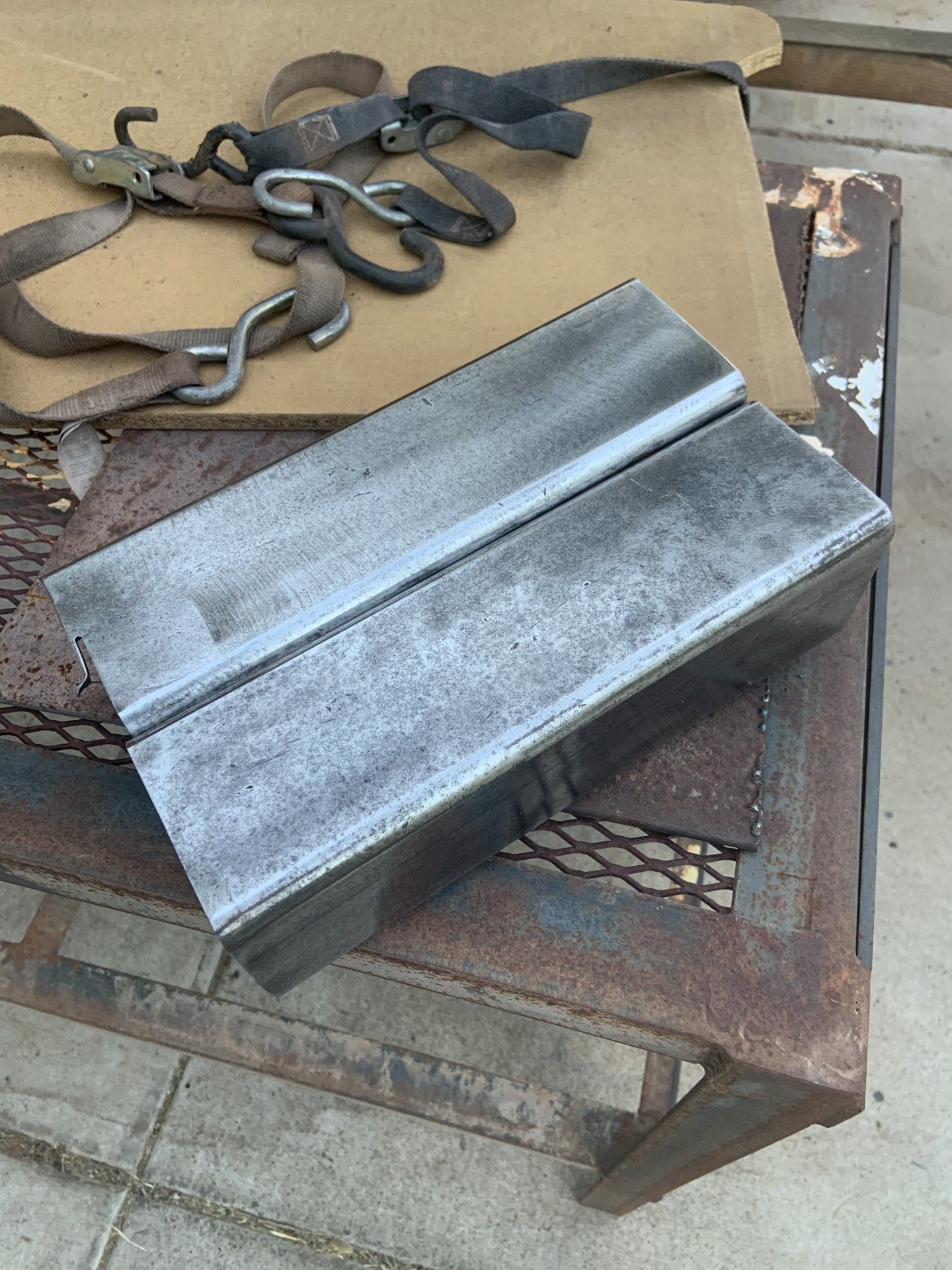

Not long after I finished my clone version of Scrappy’s rear x-member, I had an idea to alter it a bit, and then finally decided to do it since it’s gonna be one of the first pieces to get the paint. The new pieces were made out of 3-1/2”x1/4” square tubing.
