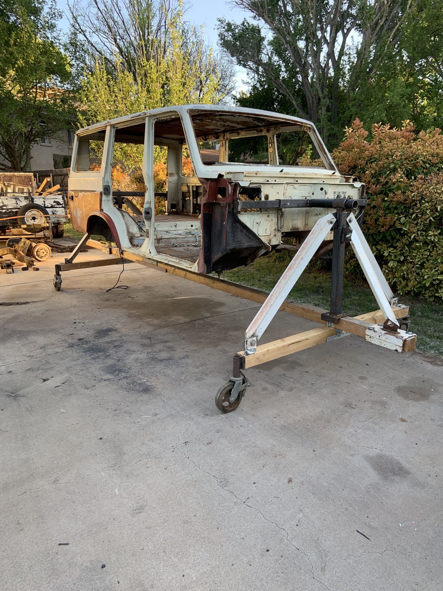

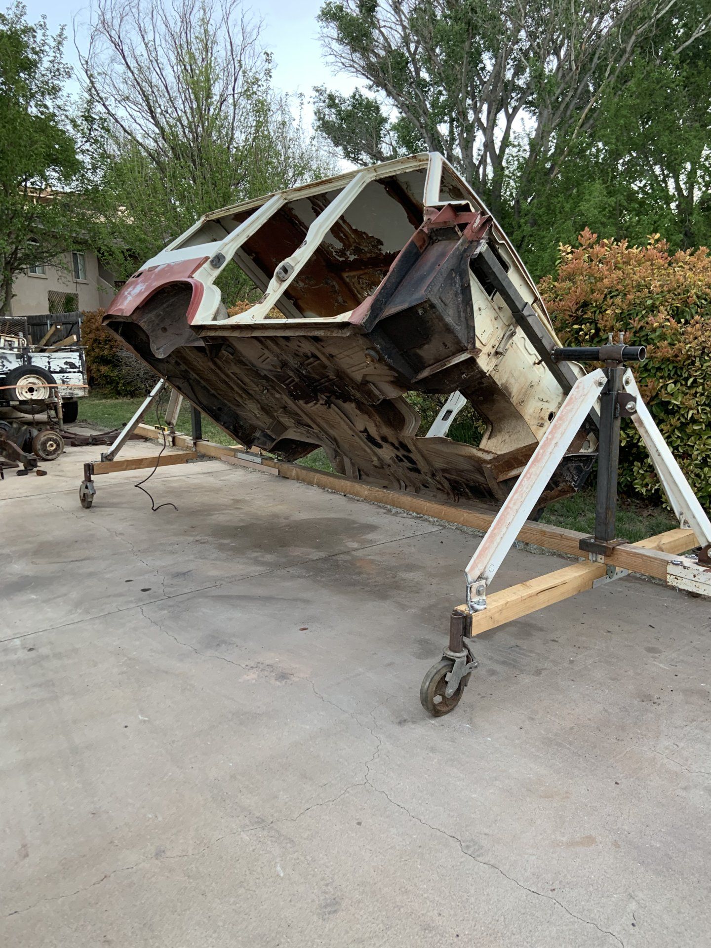

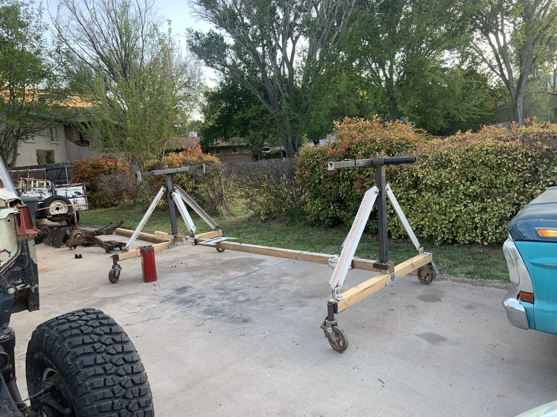

We have lift-off!!
Unfortunately, Rickety Spit IS too short🙄
Have to get a 16’ 4x4 and adjust to length, which will be a piece of cake. The setup will be plenty strong enough though, and is no longer a question in my mind.
Still call that a win!

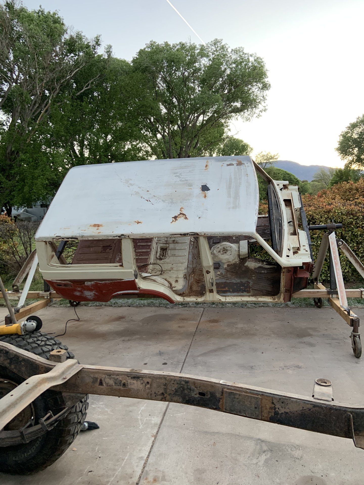

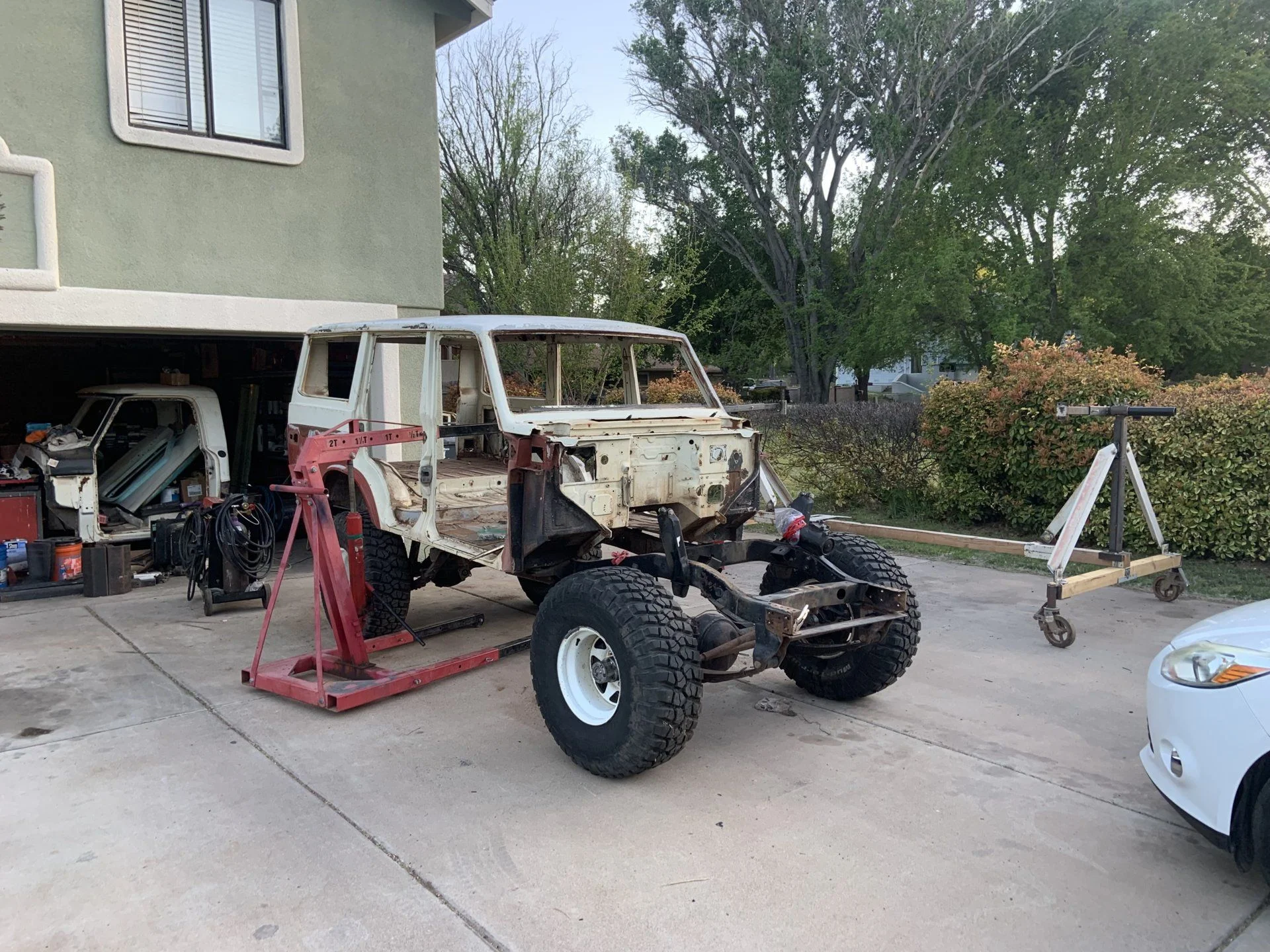

Worked on The Rickety Spit all weekend. God I hope this thing works 🙏
I’m a little concerned it might be too short lengthwise at 12’. Gonna find out here pretty soon. Ran out of daylight and proper rigging to lift off with the cherry pickers.

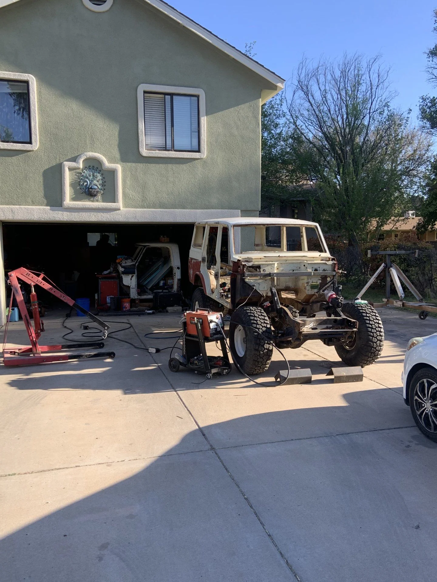

Also put the ends on my new 30’ 220v extension cord. Now I can wheel my welder way out in the driveway 👍💥👍
Oh this is awesome! My :princess: would be $hittin' kittens if I did that in our driveway...
