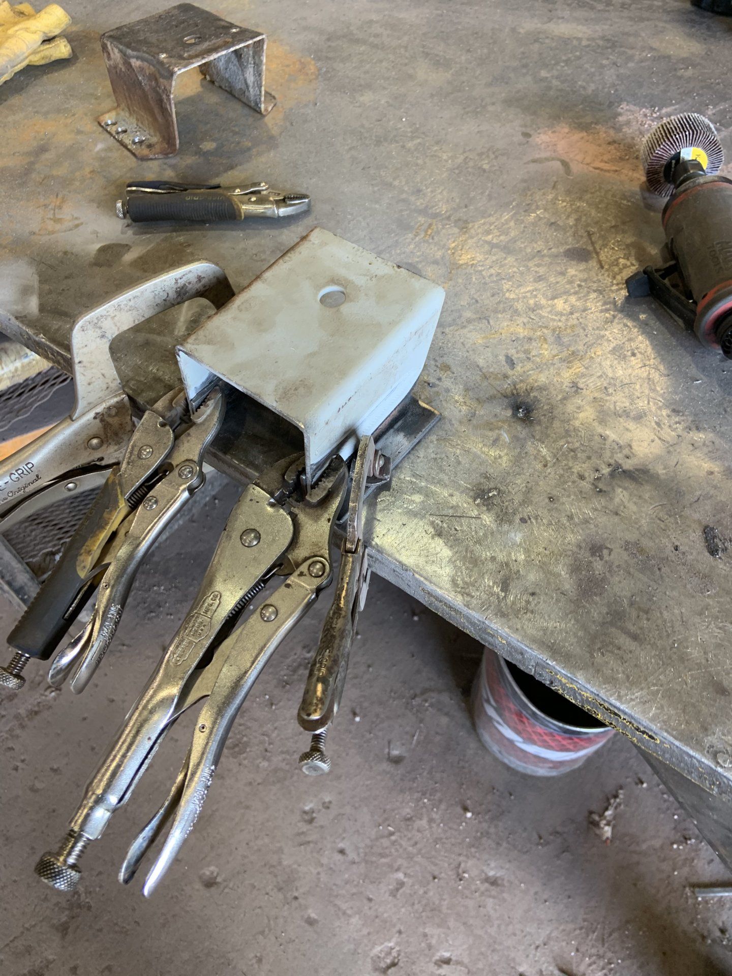

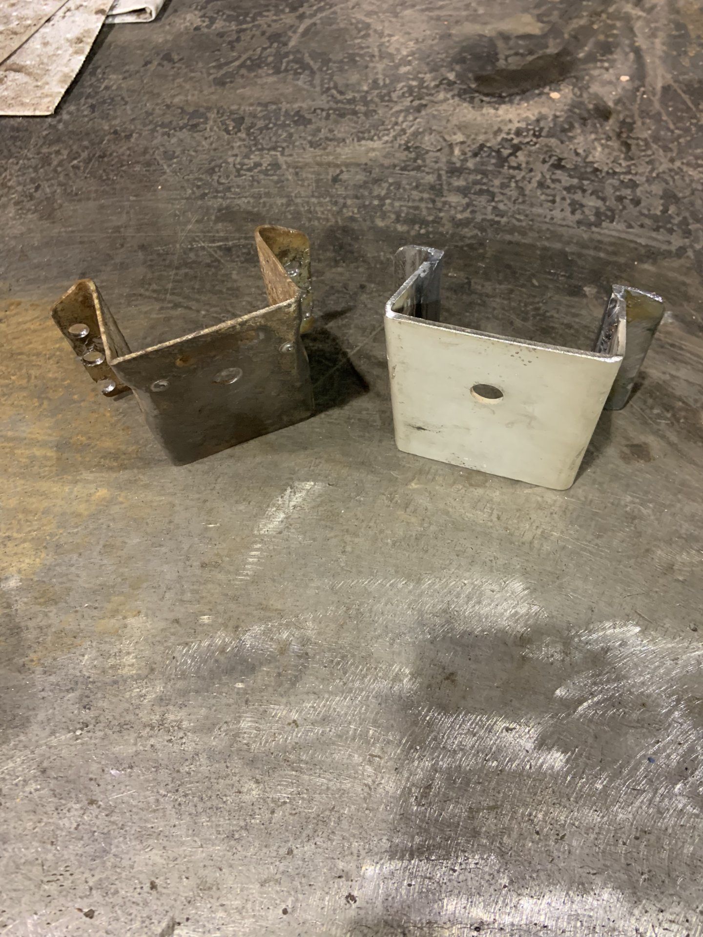

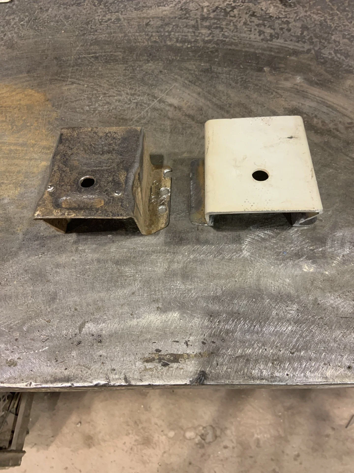

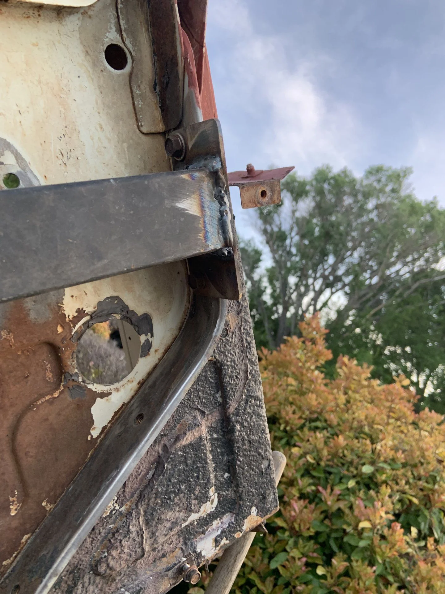

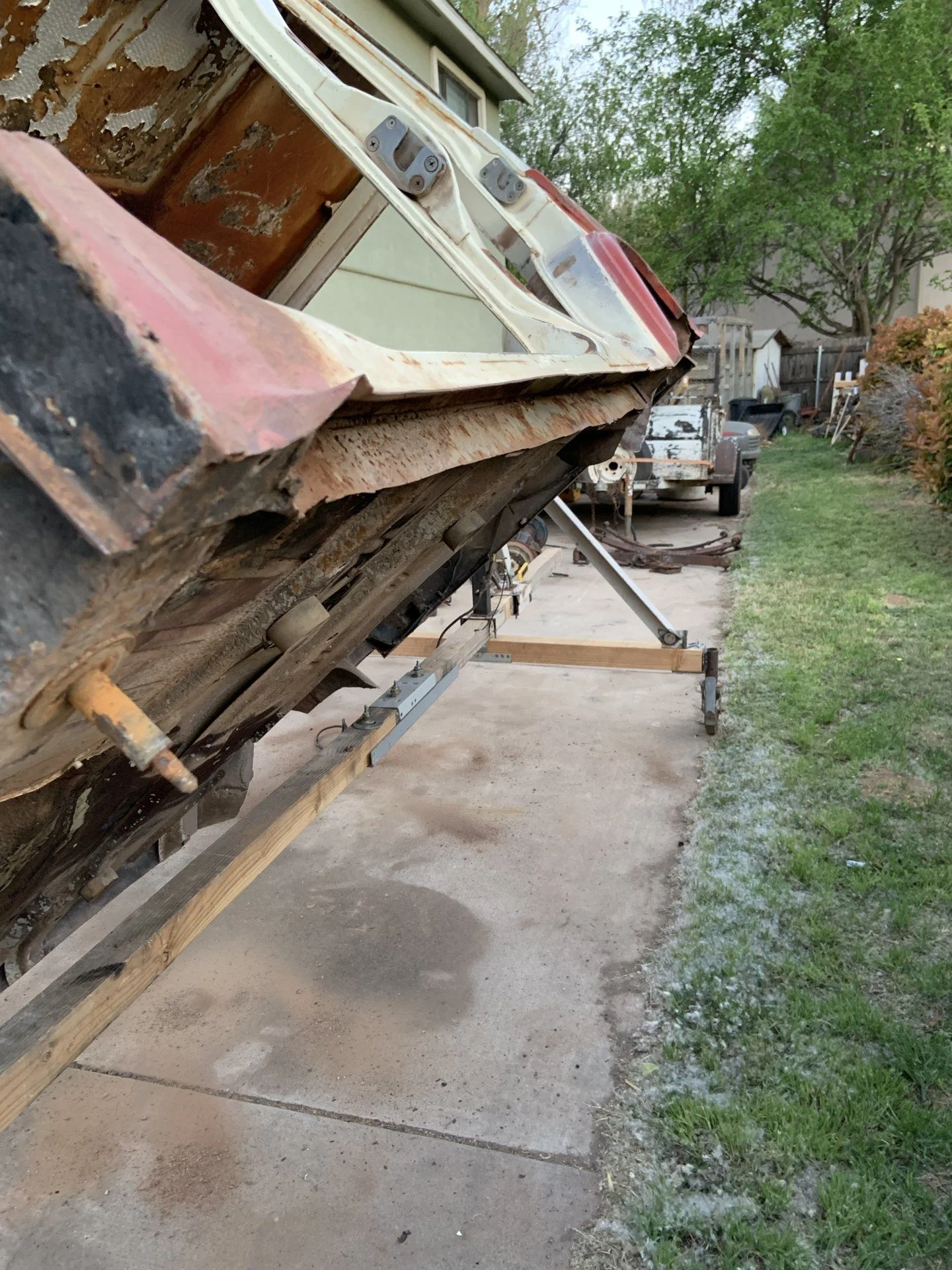

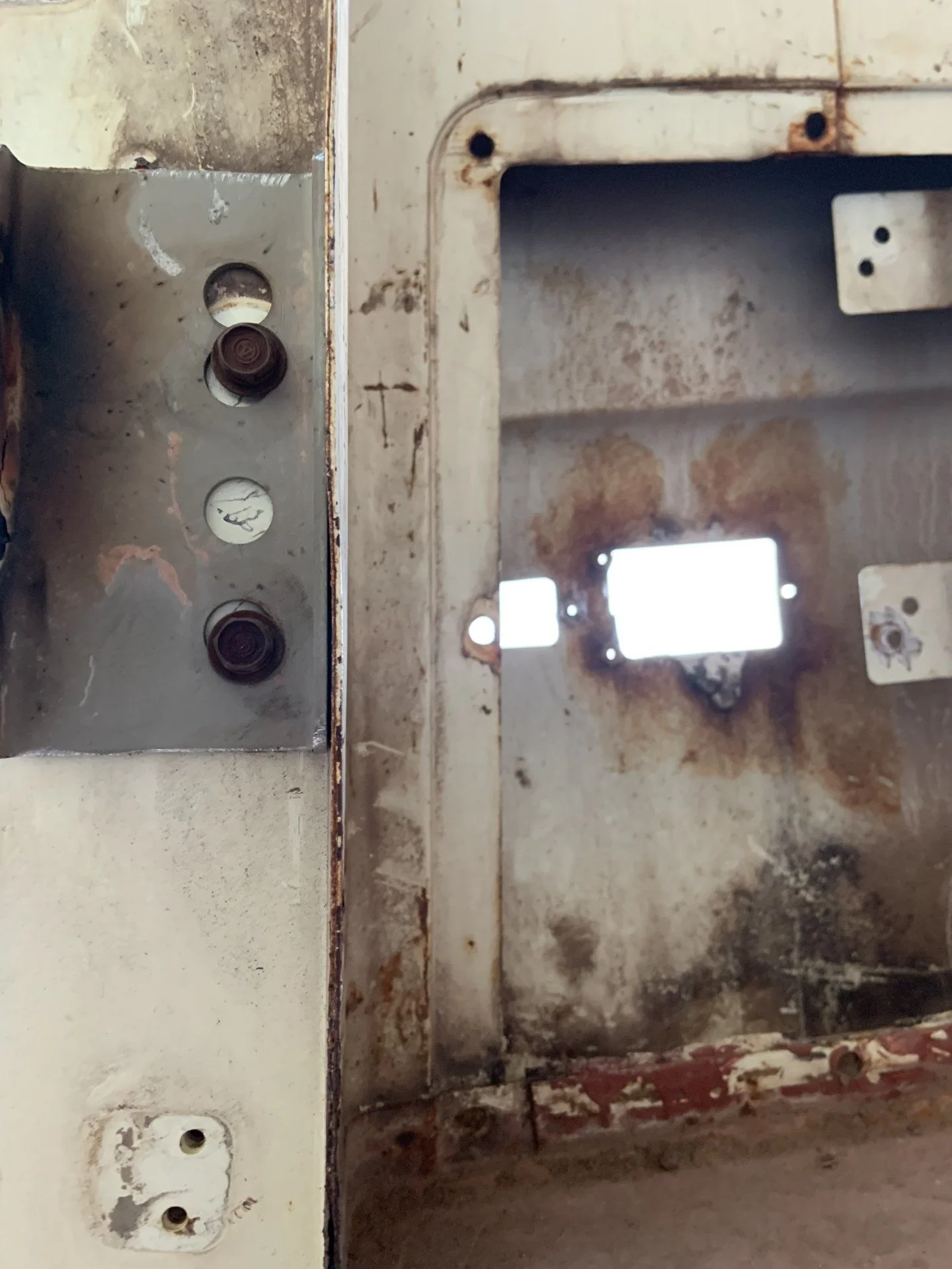

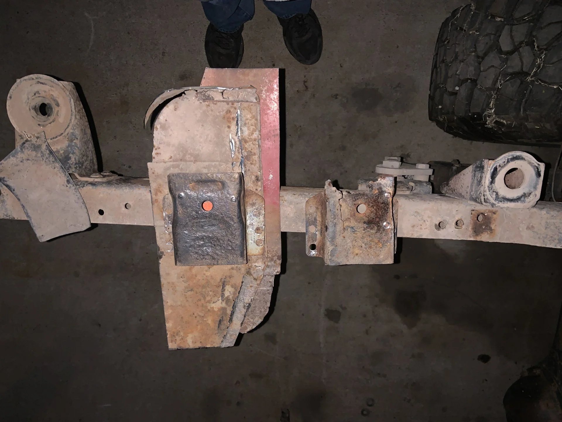

Here’s a couple attachment point pics @PabloCruise ‘s request. Just mimicking what I saw @scrapdaddy and a few others do. The pieces on the back already had pre-punched holes. 90%of the steel used was free scrap that I picked up from work. The 2-1/2” x .125 square tubing was the only steel I had to purchase at about $7 and change per foot. The 2-1/2” x 3/16” was almost $9 a foot. I went with the .125”.

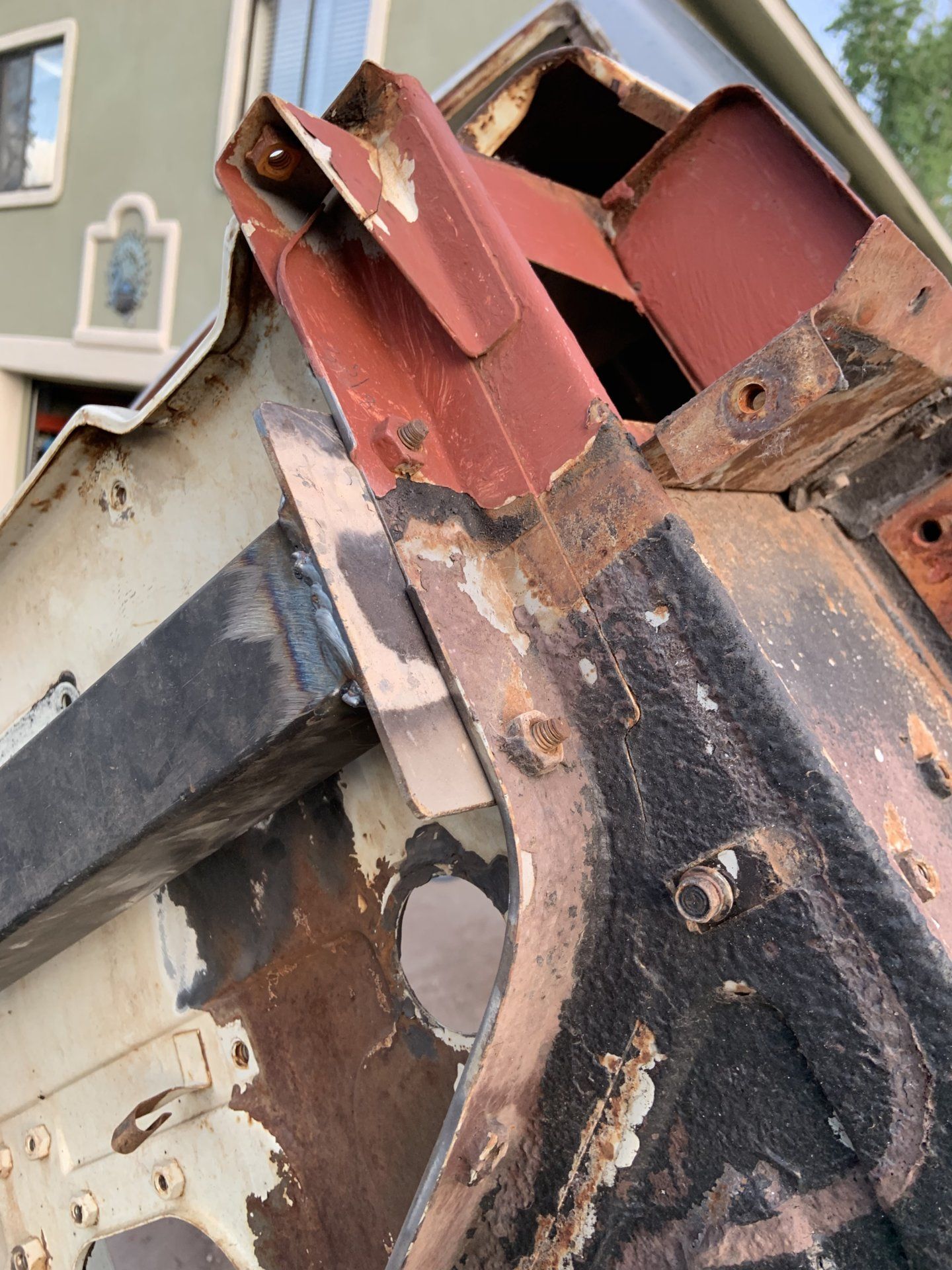

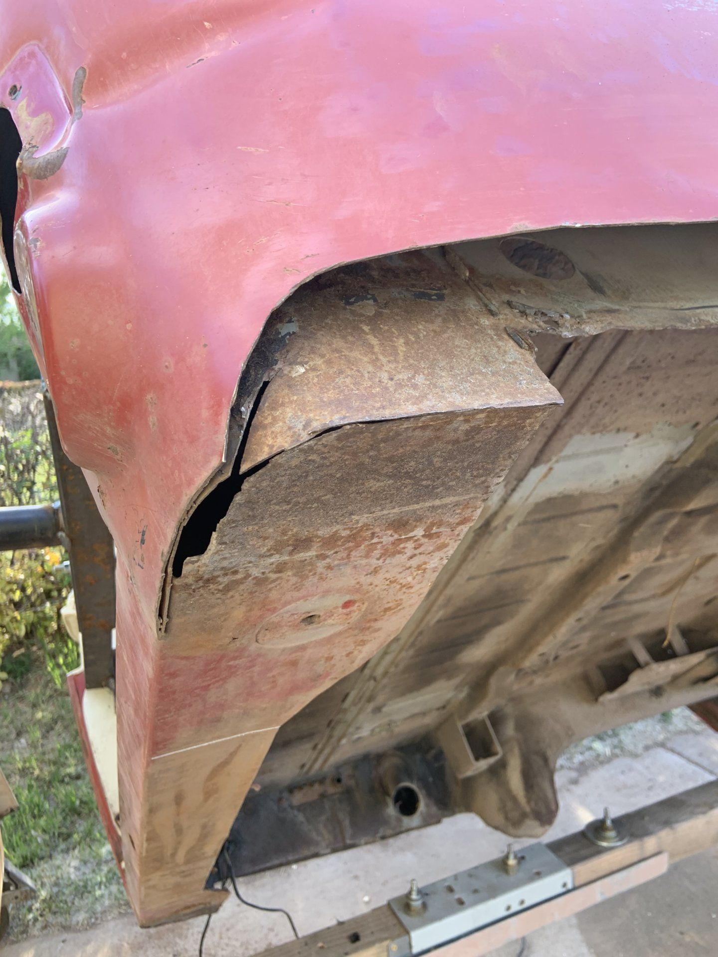

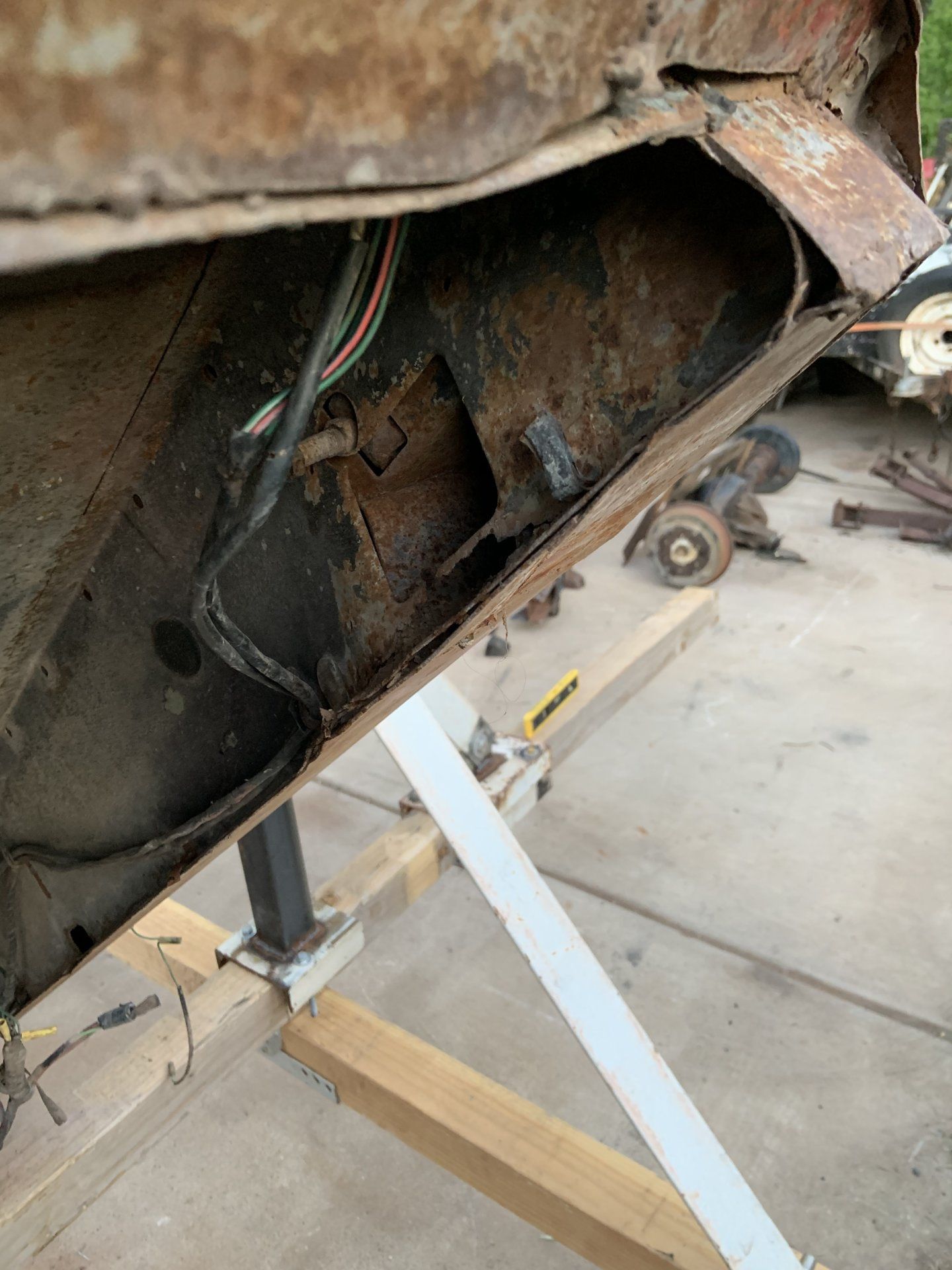

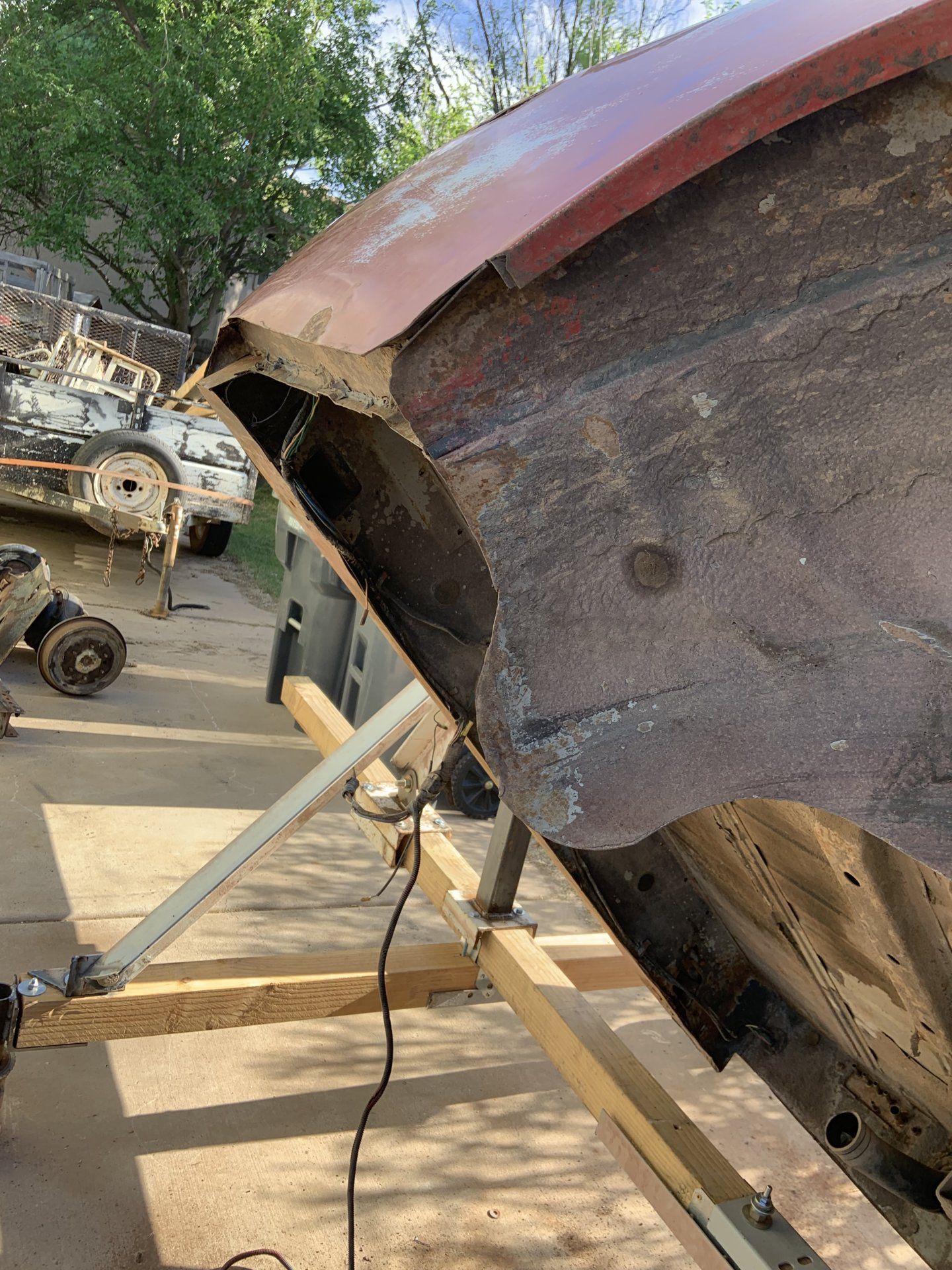

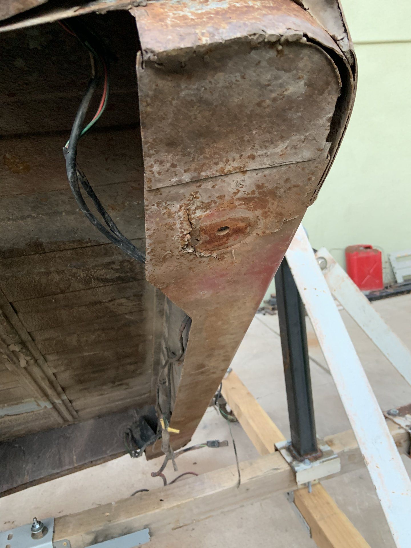

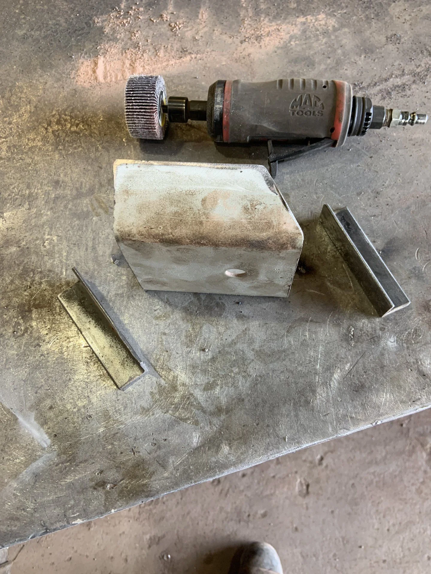

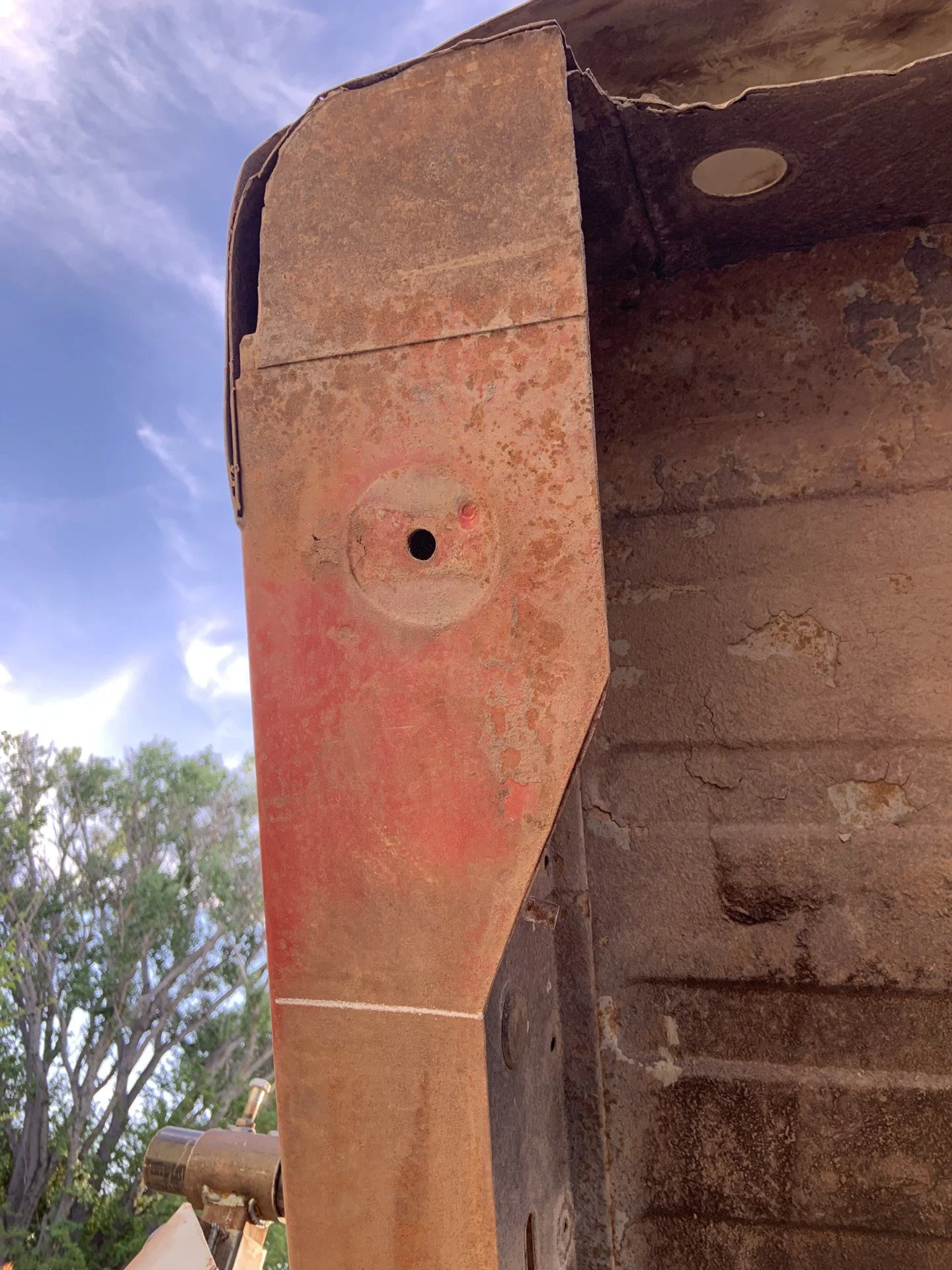

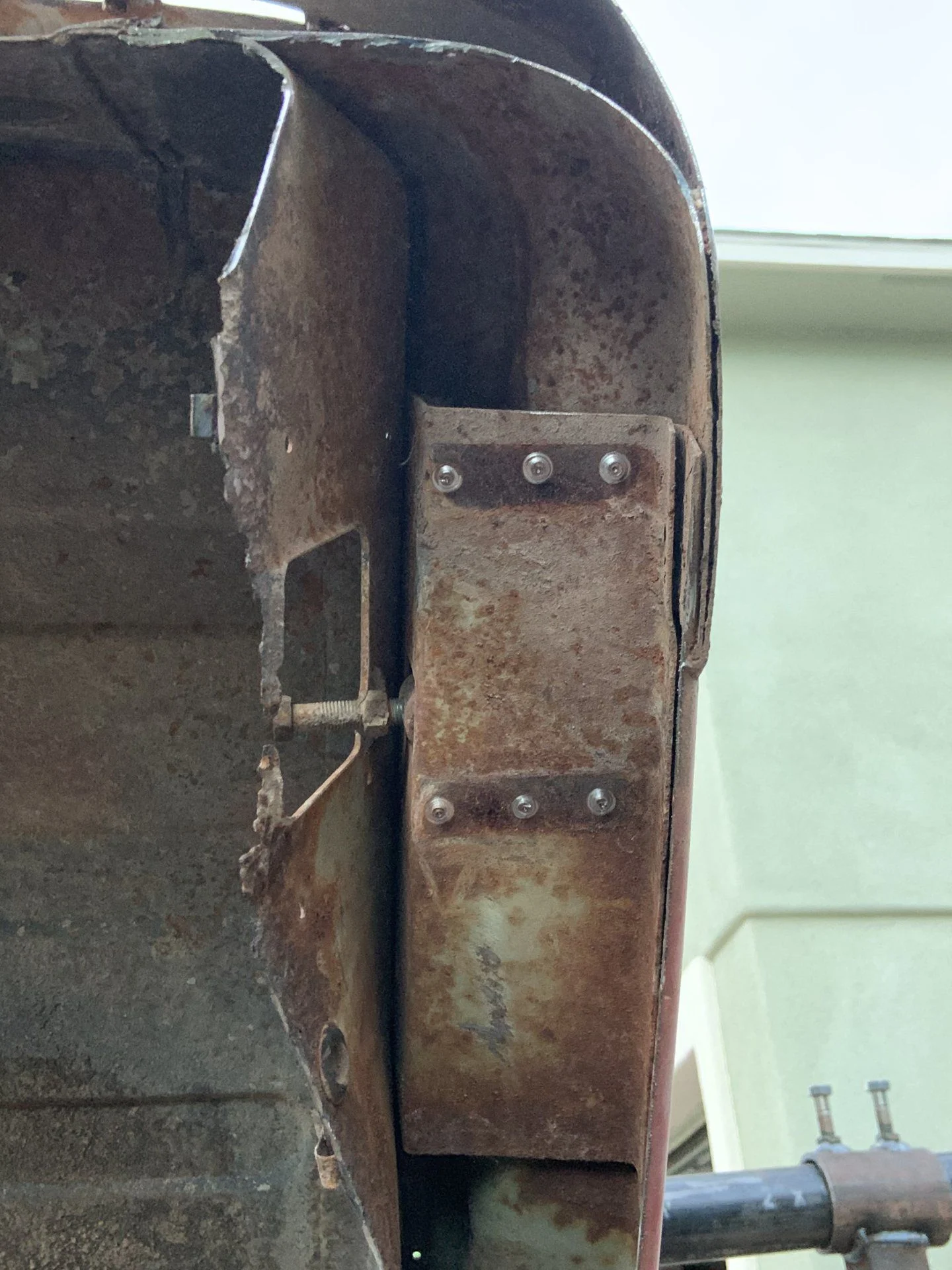

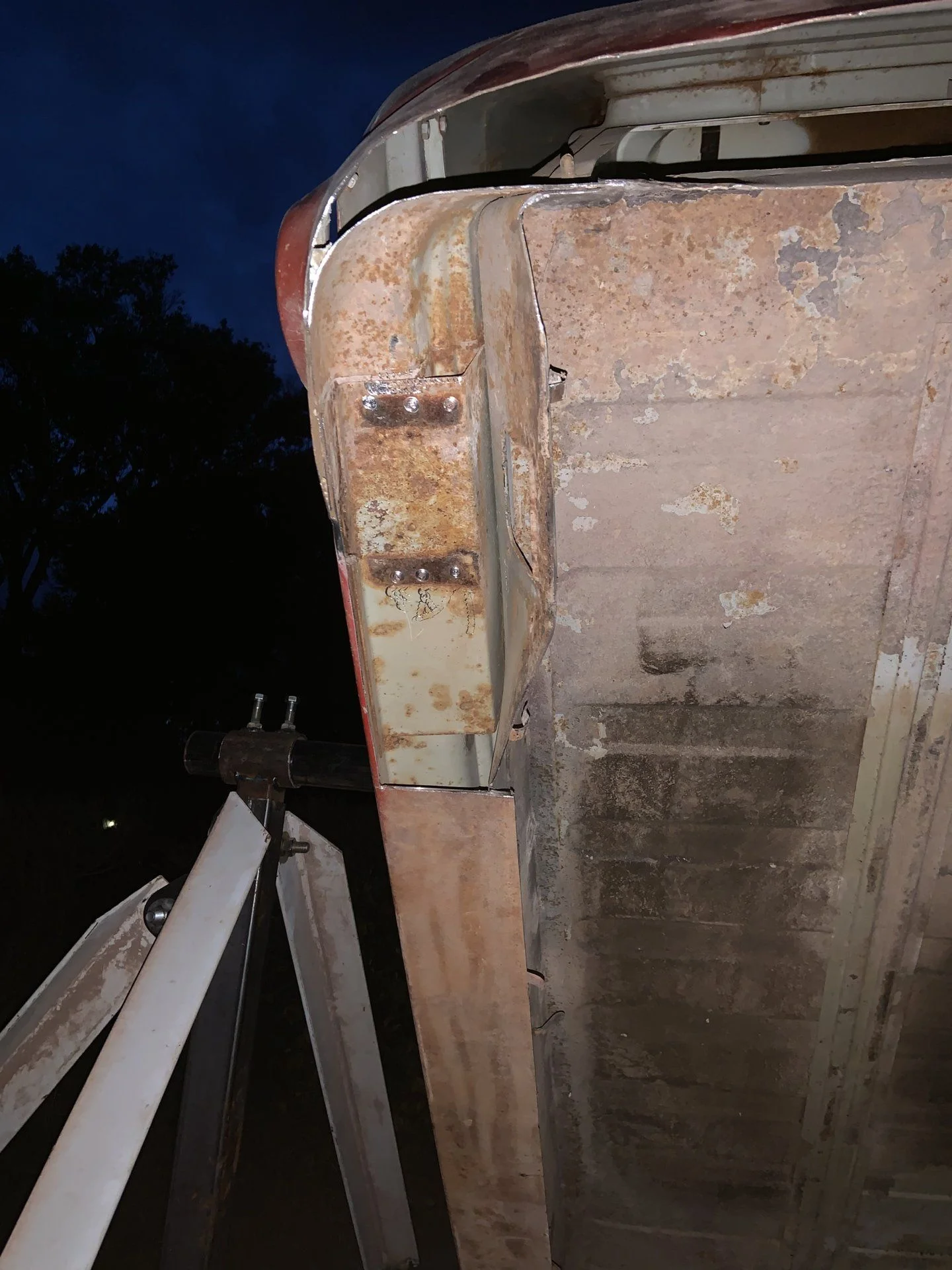

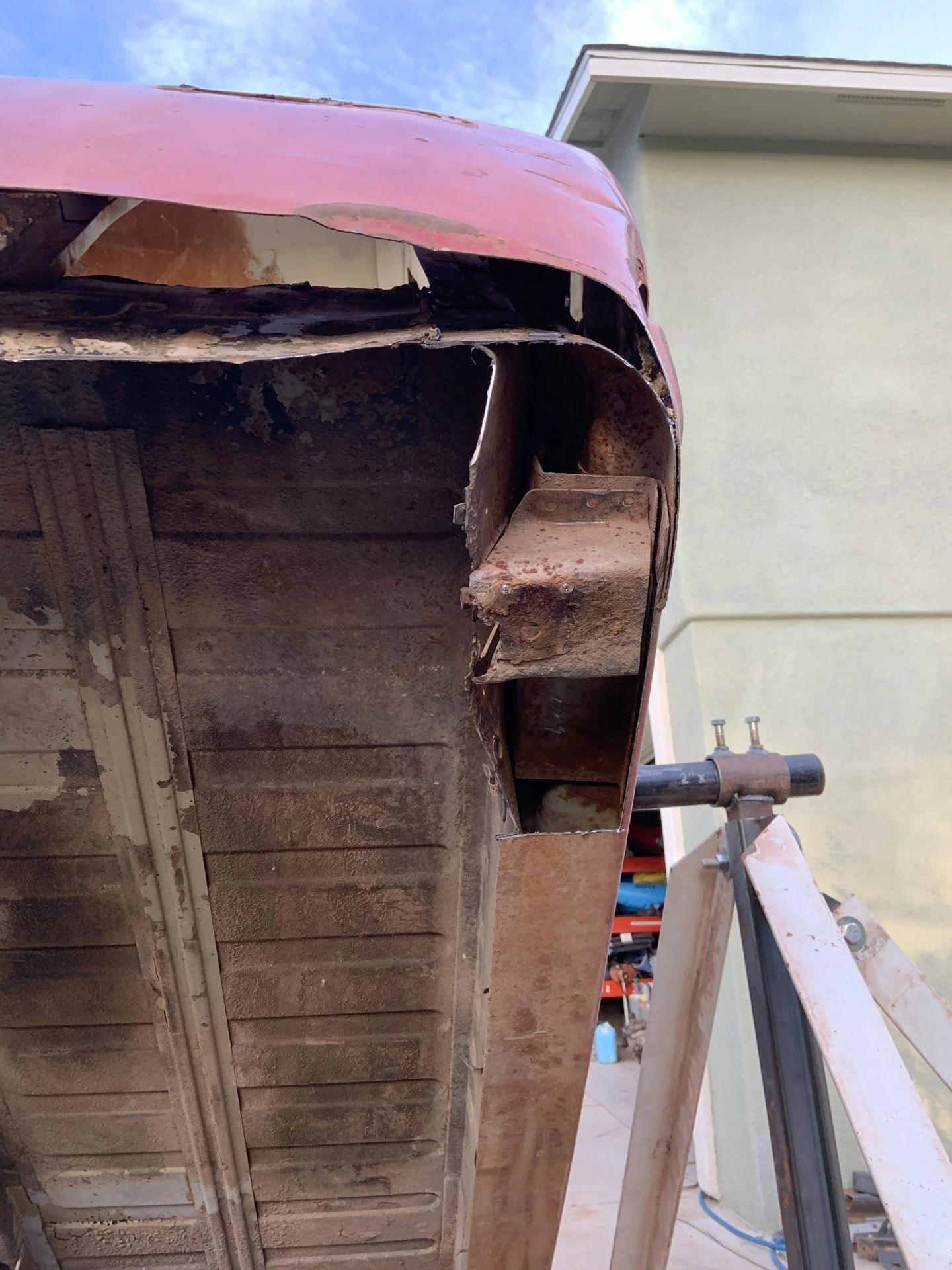

The passenger side wasn’t as bad as the drivers side. I used a spot-weld cutter to cut the outer plate(s) from the inner mount cradle (or whatever you want to call them), then used the spot-weld cutter to remove those as well.

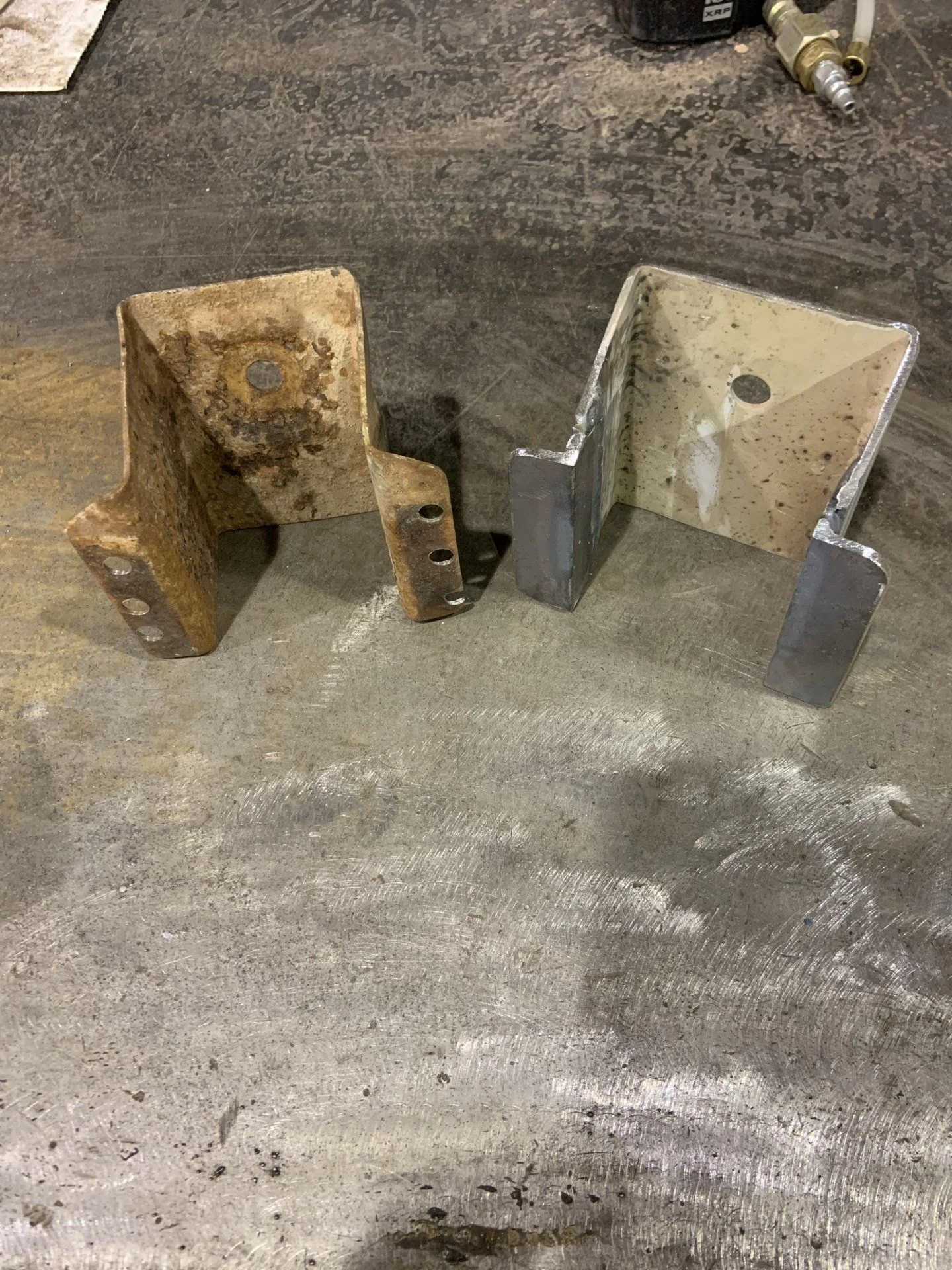

The plan is to re-fabricate the inner mounts out of some square tubing, weld those in, then cover them with some 1/8” plate. Funny thing about those inner mounts is that the plate they’re spot welded to is not solidly welded in place. It’s all kind of flexy in there. Not sure if they engineered it that way or if they just decided it wasn’t important to tie it all in together 🤔

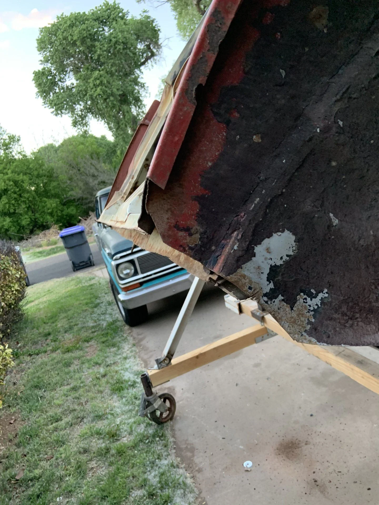

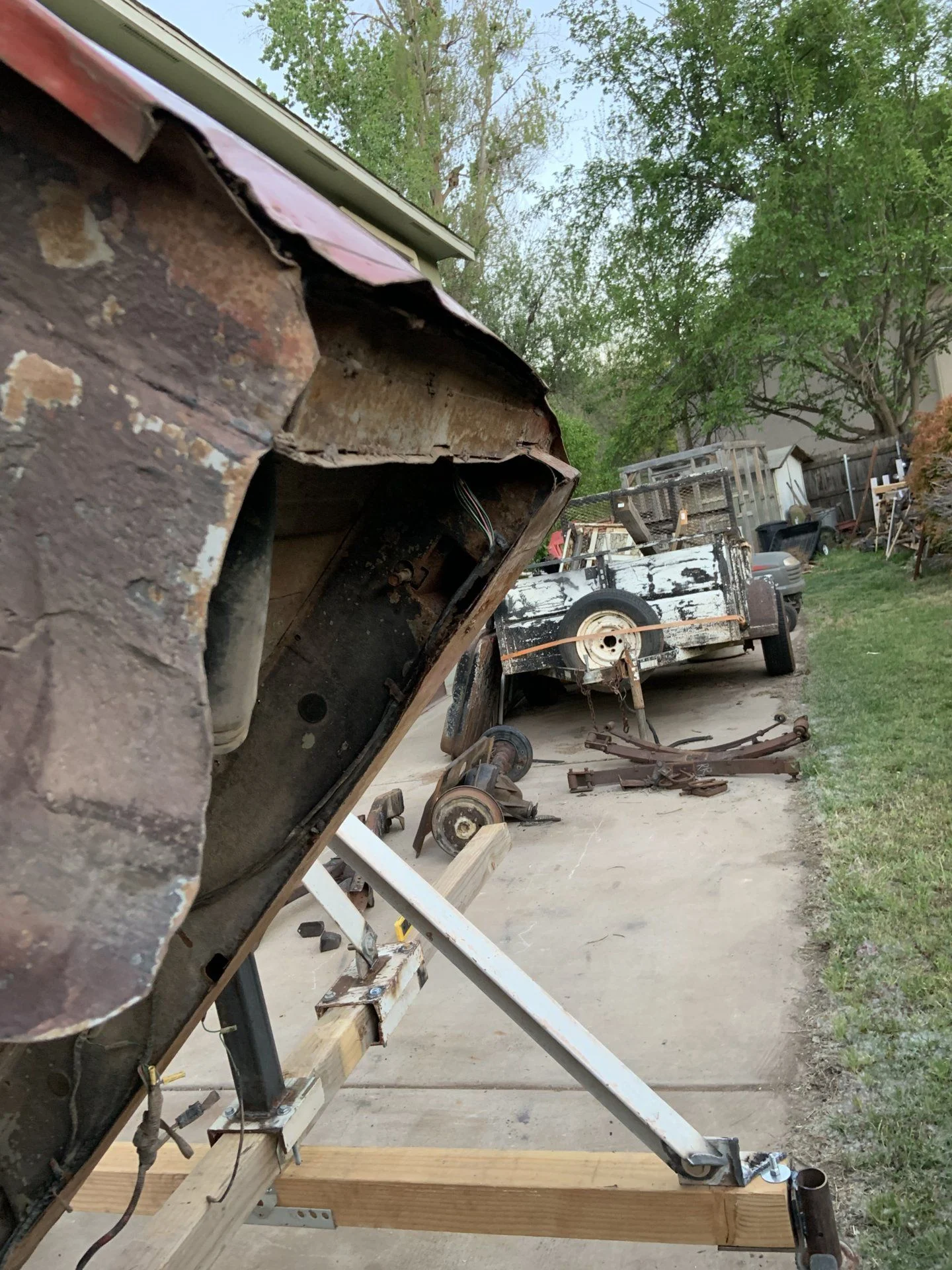

Also funny to me how those rear tub mounts aren’t really designed to deter dirt and moisture from entering that whole rear cavity with the exception of the cheesy little flaps that are supposed to cover the access holes. I’m thinking that a mount that was enclosed on every side but the access would be much better at keeping dirt and mud from getting into that cavity.
Great pics showing all the layers sandwiched in to one big rust trap...mine is going to be worse than yours if I ever open it up.
Did you not also have yours on a rotisserie @PabloCruise ? You did a frame-off, right?
No sir, frame-on job for me. I don't have the space to do what you are doing.
Great pictures - those are golden!
