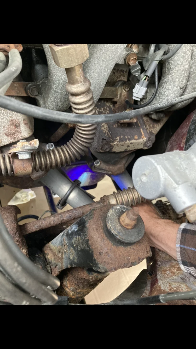

Went ahead and cleaned the engine compartment, bought some UV dye and poured a couple ounces, drove around for about 20 min. Appears to be a literal hole in the oil pan, not a leak from the gaskets, but a literal hole lol. I drove for a hour after finding this leak and I still don't see any other spots around the oil pump, head gaskets, etc. appears to only be the oil pan. Does anyone know if 92 is compatible with 93-97 oil pans? Parts finder is saying they are.

The picture you posted is inconclusive at best. It's impossible to tell where the oil is coming from, but I'm not the one laying under your truck. If there's a hole it can be fixed. If it's a leaking gasket it can be replaced.

Yeah picture just shows the drips but I was under the truck watching the oil droplets form from that spot then drip down. There is a small hole. the drips became more apparent after doing a full synthetic oil change (I don't know when the last change was done or with what oil) and after blasting off all the grime on the pan with a degreaser.

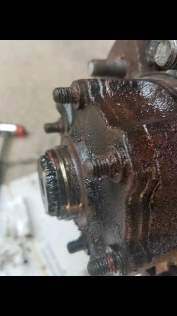

Someone before red locktite on the studs for the drive flange that face out. and it appears to not be gear grease but more locktite on the flange where it interfaces? What is the best way to get these off? Blow torch/heat gun? What is the part number to replace these screws, they are very rusted. pic below:
According to loctite's website "Loctite Threadlocker Red 271 is designed for the permanent locking and sealing of threaded fasteners.
The product cures when confined in the absence of air between close fitting metal surfaces. It protects threads from rust and corrosion and prevents loosening from shock and vibration. It is only removable once cured by heating up parts to 500°F (260°C)."
That doesn't look like red loctite to me. It looks like high heat permatex silicone sealant to prevent leaks......
There is some on the tip of the drive flange by the axle shaft as well that is the same color.
Use a brass hammer to hit the ends of the studs straight on to release the cone washers.
