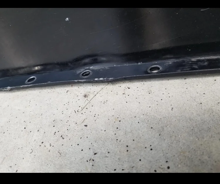

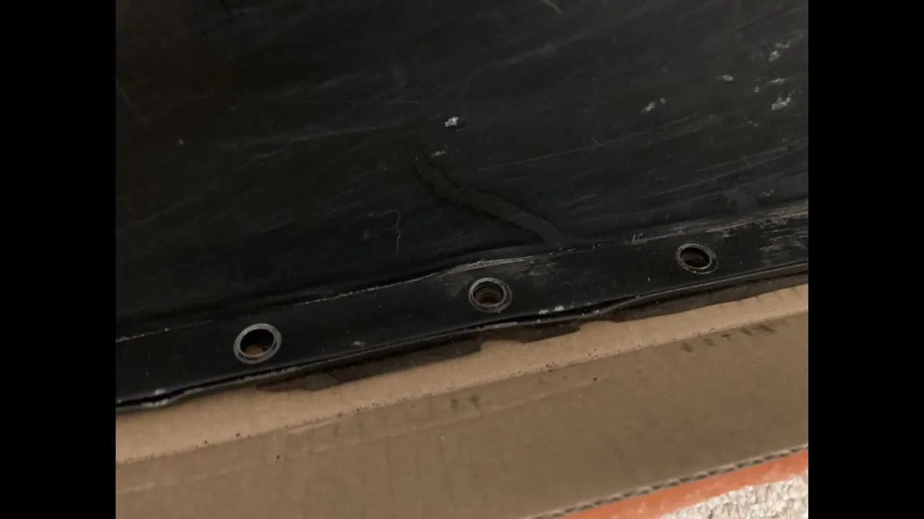

i got the oil pan today, good condition but there are these two holes that are bent any ideas on the best way to flatten these bends or am I screwed? lol
Two hammers. One medium, one small, on opposing sides, light frequently tapping, one as back up to the other.
seemed to turn out ok, thank you for the advice, unfortunately the bolts are running behind and i have to run to fastenal for some washers tomorrow.
