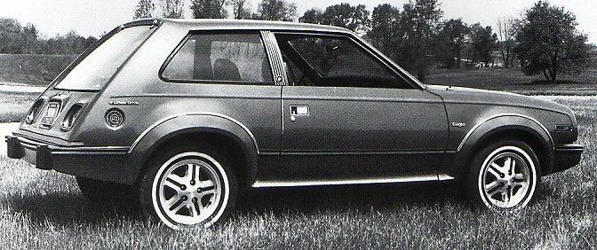

The car is 'actually' a 1981 AMC EAGLE Kammback series50 -
which is a 1977'78 AMC GREMLIN shell - with full rear side
- windows -ala- their 'Spirit' Sedan - the new name for the
'79 - '82 GREMLIN for these years.
The Kammback has 4WD and the 258cu.in. inline 6 - all of which will
get 'stored' - saving some 1k lbs. weight.
I located a '71 Gremlin 'Fun in the Sun' sliding sunroof clip made in England by
'Britax' - sourced by AMC - in *Mint* shape.
Building an AMC 360 would cost alone for a Hyd. Roller Cam Kit - $1,250.00
before upgrading cast rods 'n pistons - new valve seals - etc.
AMC 360 weighs 540 lbs. dry
Toyota 4.7 weighs 540 lbs. wet - oil / coolant
DOHC 32 valve alloy VVT-i head 271 HP vs 2 valve all cast iron 170 HP -
not much to choose from ;)
