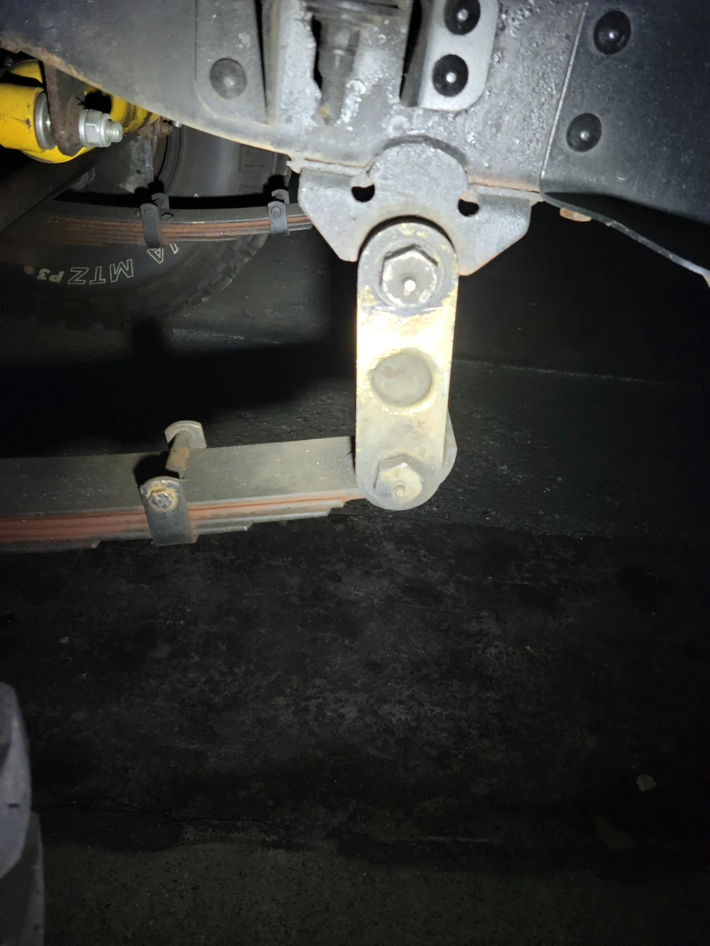

Hi guys, I have an fj62 89. It was lifted when I purchased it. It's a cool-looking truck. So I bought new 33 Micky Thompsons and Bilstein shocks to try to smooth out the ride. It helped but the ride is still very uncomfortable. It bounces way too much while on the road, especially on wavy streets. If the road is smooth then she rides smoothly. But any little bump or wave and she bounces. I try to avoid long trips. I started reading online about the possible issues with the stock leaf springs. Also, a buddy mentioned that the shackles are straight up and down and that shackles should be angled. He suspects that the leaf springs are too short which might be the cause of the stiffness. Could one of you find men guide me? Any input would be great. What leave springs do you recommend or do you know of a shop in Los Angeles that could help me? Thanks.

It sounds almost like you have stock springs and someone just put on longer shackles. I imagine if this were the case you could have all sorts of problems.
This is exactly it. I'm just trying to work with it. The best route I think is swapping the leaf springs with the rights ones.
Is it possible that the leafs on a 62 are longer than the normal 60?
Pictures per your request. Leaf springs look stock. And it looks like the previous owner just upgraded the shackles. When I bought the truck I replaced new shocks thinking that would solve the problem. Let me know what you guys think I should do to reduce the bumpy ride. Thank you.
Those look like they might be stock springs but have a lot of arch if so. Either way the packs aren’t super think so should be pretty good.
However those shackles are too long for those springs in my opinion, for fastest/cheapest/easiest I would call Cruiser Outfitters @cruiseroutfit and get a set of either the greaseable stock-replacement or the shortest ARB anti inversion shackles.
Also might be time for a full set of bushings and springs as well (definitely get greaseable for those).
If that is still not up to your standards swap the springs/shocks out for Dobinsons or maybe reevaluate your vehicle choice
