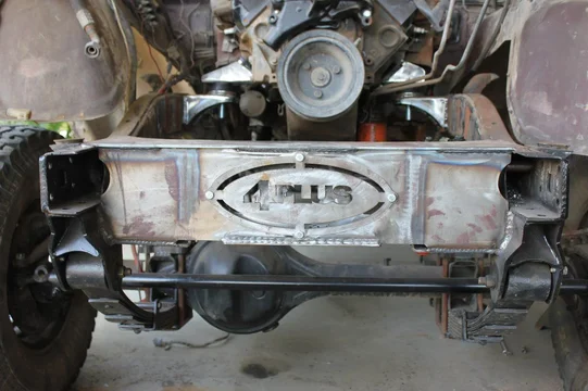

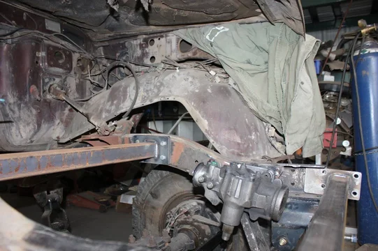

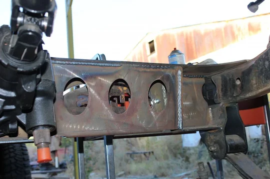

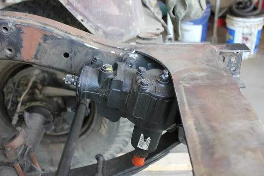

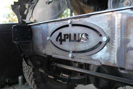

only crazy people do saginaw box conversions. It's a little more work
