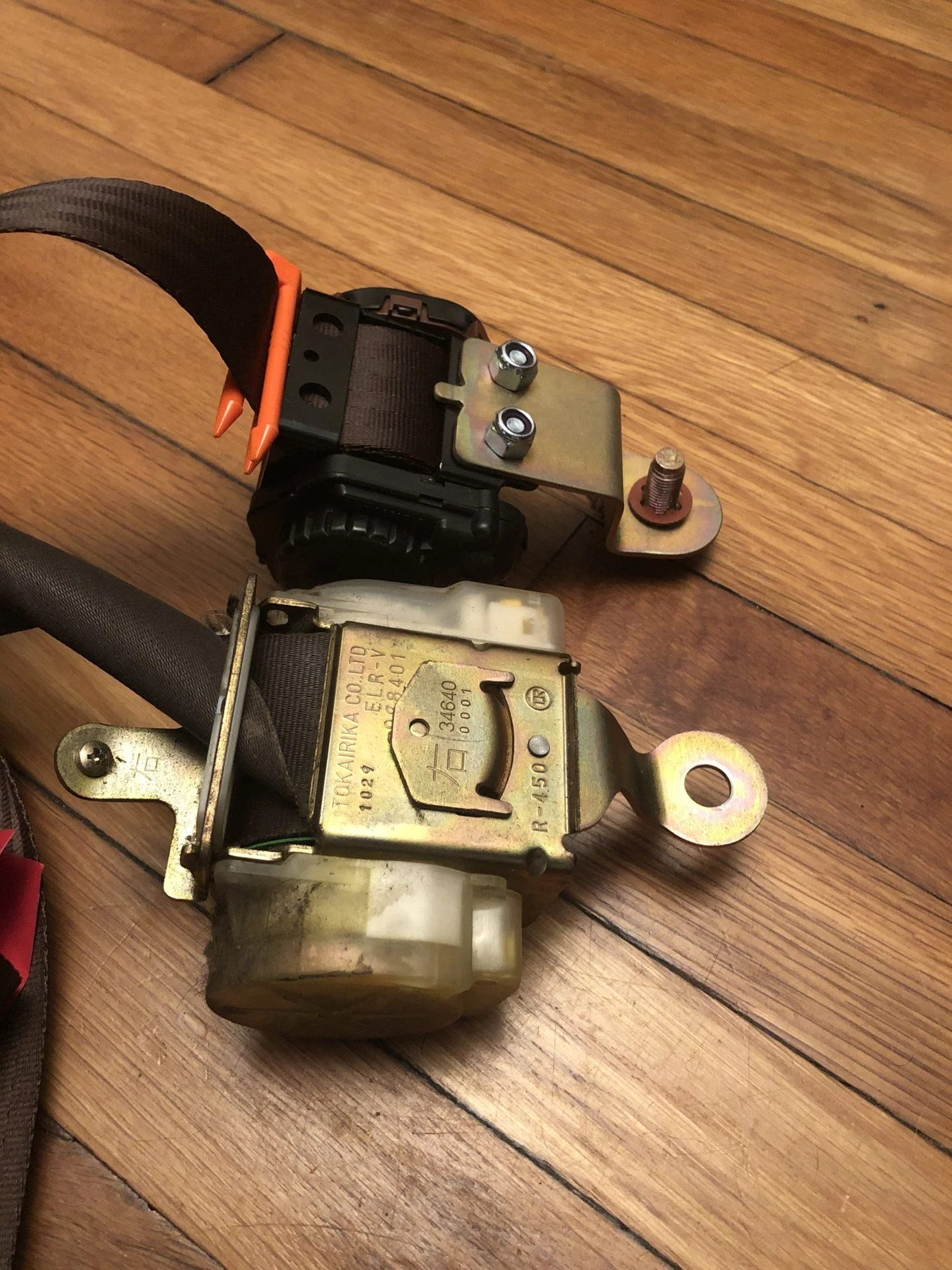

Ok, I got a picture of the difference between the seatbelt planet canister and the OEM one. You can see the sharp angle on the new one and that’s what’s keeping it from mounting. Could they refurbish the OEM one?
take off the last 2 digits in your search. they must be for color, but search doesn't pull them.
WELL HEY! There it is! Under $300, too. I like that. Way better than spending $450 for the entire belt and trim set from Cruiserparts.net, especially since I already had factory belts and only wanted trim. An actual new set that looks factory will be a much better avenue I think.
Late 70 series seatbelts have been retrofitted into our trucks and can be had new from Toyota.
View attachment 2091753Ok, I got a picture of the difference between the seatbelt planet canister and the OEM one. You can see the sharp angle on the new one and that’s what’s keeping it from mounting. Could they refurbish the OEM one?
was there ever a solution for this issue? i have an FJ62 manufactured in 1988 for the 89 model year and indeed what i have installed is the one below.
