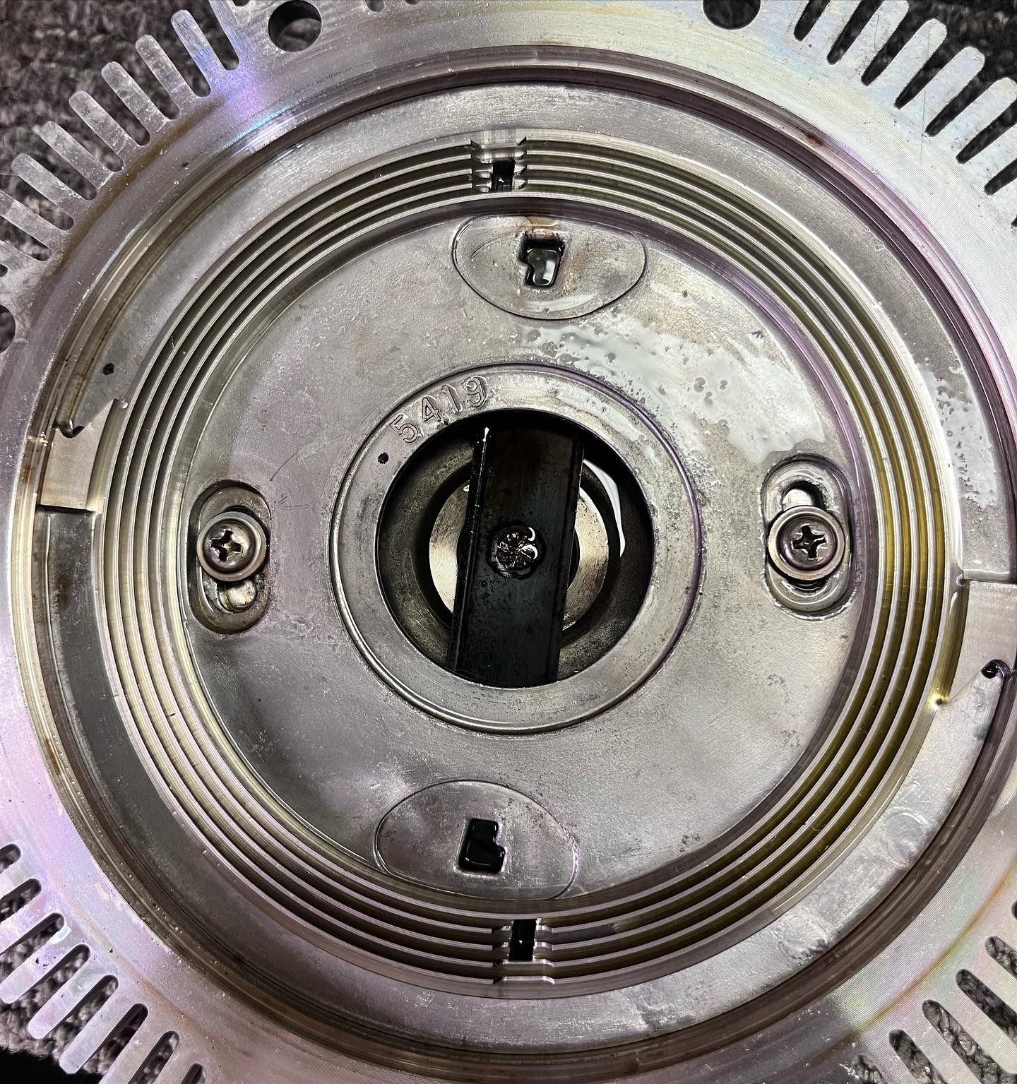

Couple of projects checked off the list, completed amid some inhospitably high temperatures here. Last month I ordered up some 20k silicone oil and modified my green hub Aisin FTC-049 fan clutch. I also moved the adjustment screws from the far left position to about 3/4 to the right to lockup at a lower temperature. Well there's a huge difference in fan performance just from the sound, and I can see the temps staying in check much better. For context: twice over the past year I've had the trans temp light come on when the engine temp was in the 230 range for a bit, in conditions where that really shouldn't be happening (ie...not that hot outside).
Now after the oil modification, I've had the truck out in 115 degrees for hours, and even on what I think is probably the longest steepest grade in AZ, and the engine temp barely hit 215 or maybe 220, and no trans temp light. This is a win of course. However I do notice the fan locking up a bit earlier (lower water temp) than what I would expect, in the 185-195 range. Since the thermostat doesn't fully open until 210, I believe the fan should lock up closer to 215. So I think I'll pull the fan clutch out and adjust the screw position to maybe 1/3 or 1/2 of the sweep instead of 3/4, and test the result. I may need to remove 1/2 of the 20k and replace with 1/2 10k to drop the viscosity to around 15k. That remains to be seen. [edit 2026 - still running straight 20k oil]
Current valve position screw setting:
I also did a quick viscosity test to see if I could tell what the factory oil weight was. I put a drop each of 10k, 20k and the factory oil on a heated aluminum plate and then tilted it up so the oil would start running down. Based on the distance each traveled in a period of time, I estimate the factory used about 5k oil since it traveled about twice as far as the 10k and 4x the 20k.
