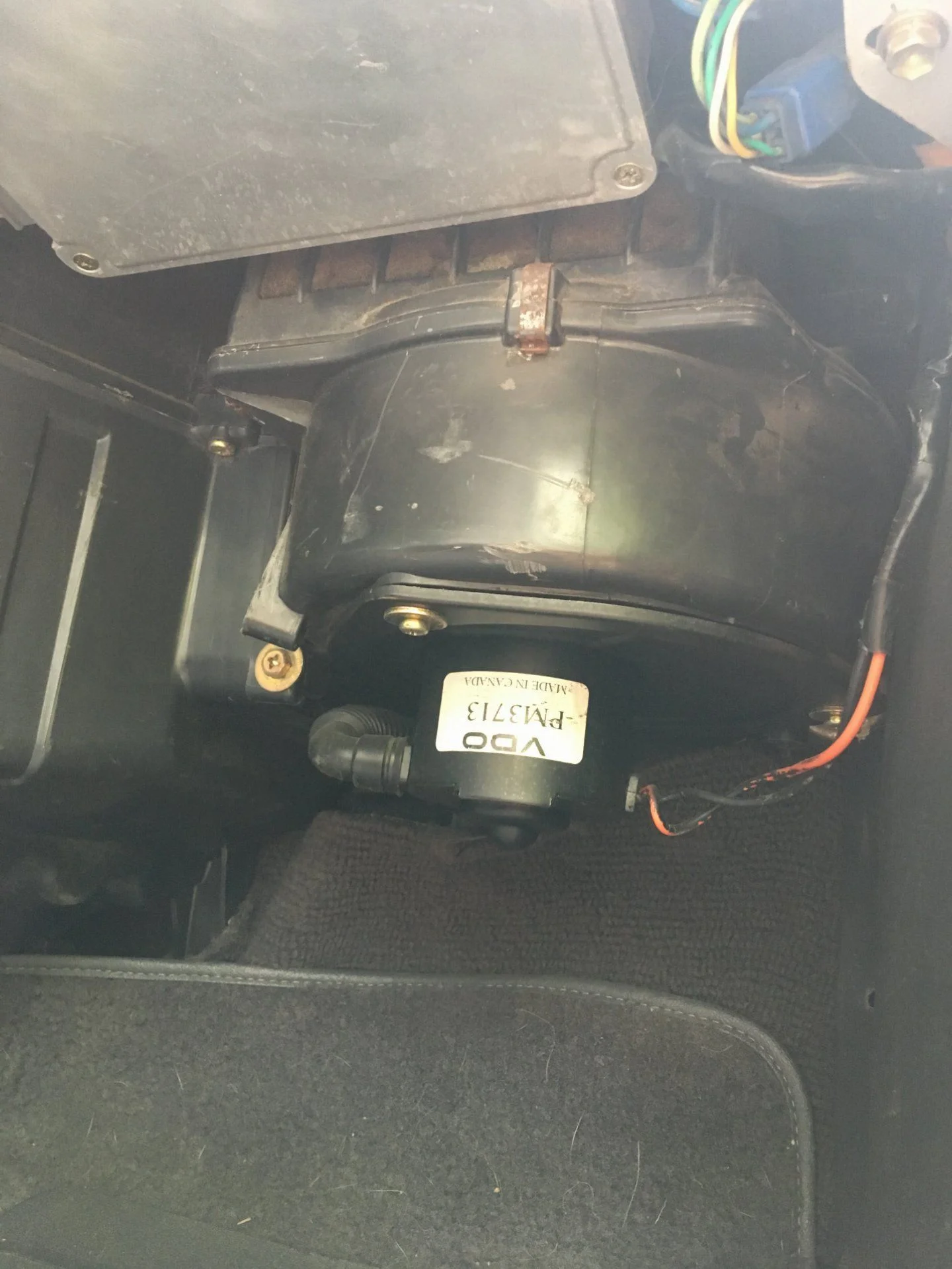

I'd suggest taking the fan out and giving it a good cleaning. It's down by the passenger footwell. My fan quit on me recently, so I pulled the motor, cleaned off the connections and body, and it works like new again. Pretty quick and easy.
I had a similar problem. Noise and barely any flow. Previous owner had installed an aftermarket replacement blower motor and wired it backwards. Check the dumb stuff first!

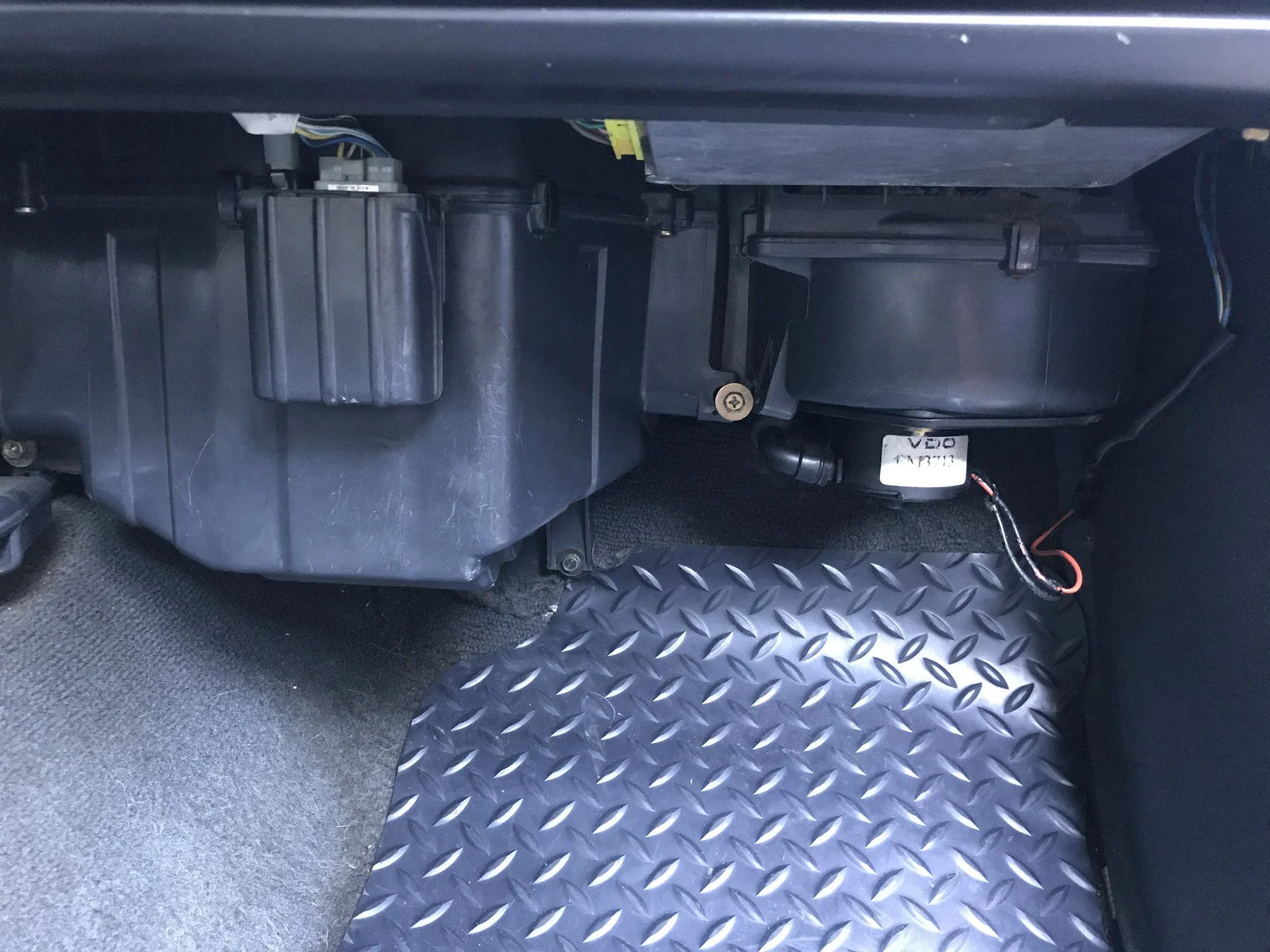

Yessir, this is the blower fan. Three screws (one is in the middle of the picture) and it drops out.

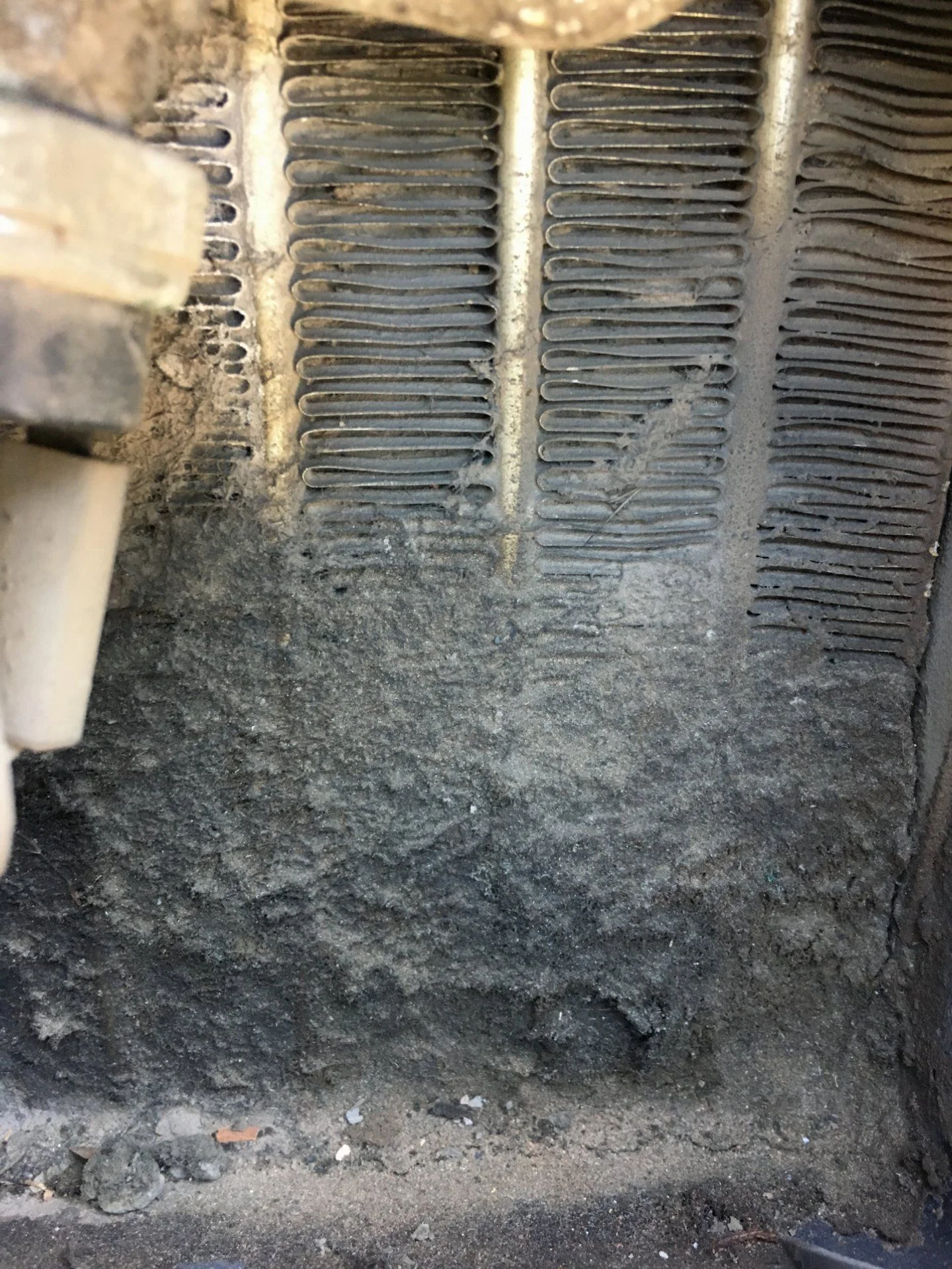

With the fan assembly off, were you able to get a mirror or phone camera into the opening to the left of the fan assembly? - basically where that screw in the middle of your photo above connects the two. If fan is blowing strong - I suspect you're going to see a few decades of dust and debris - something like this:
From there you'll decide whether to clean or replace your evaporator.
