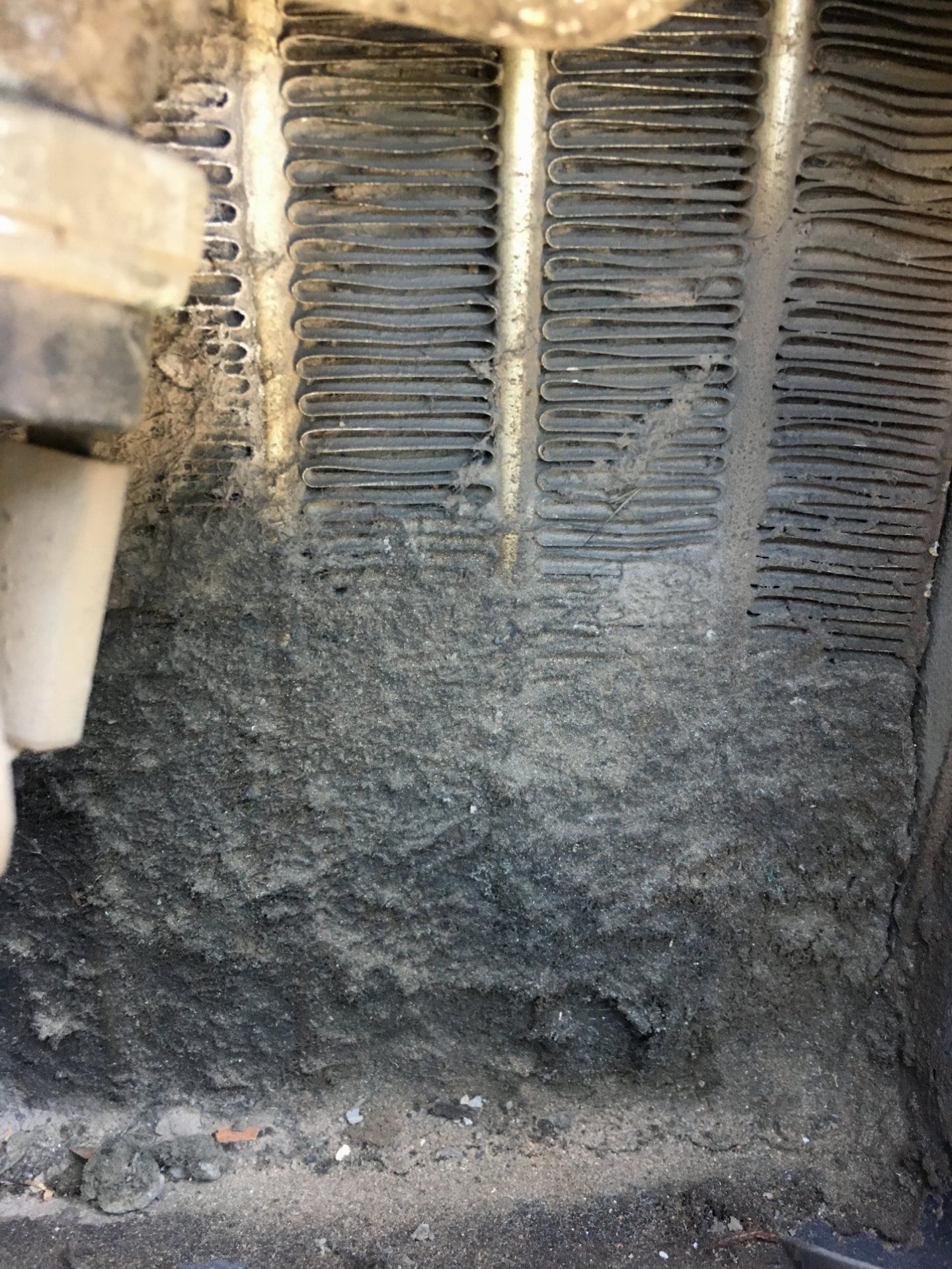

With the fan assembly off, were you able to get a mirror or phone camera into the opening to the left of the fan assembly? - basically where that screw in the middle of your photo above connects the two. If fan is blowing strong - I suspect you're going to see a few decades of dust and debris - something like this: View attachment 1505463
From there you'll decide whether to clean or replace your evaporator.

Not as bad as yours but probably worth vacuuming. I wonder if this is the issue

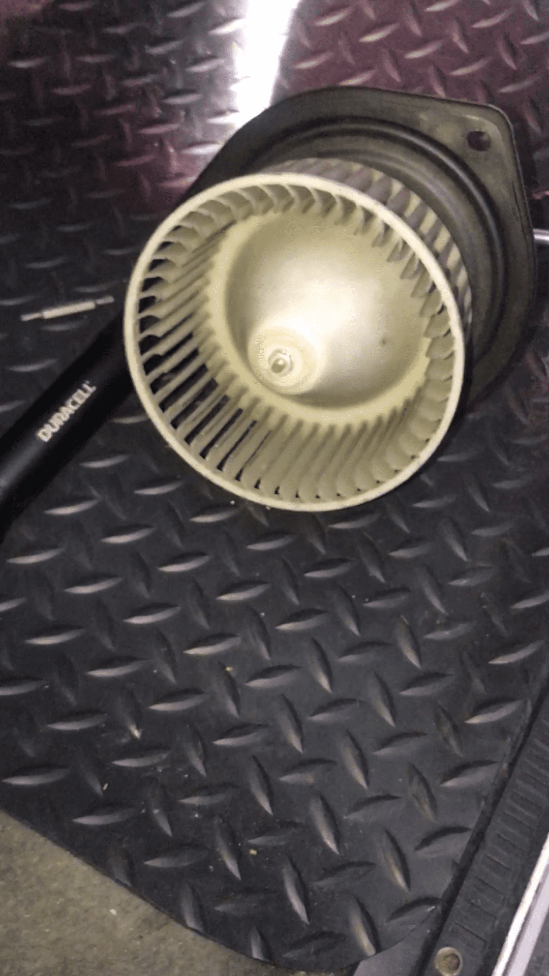

One other question, when it comes to cleaning the fan, should I remove the nut in the middle and clean the motor inside?
While you have the fan out plug in the wires and turn it on, switching through all the speed levels. Obviously, hang on to the housing and don't let it flop around.
Should run nice and strong with ease.

How do I check for blockage in the intake? I did a serious vacuum of the evap today, didn't move the needle unfortunately.
