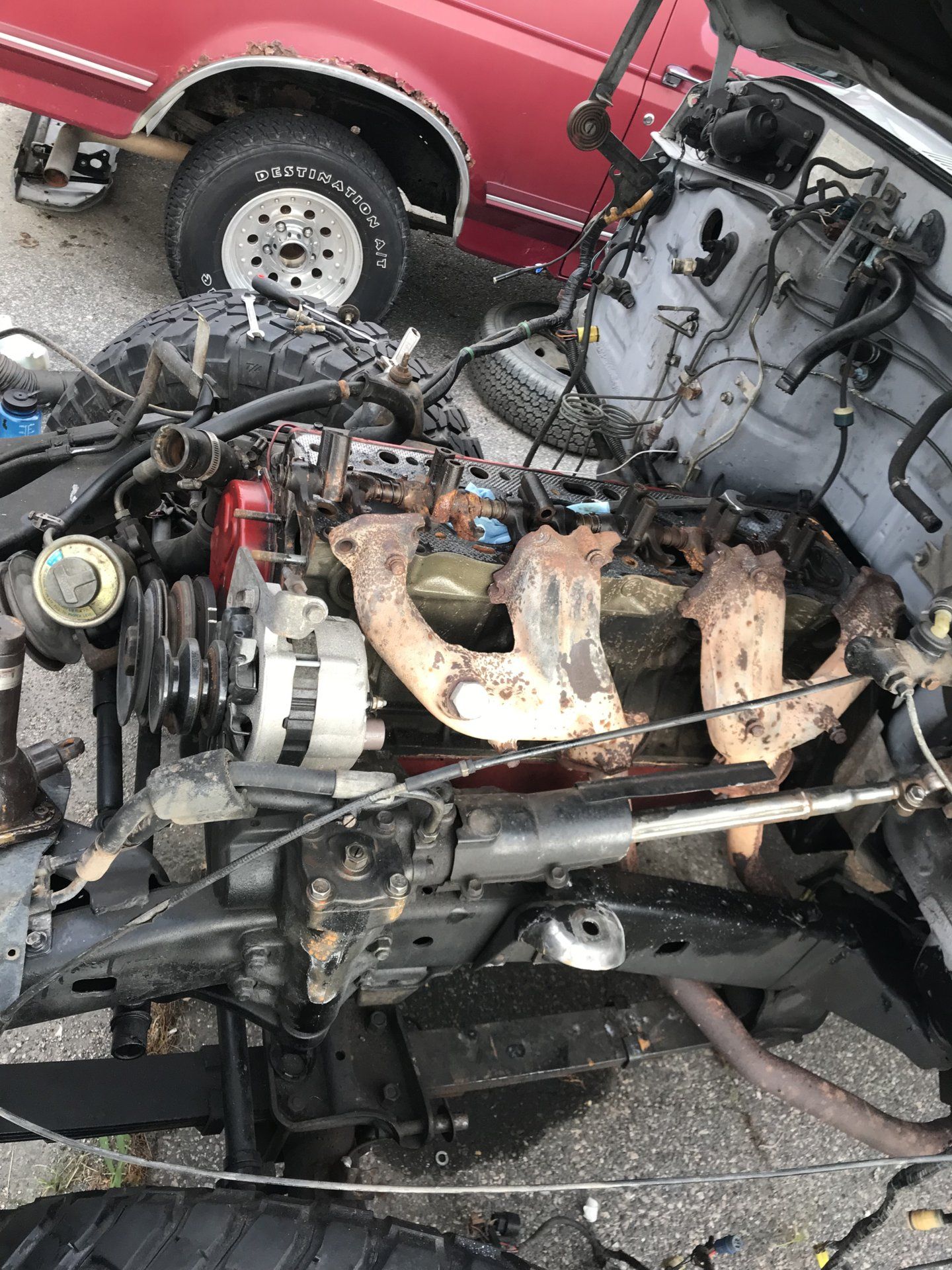

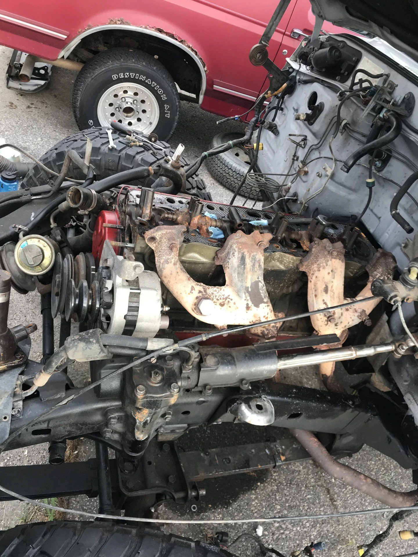

Well the 3fe, efi harness, gas pedal assembly and fuel tank is out. I also pulled the fenders, core support, and good to make the swap easier.
Tomorrow I’m getting up early and pulling the cowl harness. After a bit of research,it looks like the FJ60 cowl harness will be less of a headache. I already have crank windows swapped In too so, getting power windows and locks to work won’t be an issue.
Wasn’t too hard to disassemble everything today. Putting it back together is always more difficult.

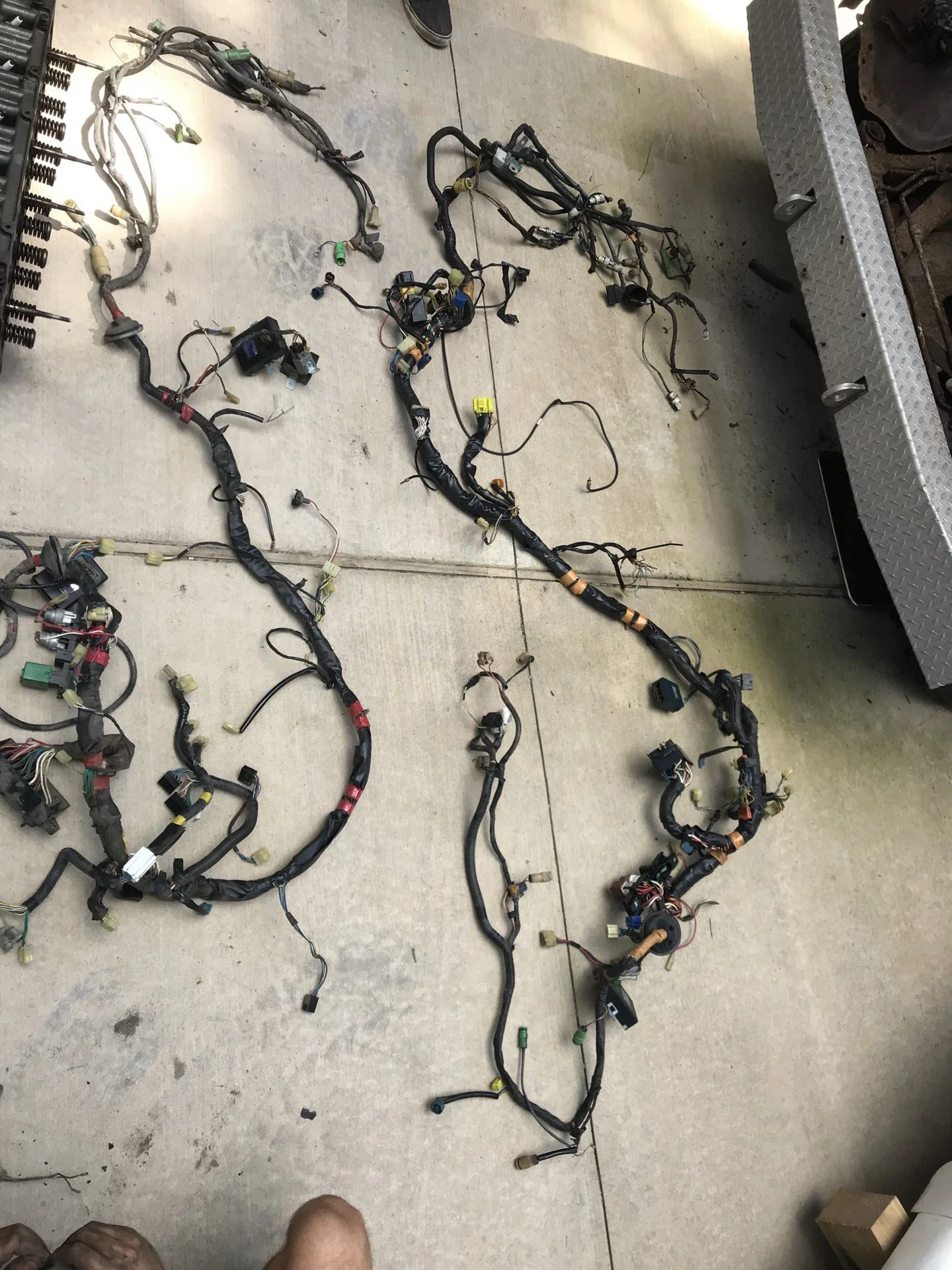

I pulled the harnesses out of my FJ62 and the donor FJ60. I left all of the modules on both harnesses. Most of the plugs are exactly the same, however, the FJ60 rear defroster and wiper switches are a different size than the ones in the FJ62 and it seems to be wired differently. So I’m going to swap in an FJ60 dash and tail light harness. (I wanted to do this anyway because I have crank windows swapped in. ) I’m also going to rewire the headlight plugs.
Luckily, the dash on the parts 60 is in awesome shape and my 62 dash is cracked so I’m just going to swap dashes too.

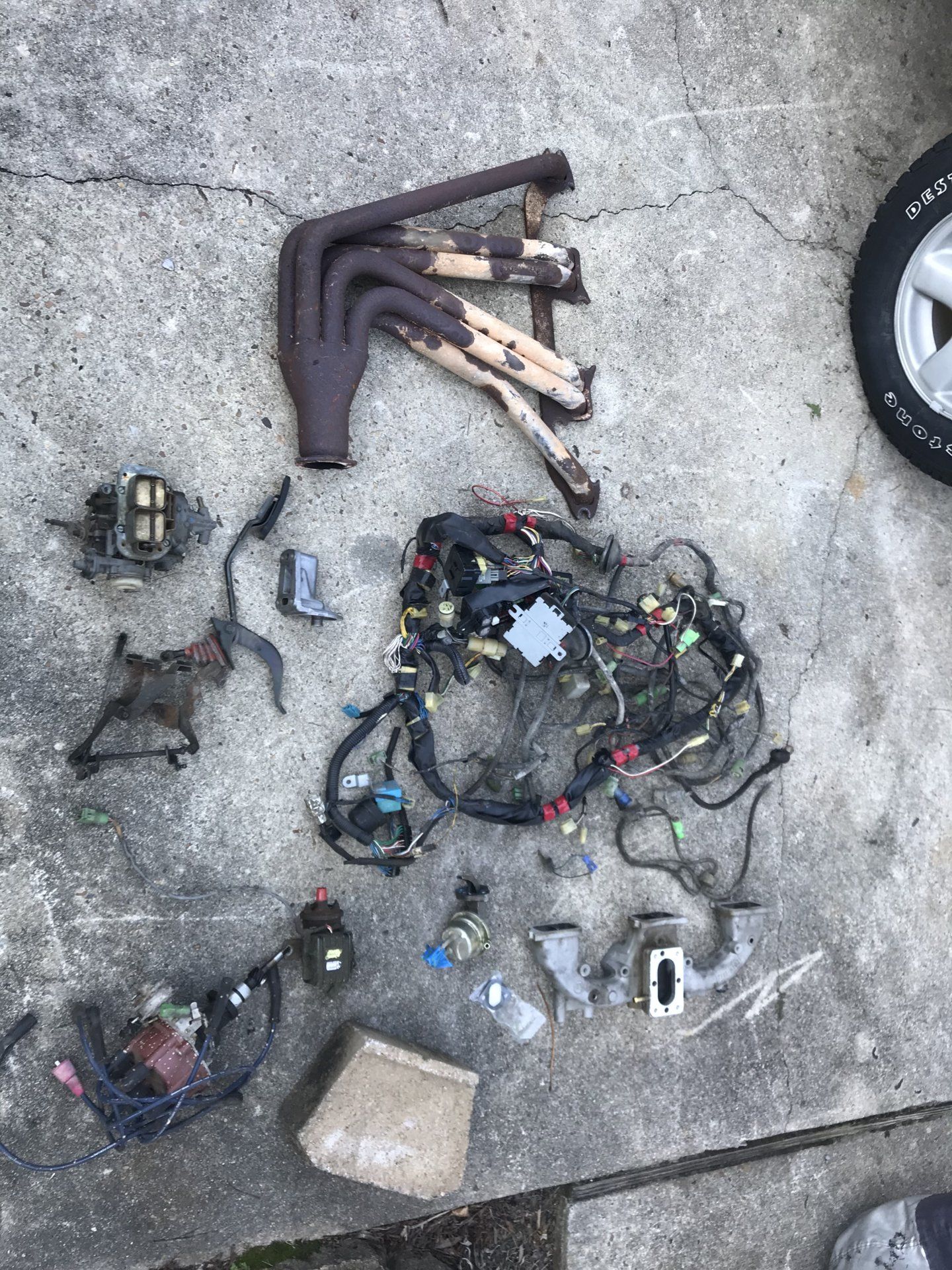

Also picked up
-FJ60 fuel tank
-fj60 dizzy and ignited
-good Webber carb with rebuild kit
-desmogged intake.
-a rusty but supposedly leak tee set of 2F TRI MIL headers
-low mileage mechanical fuel pump with brand new spacer
-intake gasket
-fj60 pedal assembly and linkage
-a complete FJ60 cowl harness with modules
-FJ40 oil filter housing
(this will be nice. My cooling system will only have 2 hoses going back to the front heater since I already deleted the rear heater and piping. Although I may add a fluid riser later.)
Also got a picture of the FJ62 cowl harness and FJ60 cowl harness side by side for research purposes.

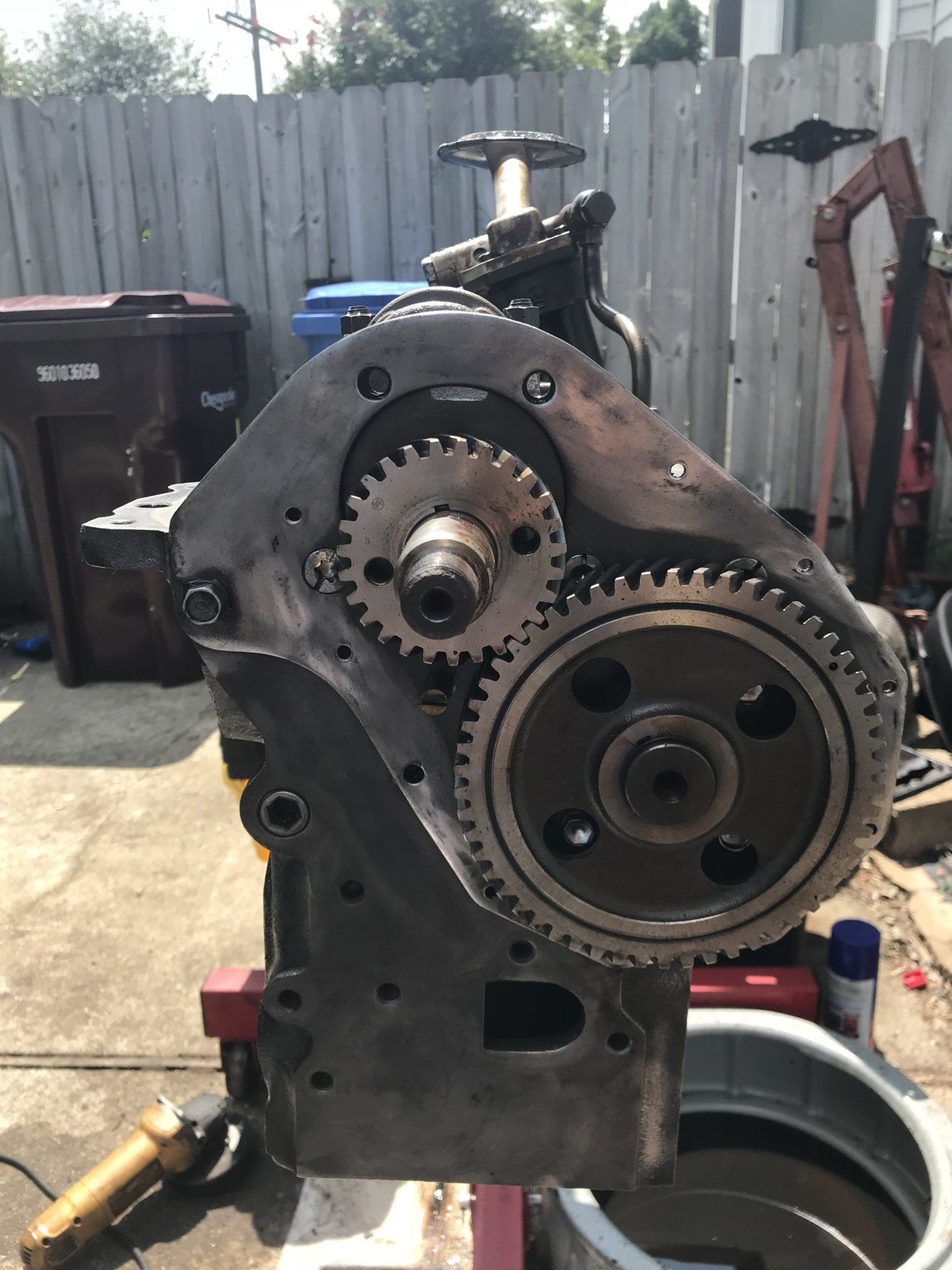

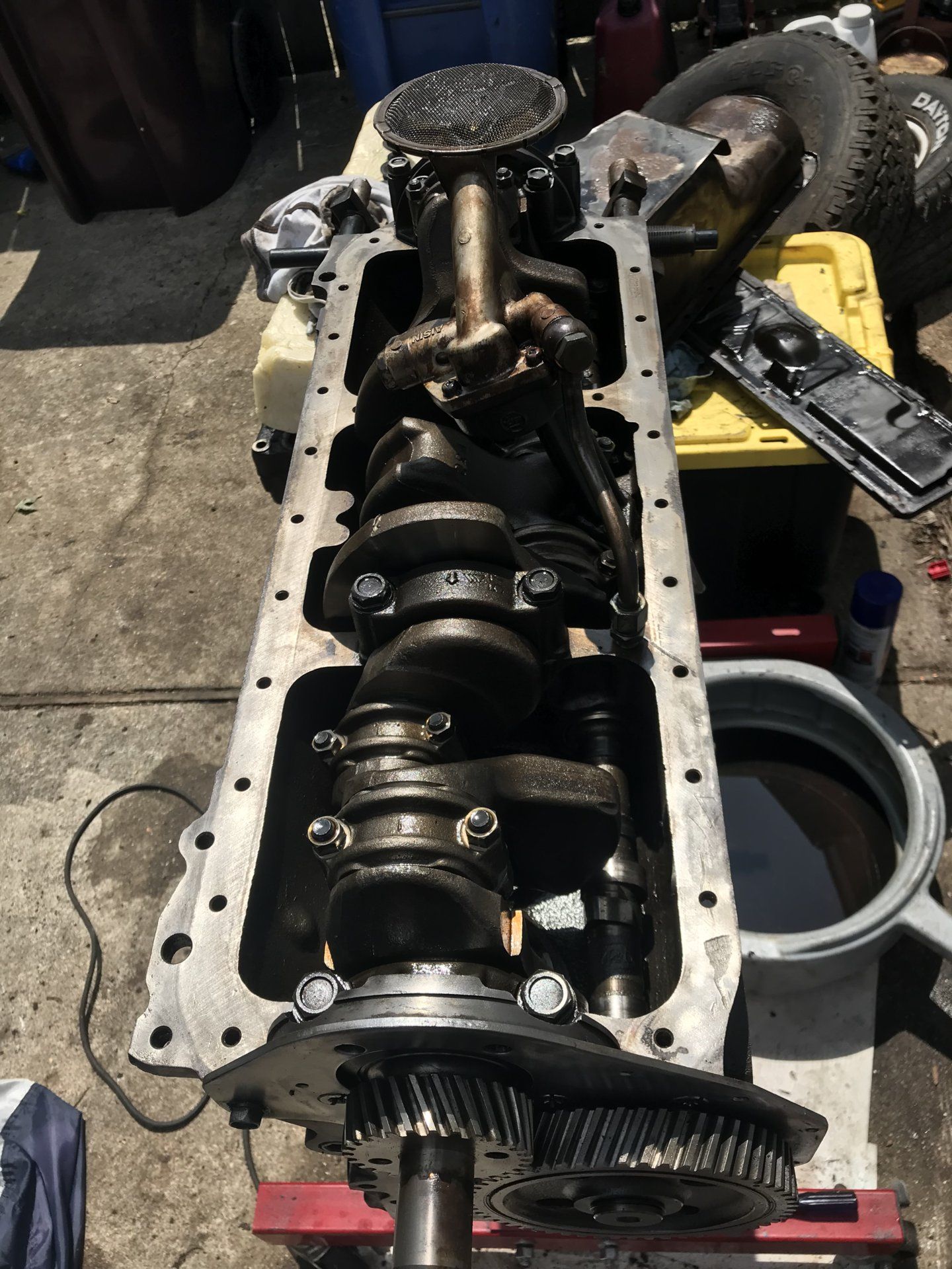

Figured Swap my red oil pan and timing cover from my old 3Fe to the 2F and change the gaskets in the process.
