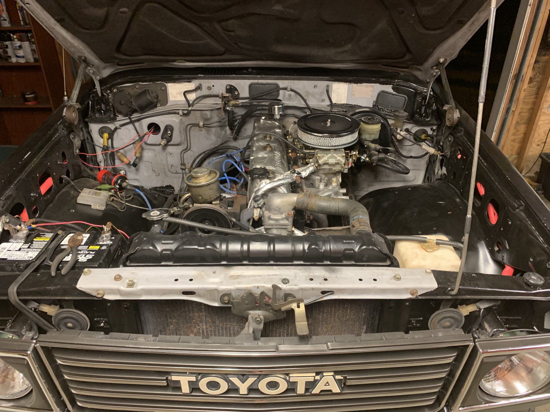

I just found this by chance. What a neat swap! I mean sure it wasn't easy but now the OP has my favorite body of these trucks, the 60/62 and the ease of repair of the 40. I mean look at all that extra room! That truck should be much easier to wrench on and will probably prove to be very relaible.
Just curious, could you not have gotten a 3F carb from overseas? The 3F engine came carb'ed in other markets.
But I agree the 3FE is a difficult engine to run nice. I had a lot of issues on my 3FE, but was able to get it running better by blocking the vacuum to the egr.
Now you don't have that to worry about. But having an older engine (than body) without pollution control will limit the places it can be registered. You could change out the firewall with one from an FJ60.... Have a new VIN and call it an 84.or so.
You working on that in a base garage and nobody gave you s***!? What I would have given to work on my s*** on base without having to go to the hobby shop!
good work. i remember seeing your CL ads with the parts in the back of a 80. I wondered what the parking garage connection was? hahaha,, i get it now.

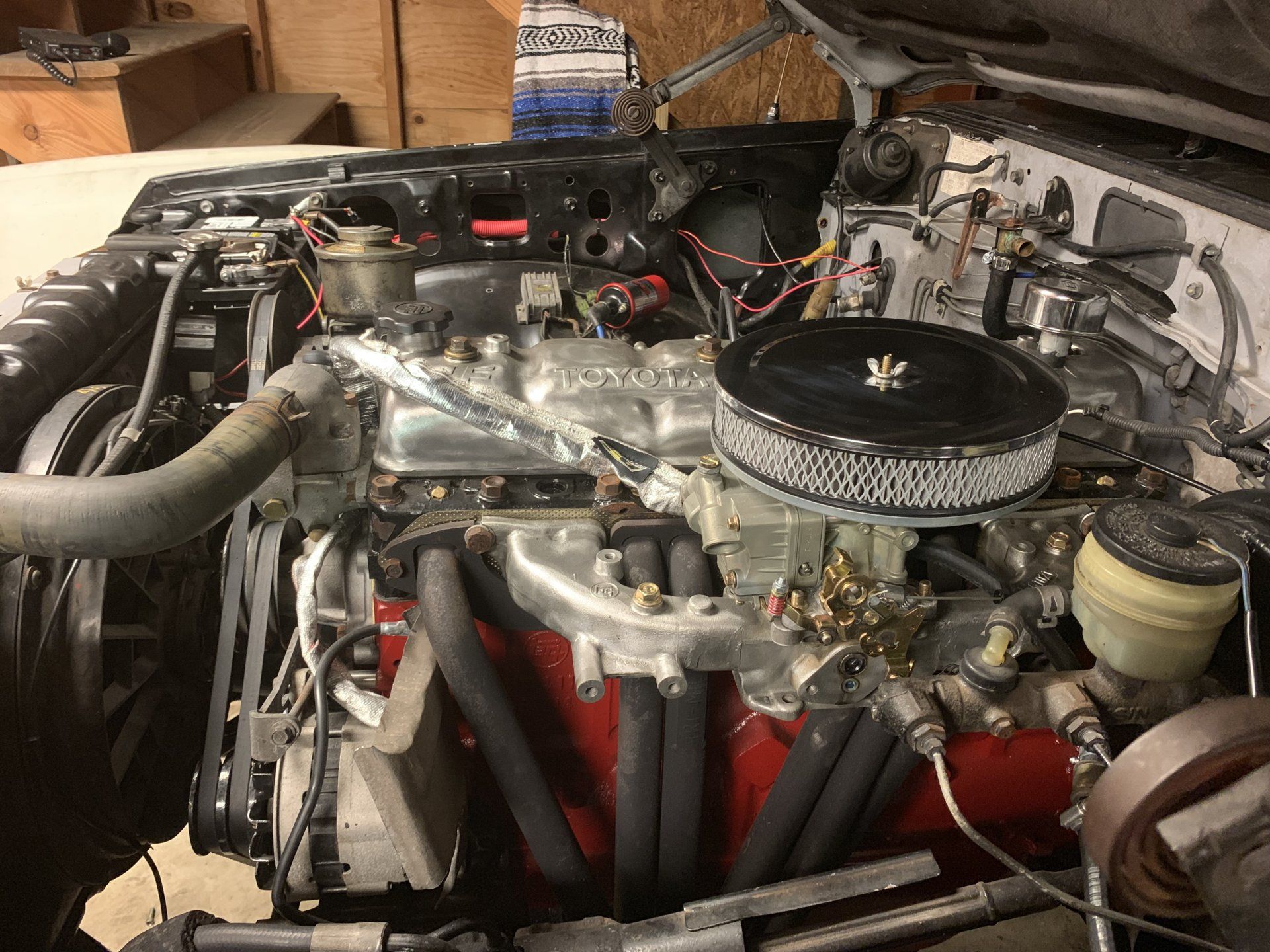

Man, I’d skin a late 2f head and run the square block with the 2f manifolds and carb...
I have the timing set at about 8 degrees of initial timing and it revs quickly (for a 2F) and pulls my truck worth 35s very well.
Your funny. Pulls truck with 35s very well. Still chuckling...
Couple of questions. Don't they have smog checks there? Typically a no-no to put an older engine in a vehicle.
Good luck with the Holley. My experience is that they suck big offroad.
Looks good though. Enjoy!

Luckily there’s no smog in VA. I had heard a lot of bad things about holleys on 2Fs that see extreme angles. This is a non issue for me because my truck won’t be seeing any extreme trails or god forbid large rocks. 🤮 The Holley works very well for daily use, and believe me, it really does pull very well....
You could also look into a Ford Motorcraft carb. I used to run those on my FJ40. They have a Holley bolt pattern but don't suffer any of the off-camber issues that the Holley's do. They were used on literally millions of Fords. I've had great luck with them in the past. Very simple carb, pairs nicely with the 2F motor. Enjoy!

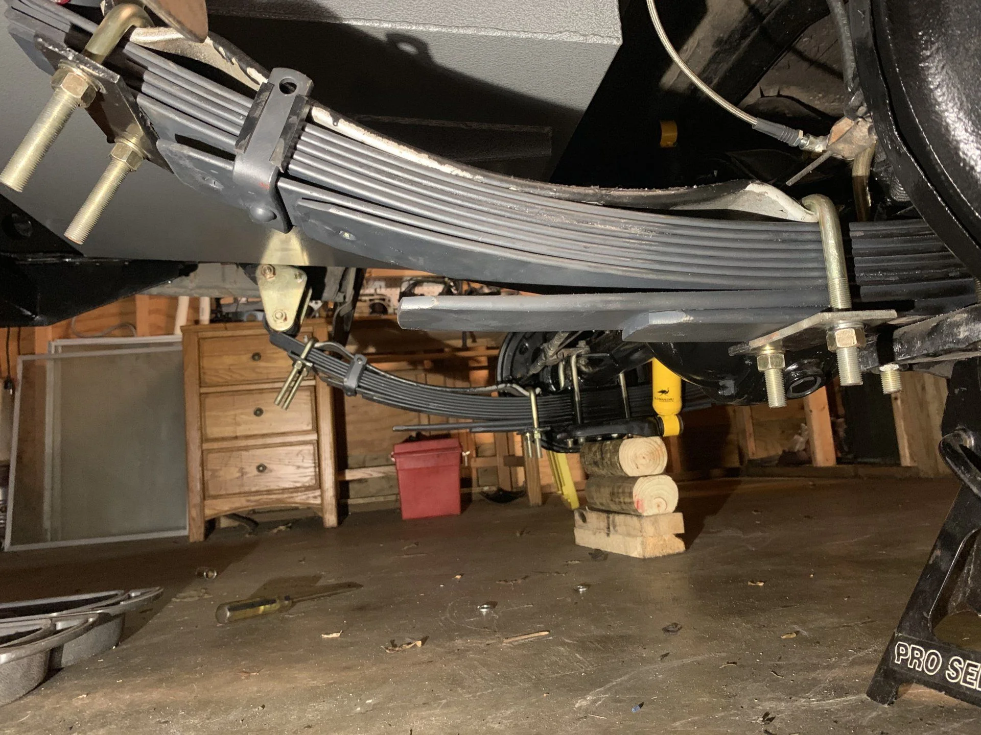

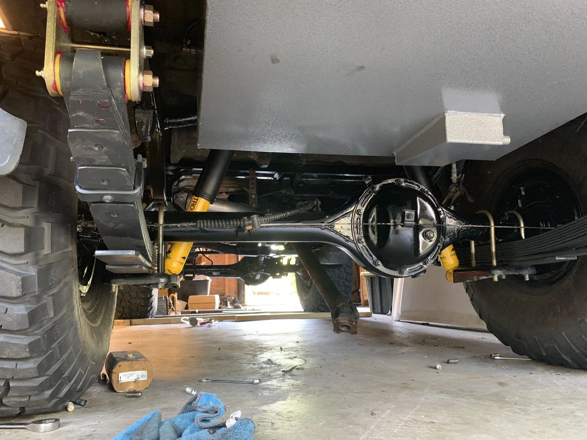

-The biggest being the fact that the PO did a halfass job converting it to SOA and SOA just sucks in general. The shock mounts are too short to mount a stock shock and the lift and tires are too big.

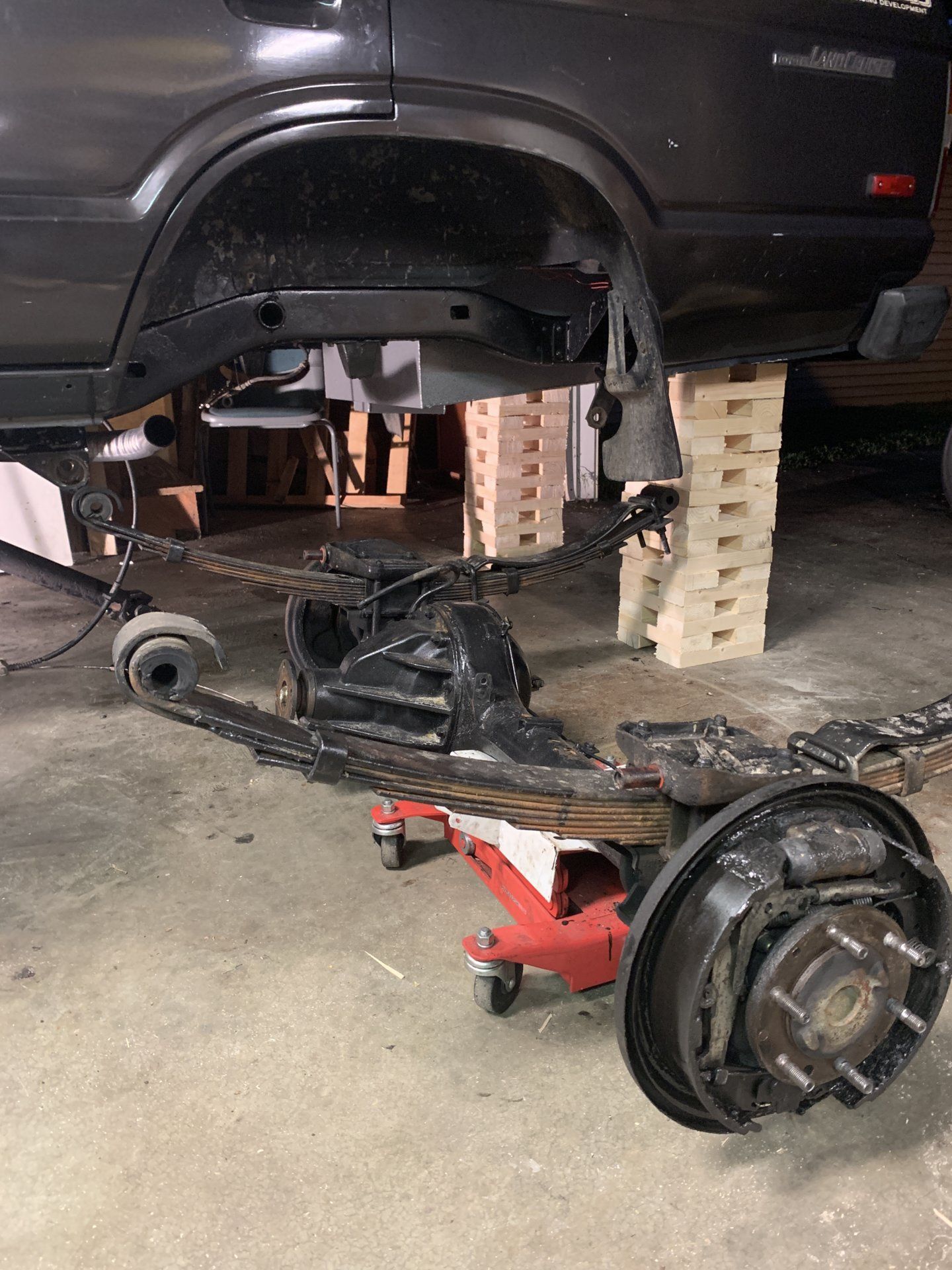

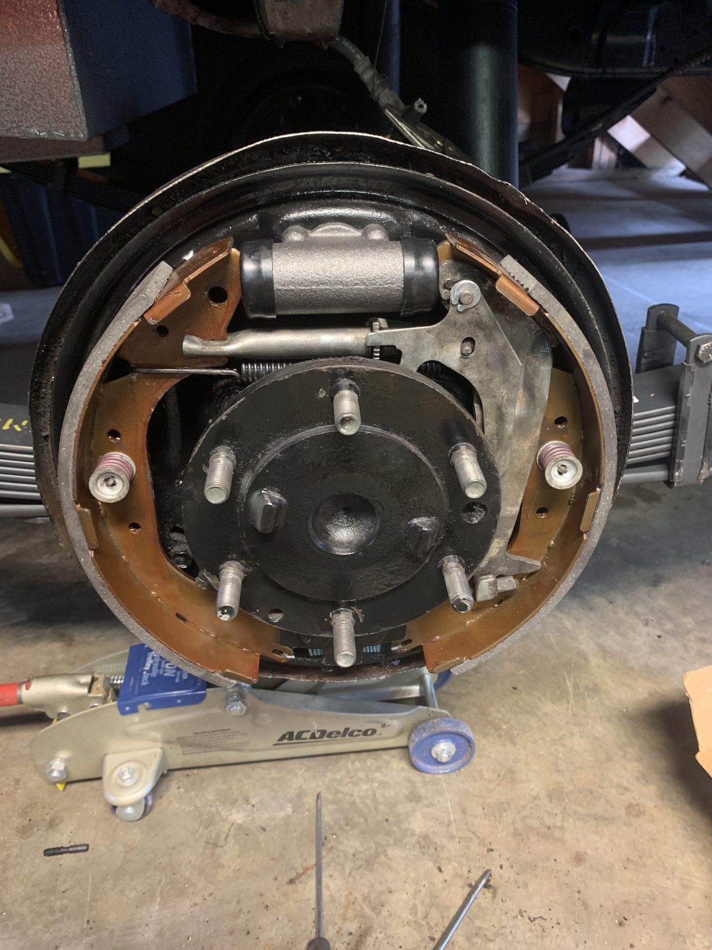

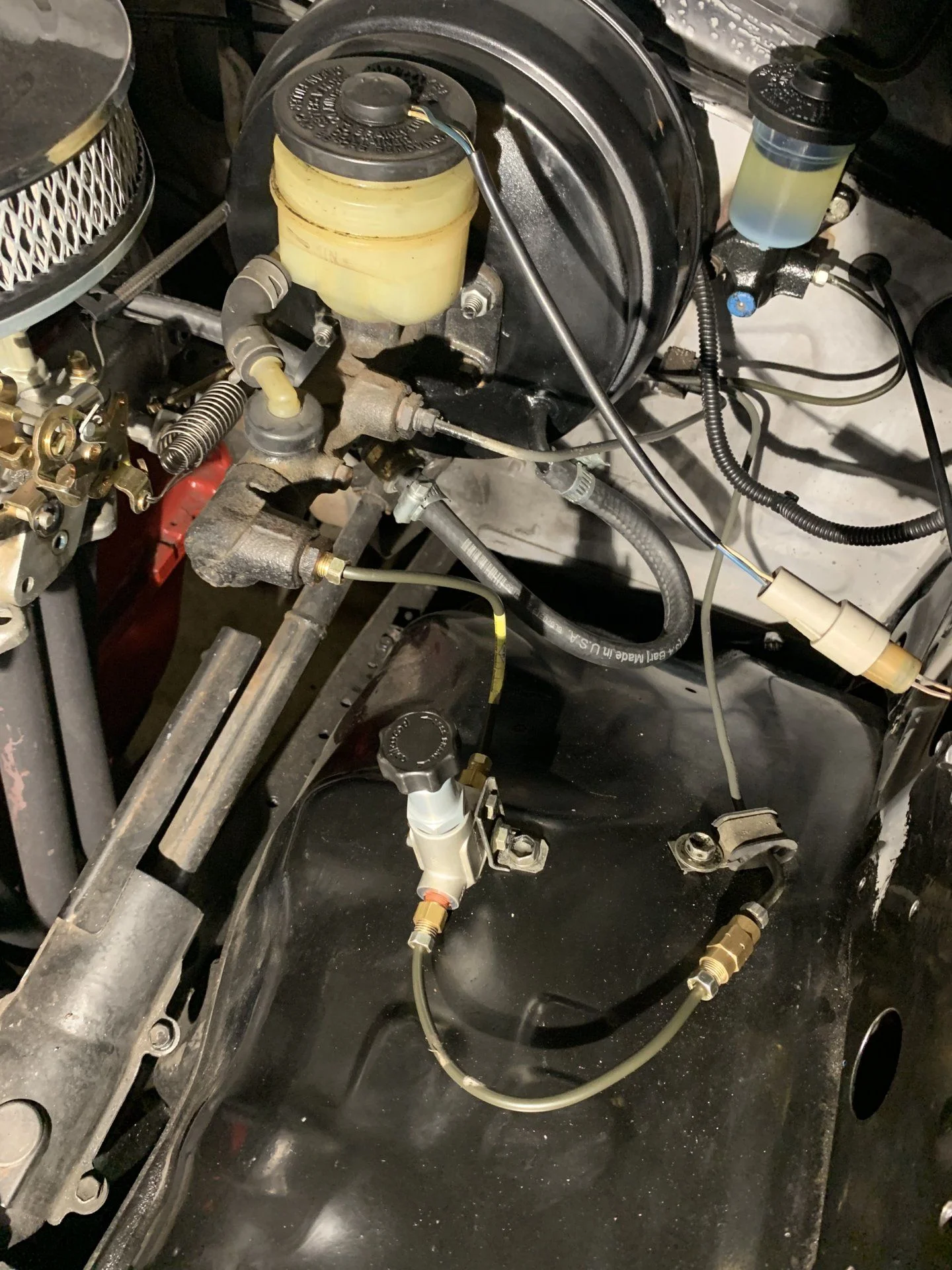

-I also needed to rebuild the rear brakes and add a proportioning valve and new brake booster.
-also the way the trans was mounted was absolute trash luckily I have a short H42 and 1983 crossmember but no shift linkage for it.

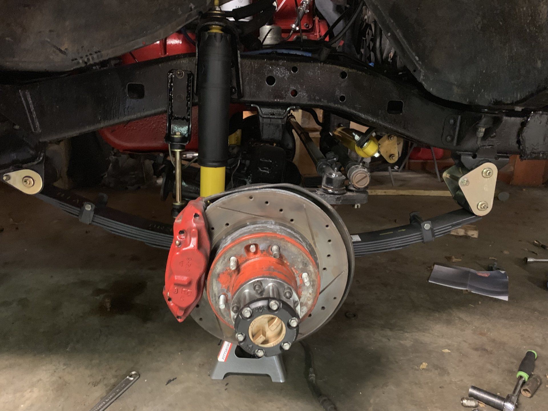

While I was on deployment I saved up a bunch of money. I bought a ton of parts and I have a huge garage so I splurged on a ton of parts
-MAF 38 gal tank
-AA twin stick and t case reseal

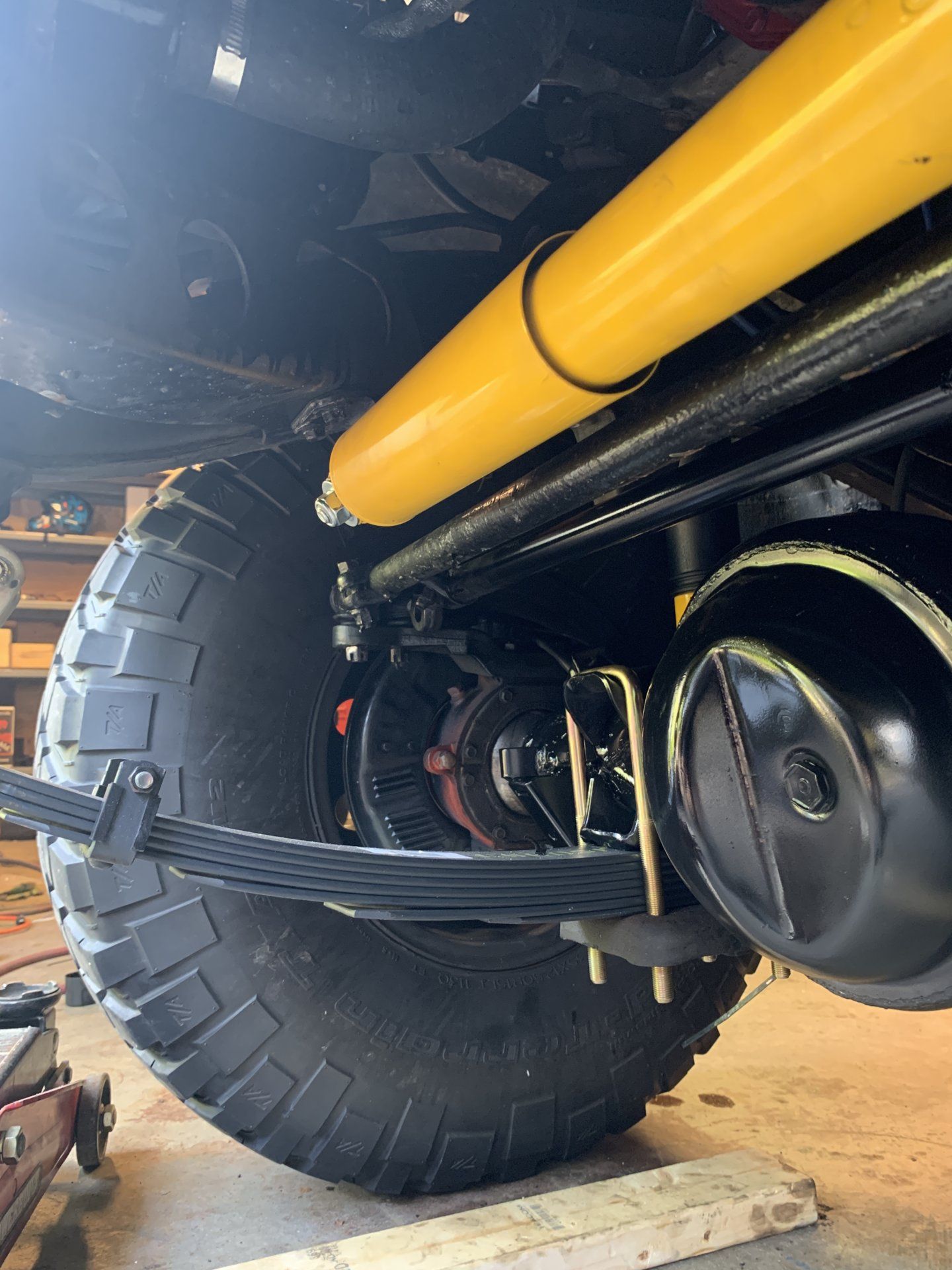

-OME heavy plus lift kit from Kurt at cruiser outfitters
-Gobi stealth rack
-Pro comp 17x9 wheels+BFG AT Ko2s 275/70r17

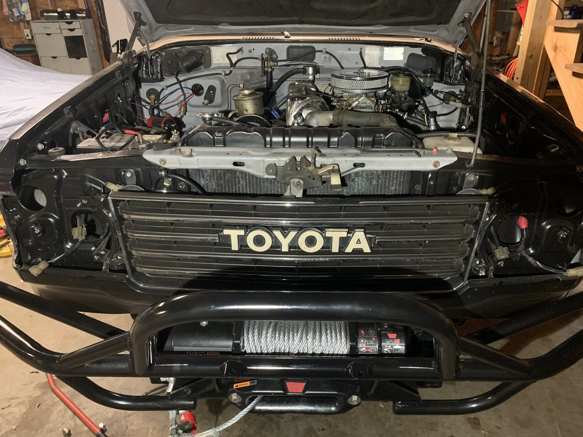

-Warn VR1200 winch

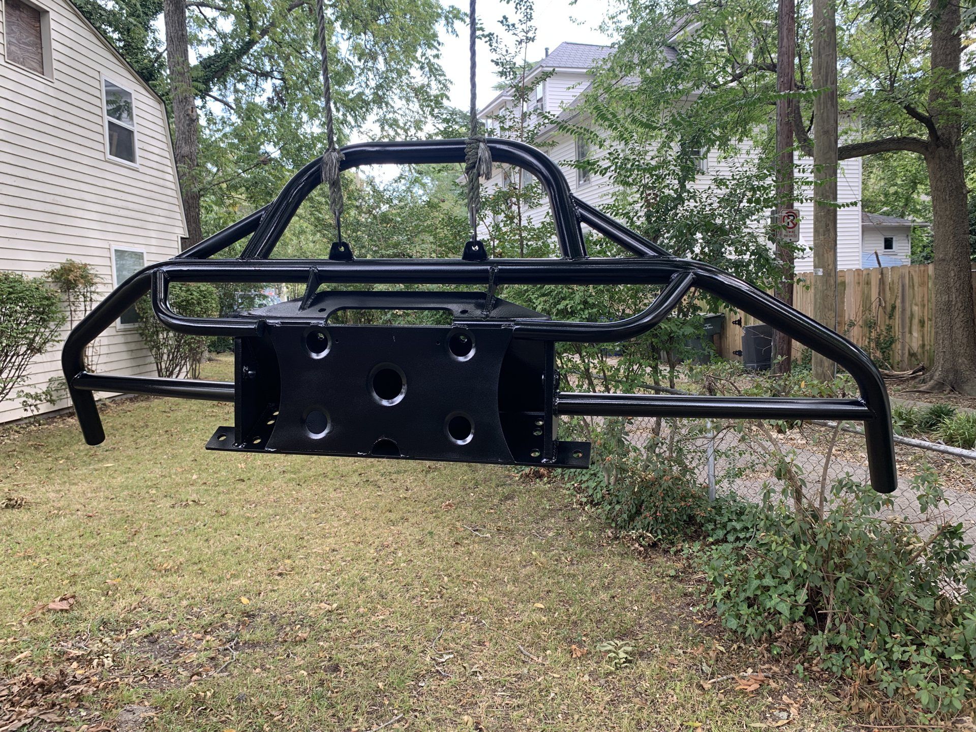

-addicted Offroad tube bumper
-hitch mounted motorcycle carrier
Also lots of little parts

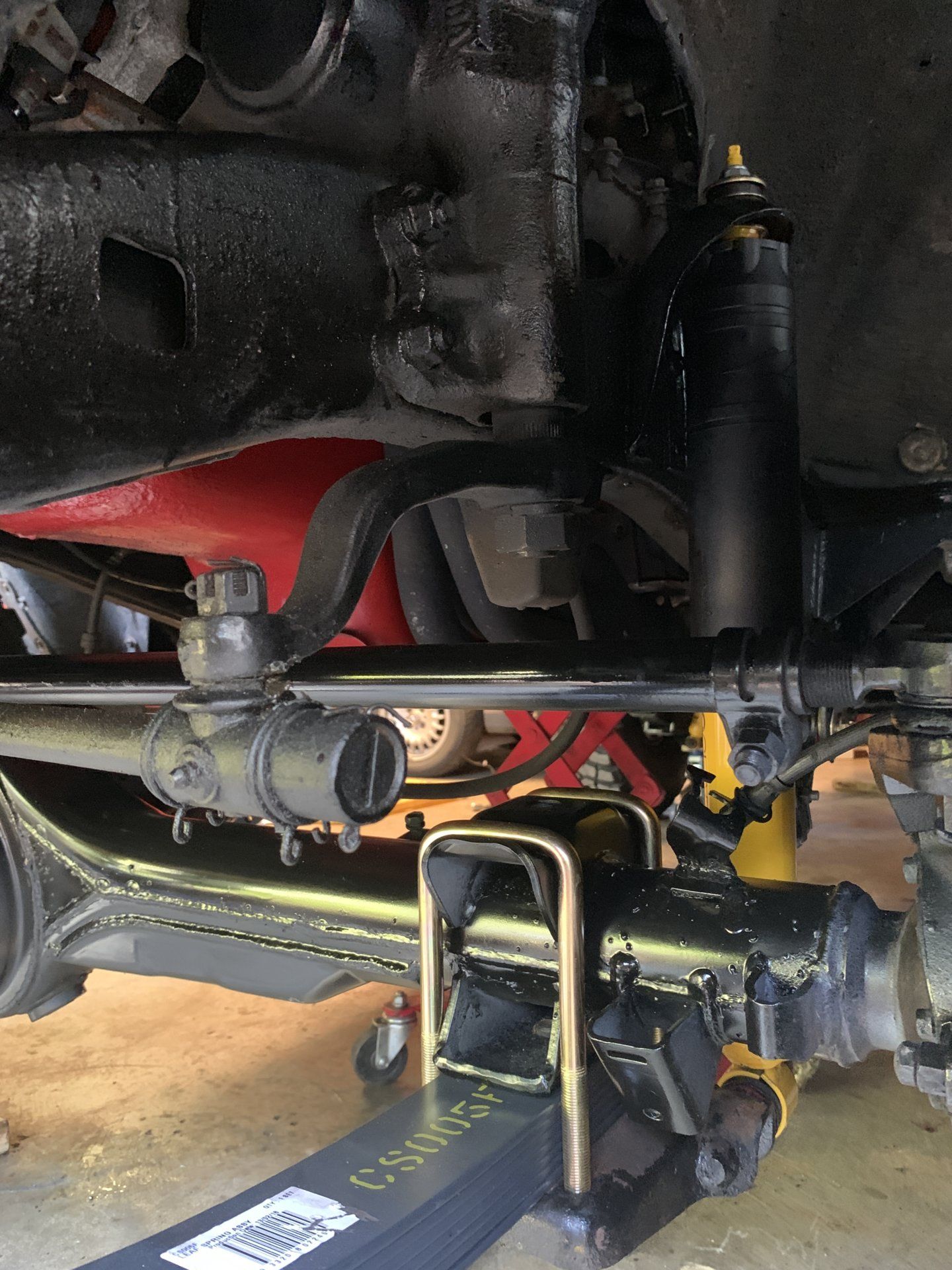

-didn’t have sway bars before so I added a front sway bar with oem Toyota bushings and brackets.
-4 runner brake booster
-new asin clutch master and slave cylinders
-MAF stainless brake lines

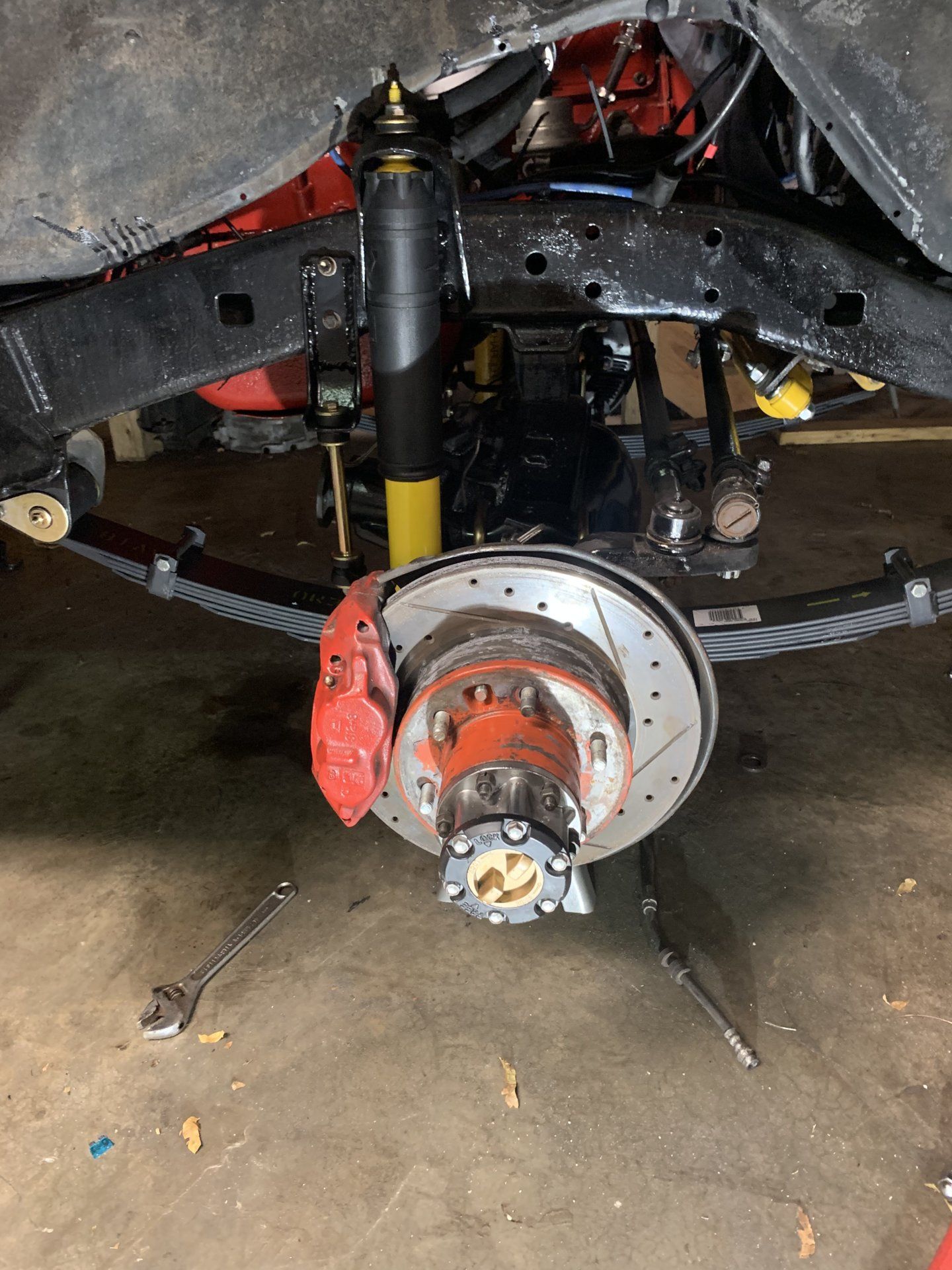

-willwood proportioning valve
-rebuilt rear Driveshaft+ rebuilt double Cardon front Driveshaft.

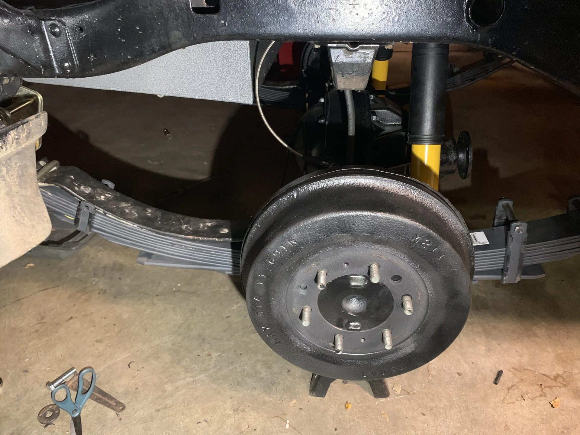

-new rear drums, brake cylinders and pads

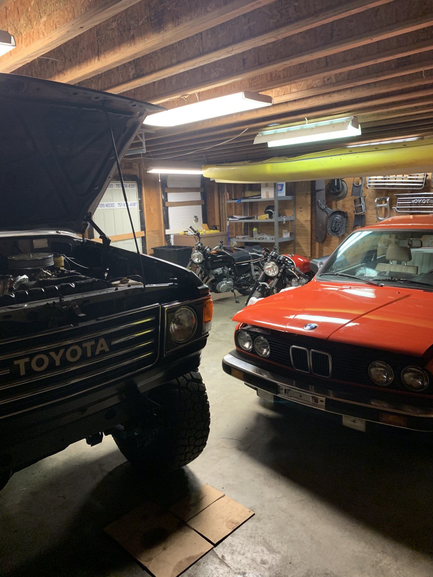

Oh, and that henna red 1984 E30 318i is my new daily.
My FJ60, e30 and my motorcycle have a nice garage they stay in.

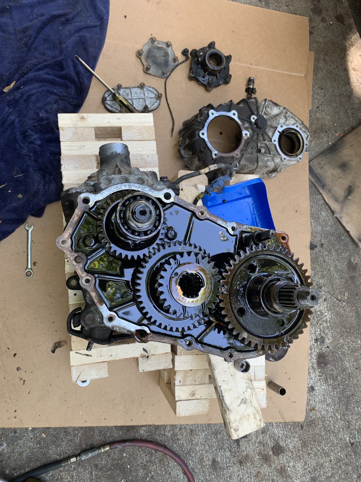

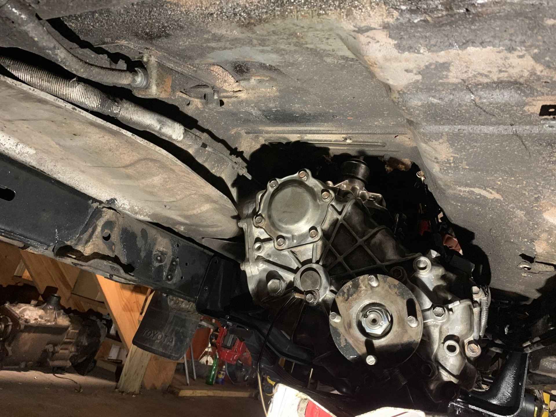

Rebuilt the rear brakes, reasealed the Tcase on my short H42 and added a new Mode select shaft.
My ome heavies with added helper spring off my old springs

Trans and crossmember going into place
Pay no attention to my sketchy jackstand lol
Will wood proportioning valve.

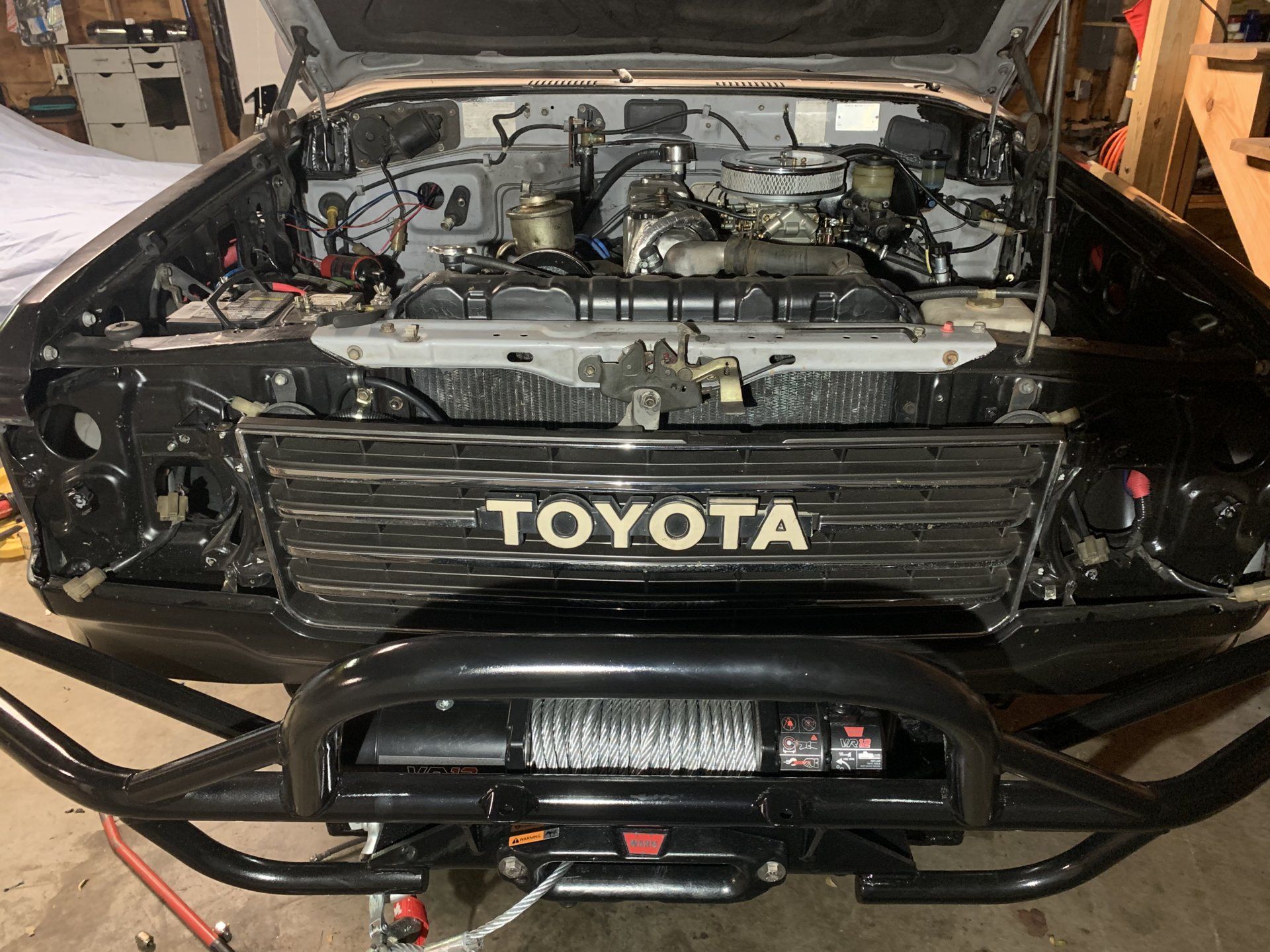

Bumper and winch mounted up. I’ll be mounting the control pack in the engine bay

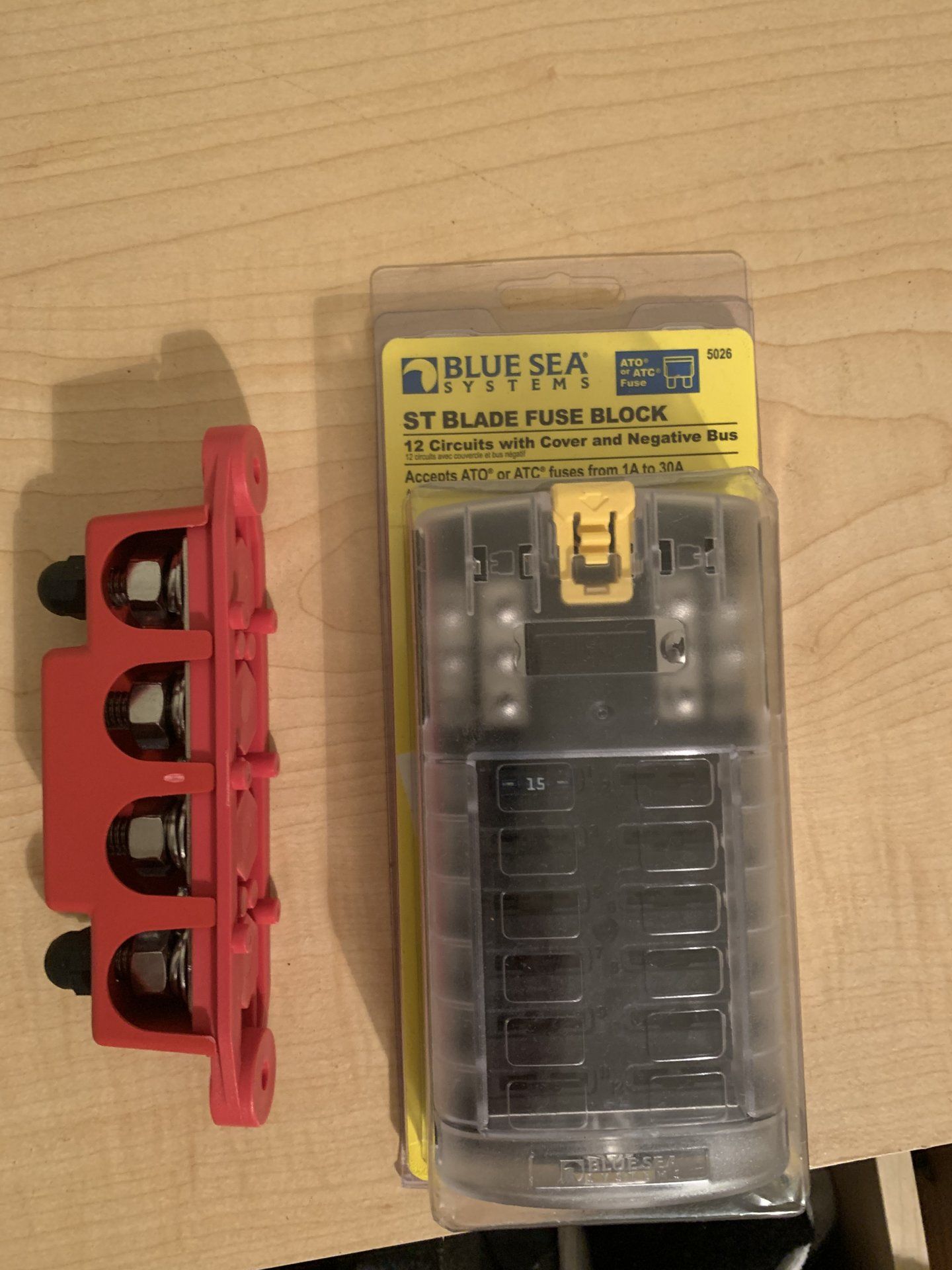

Next step is to revise the engine bay wiring. Right now my Volvo fan and USB charger/volt meter go directly to the terminal and doesn’t look great. I'll be adding lights on the roof rack and bumper and an under hood compressor and eventually an additional battery so it makes sense to add a power distribution block and fuse box.
The lights and compressor will be relayed and fused for safety.
I also need to convert my steering linkage back to stock since there isn’t much clearance with the hi steer setup
