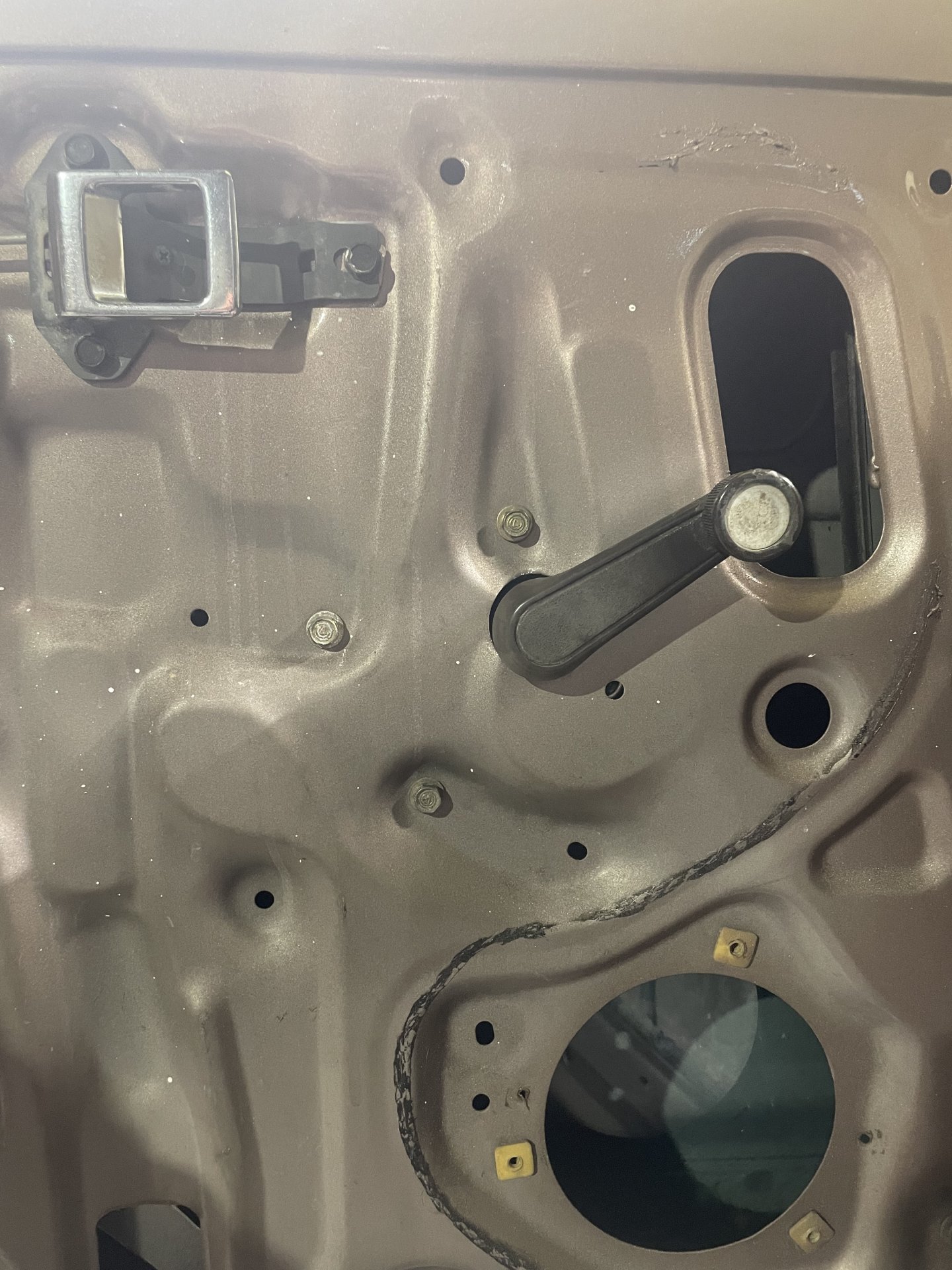

This is the driver side. The motor is installed correctly. Below is a picture of the same three bolts as @CenTXFJ60

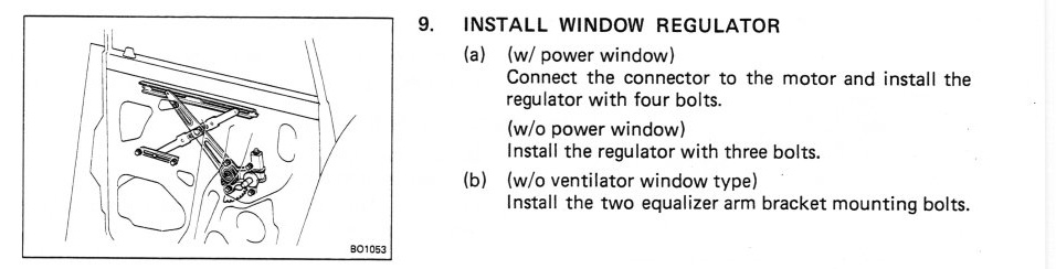

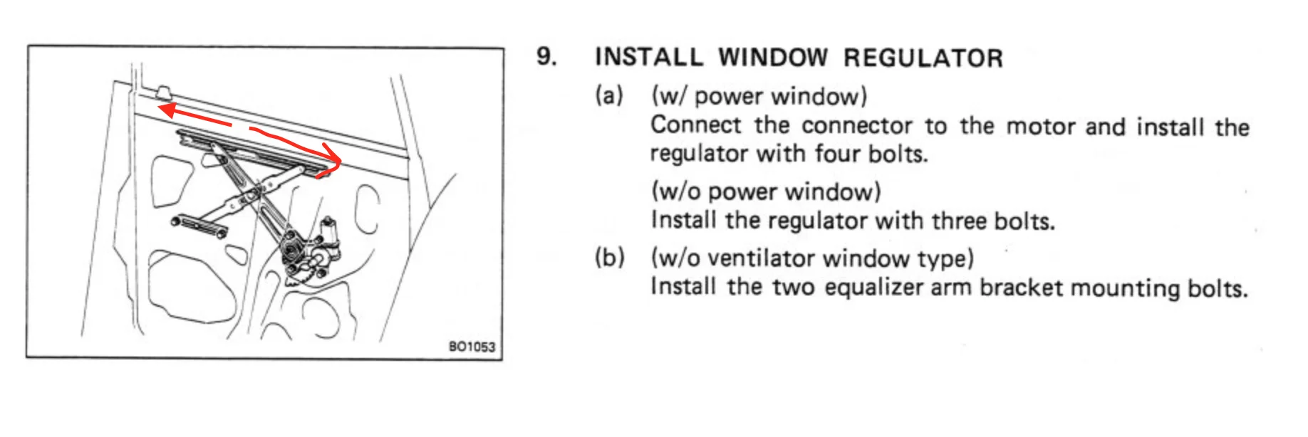

If I remember correctly from last time I did this there is some adjustment of sliding the lower linkage side to side. Seems like that could help? As 2mbb mentioned is the metal bracket thats attached to the glass positioned correctly?

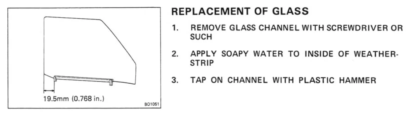

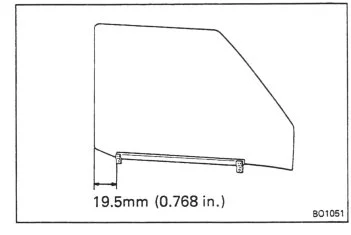

Looks like someone took the glass out of the metal channel that mounts the glass to the regulator. I see wood there. You may want to measure from the rearward side of the glass to the metal channel and see if it is the correct distance.
