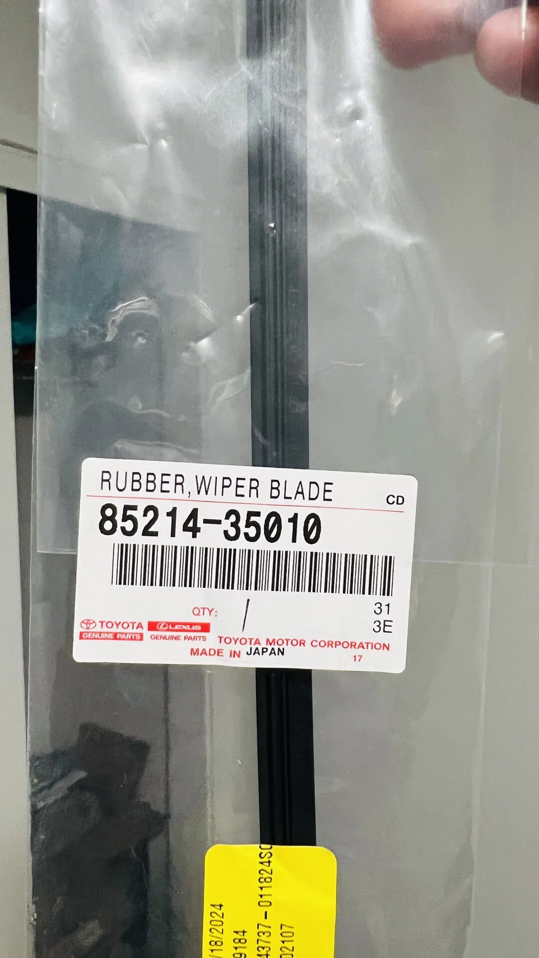

I’m curious the date code. It’s usually in black lettering bottom right of the sticker
This wiper, 85214-35010 was has “3E31” which means May 31, 2023. 3=2023, E = May, 31 js the day of the month
what he ^^ said.

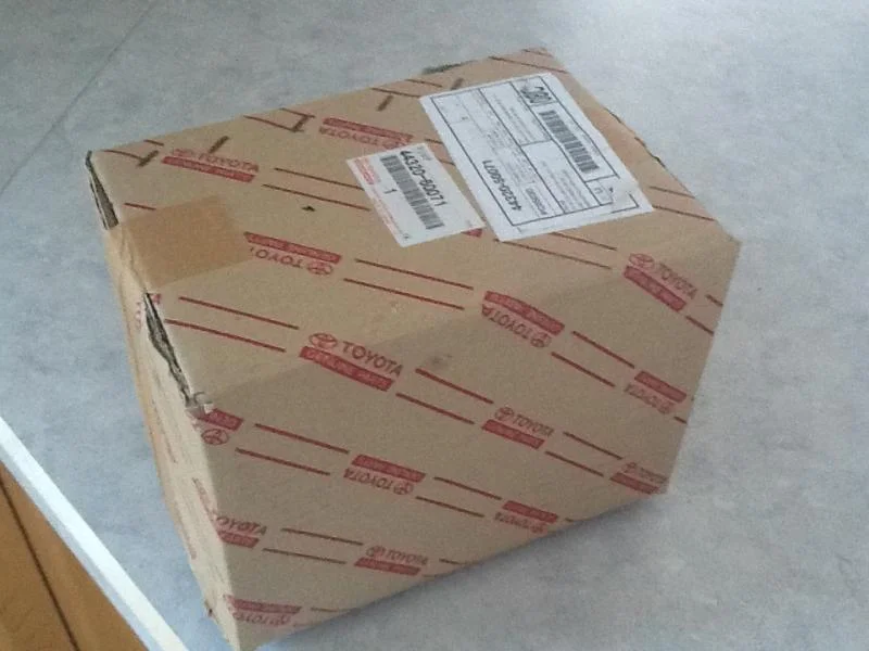

44320 60071
Unfortunately, you have the bad part number version that’s known to fail prematurely and catastrophically. Sorry to be the bearer of bad news. I’ll pm you a good address to send it to where I can properly dispose of it for you. I’ll even reimburse shipping costs once received in good, unexploded condition….
