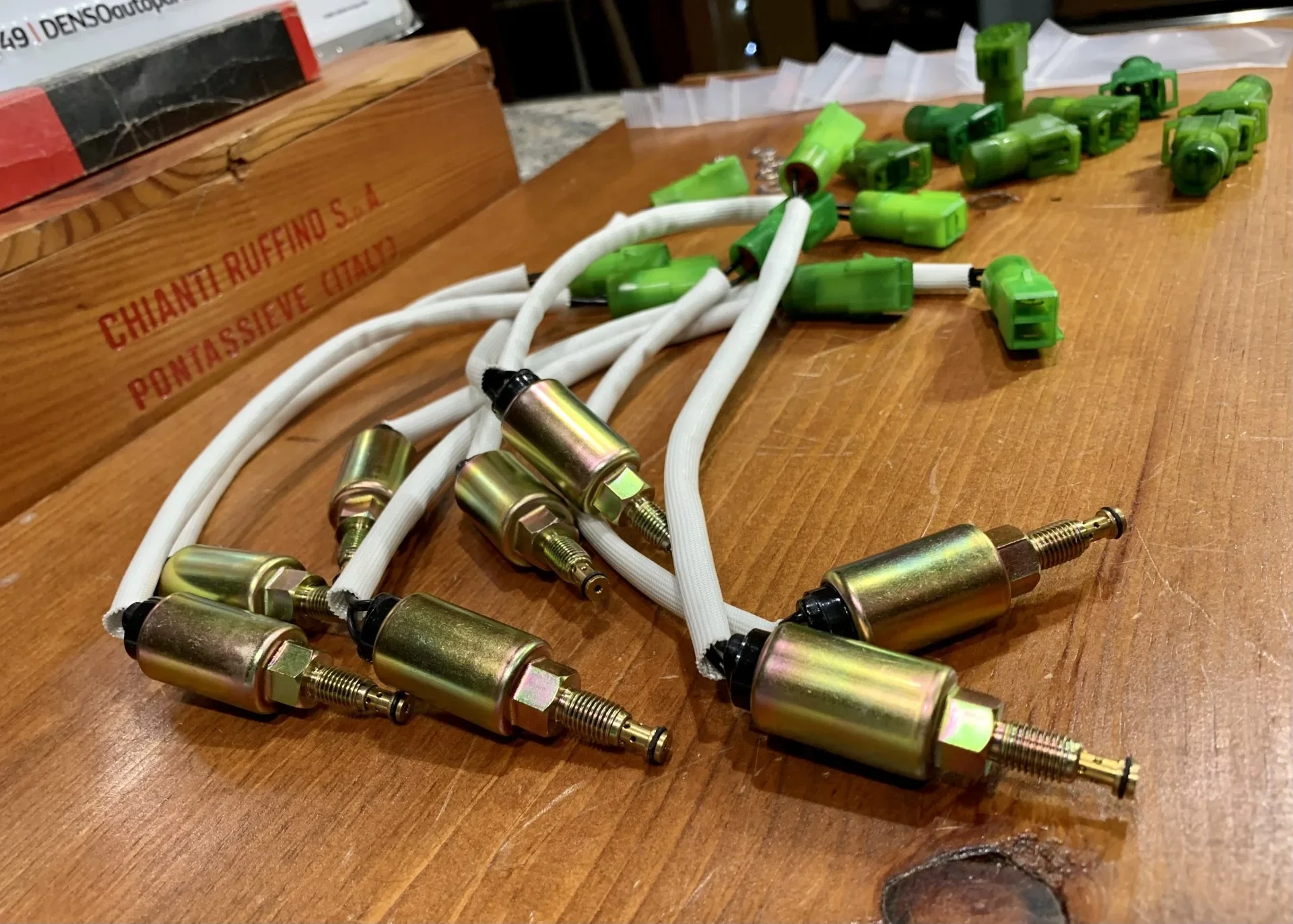

a few years ago ..........
i wondered why nobody on planet earth offered a 2-wire ICS / FCS for the
2F FJ40 FJ55 & FJ60 ?
you know the proper one , 2 wires , the square 2-pin OEM YAZAKI splash-proof Factory Green Connector Plugs and all ..........the Real McCoy ?
well , i decided to go for it and done got it going on , the ODD square 2 pin connectors female and male i had reproduced in JAPAN , the ISC / FCS is a MADE IN JAPAN aftermarket part ....
- all in all its totally TOP SHELF , al long as you make sure to lube up that tiny O-RING with some Di-Electric Grease .......
- so 21062-61060 was re-born and up to snuff too !
- i include the harness side female Connector plug and generous amounts ob the correct black w/ yellow tracer stripe 16ga wire and ground White w/ black tracer stripe , includes a OEM crush ring washer too ! PLUG and Play the TEq way

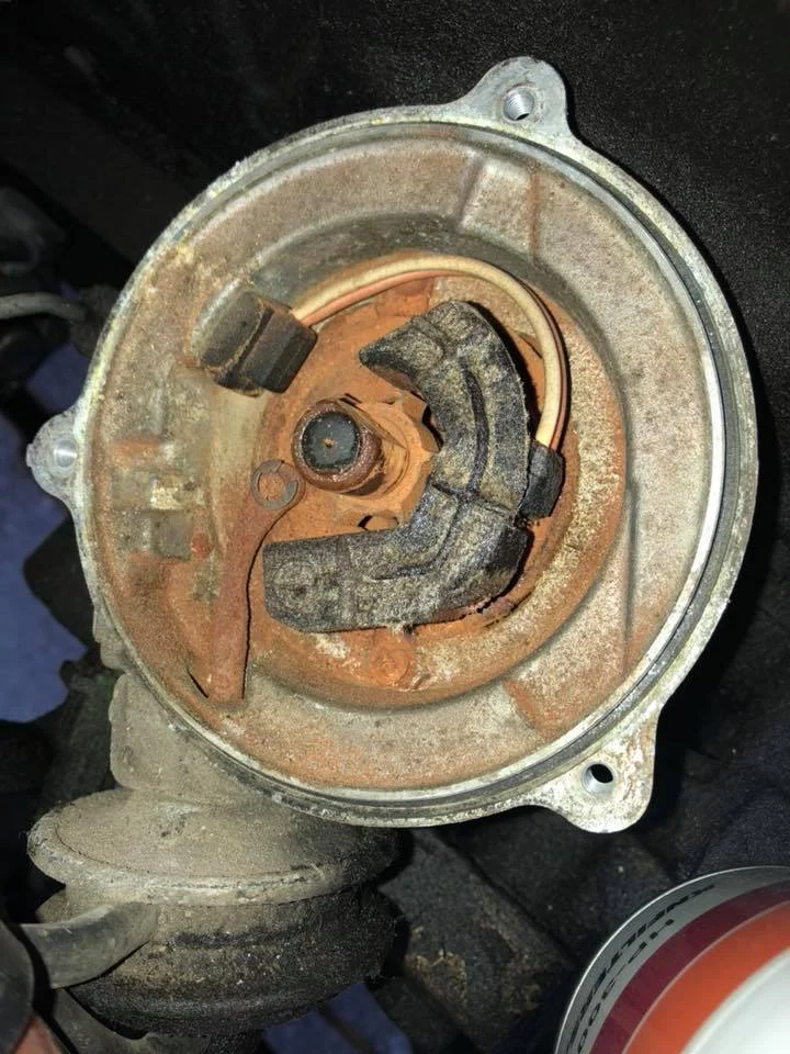

If you're asking about the VCV under the pass side of the Air Cleaner, that's there to control fresh air draw through the Distributor, under various engine parameters. You want that hooked up to keep the guts of the distributor from turning into this:
Ahh roger, thanks for posting that. So while the ICS and VCV need to be replaced, they are likely not the cause of my stumbling/stalling/hesitation?
Unlikely. When ICS is not working (for whatever reason) , truck won't idle, but otherwise seems to run ok above idle. It's an anti dieseling device.
