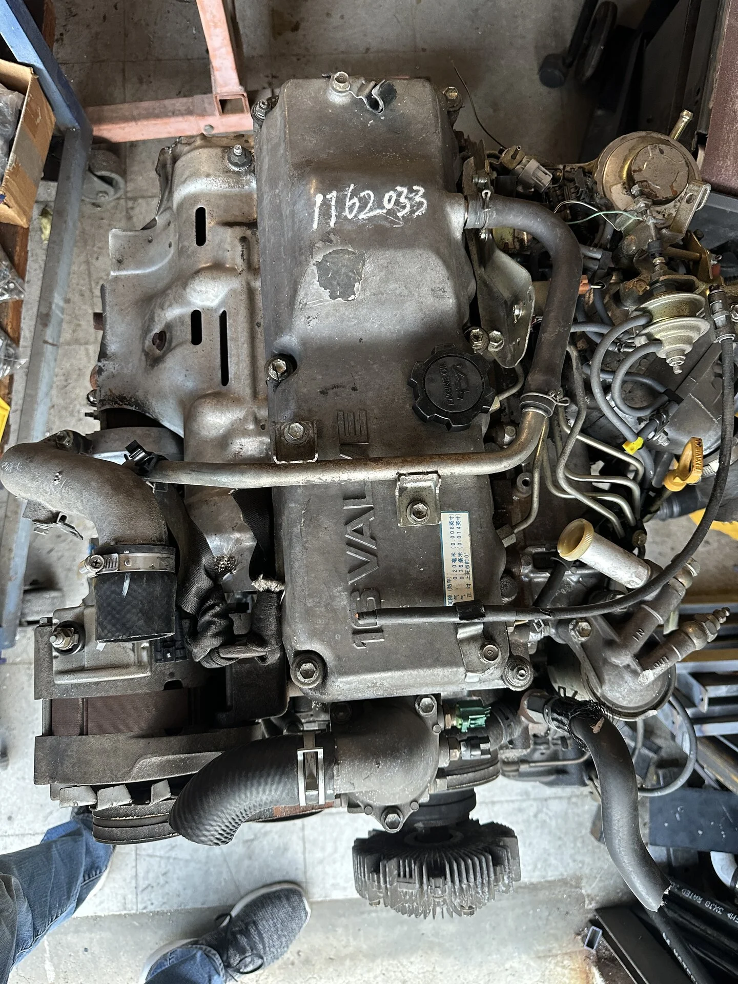

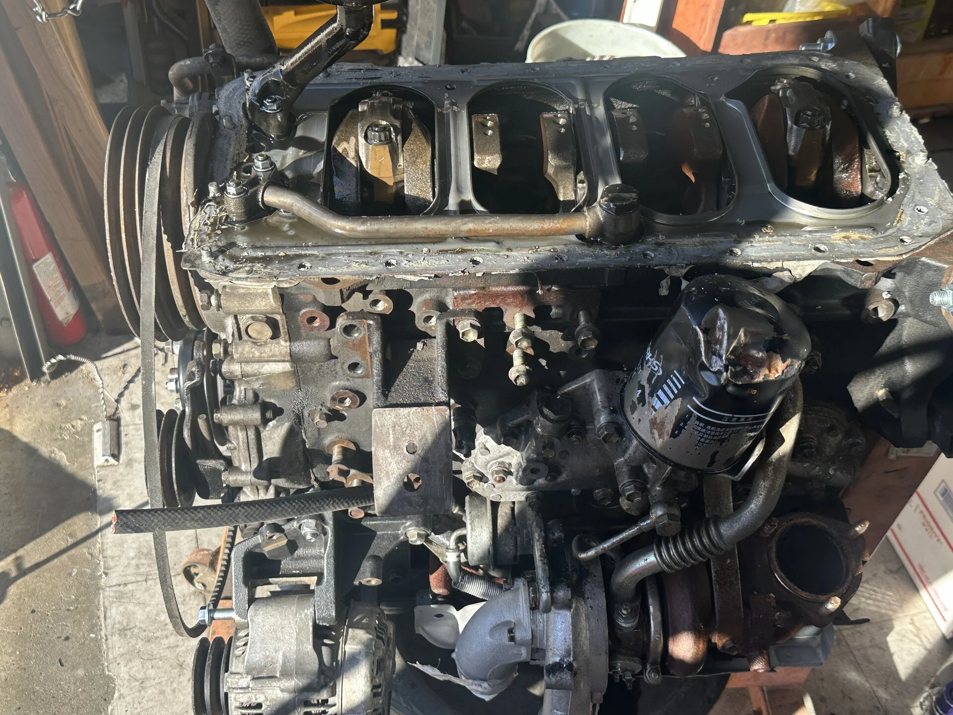

So the question was to rebuild the engine or put something that is running. My friend @AlbertoSD found 15BFTs that had about 100K miles that came from a Coaster bus. The price was less then a rebuild, so I figured that since I don't have anything better to do (traveling, building a troopy, woodworking, running a company, helping friends with their Landcruisers...) I'll take the project on. So it begins...

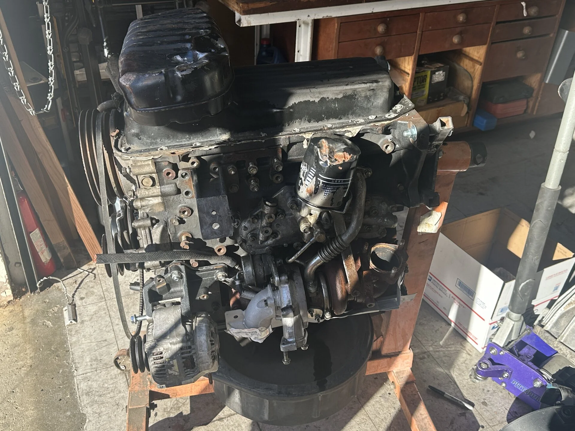

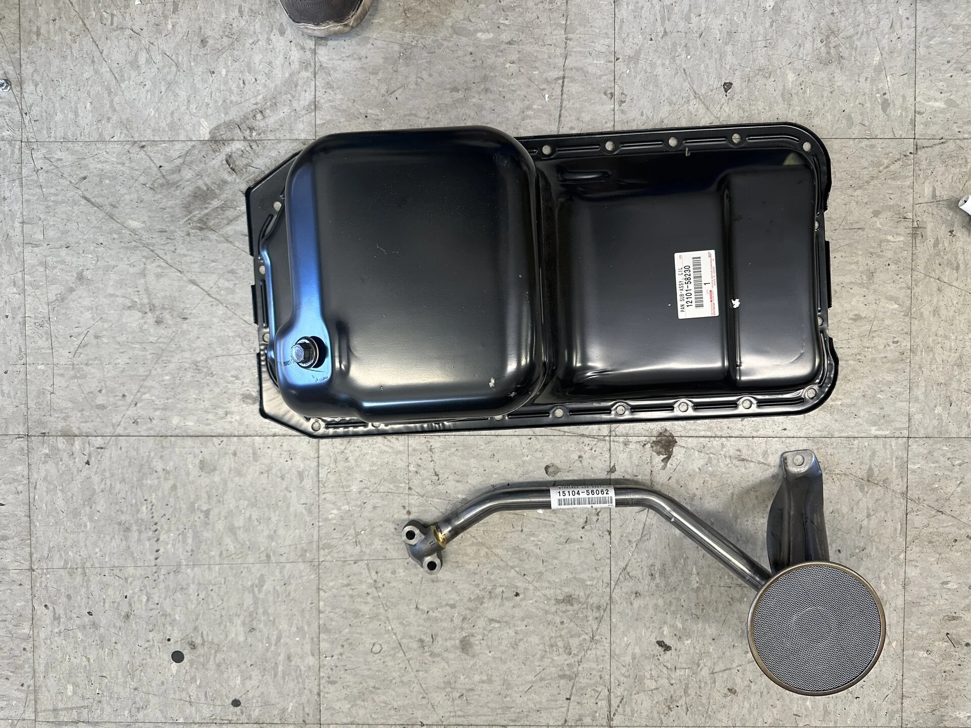

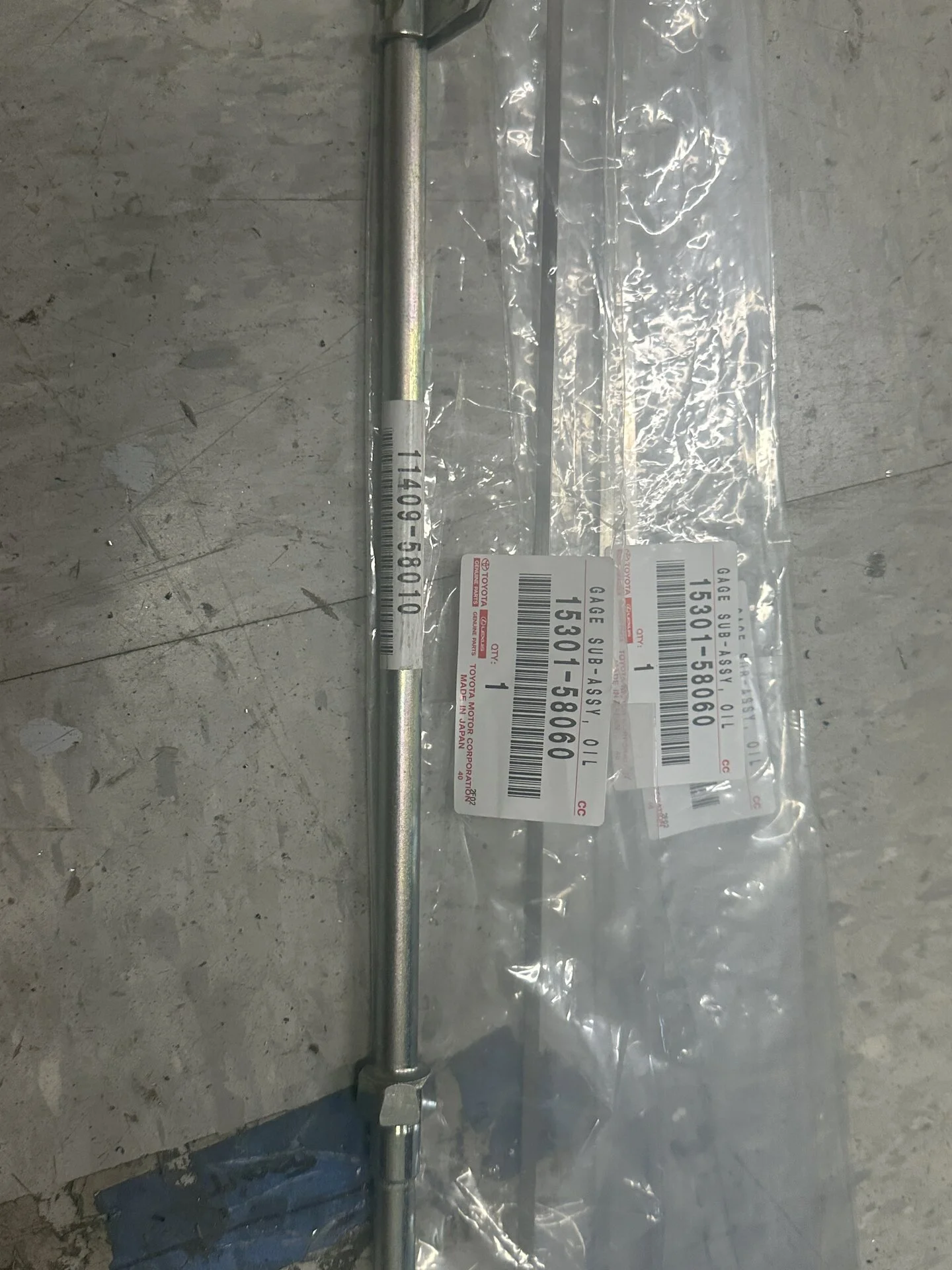

The engine arrived last week and I started working on it. Ordered from @Japan4X4 4 oil pans, pick up, dip sticks and turbo inlet and outlet. I can not say enough good things about Dave Stedman.

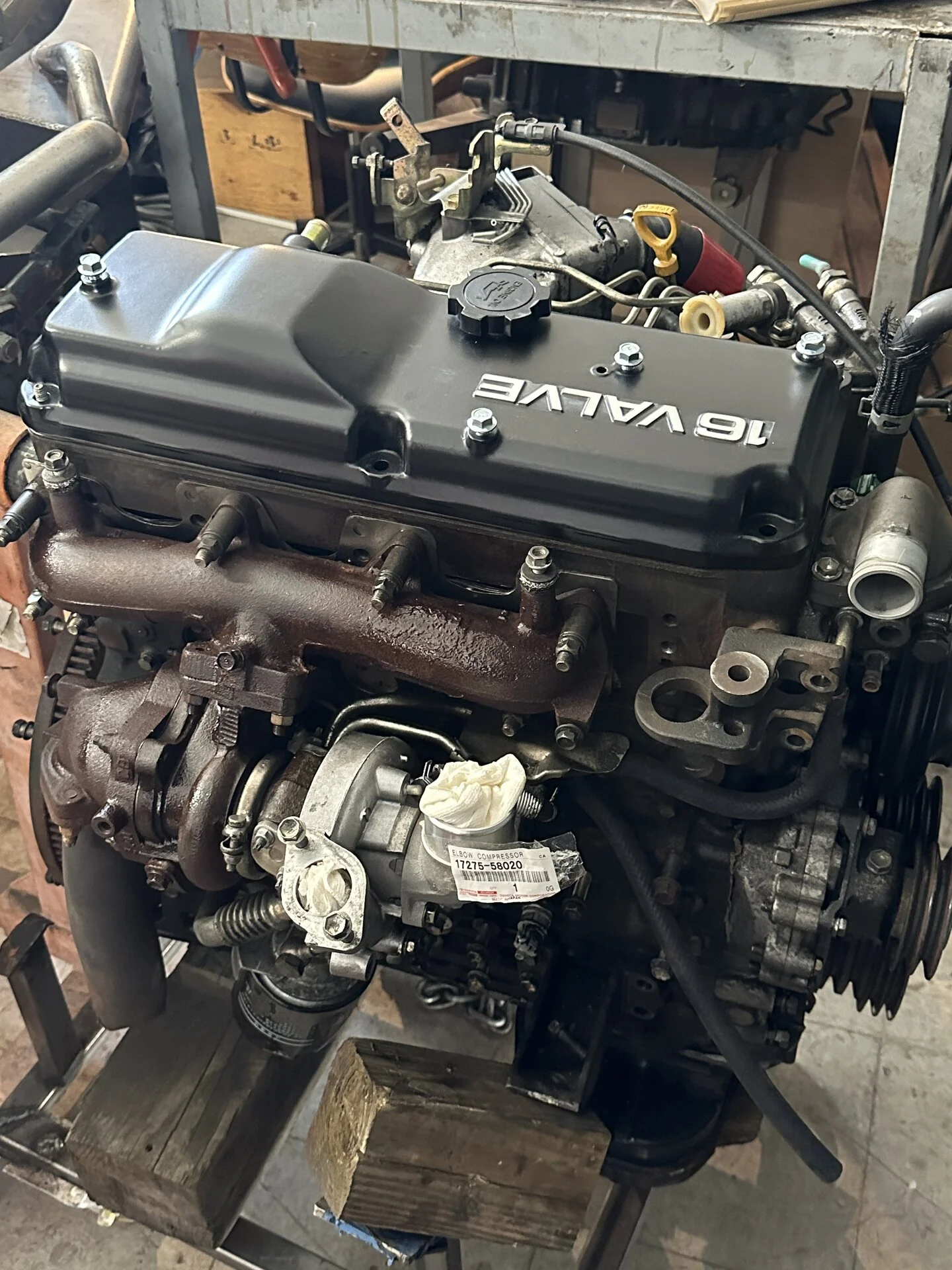

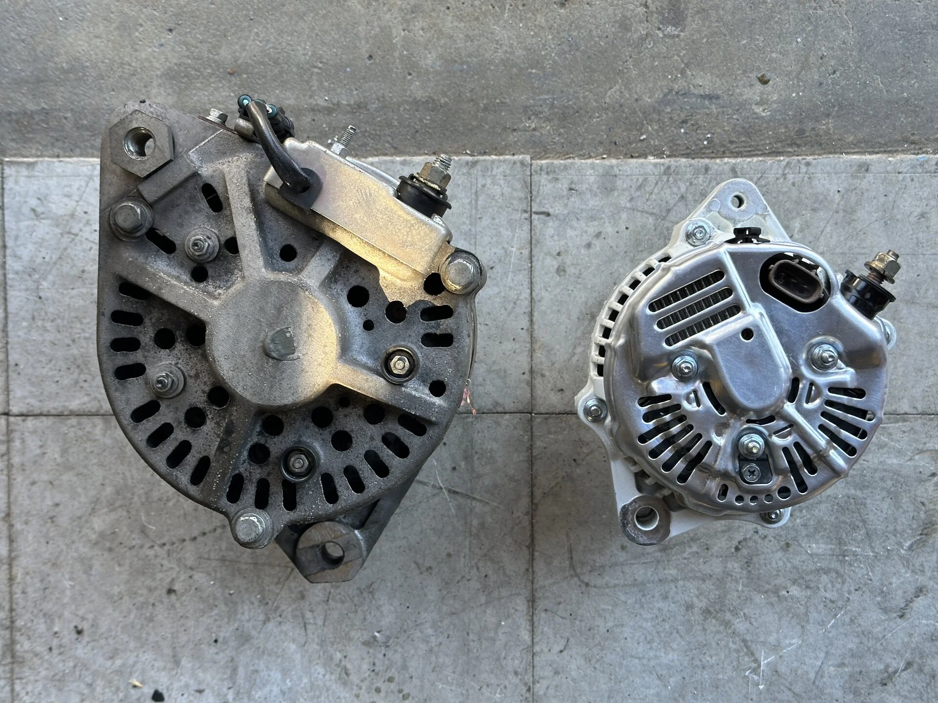

The valve cover was damaged with a hole and patched with some epoxy (you can see the patch). I removed it all and filled with aluminum epoxy that can sustain 500F and being powder coated. Next would be to replace the HUGE 24V alternator with a Terrain Tamer mated to a 1Hx, starter and AC compressor.

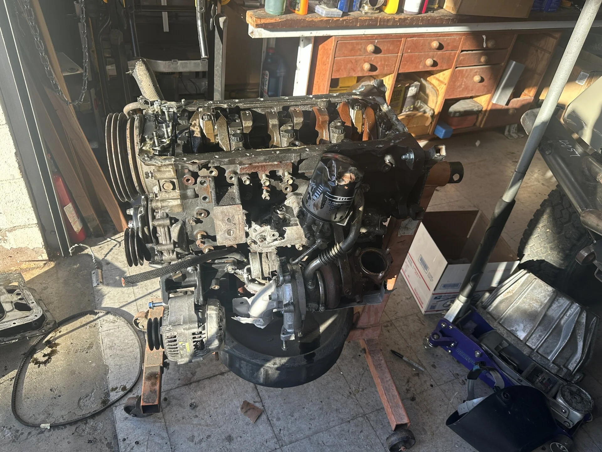

Today I loaded the engine on a stand and pulled the oil pan. Took a while. The 300 mm clutch/flywheel will not fit the aluminum bellhousing to mate the H55. Looking for options.

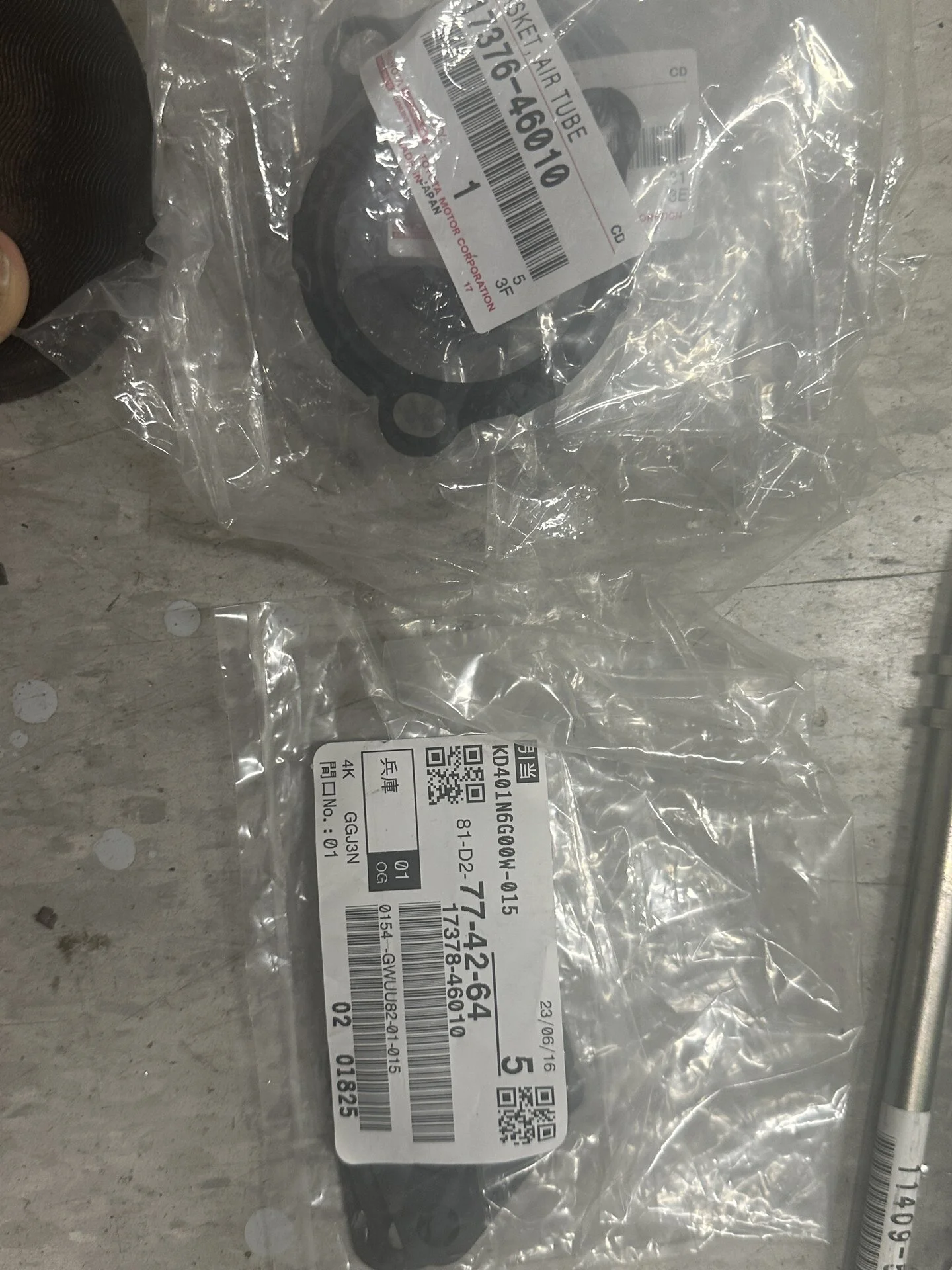

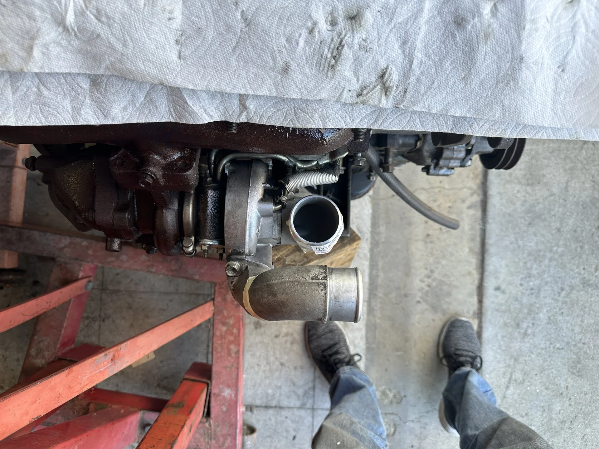

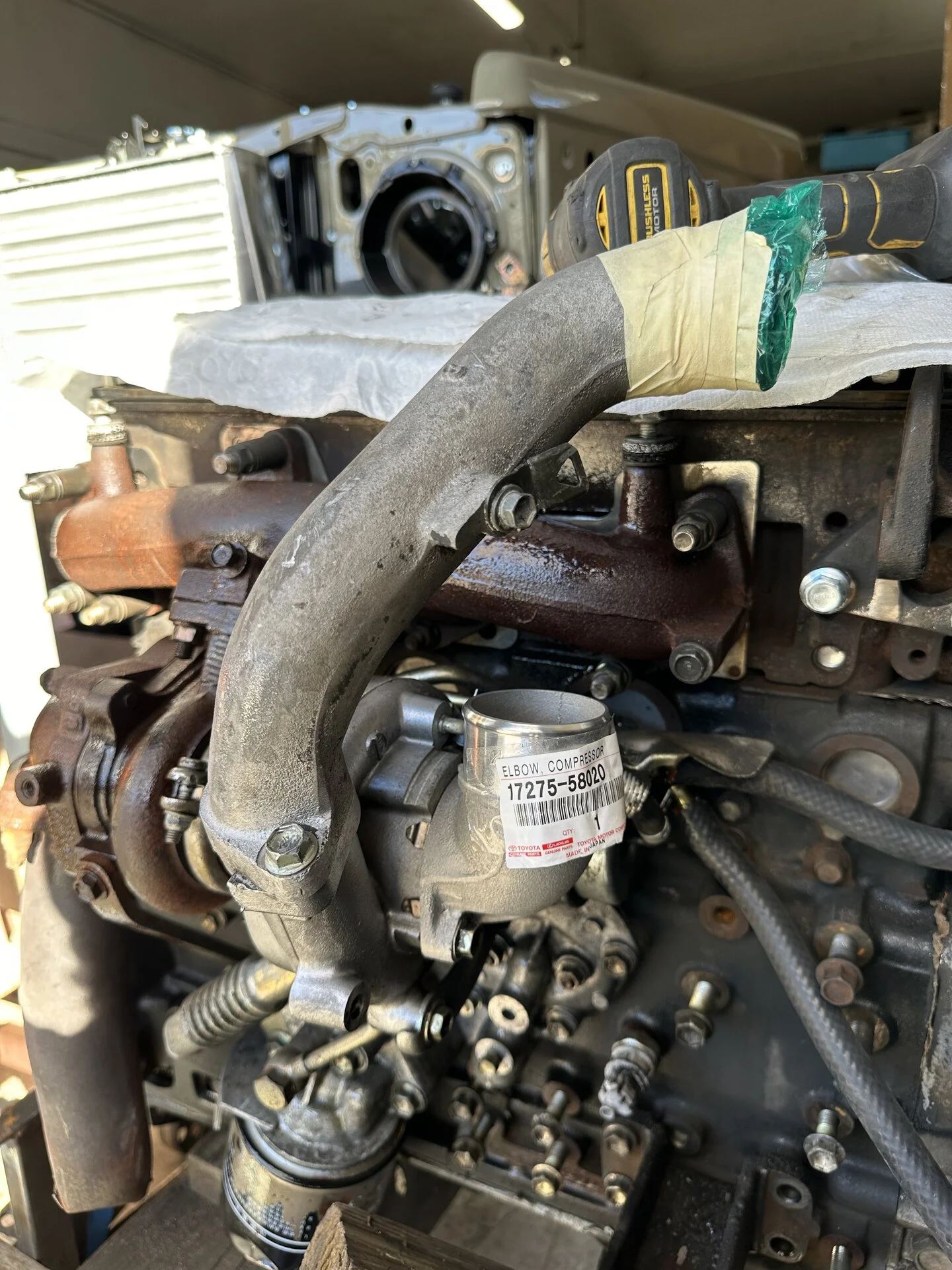

It's in the works. Hope to have parts in hand by spring. Curious, why the need for new turbo inlet/outlet?

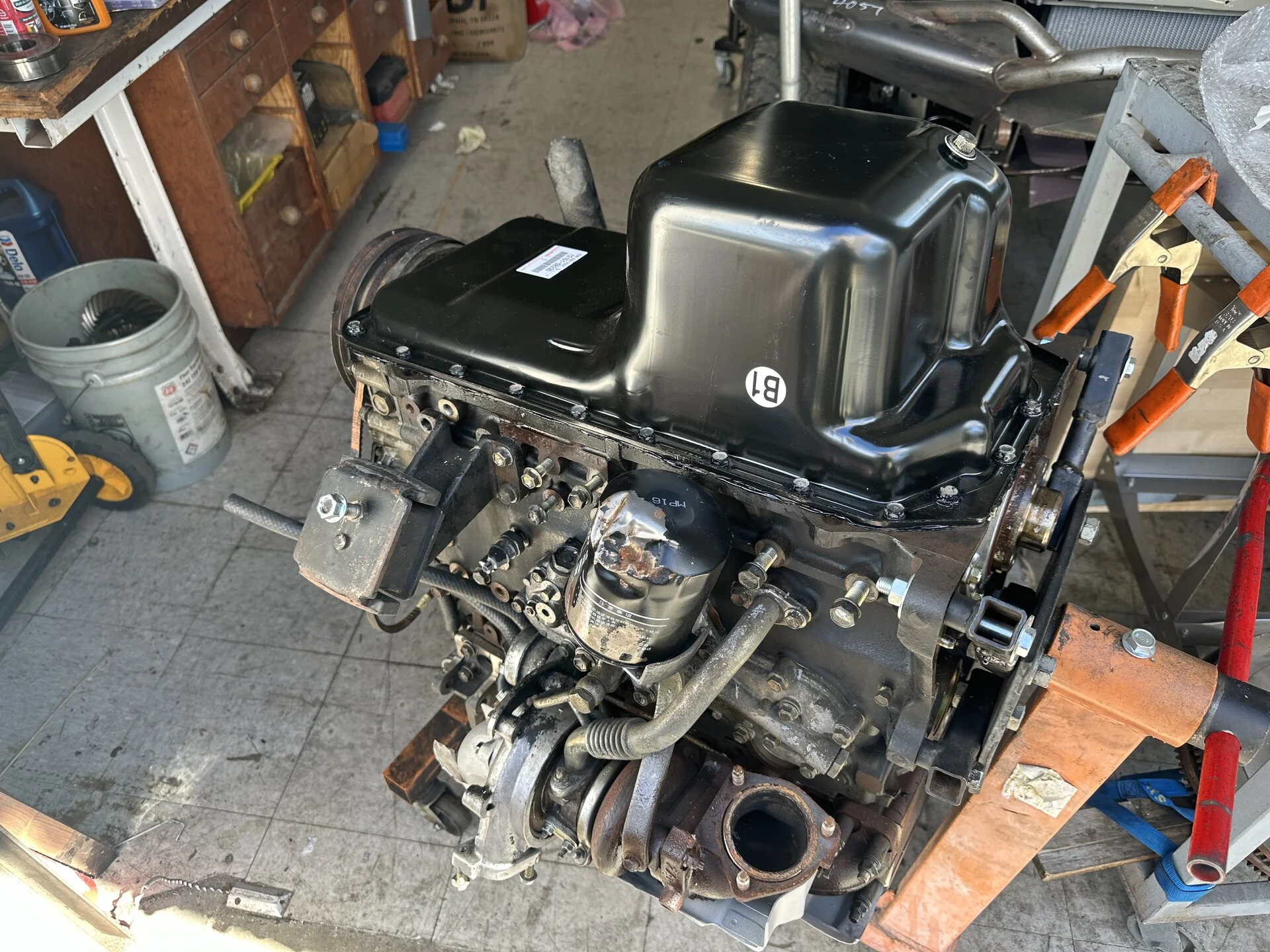

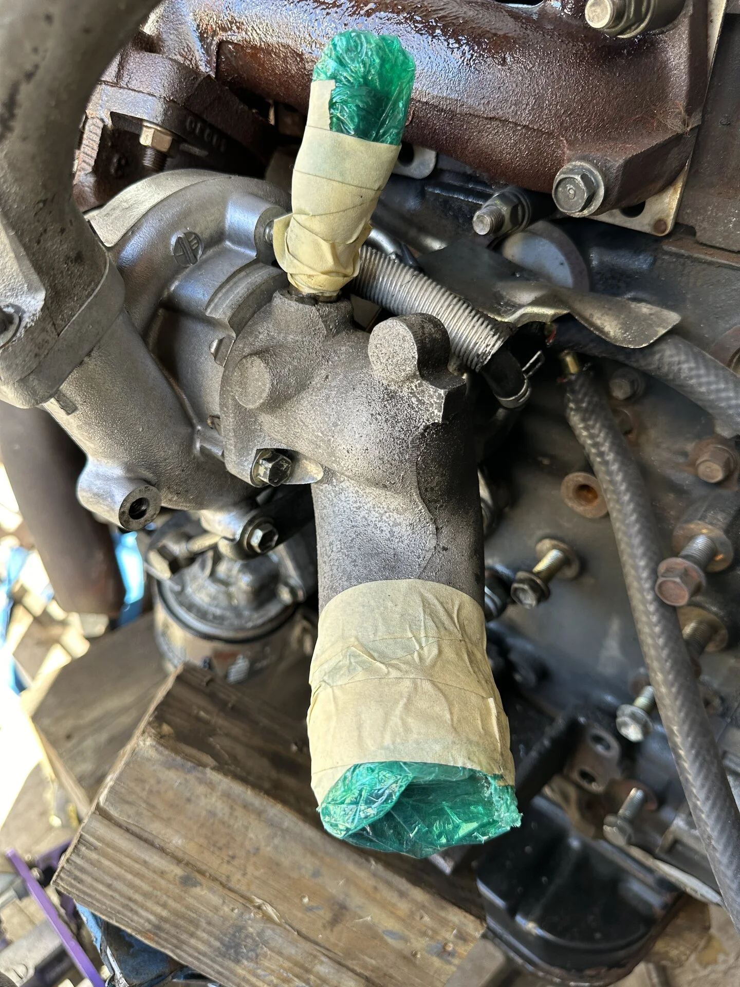

It came from a coaster. The direction of both was wrong. Last photo is the correct setup.

Unless that is a 1989 13B-T (I can't tell from the picture as the differences are very subtle), the 6 bolt 13B-T flywheel will not fit your 8-bolt 15B-FT crankshaft.

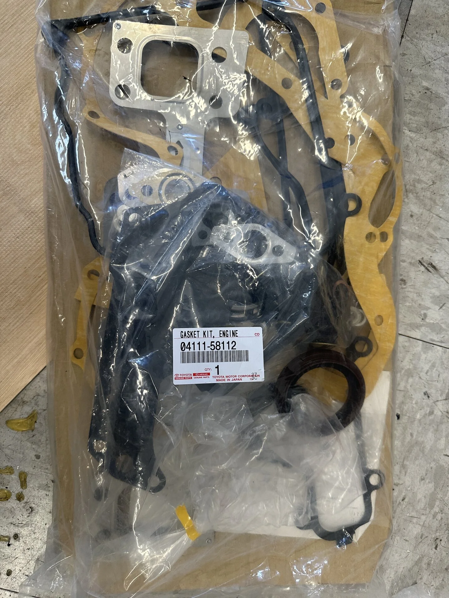

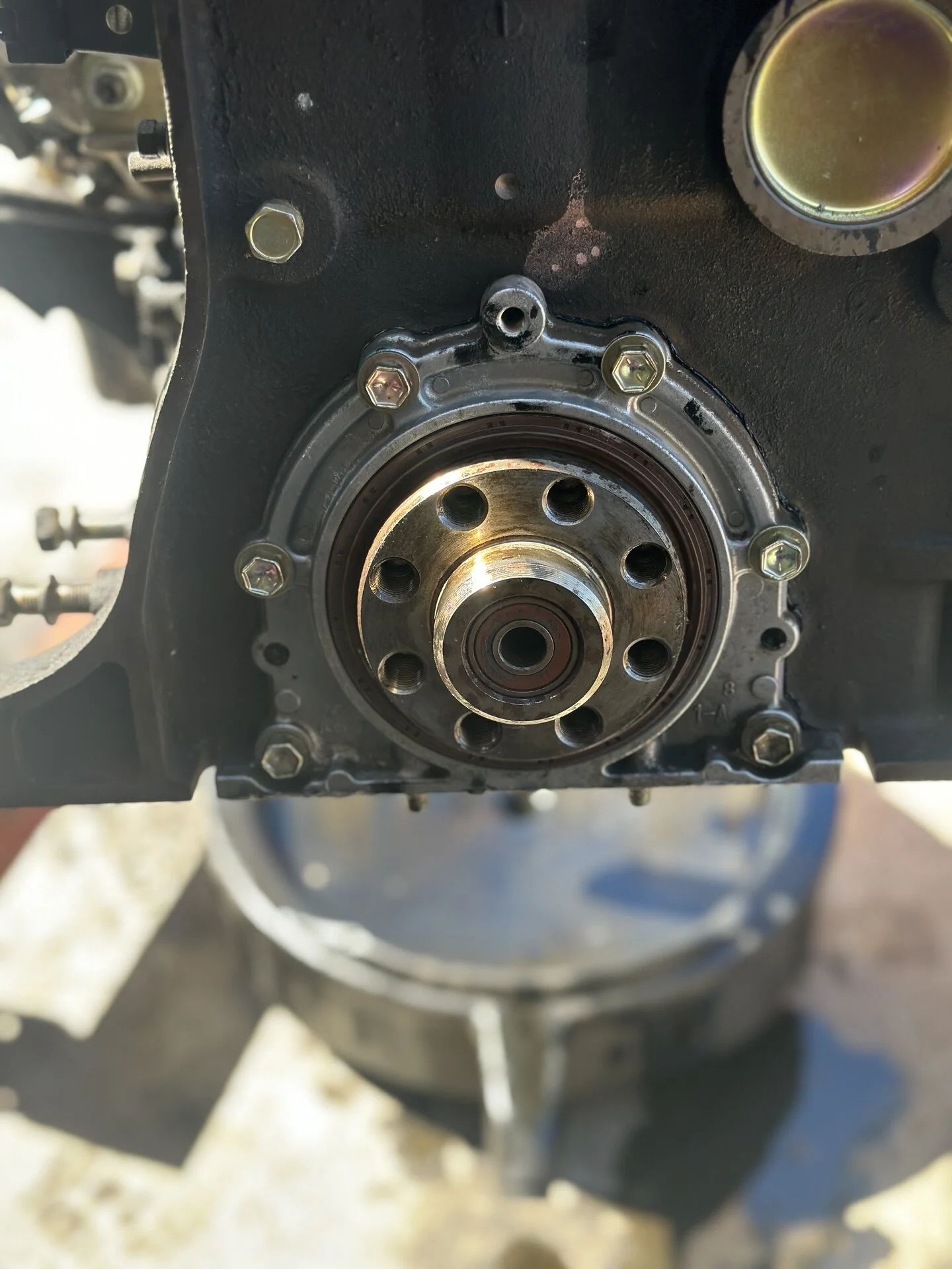

I have been using the gasket kit. Replaced the rear oil seal and happened out the plug for the dip stick so we can install the new dip stick. At this point I can install the new oil pan.
I have been using the gasket kit. Replaced the rear oil seal and happened out the plug for the dip stick so we can install the new dip stick. At this point I can install the new oil pan. View attachment 3451256View attachment 3451257
Just in case it gets overlooked, I would be sure to change that spigot bearing in the end of the crankshaft. Very annoying to have to remove a transmission to change out a $5 part. I use bread or plasticine in the hole, hammered in with an old bolt which pops the bearing out every time.

Hahaha. Thx! I ordered all the parts. Always do when separating the bellhousing. Regardless of the milage on the parts.
Installed the oil pan today and loaded the engine on a cart. This week I’m getting all the parts to mount the clutch. Been harvesting Claro Walnut this weekend so not much time for metal and grease. Alaska Mill!
