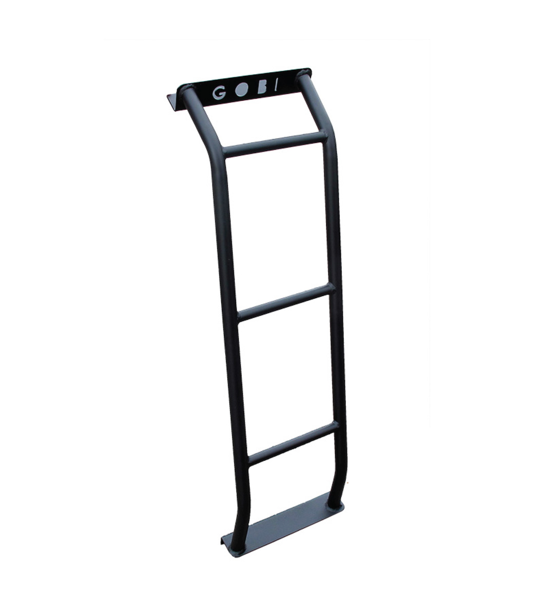

This can't be that hard for a fab shop, right? I honestly don't know. I wish I knew relative sizes of the 100 hatch so I could see how close this would fit... Eric @campteq told me someone put this ladder on an 80...

Something like this should be adaptable or a design template for a fab shop to work off of.
I imagine more than one person might be interested in a mountable ladder.

Since these are "made to order" I reached out to gobi and asked if they can make to order me a 60 one :-)
The 80 hatch is taller and the 80 tailgate shorter so a ladder designed for an 80 hatch would need to be chopped shorter to fit a 60 hatch
Other than height are the two hatches designed pretty much the same? Seems like a chop and reweld would be a lot easier than a complete fab from scratch
