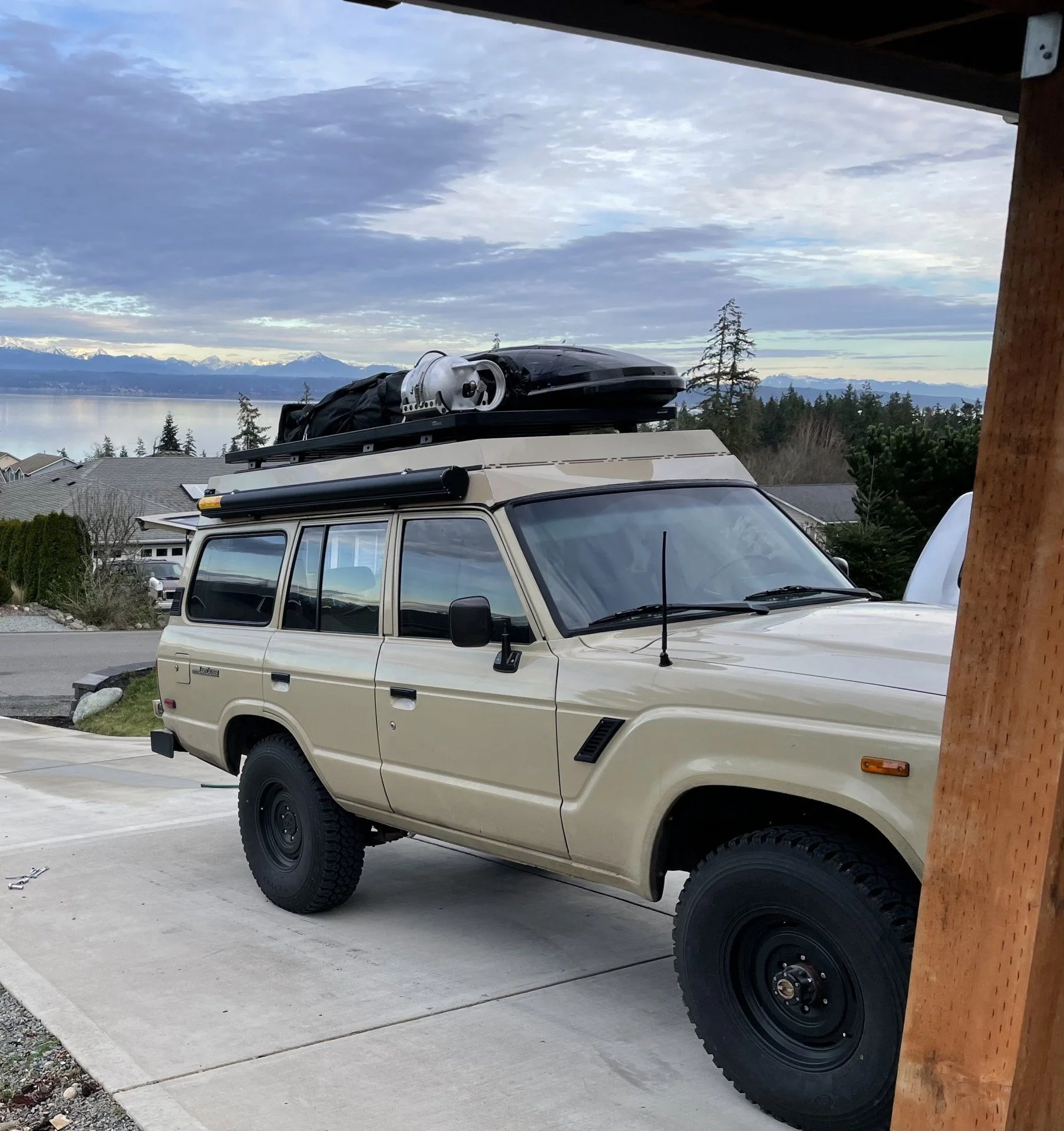

FJ60 Campteq Camper Build
Thule Box mounted for the trip.

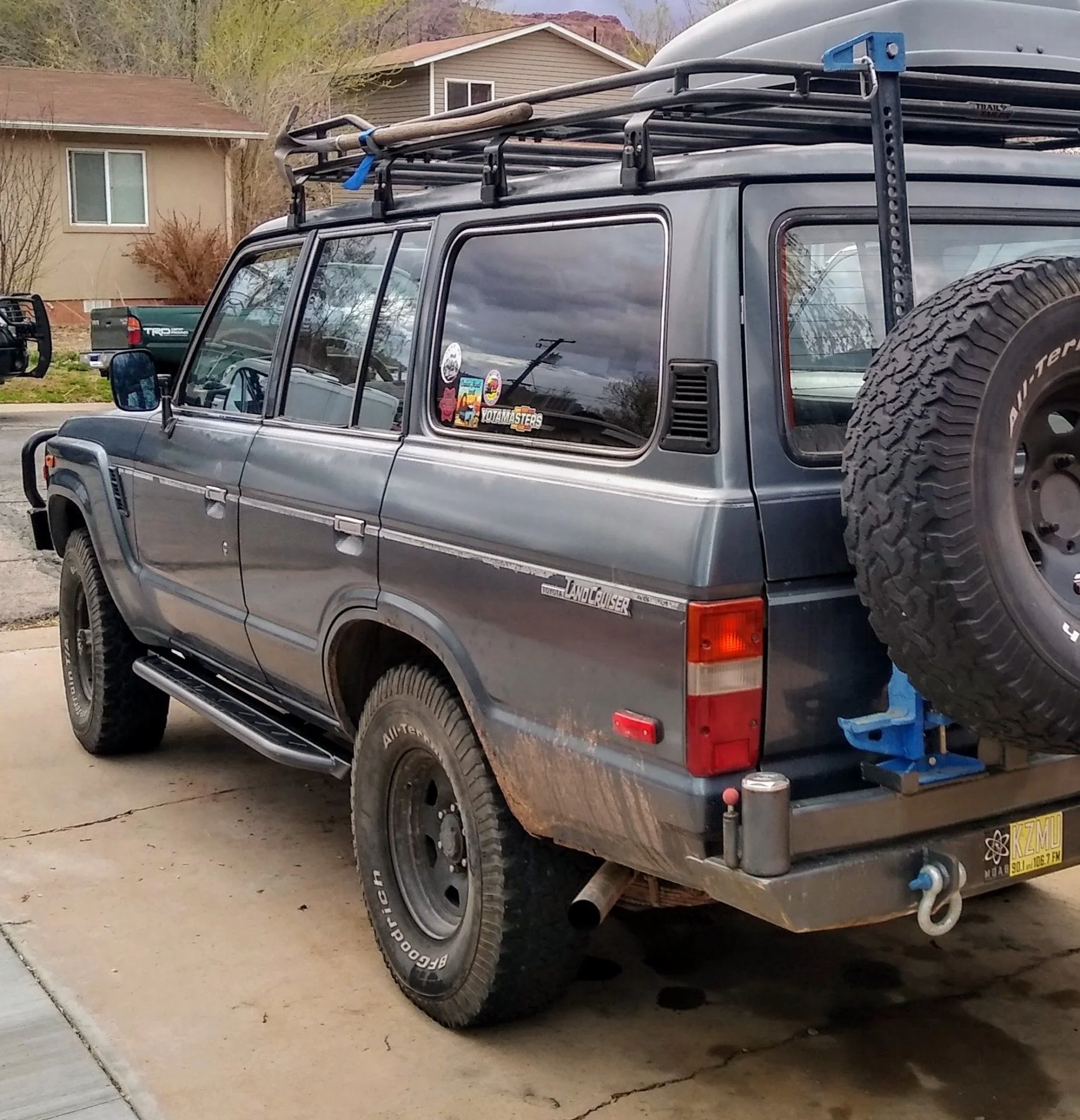

Older i get the more effort and difficulty i have getting up into my rig...these Rock Sliders a good step up? Thanks
Yep and handy for cleaning the windshield and as a handle to pull my fat arse out from underneath. Sometimes when a sketchy downhill section needs a closer look, I just open the door and stand on the slider. I'm not used to getting old, it sucks.
Hear that. What kindve sliders ya got? Pics? Im leaning twds White Knuckles....
I love all of TT’s products. Quality and attention to detail.
I have the arb “steps” on order. With what I use my rig for I don’t need a true slider. The Arbs match the style and use of my rig better. And I’m a sucker for 5 bar diamond plate. They’re back ordered though so who knows when I’ll see them
