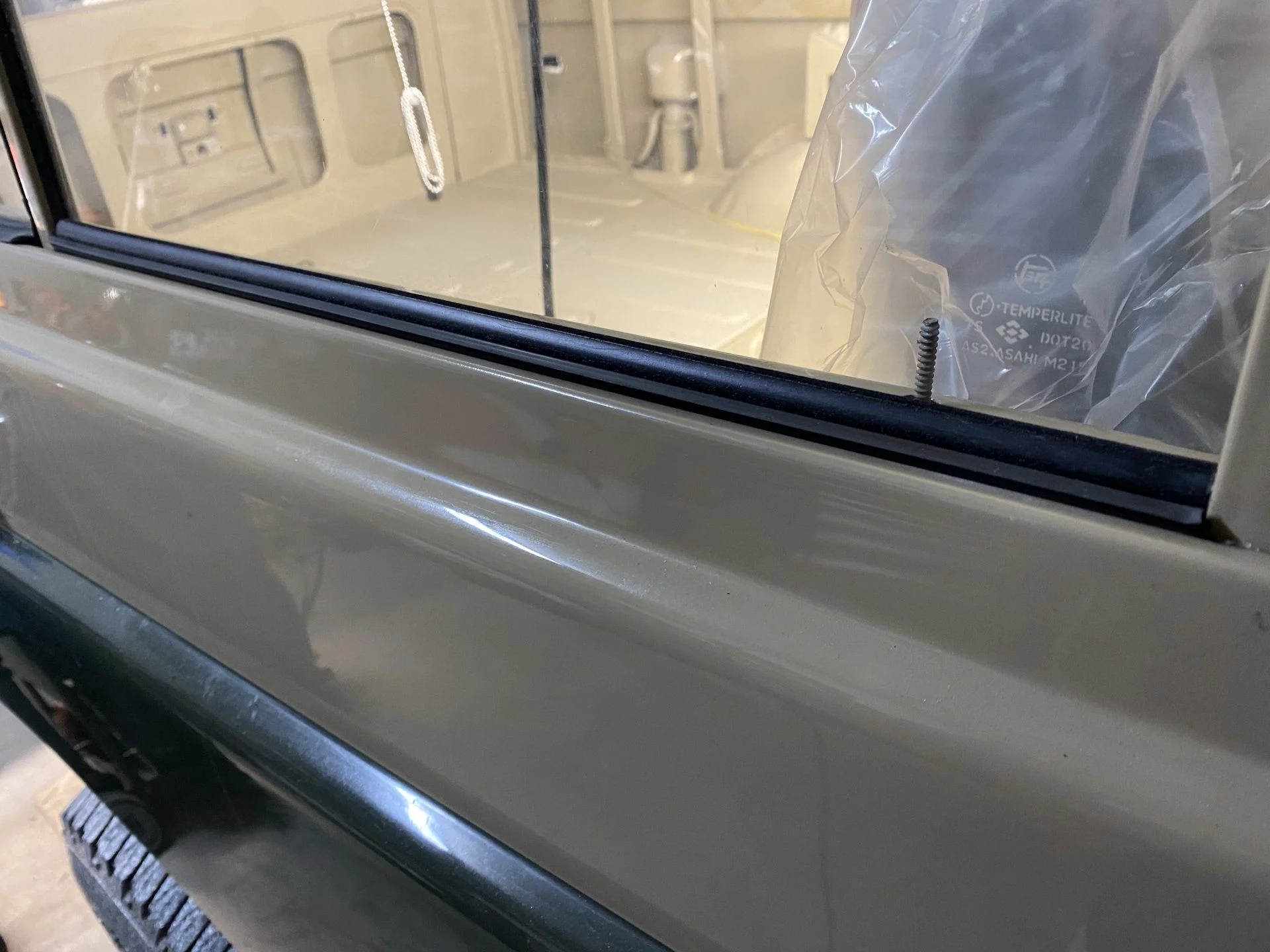

I used the FAIRCHILD 14574X2 on the outside of the windows in an effort to keep water out of my doors.
I believe the FAIRCHILD 12814X2 or the FAIRCHILD 01994X2 is for the inside.

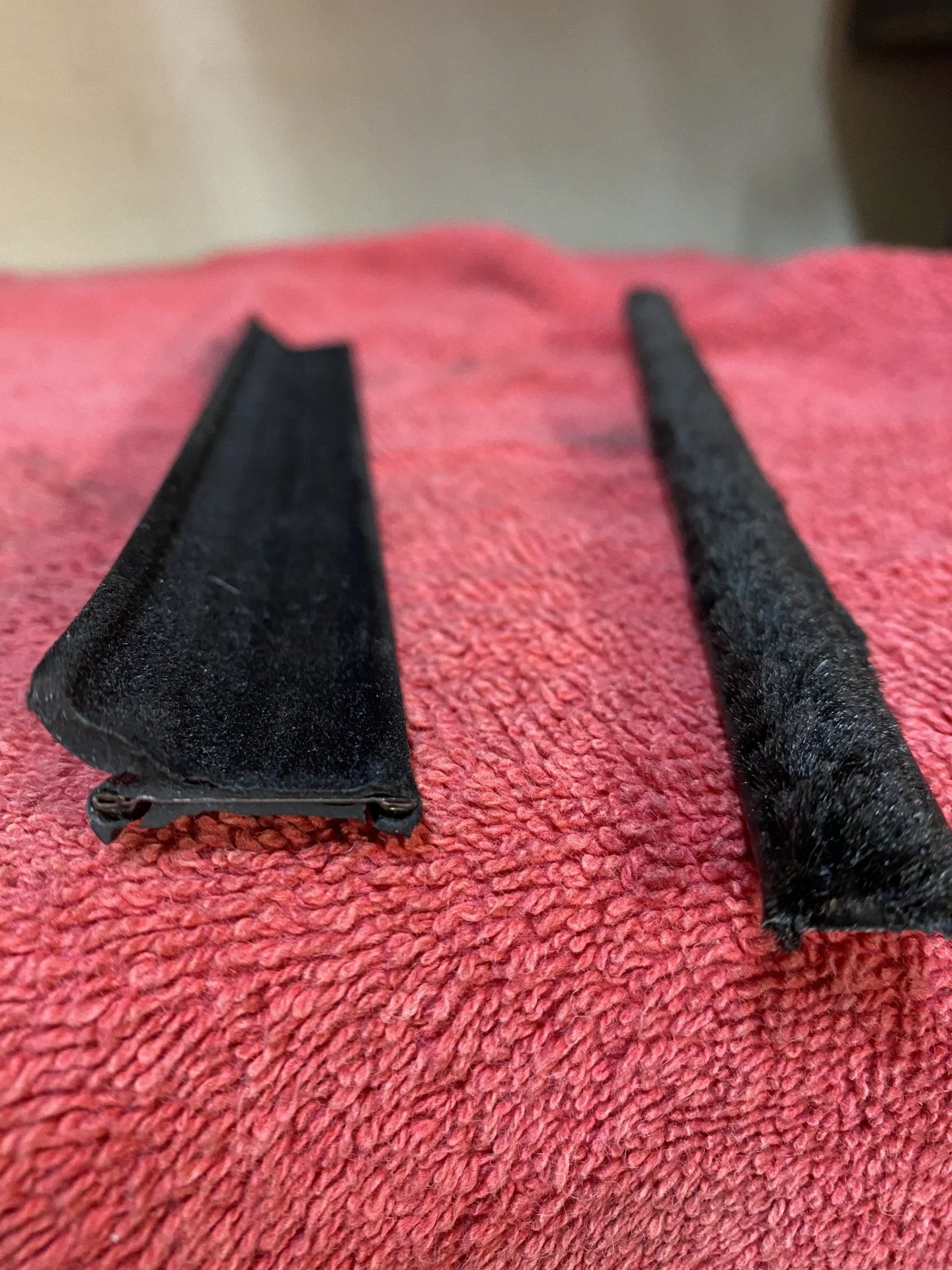

I used part # 70-3804-61 Outer Beltline and 70-0961-60 Weatherstrip Beltline from Steele Rubber Products.

How do you like the fit on those? They look like they fit nicely.

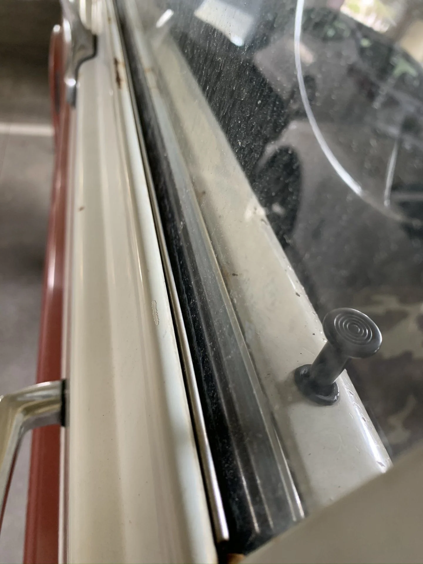

Found some with the stainless trim.
Not sure if this link will work but this is everything they have that's close.
oh man, thanks @J Mack. That stainless steel belt might be cool actually just because it looks more stock but has the benefit of the flap. I ordered from rockauto yesterday and got a shipping confirmation so sounds like they had them in stock. I just started taking the doors apart for paint today. This quarantine has given me some extra time I hadn't planned on.

Seem to Fit just fine. I haven't investigated the back window yet.
I was able to get everything from SLOcruisers a while back except those felt pieces. I started accumulating everything I needed to complete this paint job a couple of years ago. I'm excited to get it all reassembled and to have doors that seal - no weatherstrip in some places before, i'm guessing because the PO didn't know where to find them. Or maybe they just liked the draft. Not a big deal unless you ever plan to take the cruiser on a dirt road.
