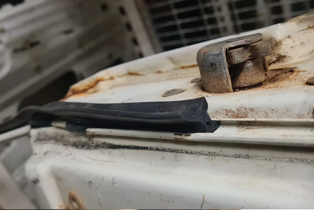

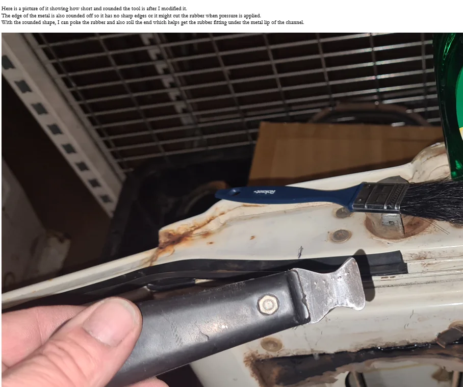

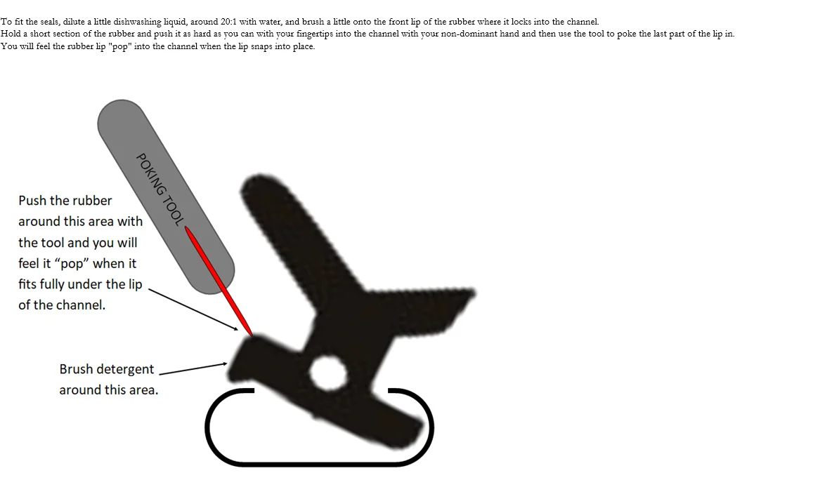

Here is a piece of the rubber I poked into the rear section of the right-hand rear door.
I had to open up part of the short channel because it was crushed on the left.
This is quite a tedious job but once you get the feel for it, it won't be as difficult.
I hope this will help with the installation.

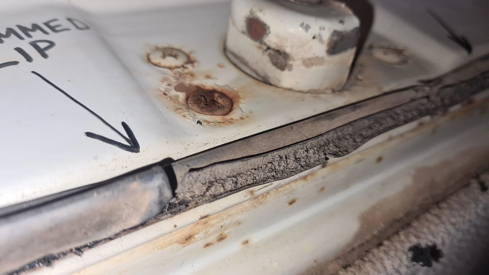

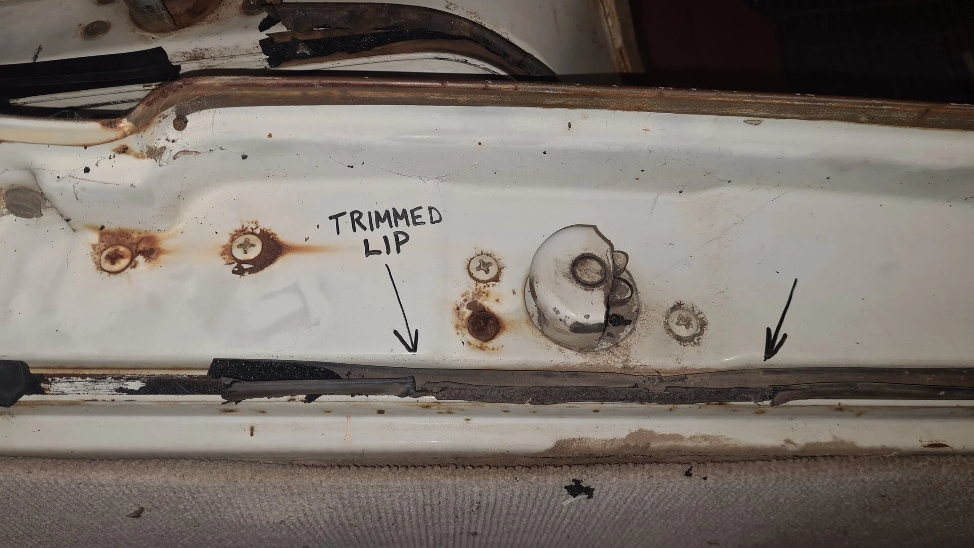

This was about a customer called Adam who had told us there was an issue with the on-door seals catching on his latches.
I took a look at the doors we have and then noticed that the front door we have has a cut-out near the latch.
Here are three pictures of that door showing where the trimmed section is.
The length of the trimmed section is 5" and the middle of the cut-out lines up with the middle of the door latch cog.

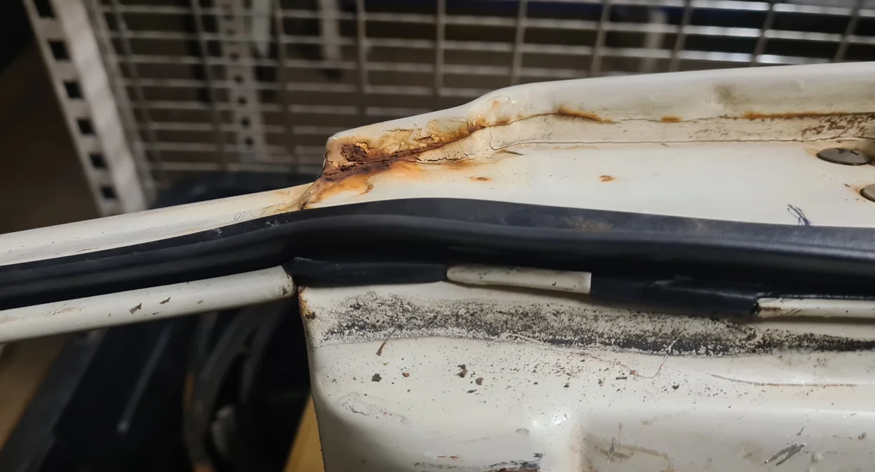

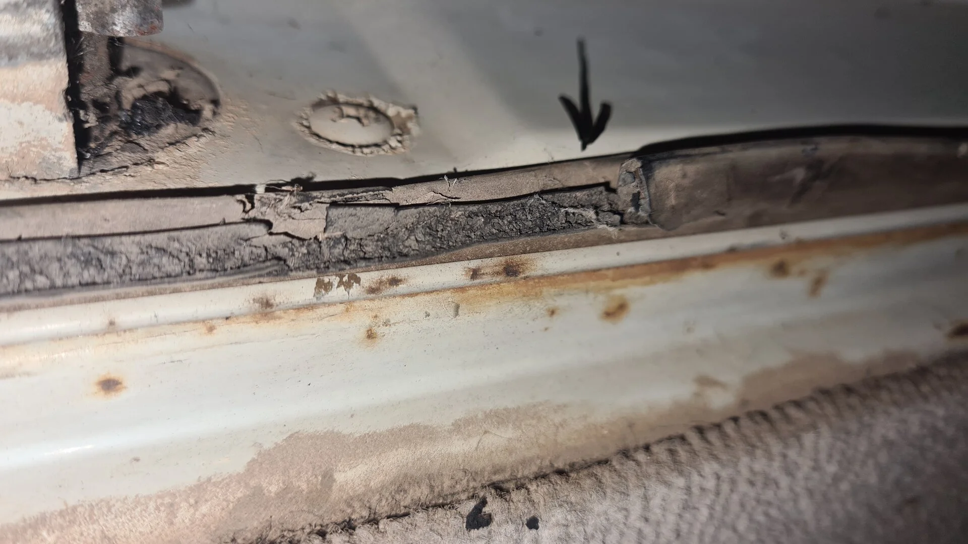

We also have a right-hand rear door but the part of the seal near the latch is completely missing so I don't know if that was also trimmed.
The image below is a picture I found online, showing an old original seal damaged where the latch would be.
It has no sign of being trimmed around that area.
I'm guessing this is what will happen if the seals do not get trimmed.
It may be that this was a problem with the early FJ55 seals like in this picture and later they were pre-trimmed like the door I have here in our factory

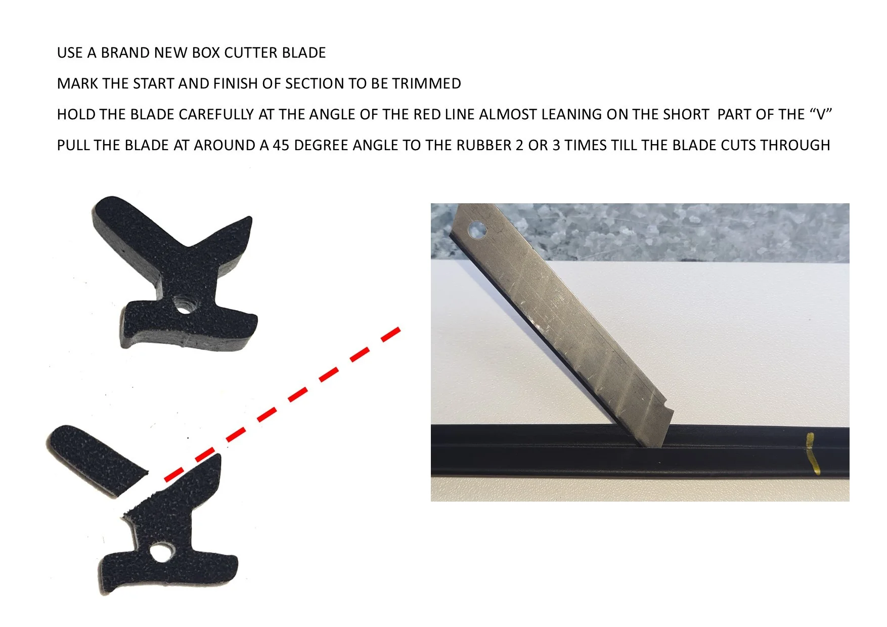

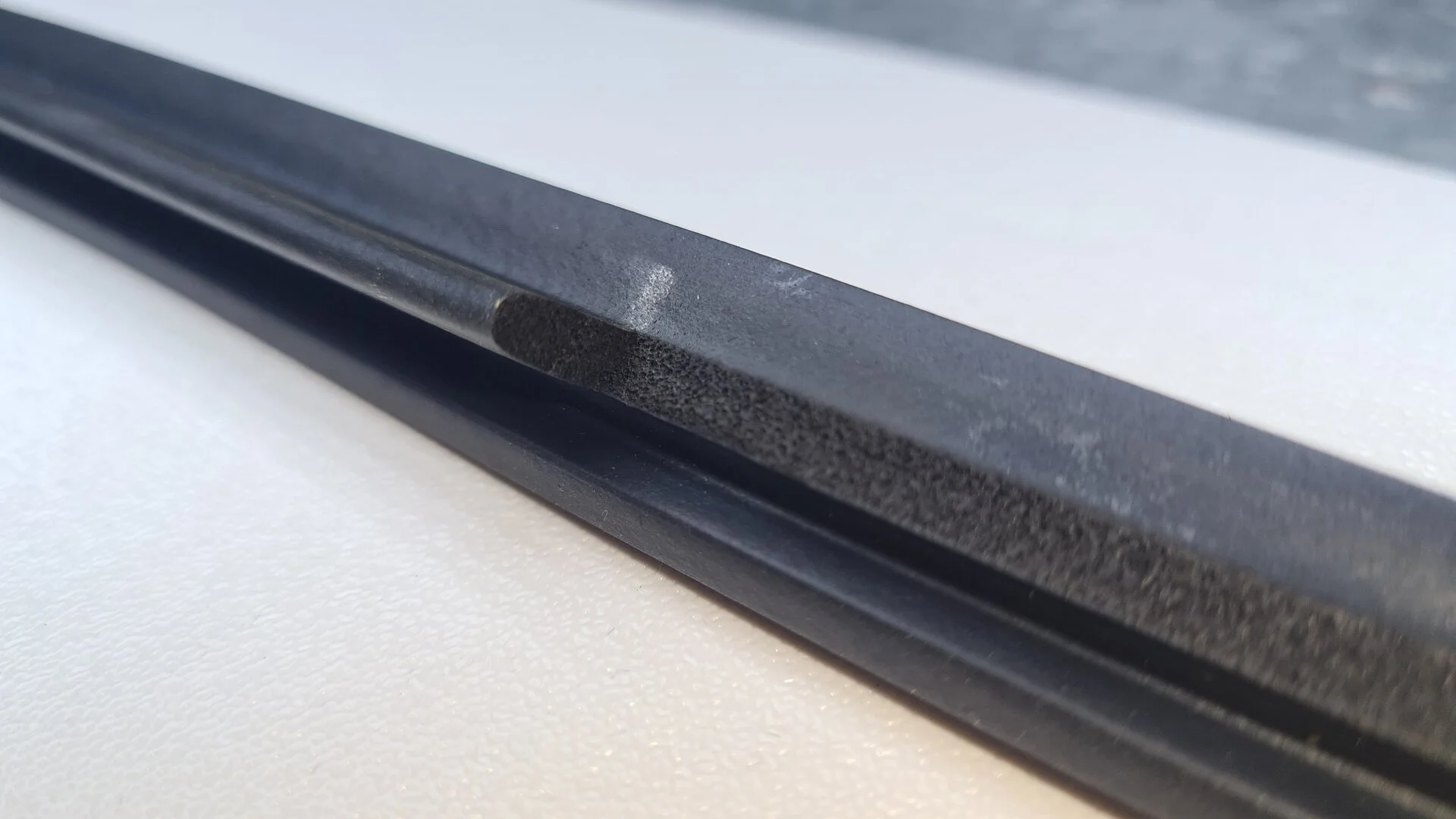

Here are a few tips if your seals need to be trimmed for the latch.
I cut a small section of the rubber profile and then trimmed a section out and took a few pictures.
Here is a rough explanation of how I did it.
