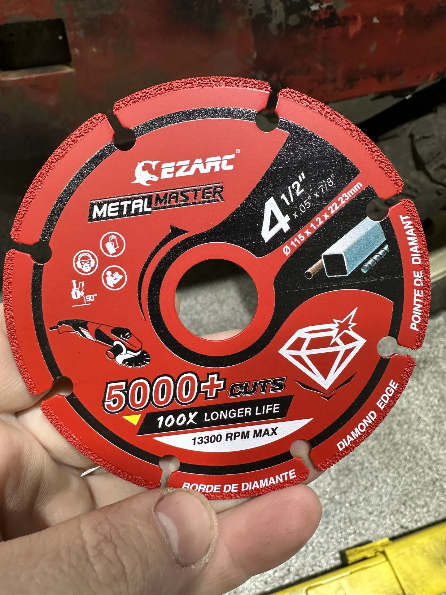

I’m testing one out now. Less mess/air born than death wheels. Not as good for thicker metal. Seem to hold up well enough. It’s another tool in the box, but not a complete replacement for death wheels.

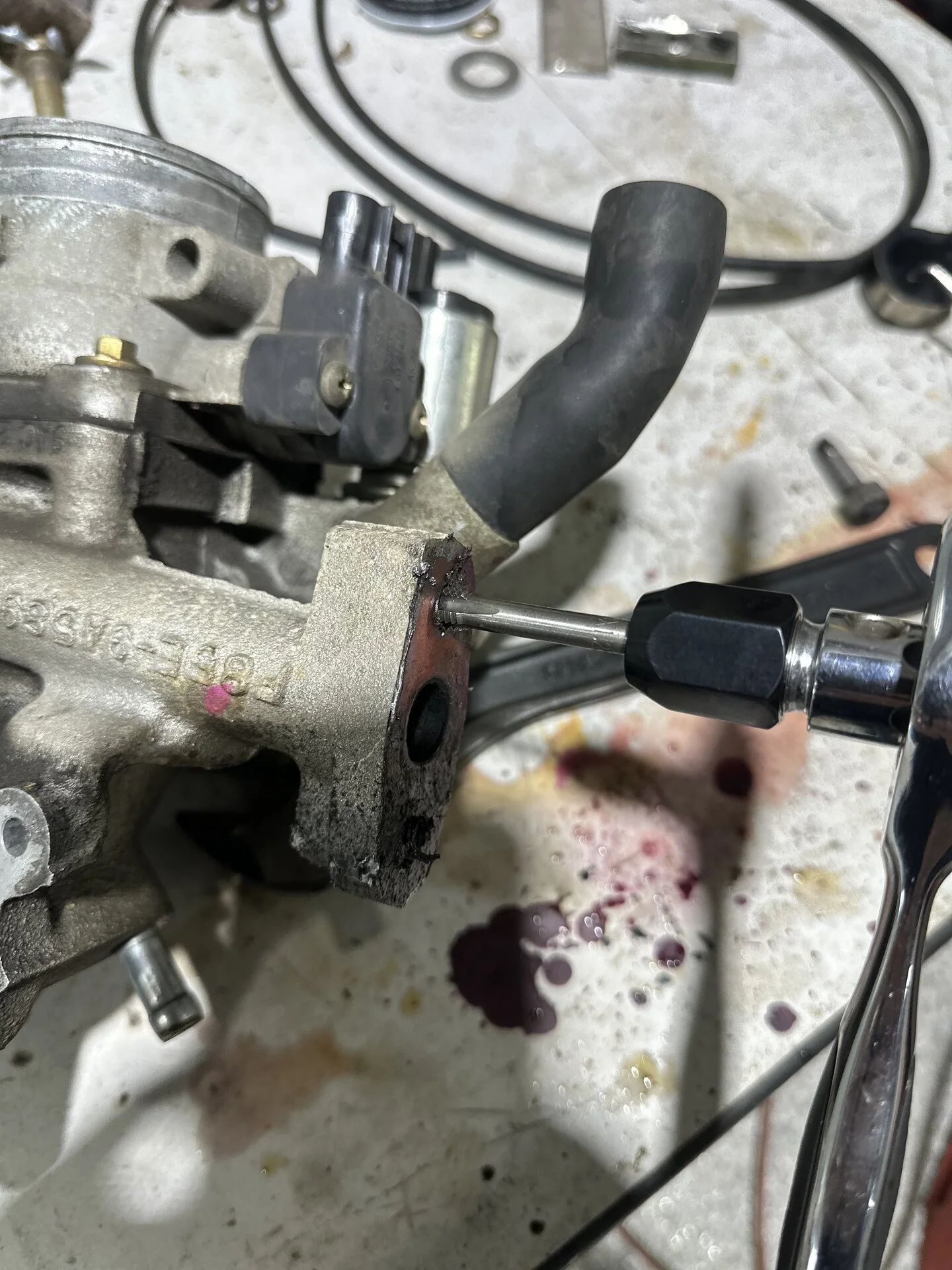

I do not recall hearing about the crayon thing, just used as a penetrant?Side Quest ; buddy has a broken bolt on his intake. Lots of pre-heat and some crayons. Welded a nut on the end.. let it cool down and wiggle wiggle its out. Tapped the holes to clean the threads.
Wax....seems to work, but somebody going to be mad about their missing crayons.
