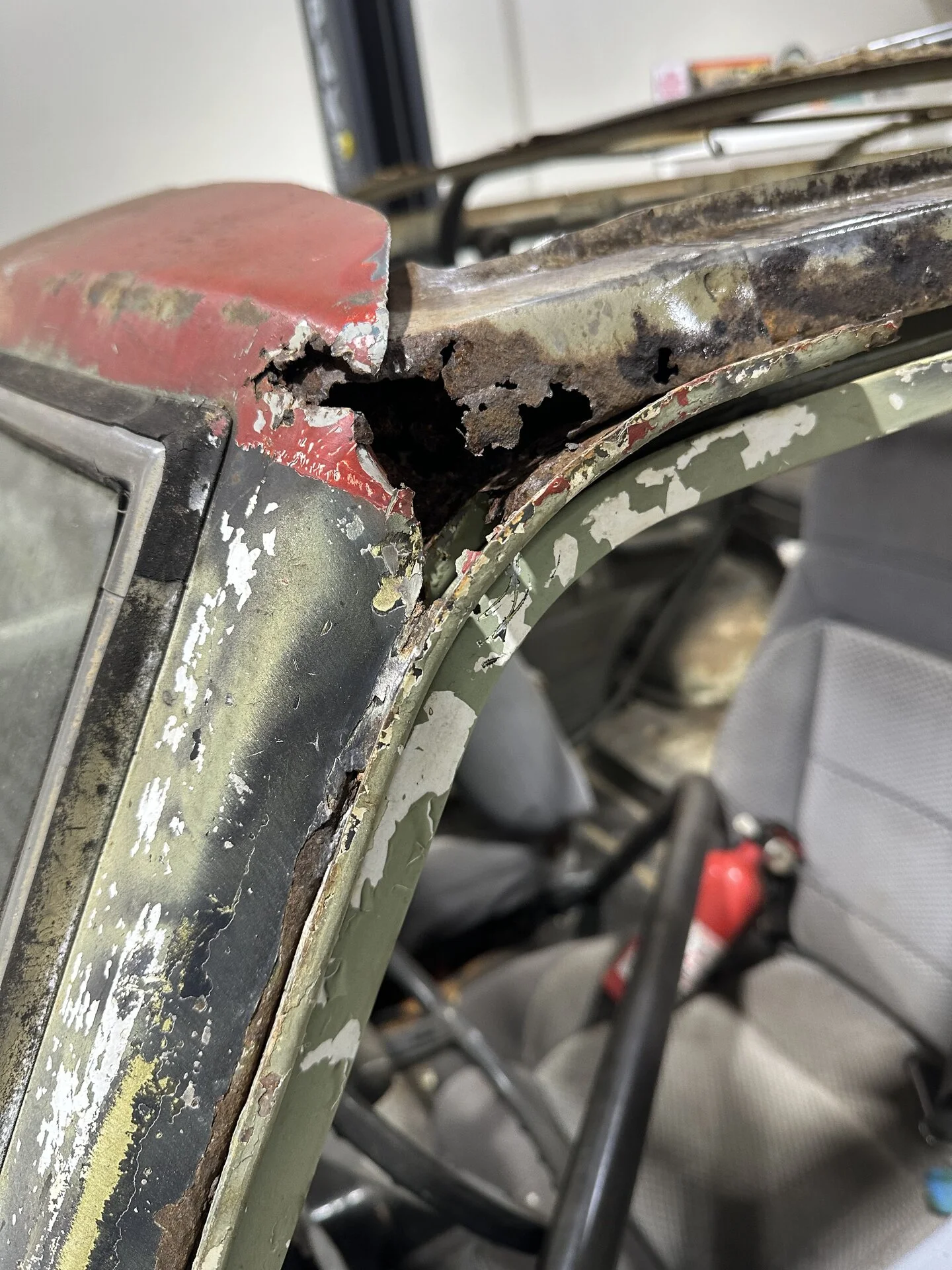

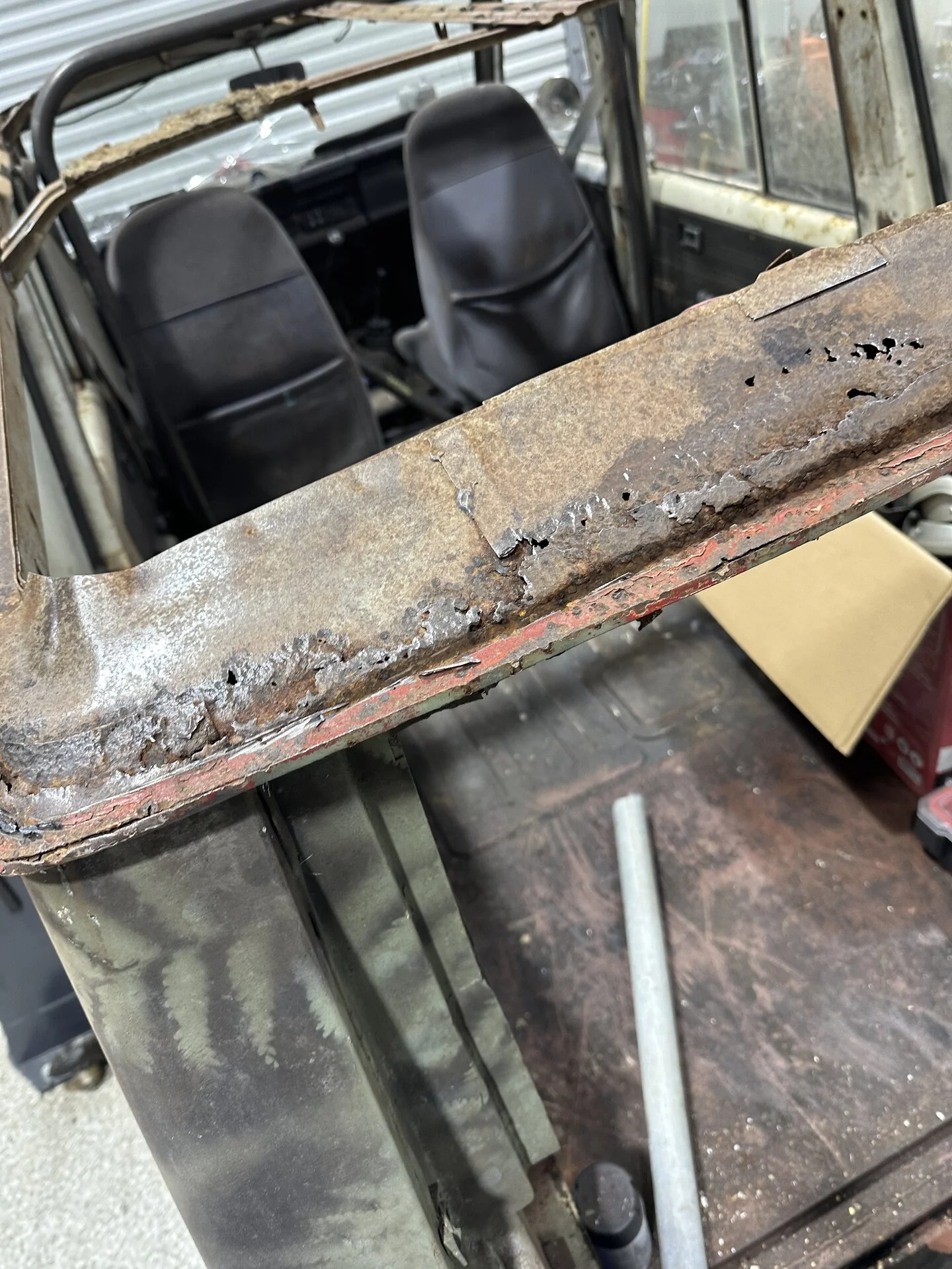

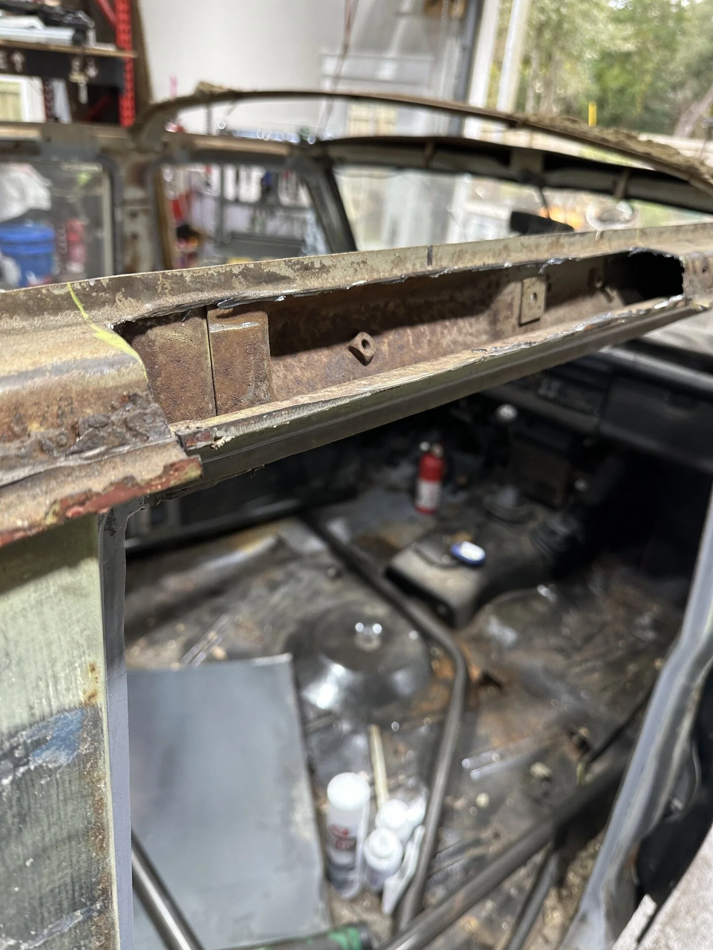

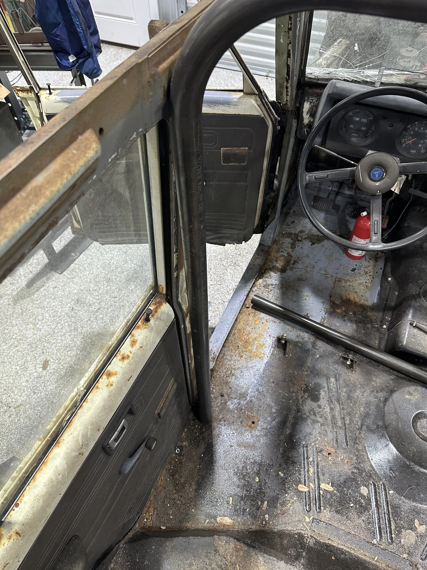

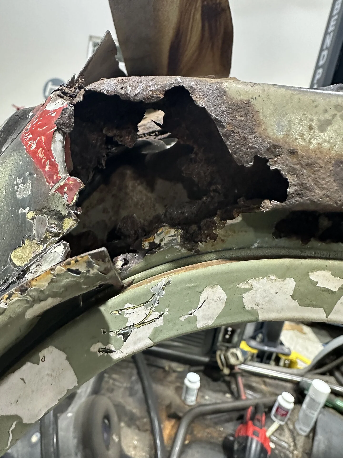

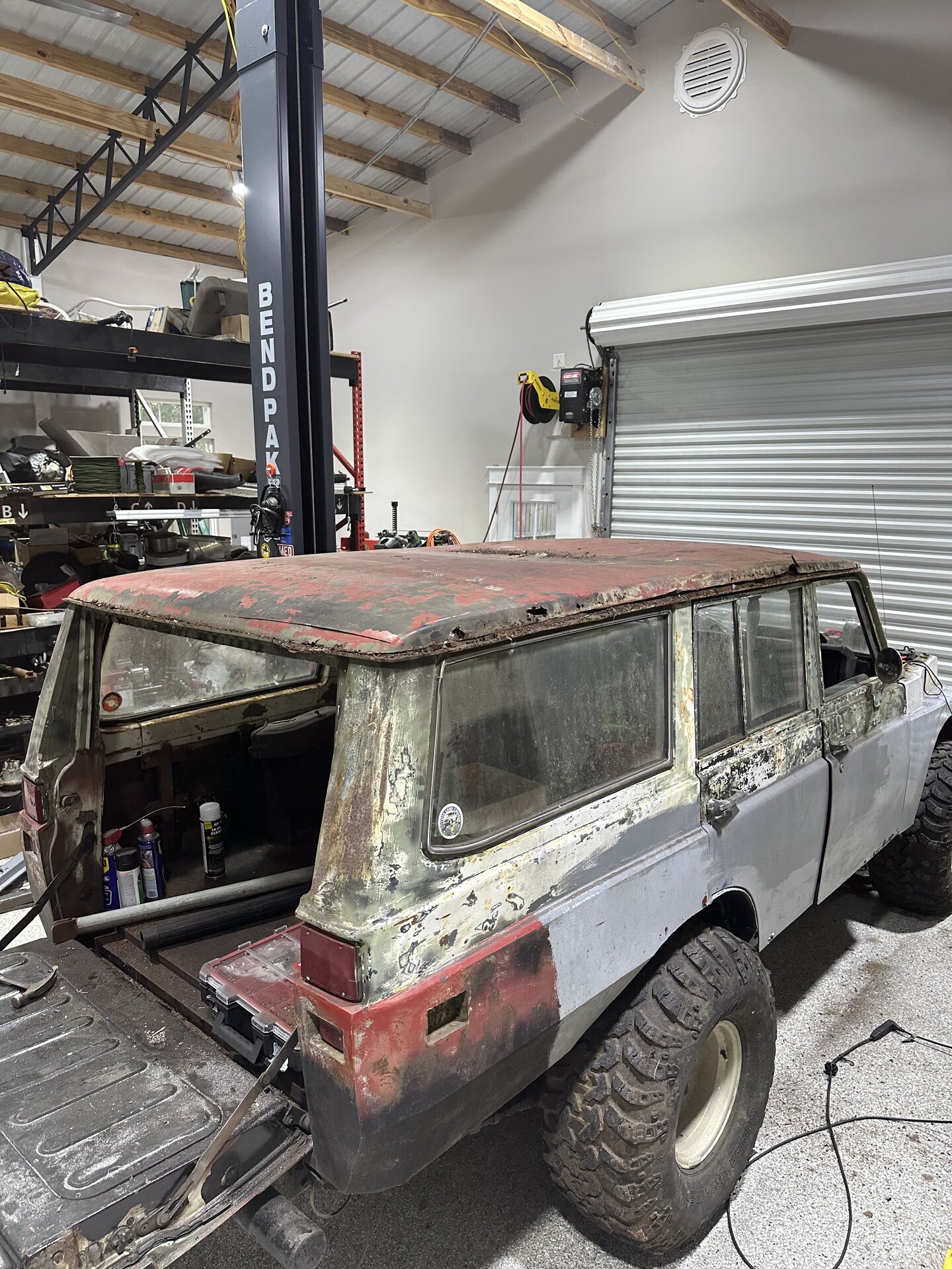

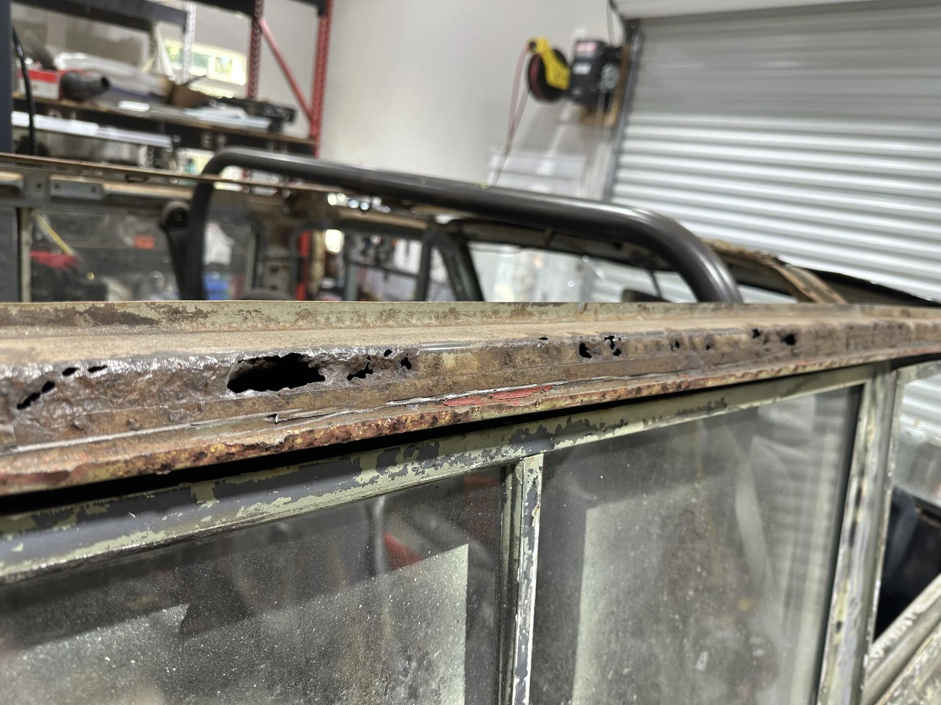

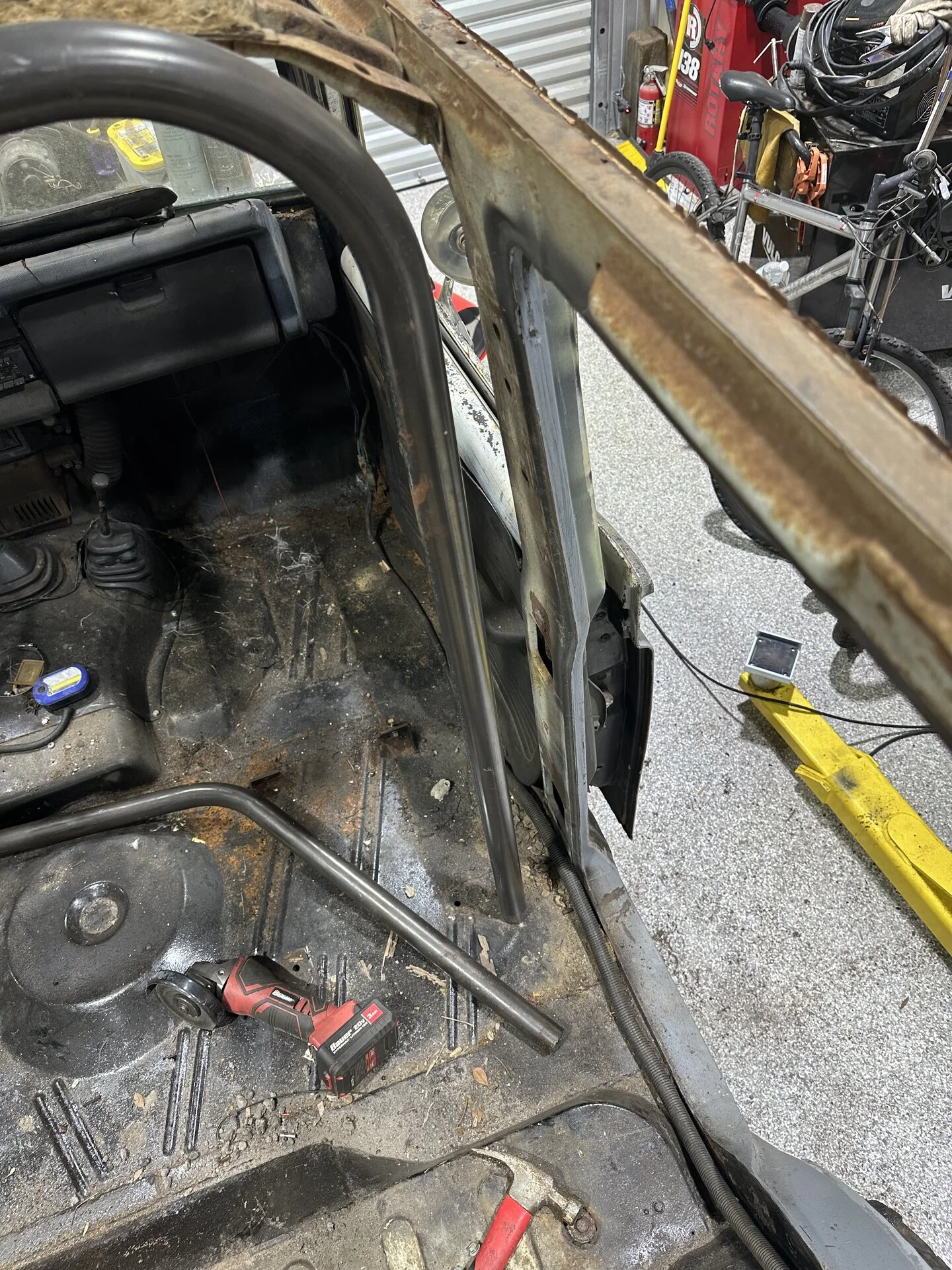

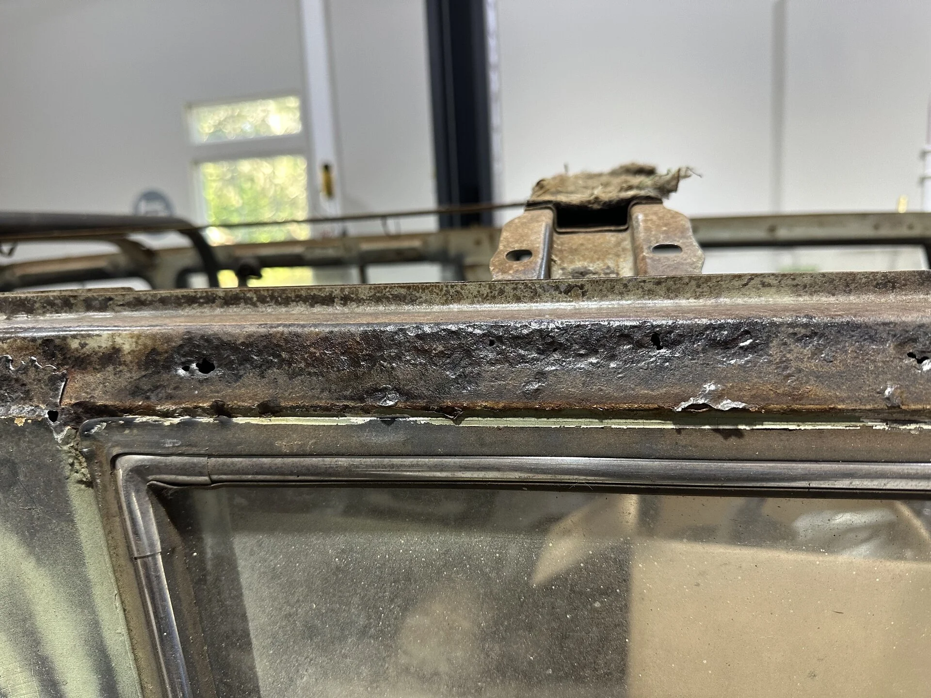

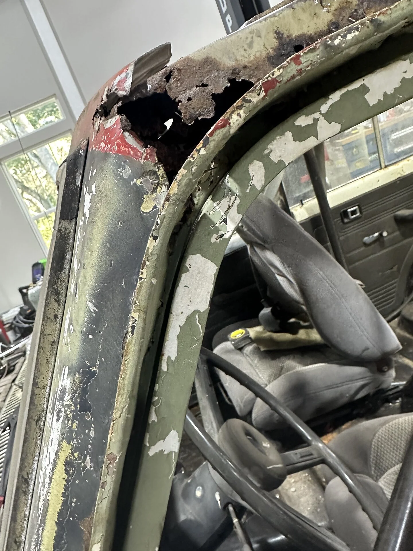

Death wheeled the exposed metal… drivers side cab corner is toast. The rest is okish.. a couple patches here and there

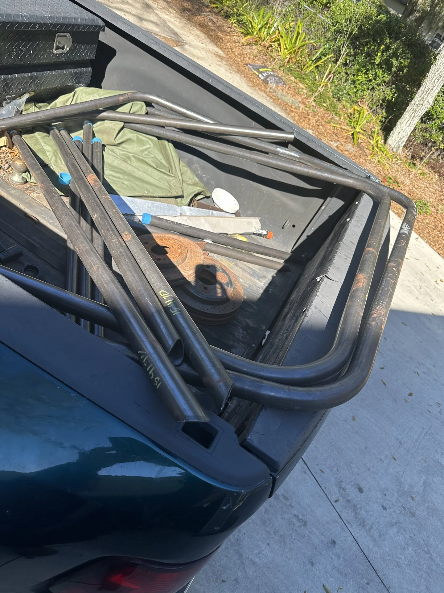

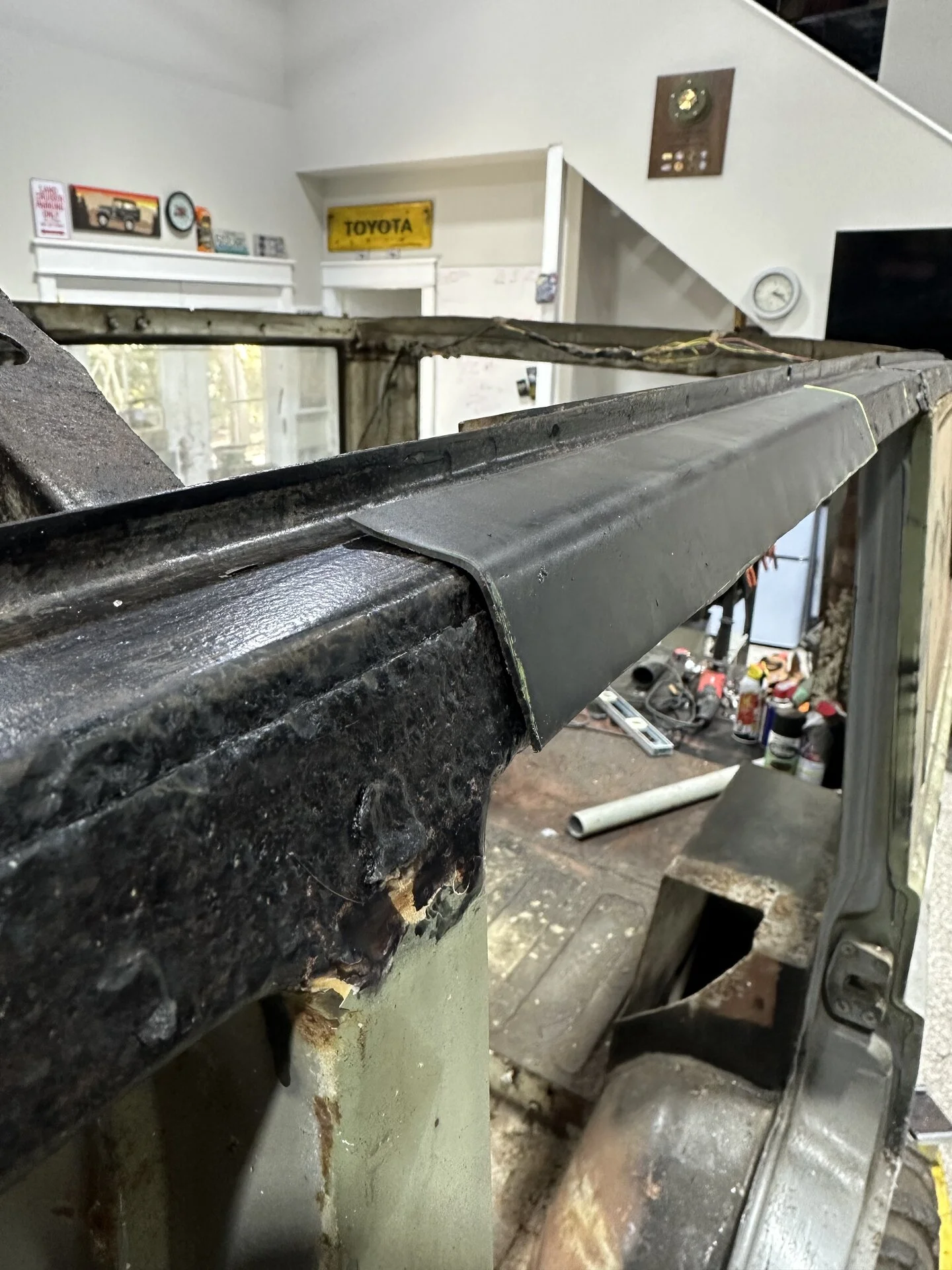

Went to the local metal works - half sheet 18gauge / 10ft stick of 1.75 120wall tube/ and 10ft 2in by 2in angle iron. $110.00 out the door - not bad. Gave them a good fog with WD-40, Floriduh isn’t nice with 110 percent humidity- it will rust over in a few hours. Crab island today —- water looks amazing today.

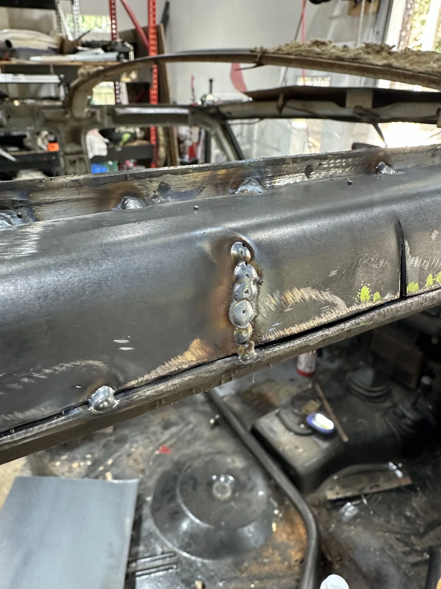

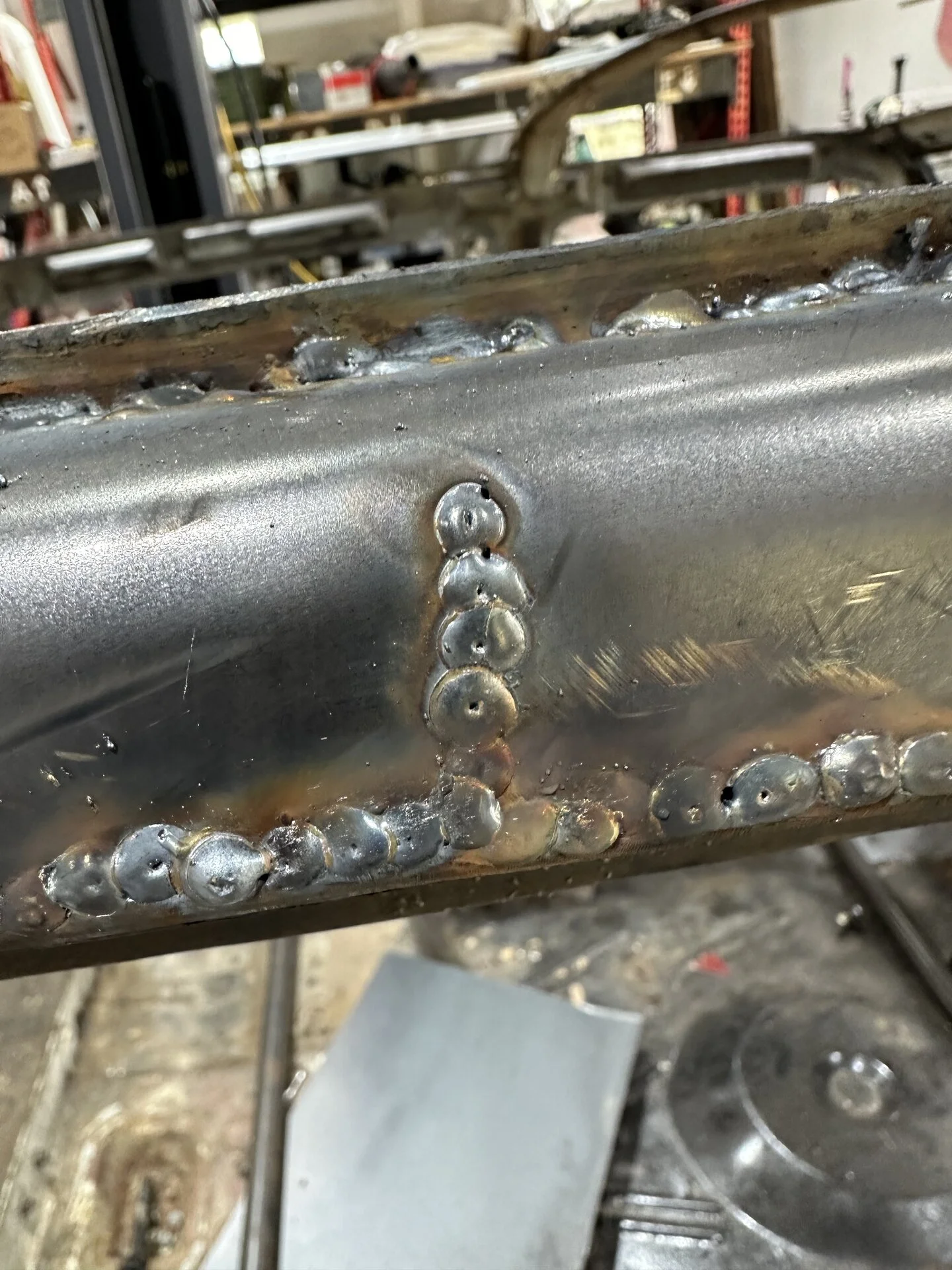

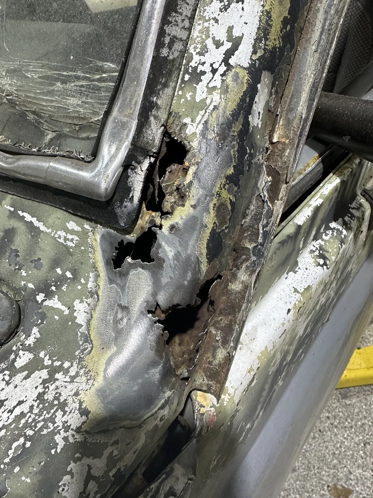

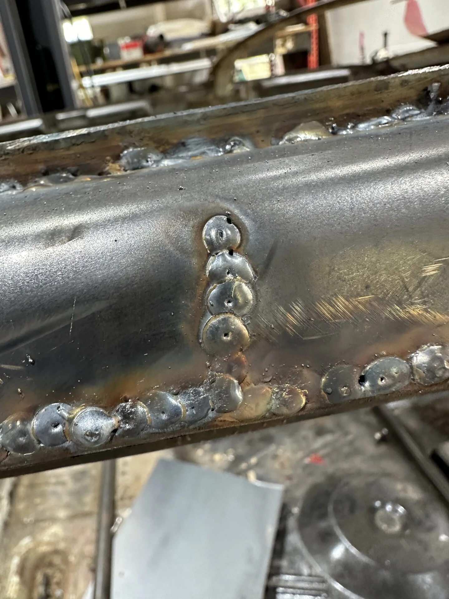

This is the part nobody wants to see - fighting the welder settings, angle of the MiG gun, burning through. I have enough welds that when I take the grinder to it you will never be able to see it. My machine does TIG,, I guess now would be a great time to practice. —. Tree top and limbs fell off in the storm that hit everyone. All safe and sound, tree people already cleaned up the stuck part that saved the neighborhood’s roof!
