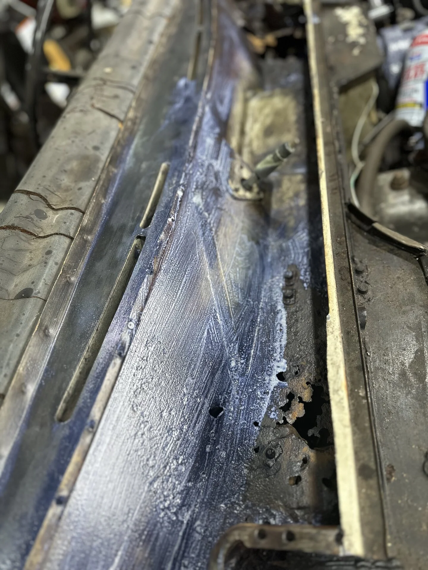

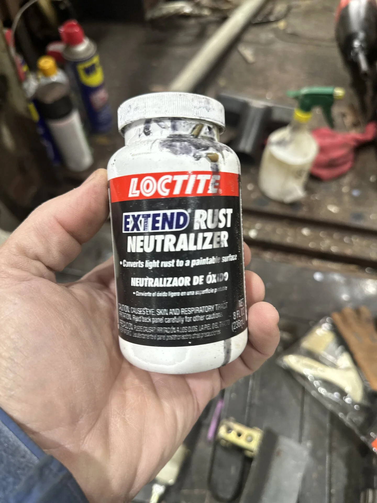

Been treating the rust with this stuff. What is everyone else using? I have a POR 15 kit that I will use later after all the metal work is done. Additionally, Hot sauce is lethal to transformers.

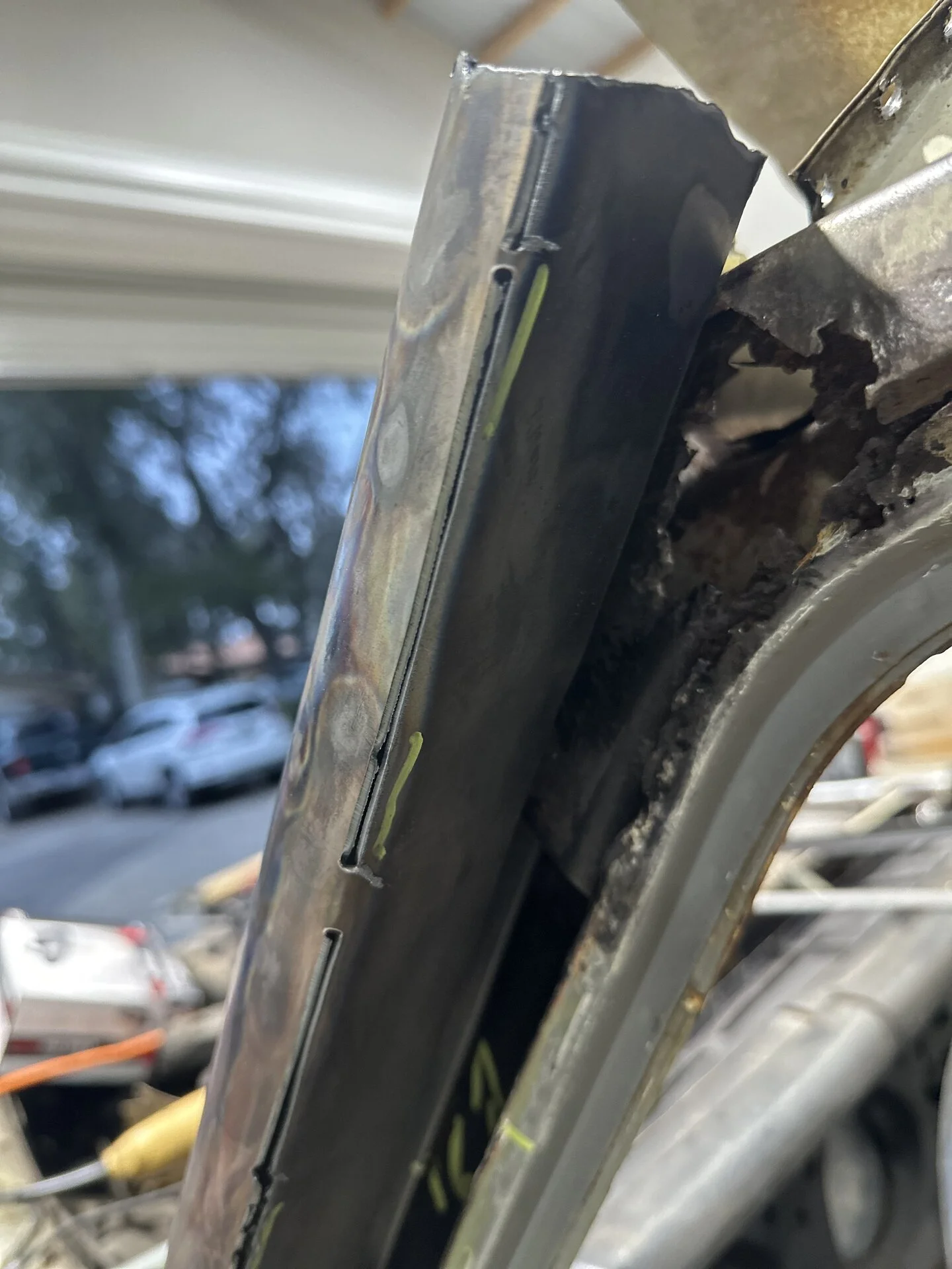

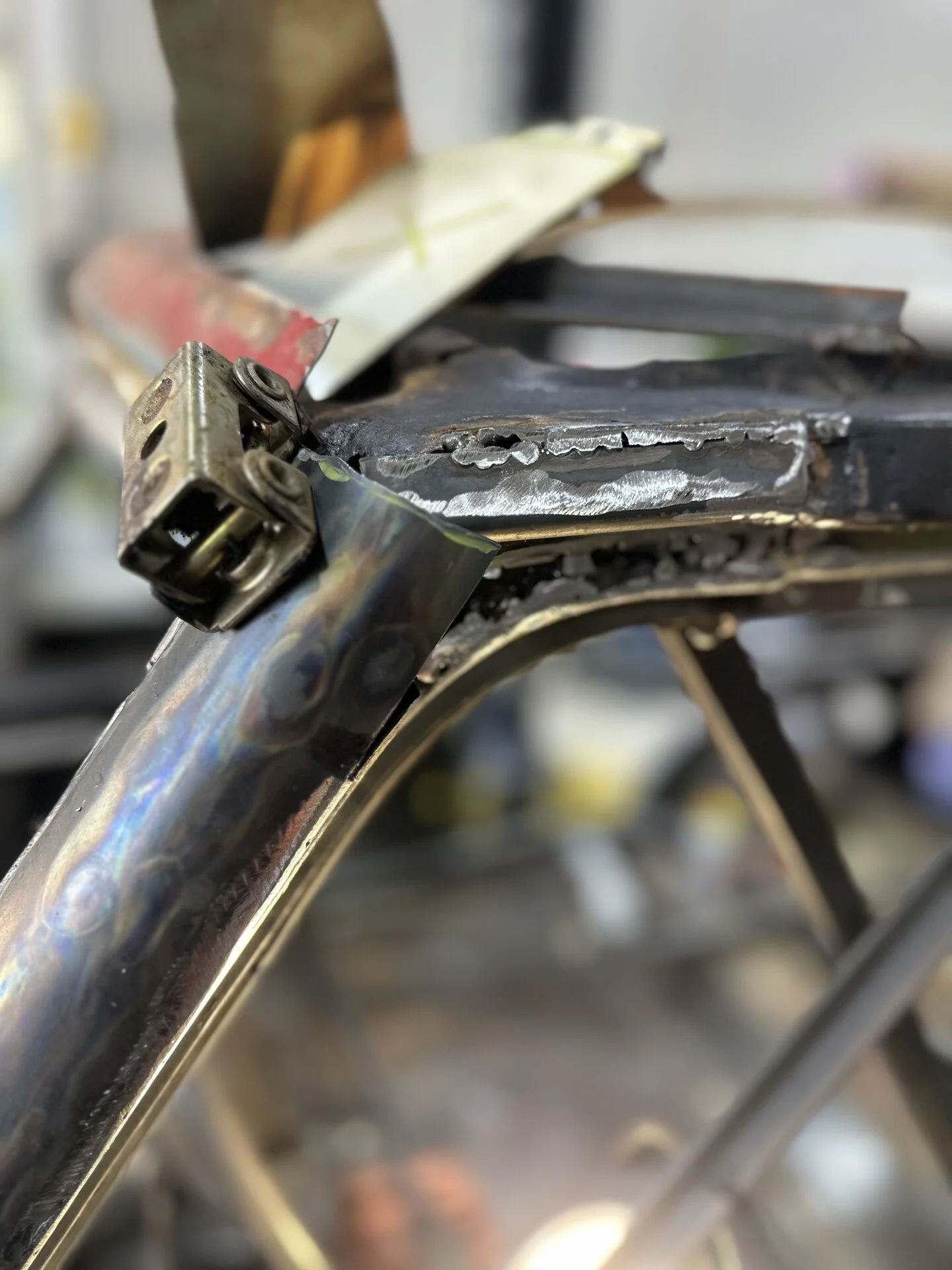

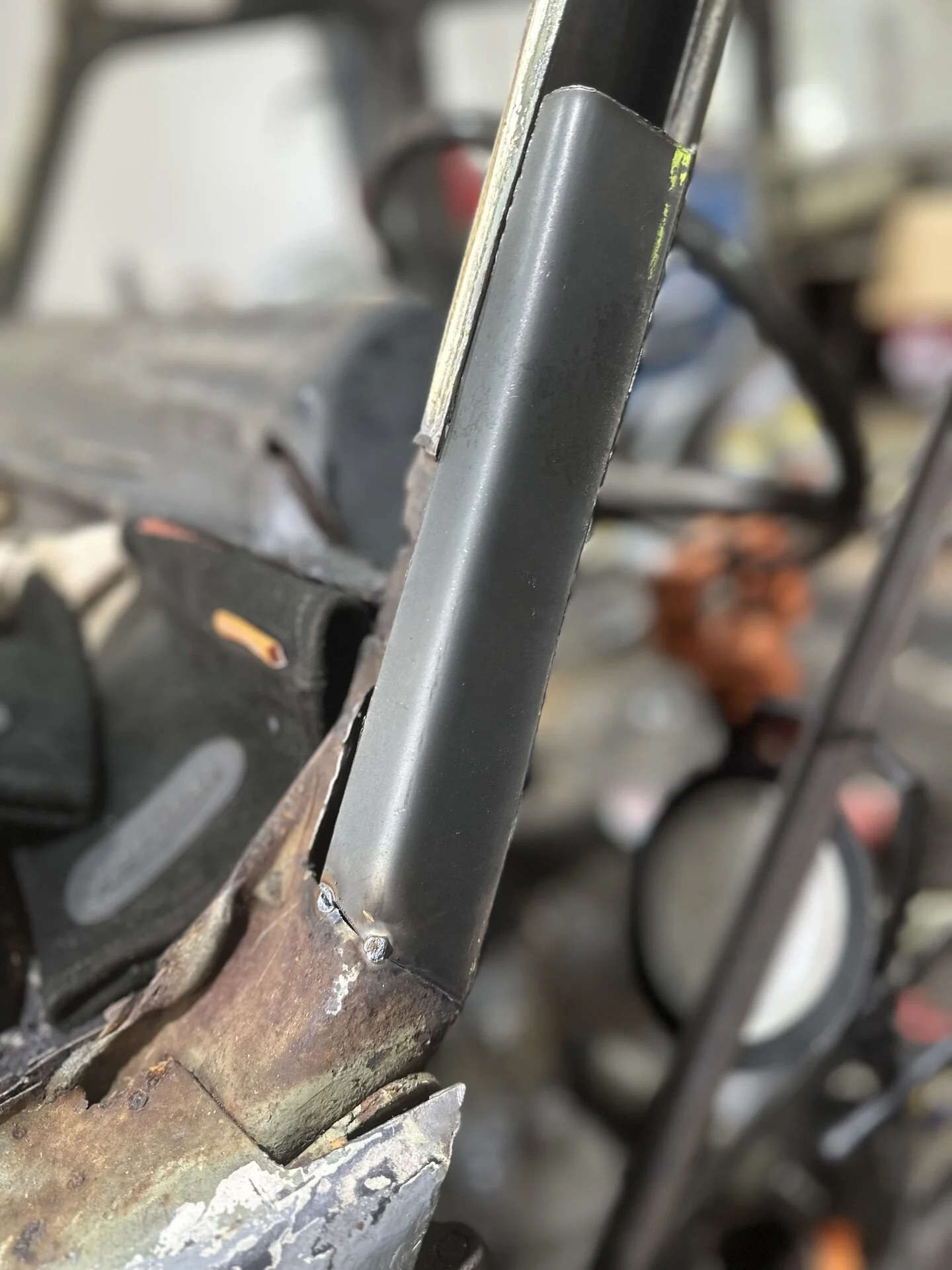

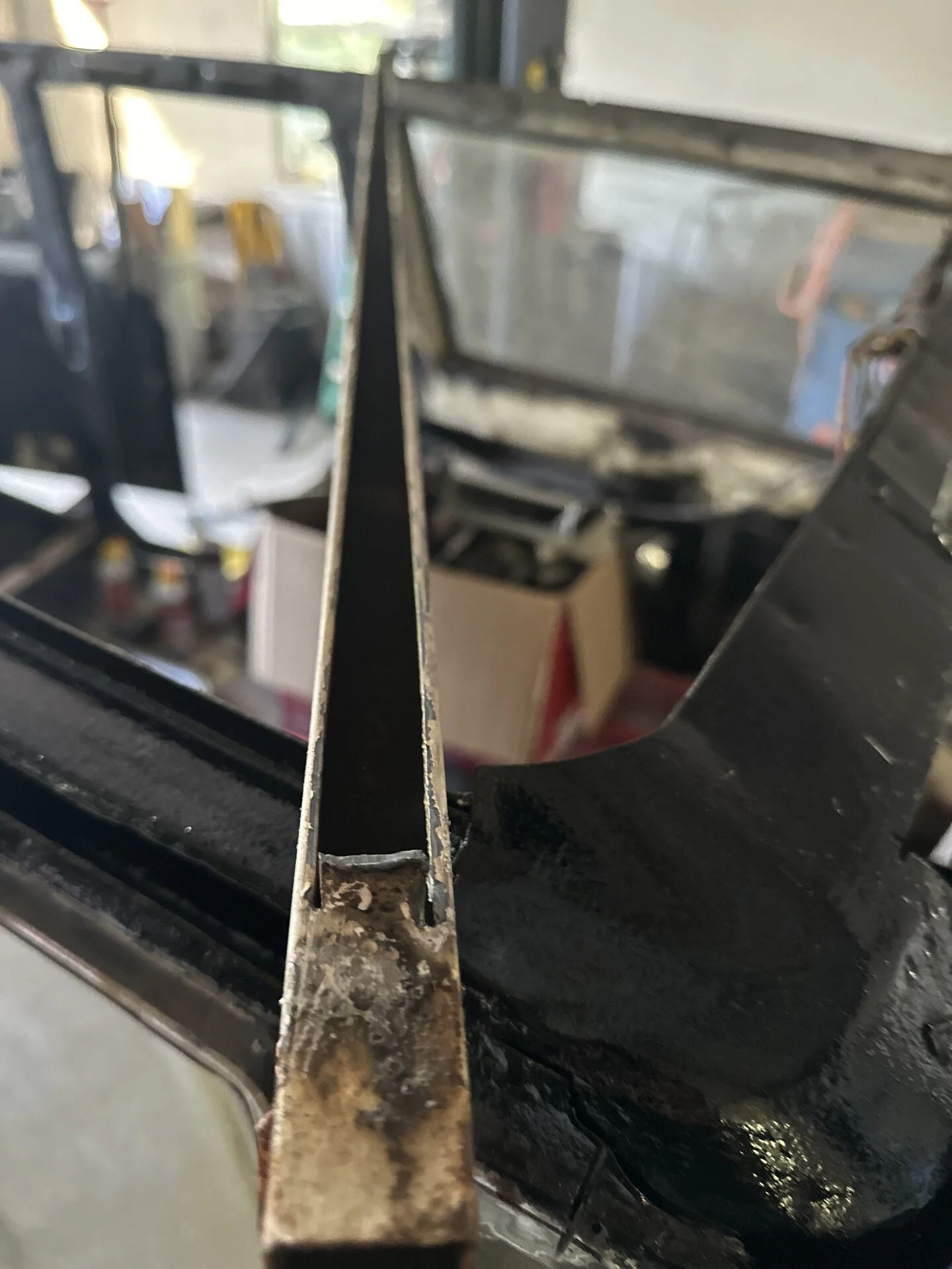

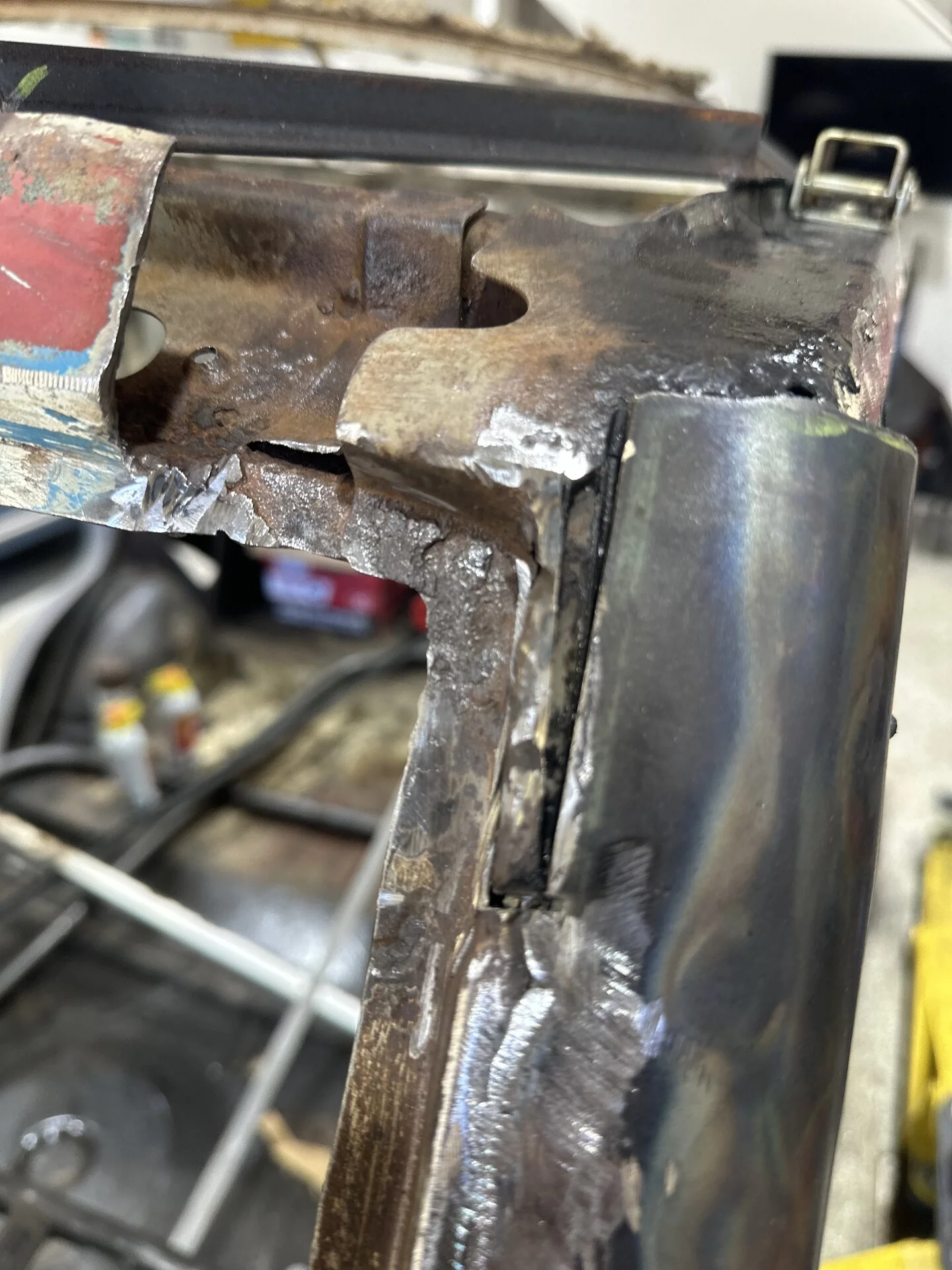

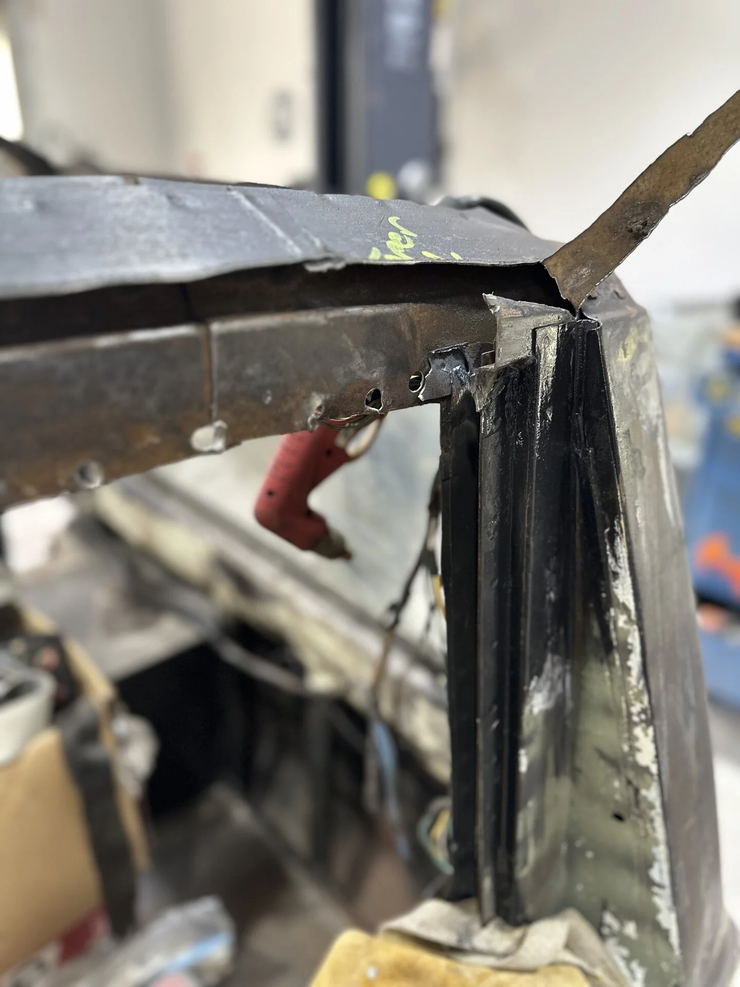

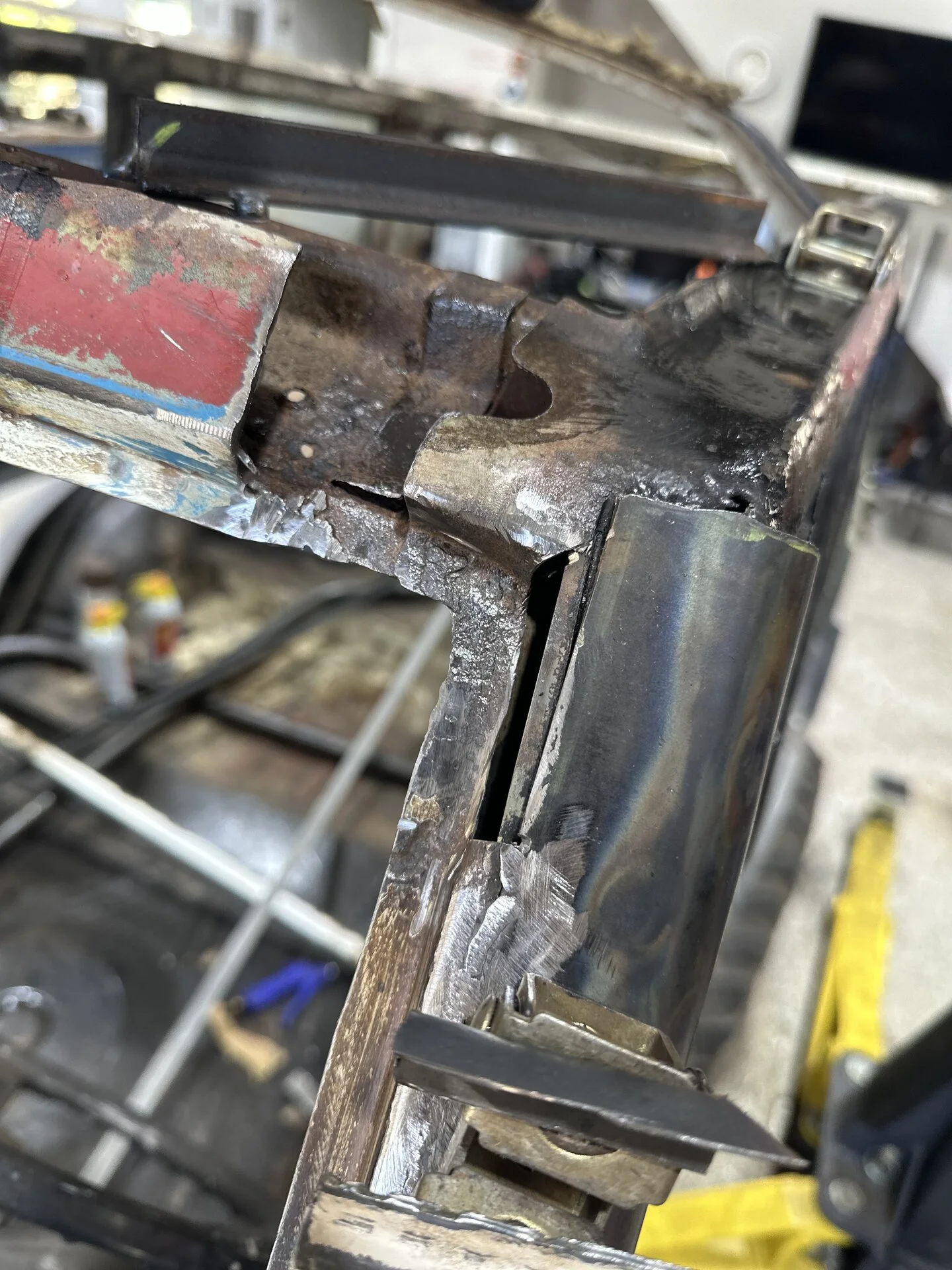

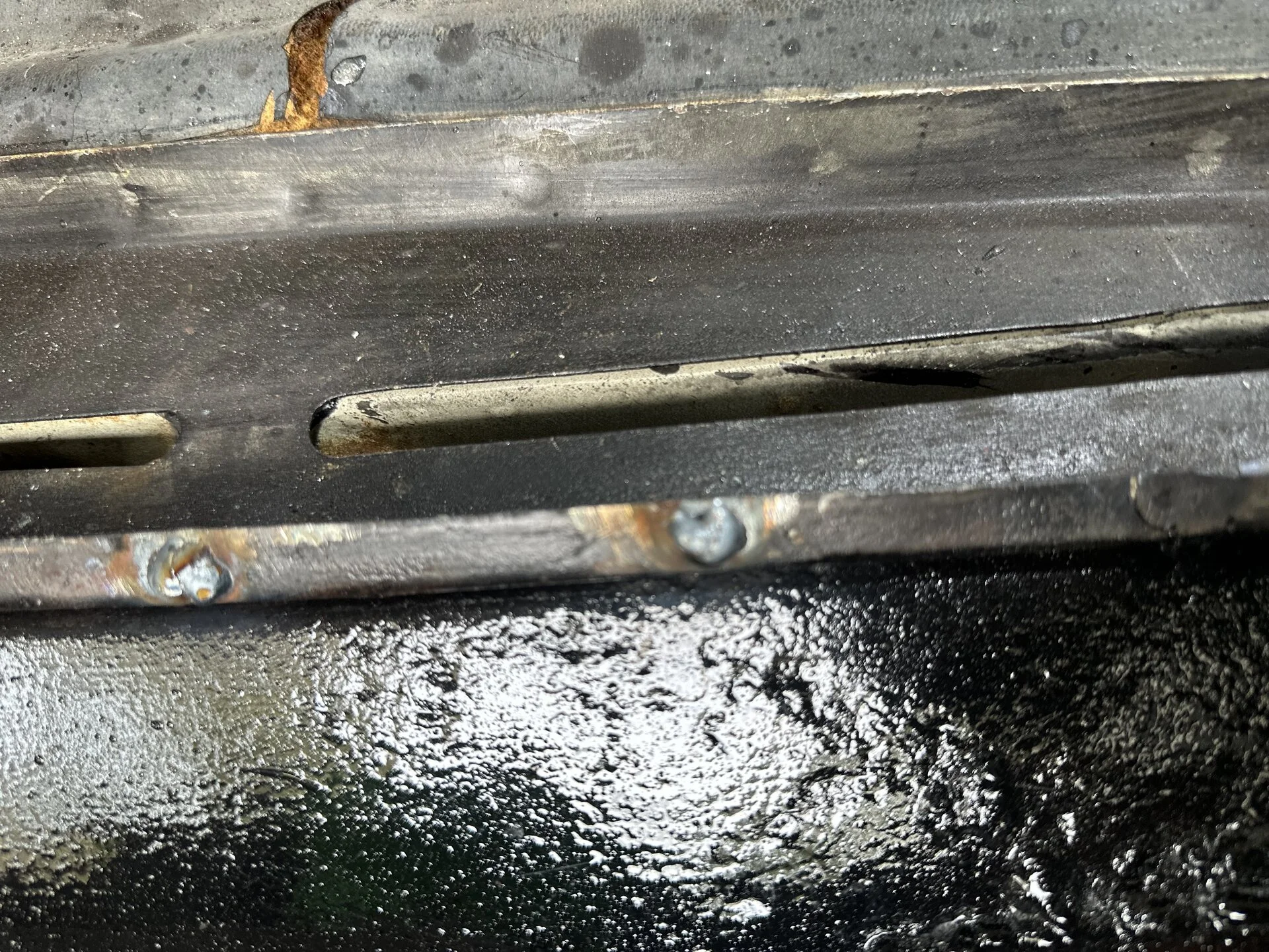

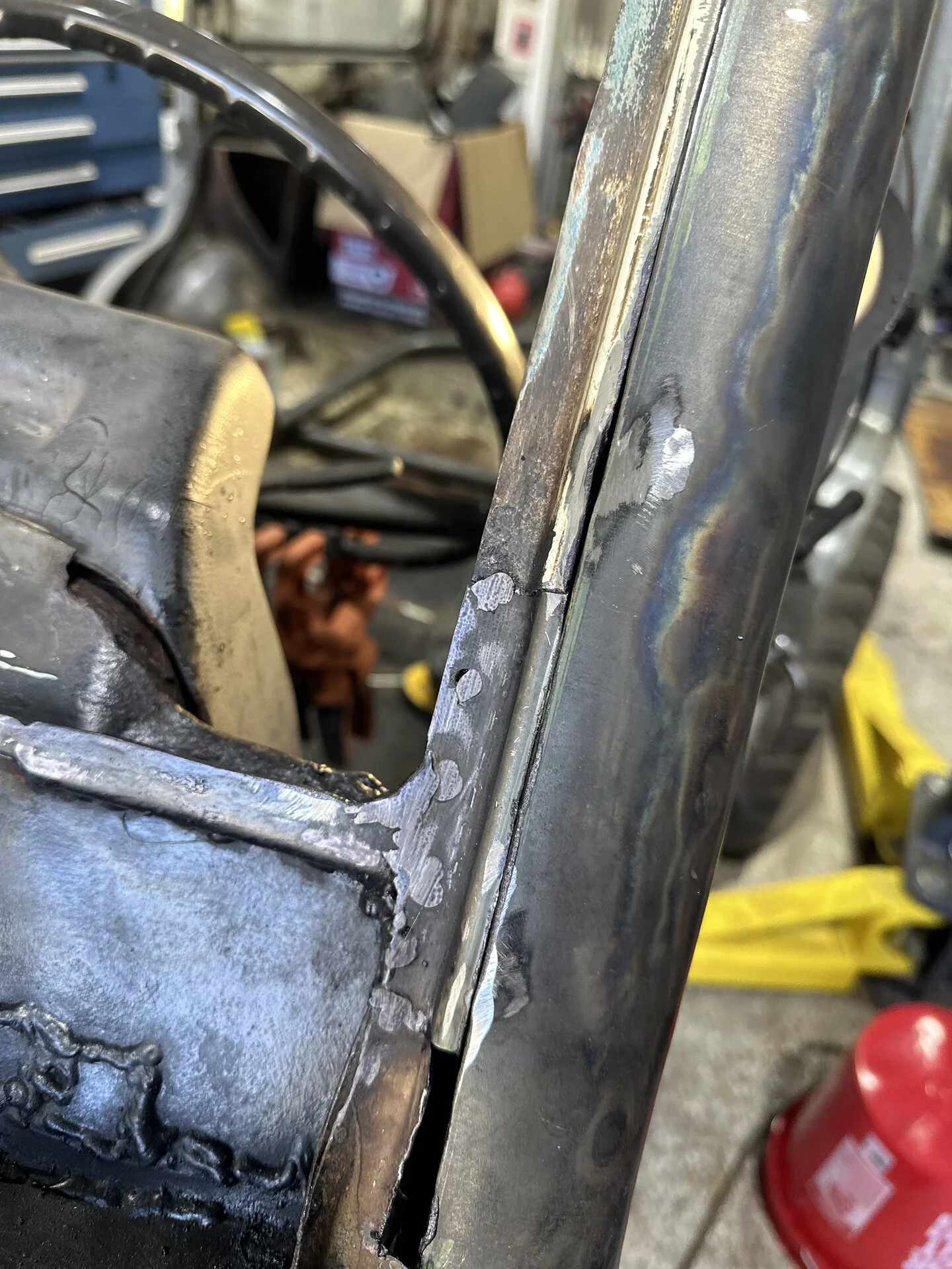

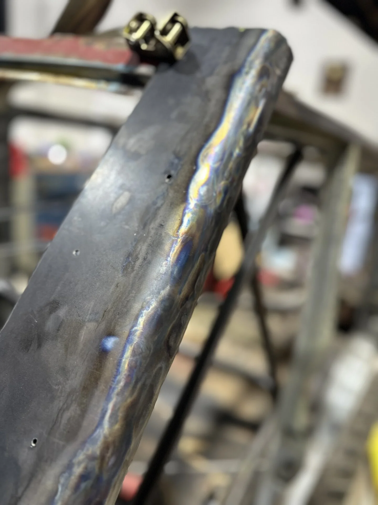

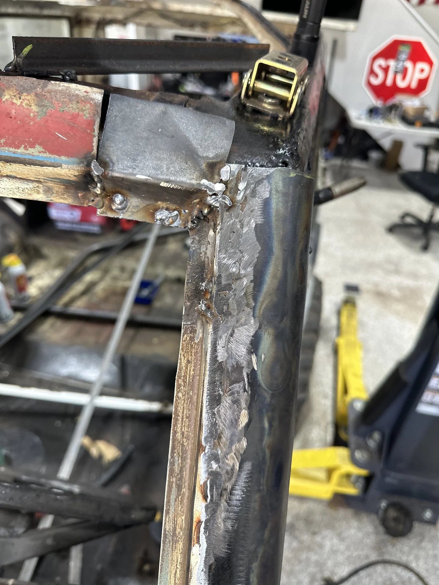

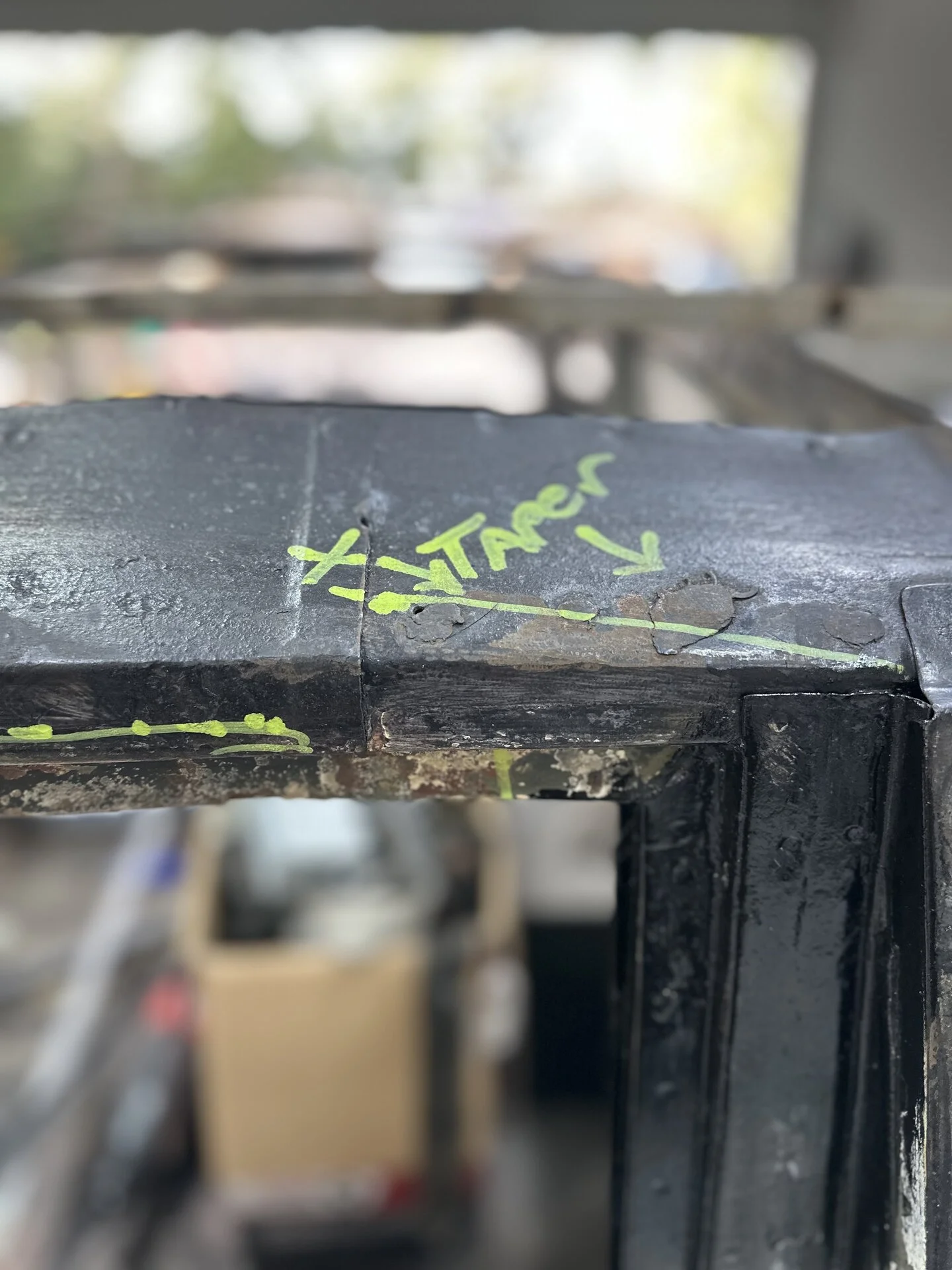

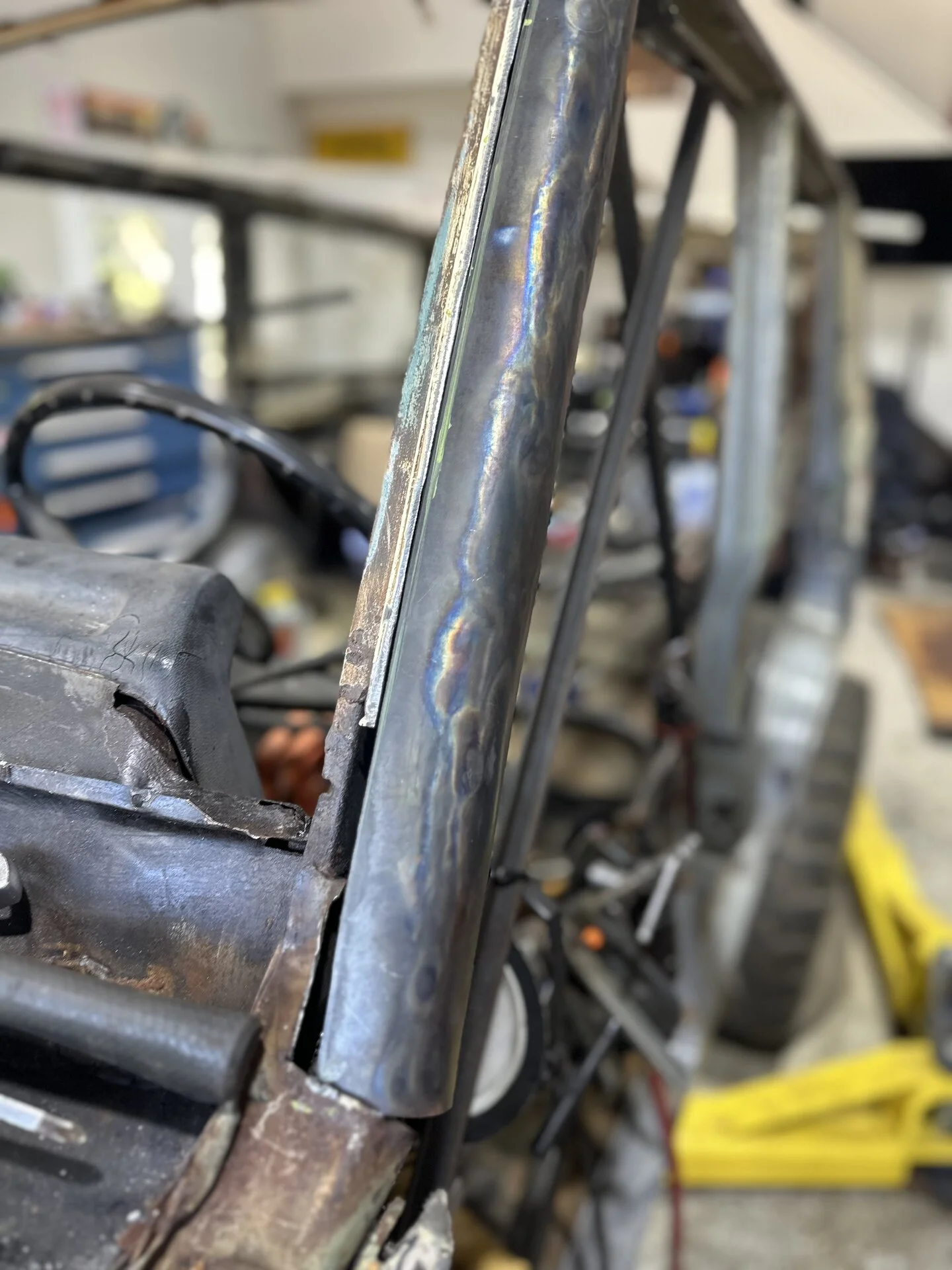

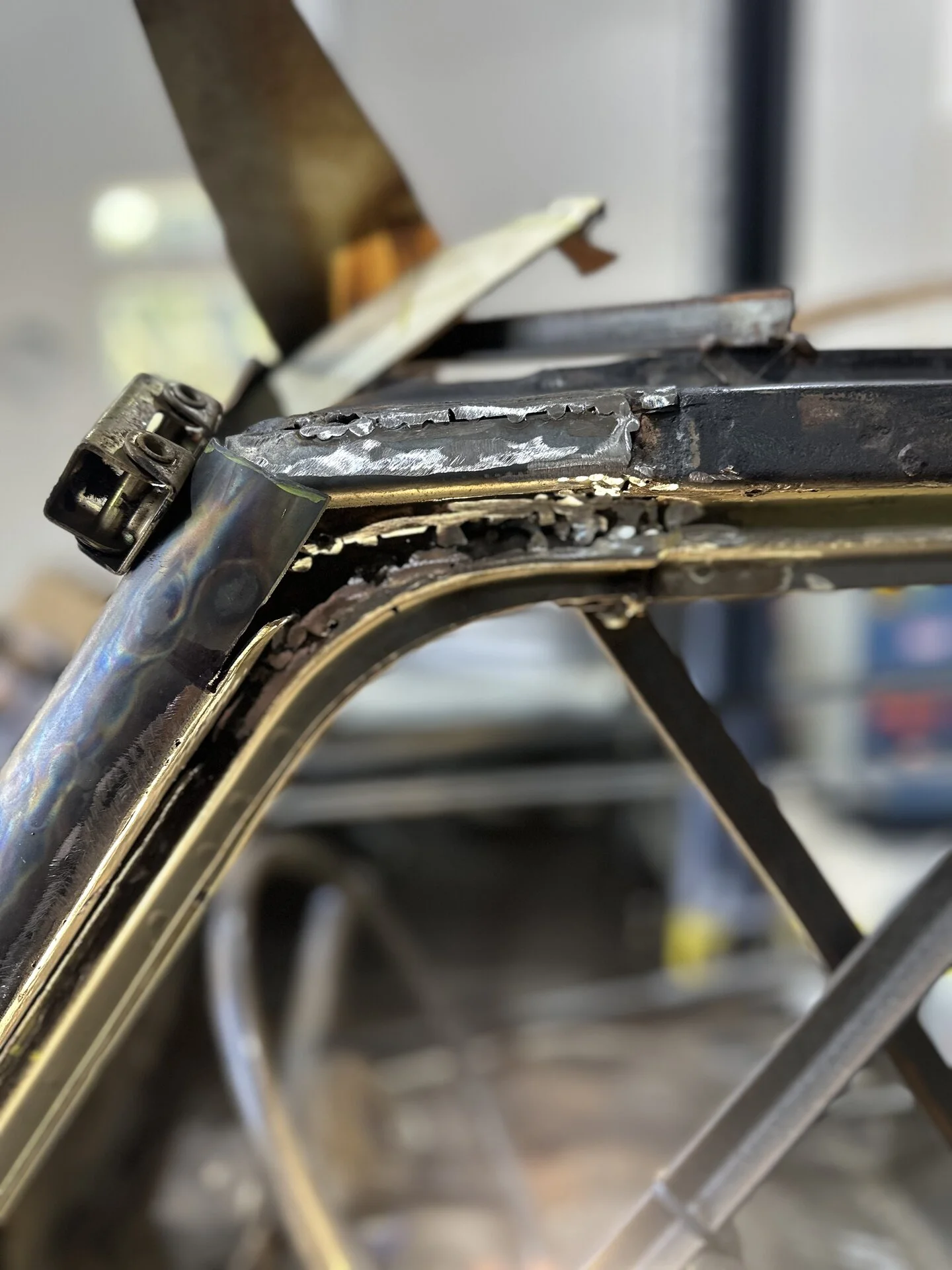

Still hammering away at this side - lots of parts in this area. The lower right windshield curve was completely gone. Started working my way across the bottom windshield lip filling in the holes from the spot welds. Put down a coat of POR 15 inside this channel and over some of the exposed metal that will be covered later. That front pan that was rusted out was POR15 also. Will just grind off whatever I need to weld other panel sections.
